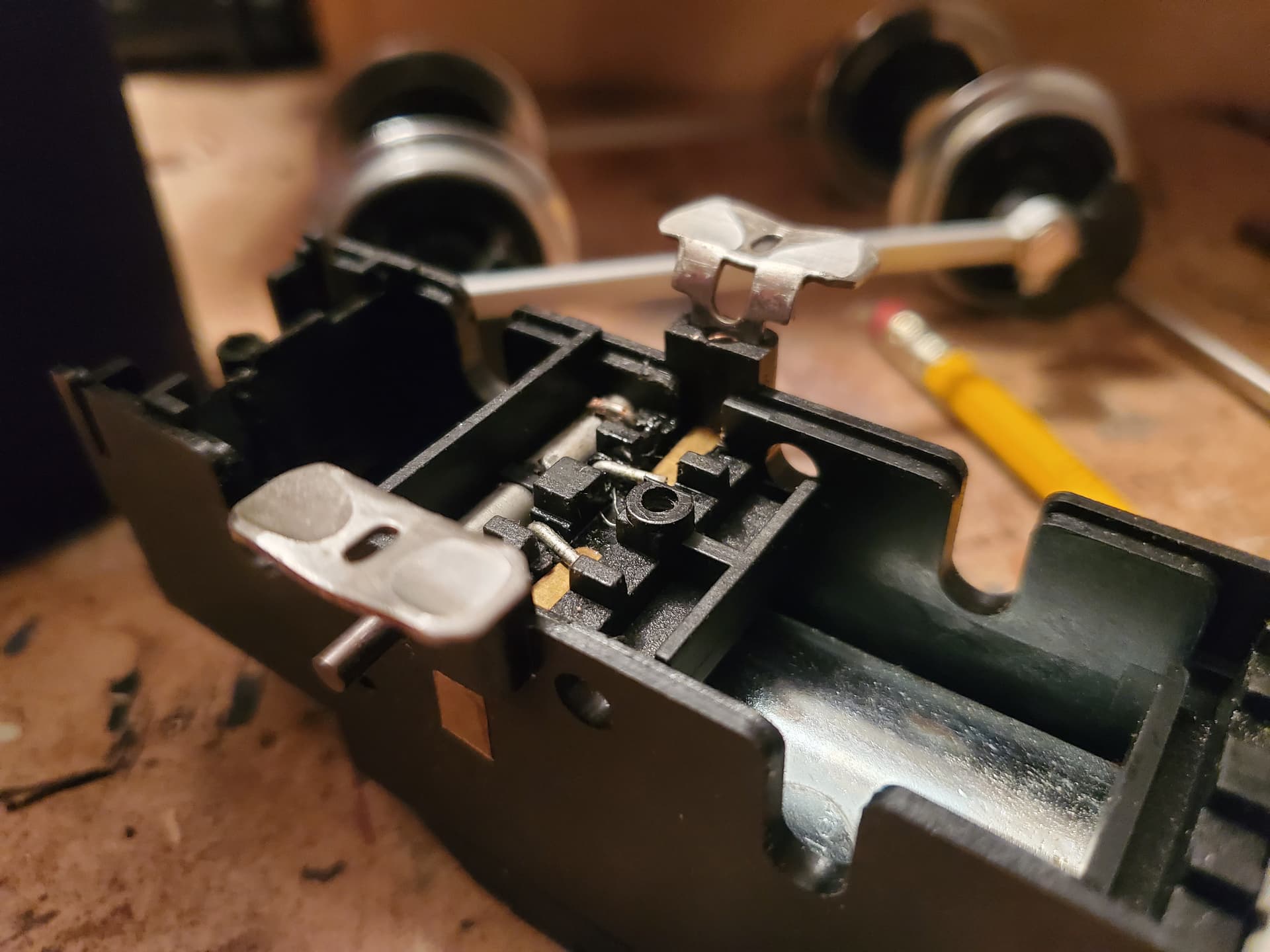

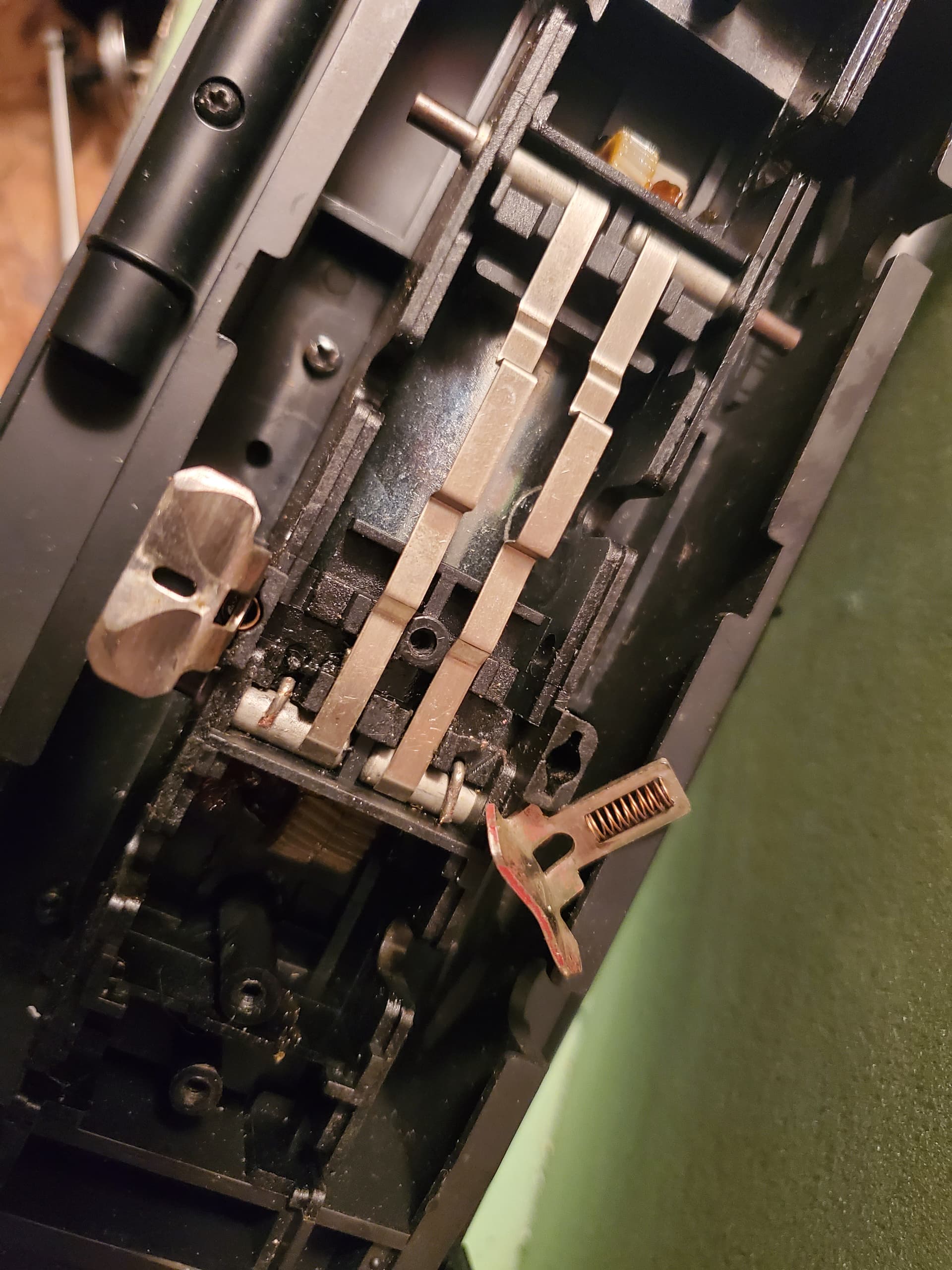

This LGB switcher came in a small collection I bought and it was setup for battery with a trailing car. I am returning it to track power. The wheels are now picking up track power but I want to add the sliders back. There seems to be something missing that keeps the sliders from falling out and transfers the power to the bus bars.
This is a 22630. Any ideas? I can’t seem to find a photo of one with the motor block opened.
I have that engine and I removed the sliders and the brass contract strips and added RailPro and battery power. I can’t remember what holds the sliders in, but it seems like they just fall out when removing the bottom plate, or something like that. Here is the LGB parts diagram, hope it shows you something to look for. https://www.onlytrains.com/manuals/20630-1.pdf
I figured it out. I pulled the motor block assembly from the frame and noticed a little slot above the mount for the pickup shoe. I looked in my parts box and found a slim copper piece that fit in through the slot in the shoe and made contact with the motor pins. Success!

Thanks for the link to the schematic John. I found the original manual on Train Li but not the break down drawings. It looks like there was a little piece that slid in the slot from the inside and secured the sliders from falling out while conducing power. I did it from the outside and it works so that is okay by me.

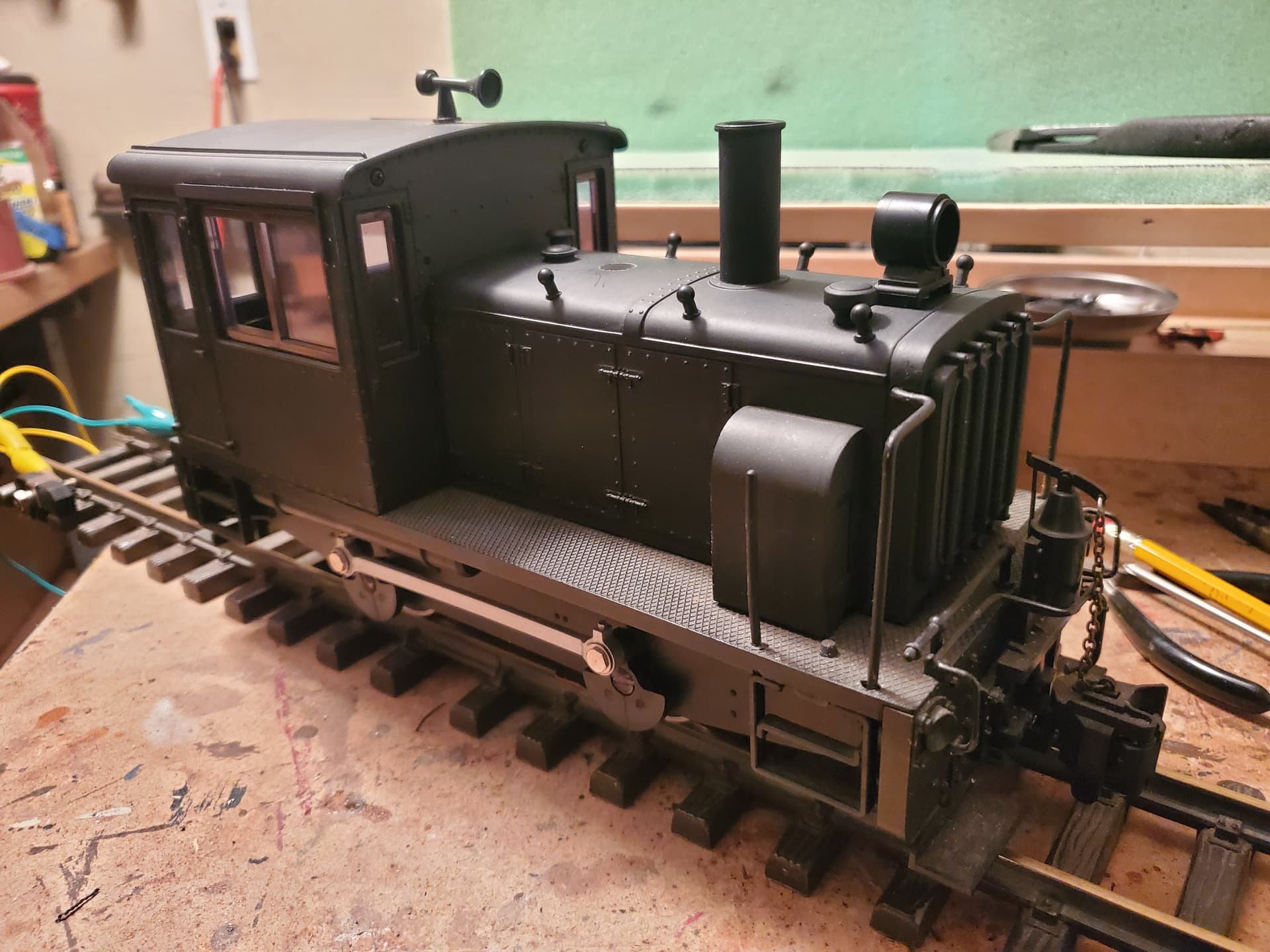

My favorite little LGB switcher. They will run forever with occasional servicing.
The LGB D&RGW #50 switcher has a great reputation for pulling ability and reliability.
I had it on rollers and then put it on the track with my hand holding it back and it felt like it had good pulling power. It does have a split gear that is so far holding so I will not be pushing it.
I have one of them too. Pulls great. I want to upsize the cab to 1:20.3
Well if I had one the first thing I would do is rip off the siderods and counterweights.
Add ditchlites, A/C unit on the cab roof, Nathan K5la horns, probably some yellow strobes and grover in the cab. Then put in on my “operating” track powered railroad and watch it go round and round for 8hrs or more at lighting speed cause it’s LGB and meant to run that way!
