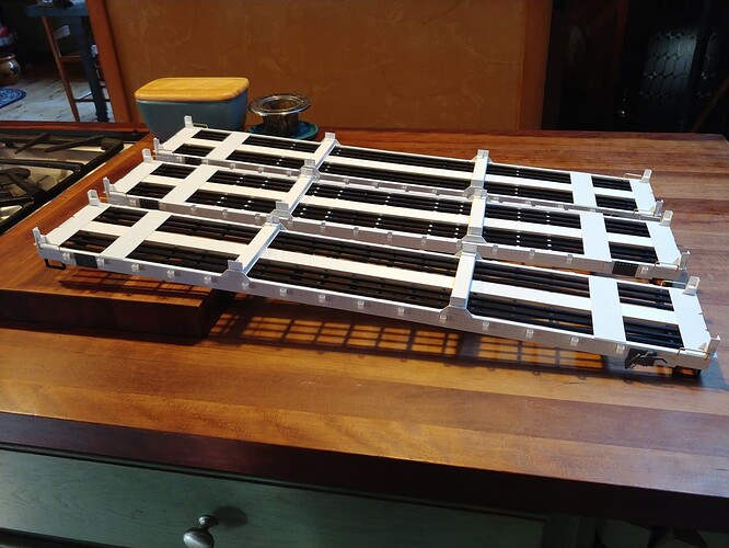

VTTX 60' flatcar rebuilds

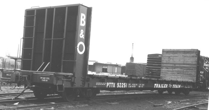

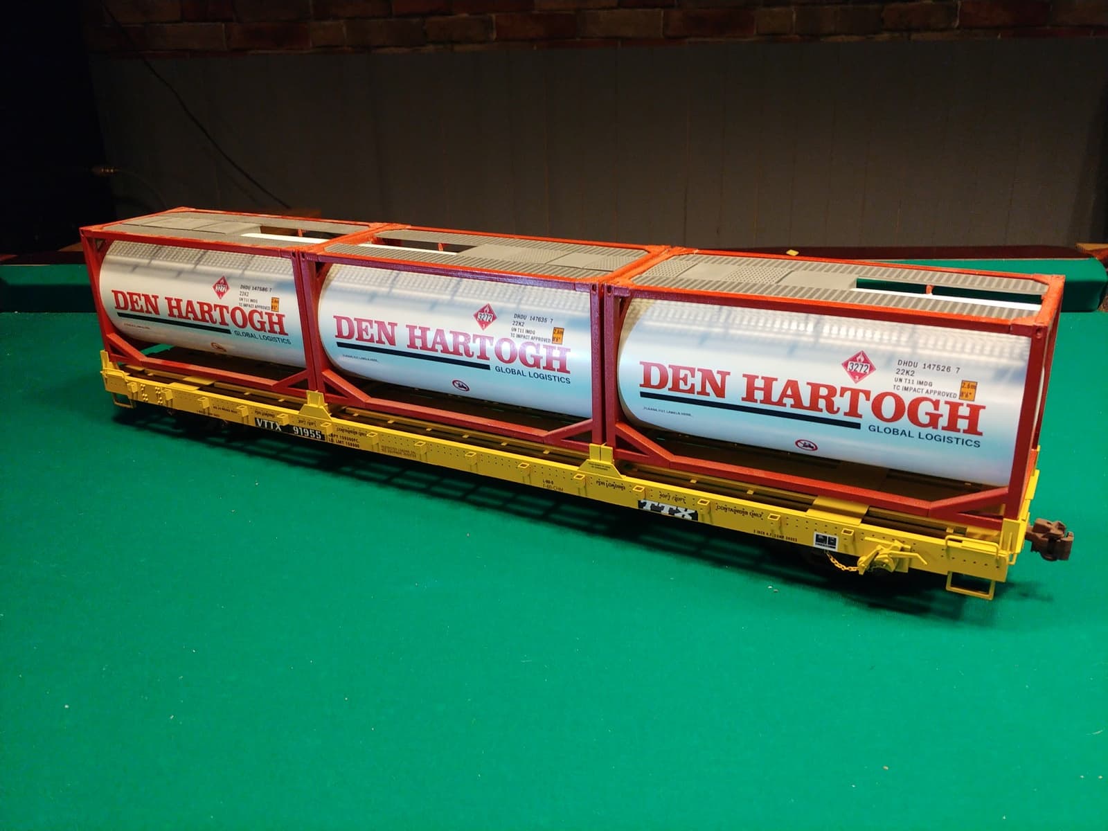

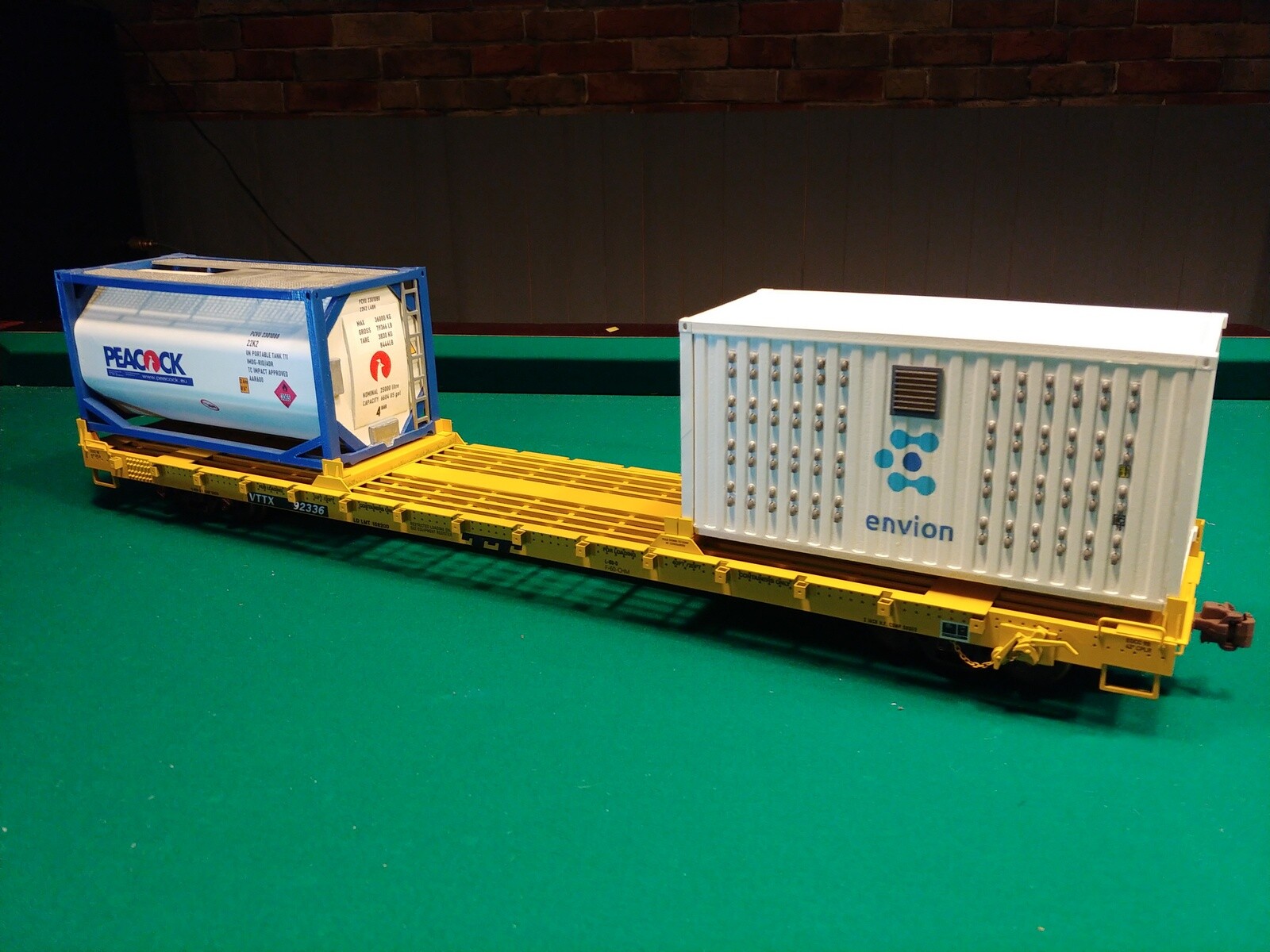

These 3 cars I built to reflect the ones rebuilt in the mid 1980’s from old Pullman Standard Bulkhead flats. The bulkheads and wood decking was removed and pedestals installed for loading three 20’ containers. One set of flip down bolsters allowed for loading one 40’ and one 20’. 1000’s were converted and some are still in use today.
Before conversion:

Your fleet of custom cars is growing quickly. Good job on get another not often modeled car in any scale.
Thanks Craig. 10 cars completed this year. 65 total!
That’s impressive. I’m impatiently waiting for my layout to be complete so I can start my rolling stock roster builds…
