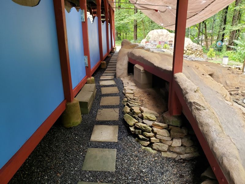

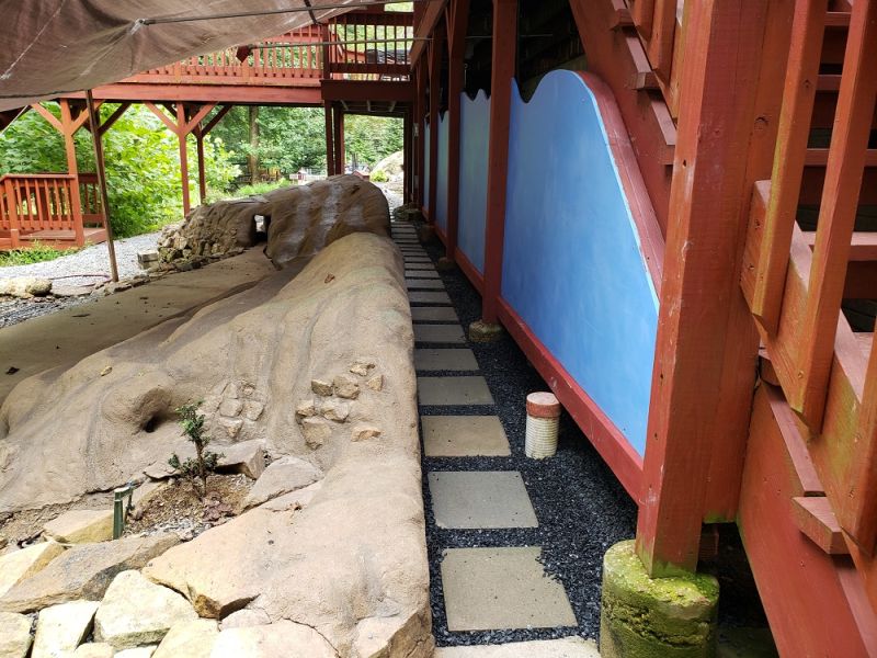

Last weekend was the big cleanup, which included touch-up painting of the deck posts and scrubbing of the blue backdrop panels.
Yesterday was all gravel work, with 2 tons delivered last thursday. Half went to paths (mainly the one in back of the new mountain), and half was moved to a storage area around the house. After moving all that at least twice (once into a transfer container or cart, once to put in place), I figger I moved 8,000 pounds of material. So I was pretty sore yesterday!
Here’s hour the mountain path looks.
This pretty much wraps this project up. Thanks for y’all sharing the project with me.
Next week I’ll hopefully begin the “flats” installation, and will post progress on that thread. [link]
