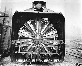

hope this helps
(http://i280.photobucket.com/albums/kk200/scooby19784/RotaryPlow.jpg)
I like the idea of the wingnut in the middle. Neat trick.
Another rotor has been found with more squared off tips.
