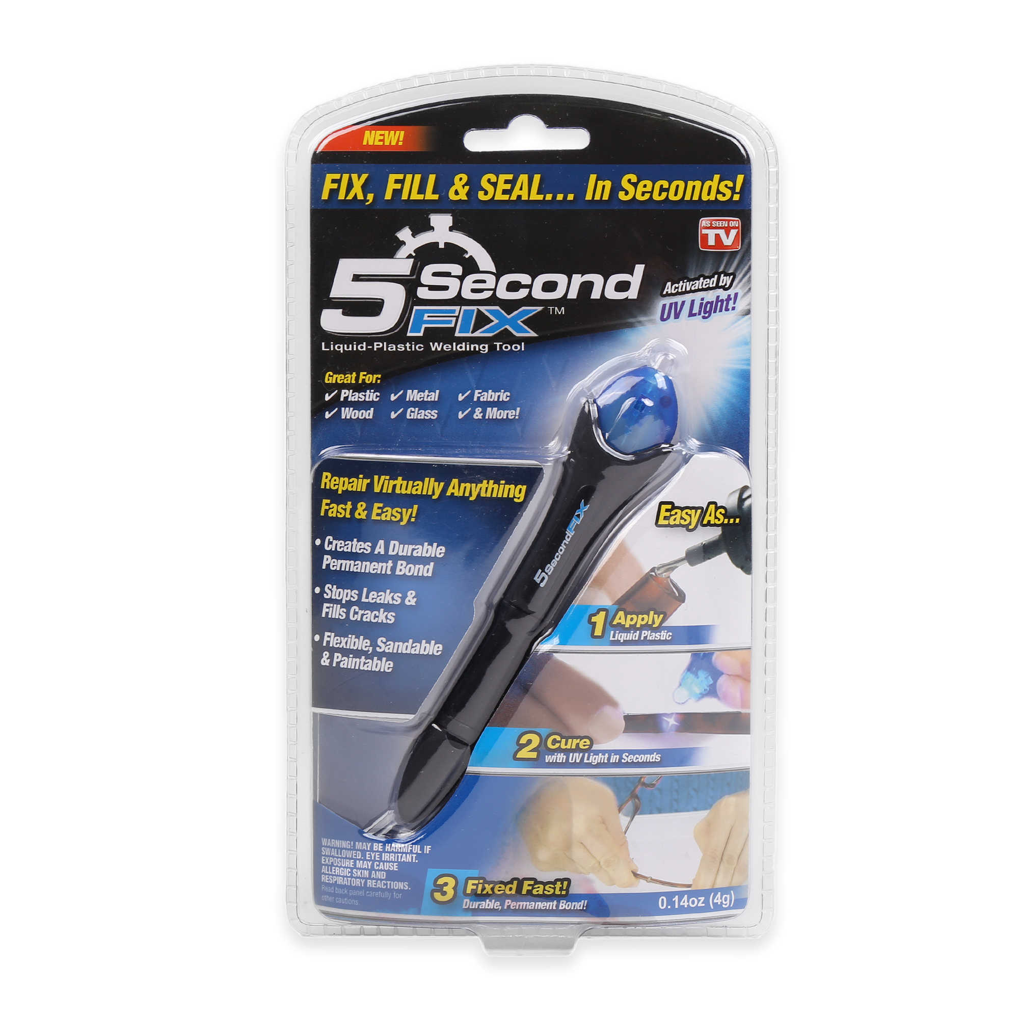

I found a $10 brand on the; As Seen On TV rack at a local Bed, Bath and Beyond; Lazer Bond USA. No fancy tin tho’(https://www.largescalecentral.com/externals/tinymce/plugins/emoticons/img/smiley-cry.gif)
This stuff?
On sale for $5 at BB&B
you win
