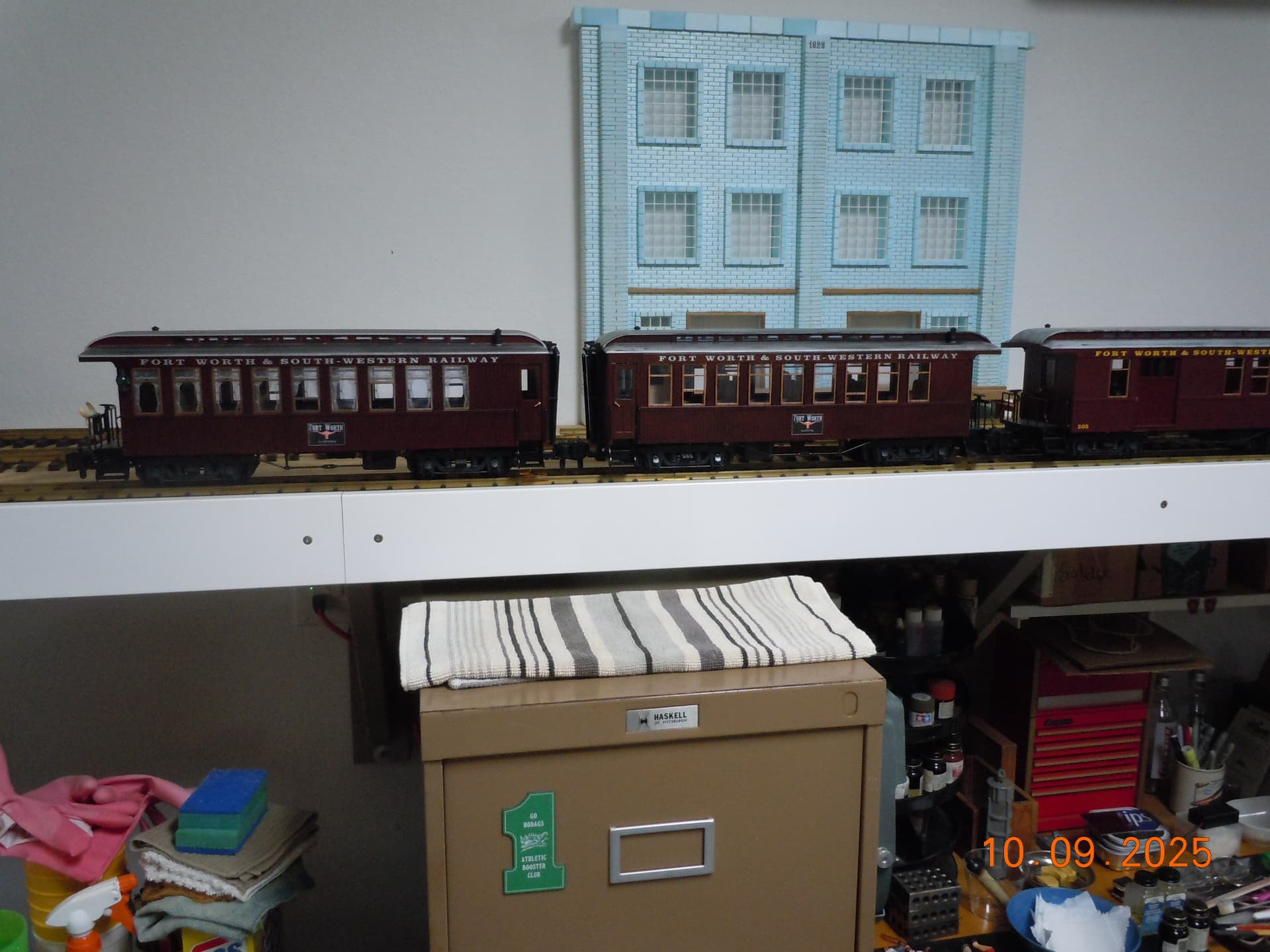

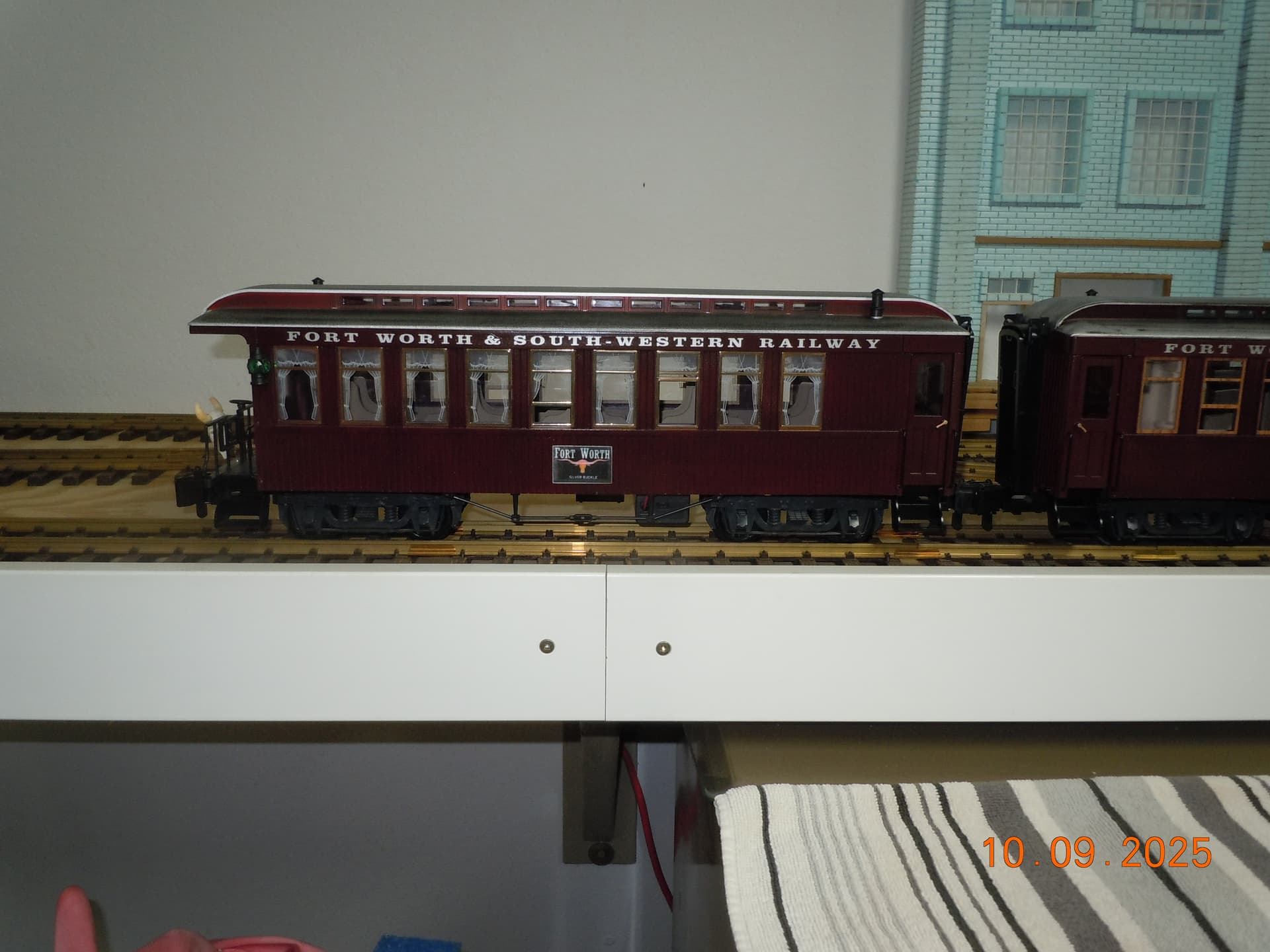

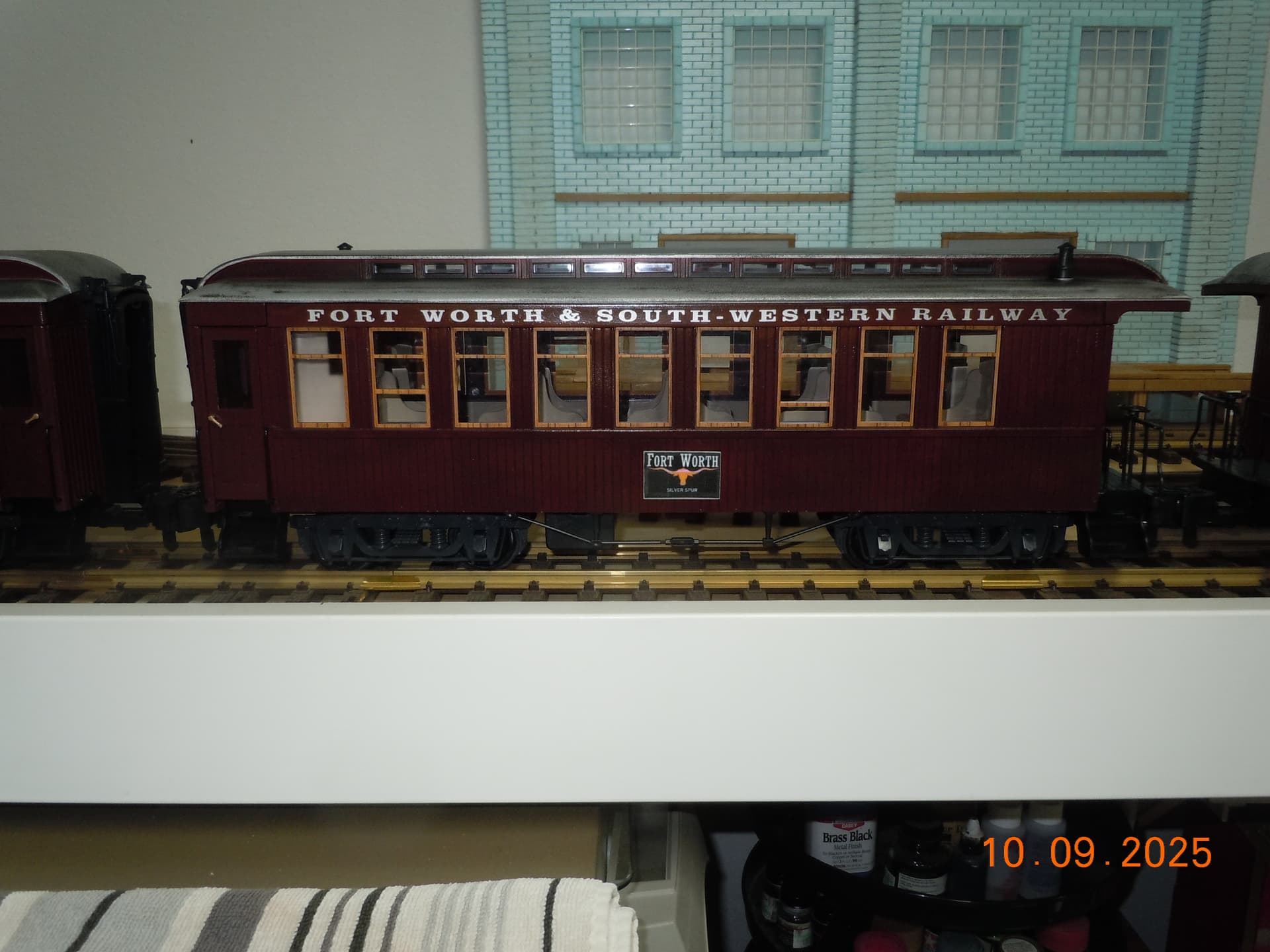

i took and LGB coach #3080 and a #3082 and made two different cars. I wanted a car like the Alamosa on the D&RGW had to run on my railroad the F W & S W railroad. I took the parts from the end of each car and put them on the other car, thus having a car with one end vestibuled and the other with the open-end platform. Both LGB cars use the same main body parts on each car with the exception of the end pieces which are just screw on with the exception of a part or two that are plastic riveted on and will have to be removed. I will answer questions if someone is interested in doing this. Here are a few pics I took.
