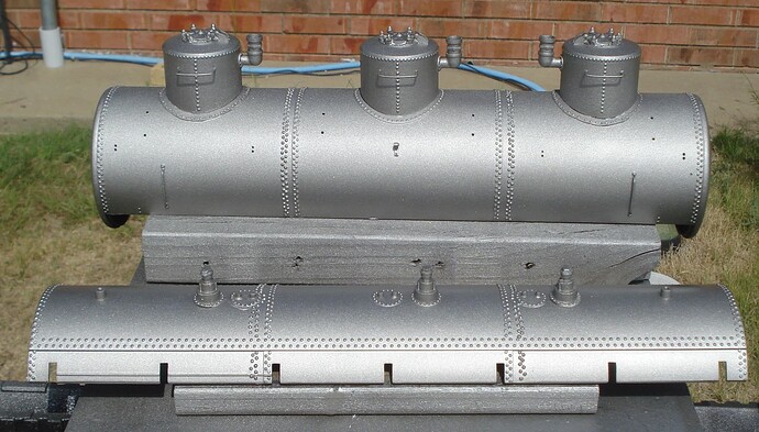

Triple Dome Narrow Gauge Framed Tank Car
While I am drilling holes in batches of 100, I am trying to decide about a paint scheme. The Oso Grande Oil Company owns it’s fleet of tank cars. I bought 12 of the Bachmann spectrum framed cars years ago when Al Kramer was blowing them out in case lots on EBay. To represent this. They are all painted silver. These will be the crude oil haulers coming to the refinery in Albuquerque from wildcat fields around Farmington.
At some point the finished products have to go to market. Most of that will be by truck or standard gauge tanker. For those business served by the Cibola, A NG tanker is the way to go and thus the reason for this car. The paint job therefore should be shameless self promotion typical of the 1920-30s.

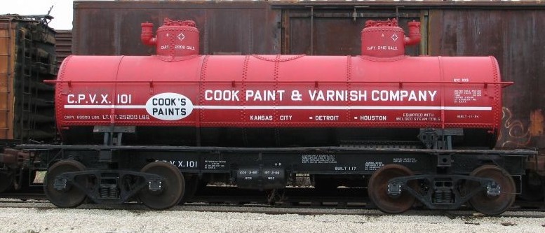

Other common colors of the era would be black, red and white.

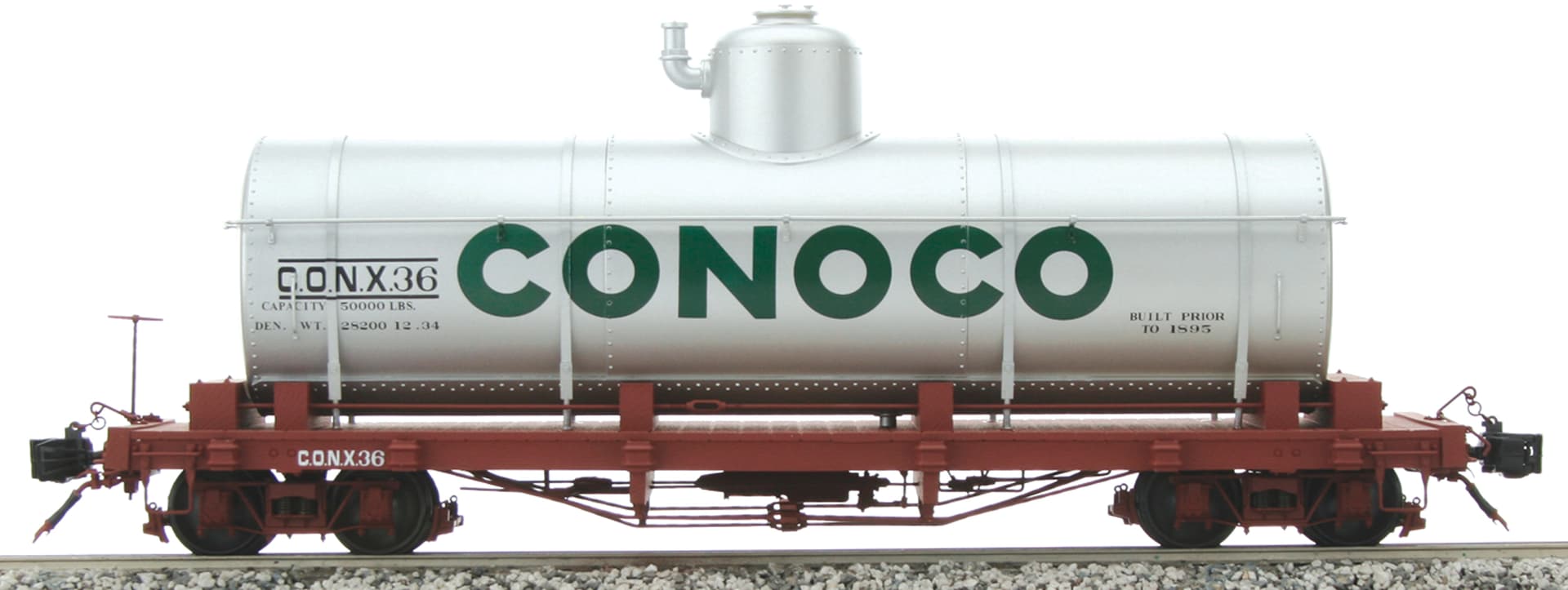

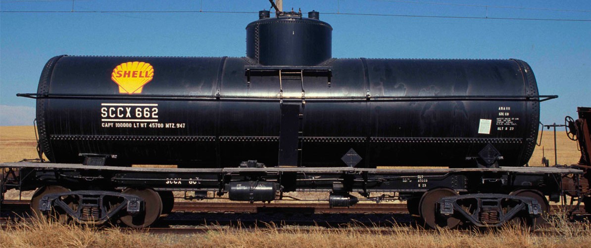

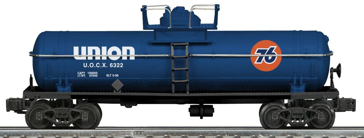

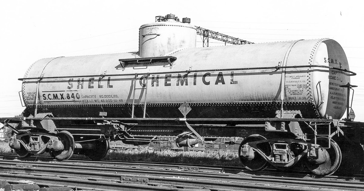

Some other choices exist like this Shell car that I think was yellow.
Not all cars were one solid color. Sometimes the frame, tank bottom, domes and ends were a different color. I will probably incorporate some of those ideas to help give the car character.
About the only thing I am opposed to is solid black since I have a set of AMS Shell tankers painted black with white lettering.

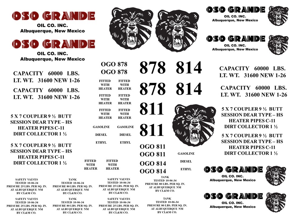

This the logo. Depending on the color of the tank body I will choose a contrasting color for the lettering.

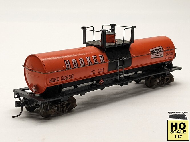

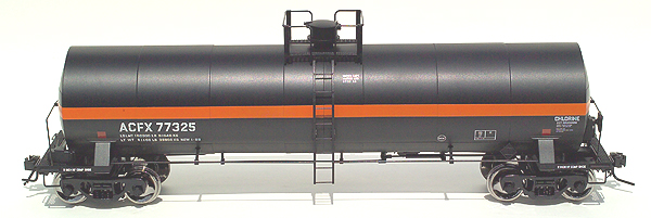

Feel free to throw in ideas. The only designs I have already discarded are the half and half seen on some Halliburton cars and the center band used by Hooker. I think those are both to modern.

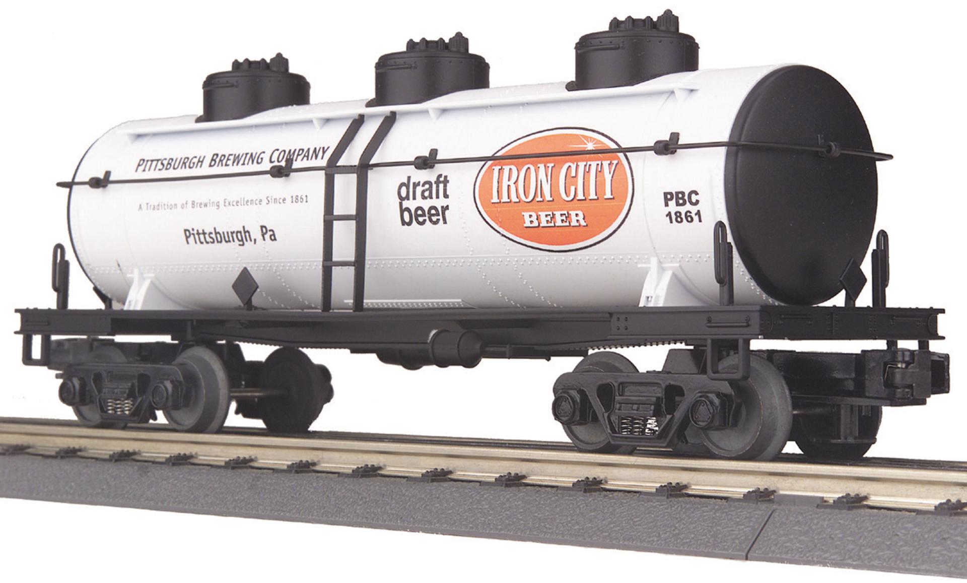

Would there be precedent of dividing the colors vertically under each dome with the name of the primary customer, too?
If not, I like the silver. It pops!
Eric, that reminds me of a church bus that was painted like a roll of Life Savers, in multi colors

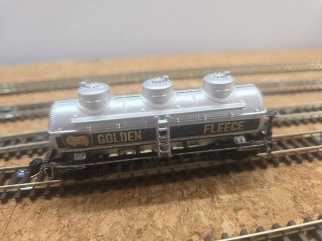

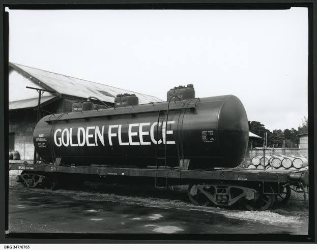

Personally I like Golden Fleece. You’d just have some difficulty explaining how it got into your consist.

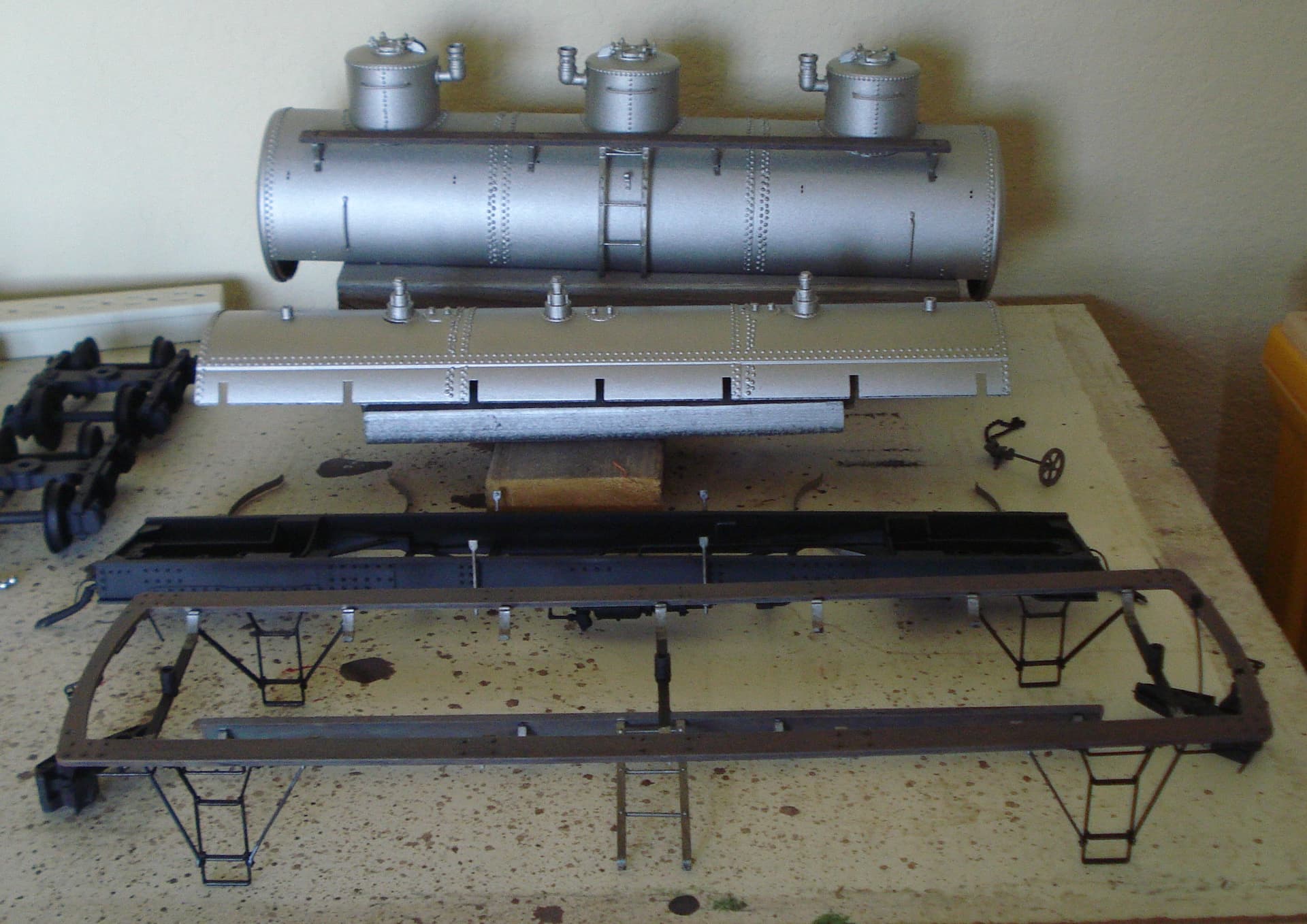

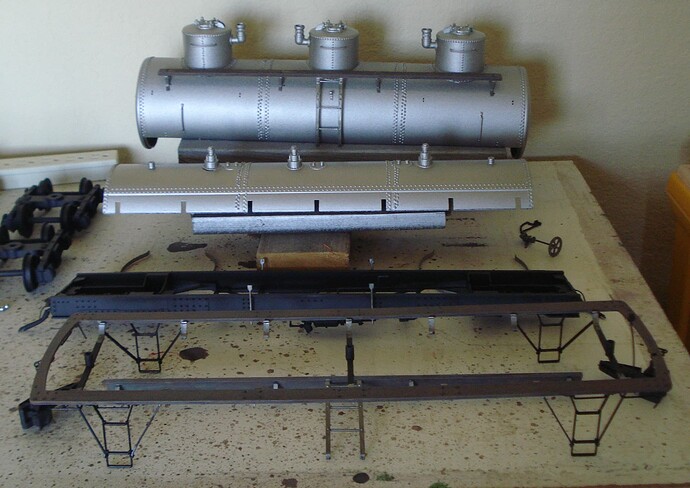

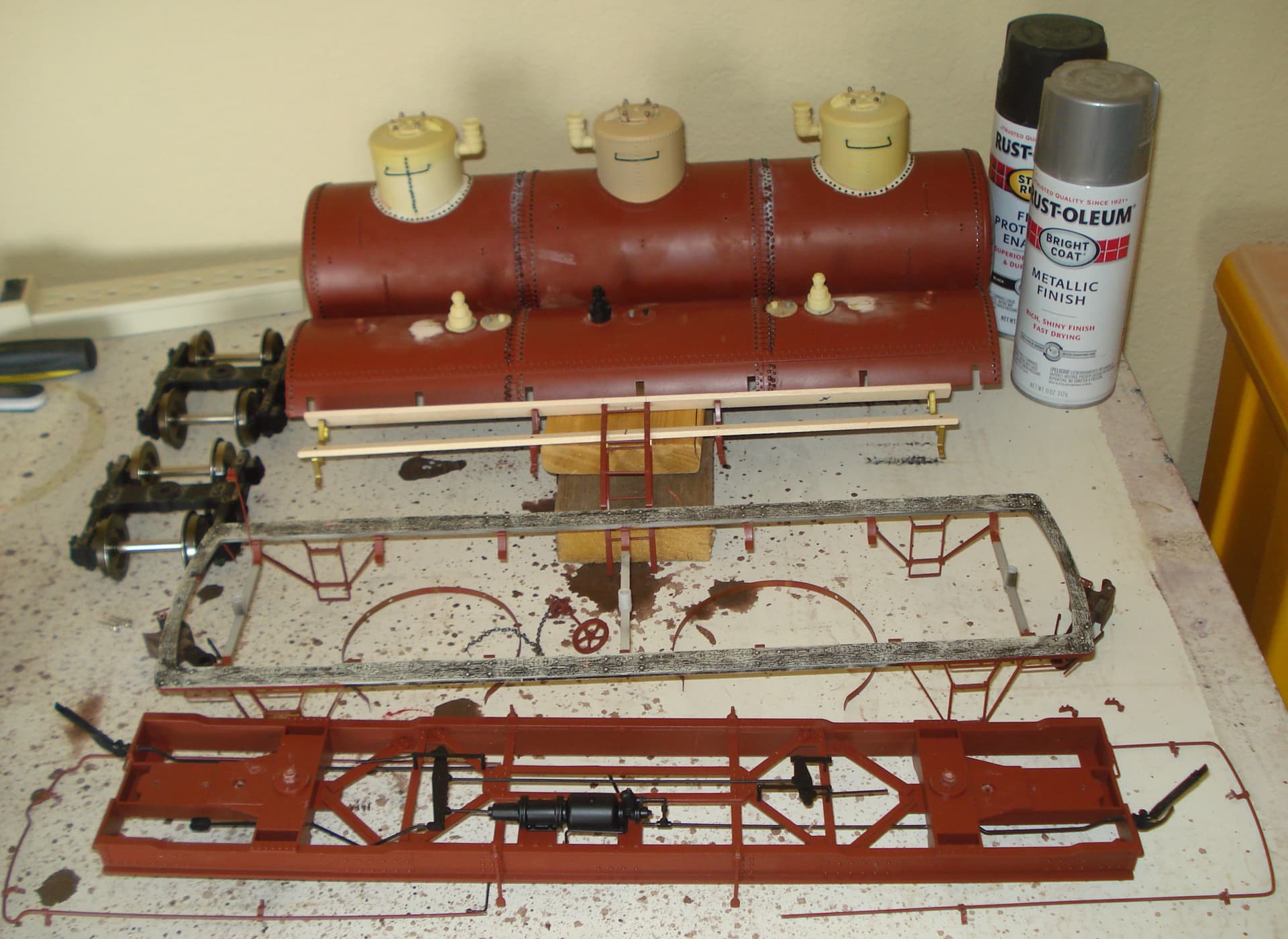

Parts ready to paint.
Just need a warm still day to shoot paint.

Below is one of my favorites concerning tank cars, but only because I like to say I take my favorite Hooker to train shows!

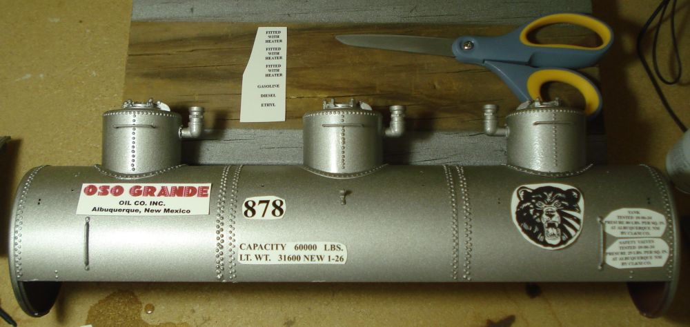

Finalized the logo design and printed the decals.
Just waiting for the weather to cooperate to shoot paint.

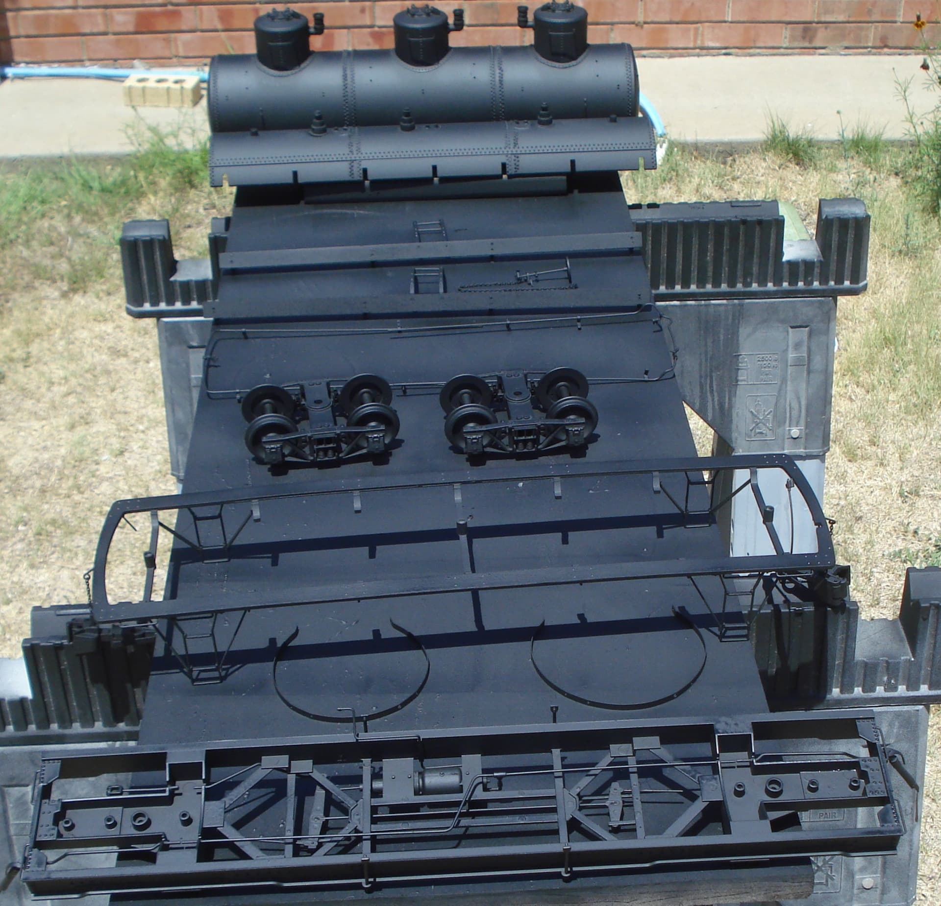

Finally a warm still day to shoot paint.
I started with a good coat of flat black on everything.
Now for the silver parts. I had a miss fire on the first can of silver I used. It was called “bright coat”. It came out thin as water and flashed the metallic instantly. No amount of adjustment would help so I went and bought a can of dull silver high performance enamel by Rustoleum. It worked great. I followed this up an hour later with a good coat of clear gloss in preparation for the decals.

Doing the detail painting has been more of a job than I thought.

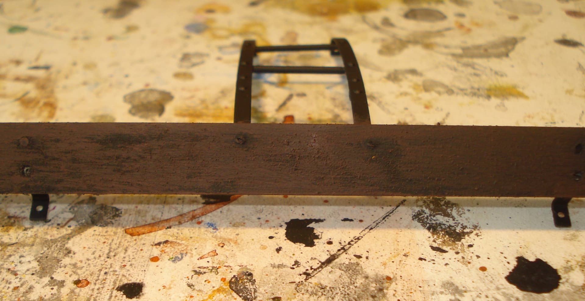

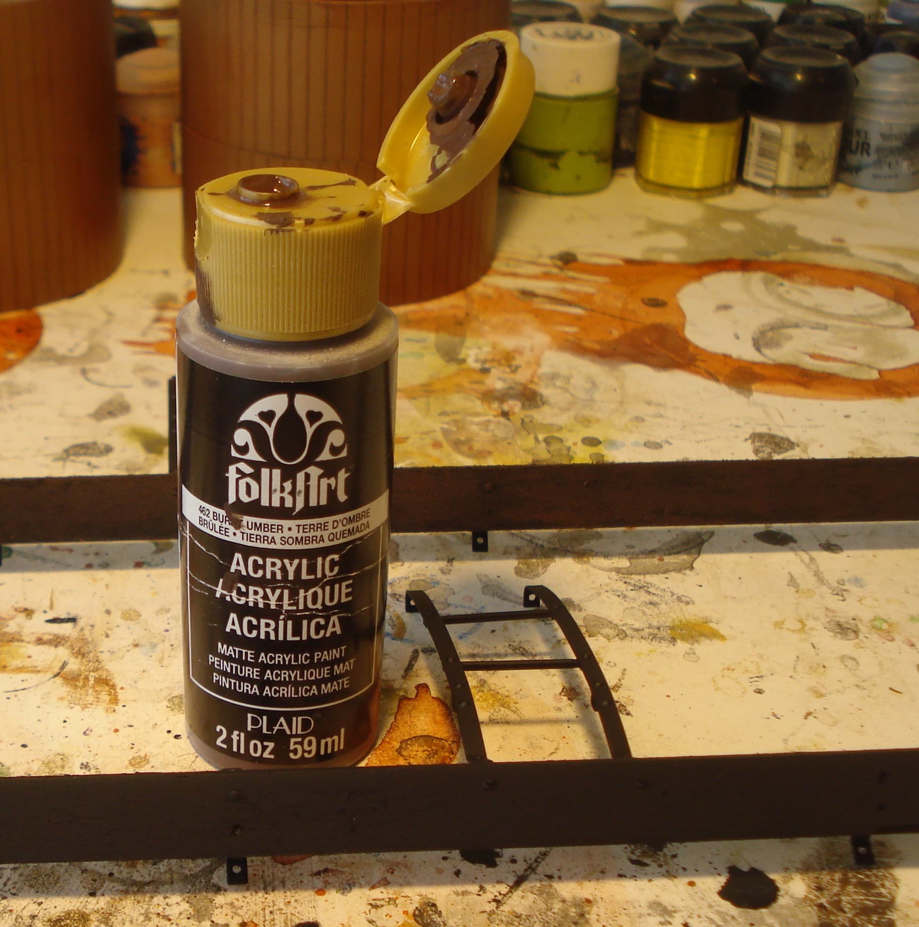

The plan is to do the wood walkways first and then come back and paint the silver parts. That will leave the solid black touch ups for last.

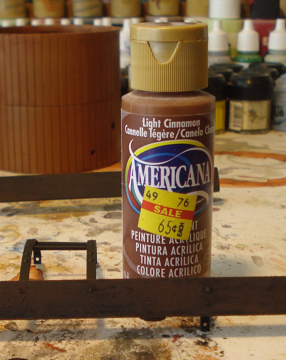

First is this dark brown “Burnt Umber” using craft paint. It is not a high hiding pigment heavy product so it works well for dry brushing.
For a high light color I am using “Light Cinnamon”.
I was going to use Vallejo “Bright Silver” or “Bolt Gun” but the first was to light and the second had a blue hue. In the end I had to capture some of the Rustoleum “Old Silver” spray paint and brush it on.
Last was the touch up of the black parts that I had unintentionally hit with the dry brush.

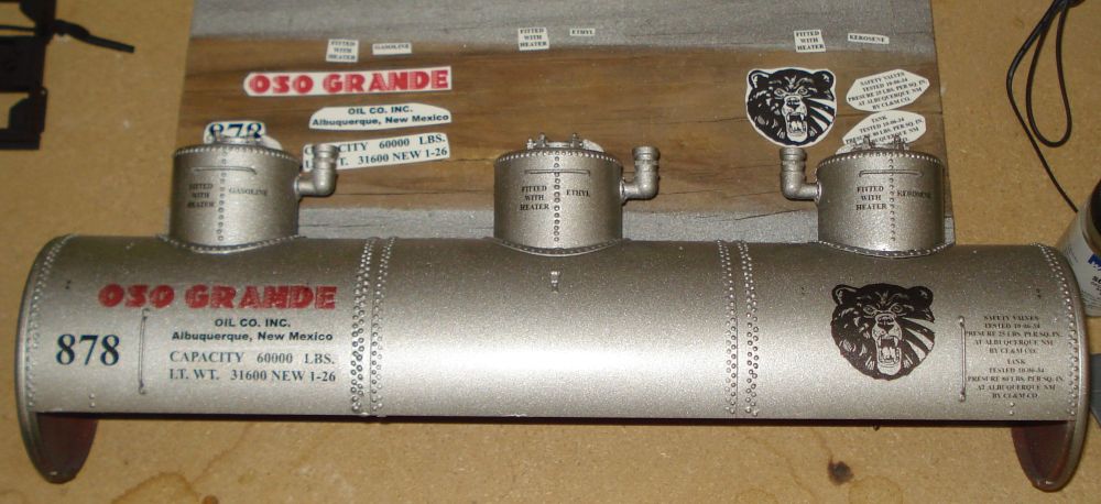

Decals.
One side and both ends are done. Looks like they are laying down very well. This is the first time I am using the Inkjet clear decal paper from Micro-mark.

On another note. Because I am waiting for Micro-sol to work its magic.
