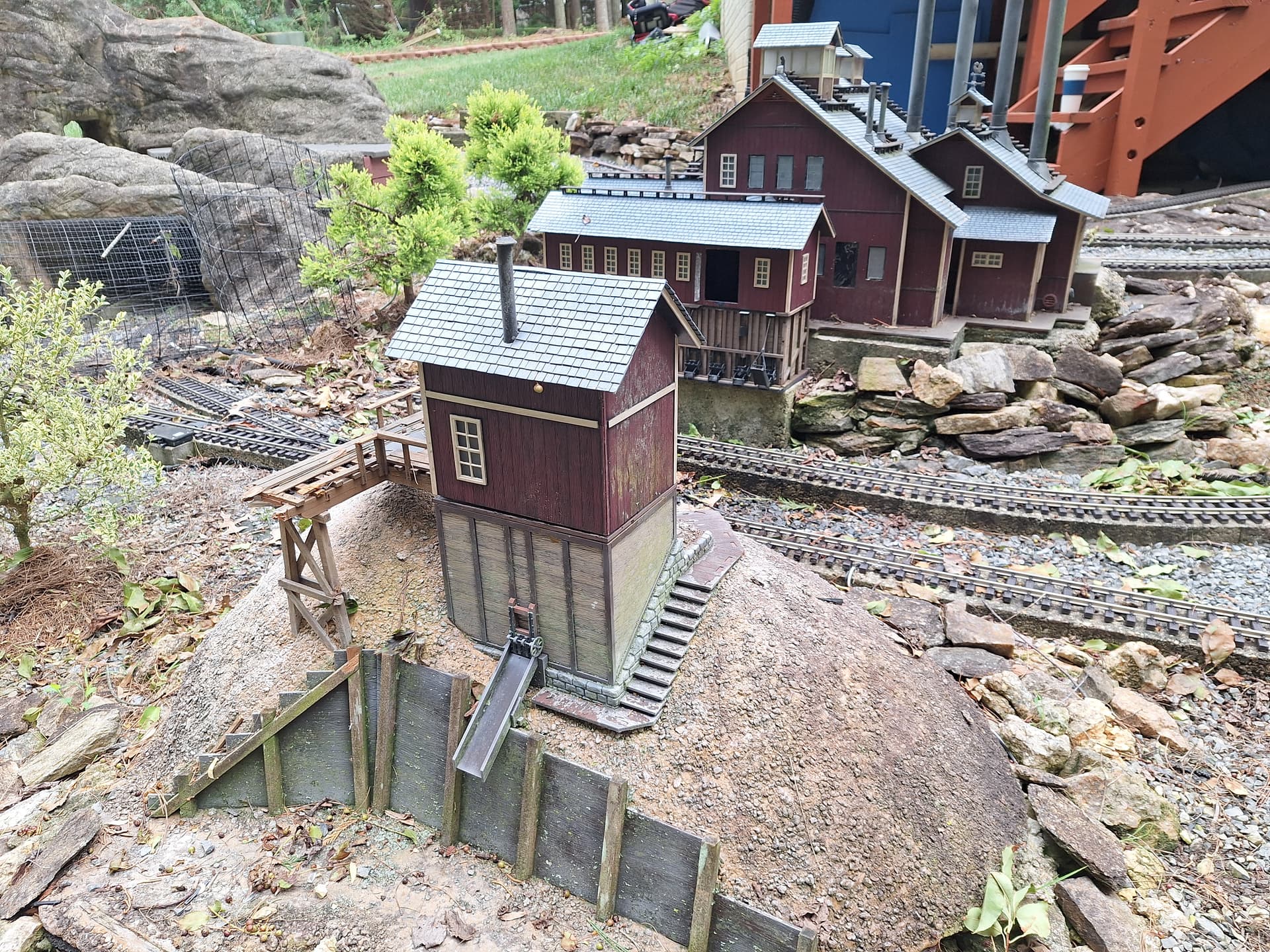

Mine:

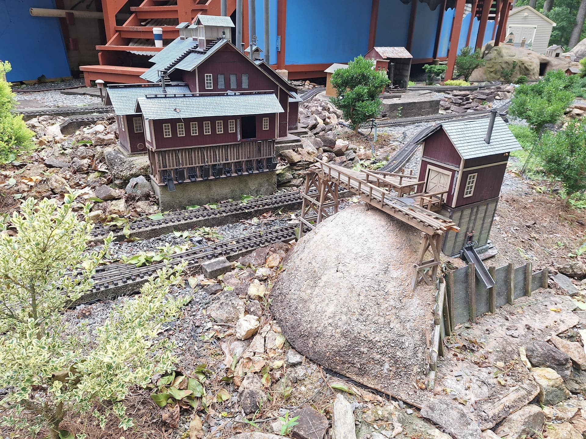

Structure ok; roof needed a small section re-glued. Door & window resin castings are ok but came unglued. I removed all the platforms & stairs (which are loose) for minor repairs. The trestle, wiring & animated doors got trashed, as did most of the ore chutes.
However, the chutes and a number of 3d printed details were done in PLA years ago, and were getting trashed on their own already, so need replacement.
When I replace the waste trestle, it’ll be non-functional and all plex. The wood parts weren’t doing too well anyway.

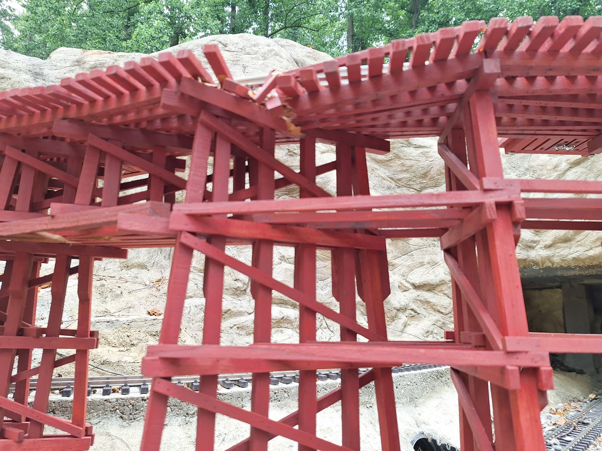

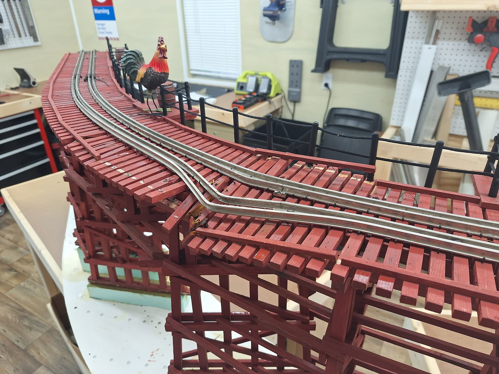

Trestle:

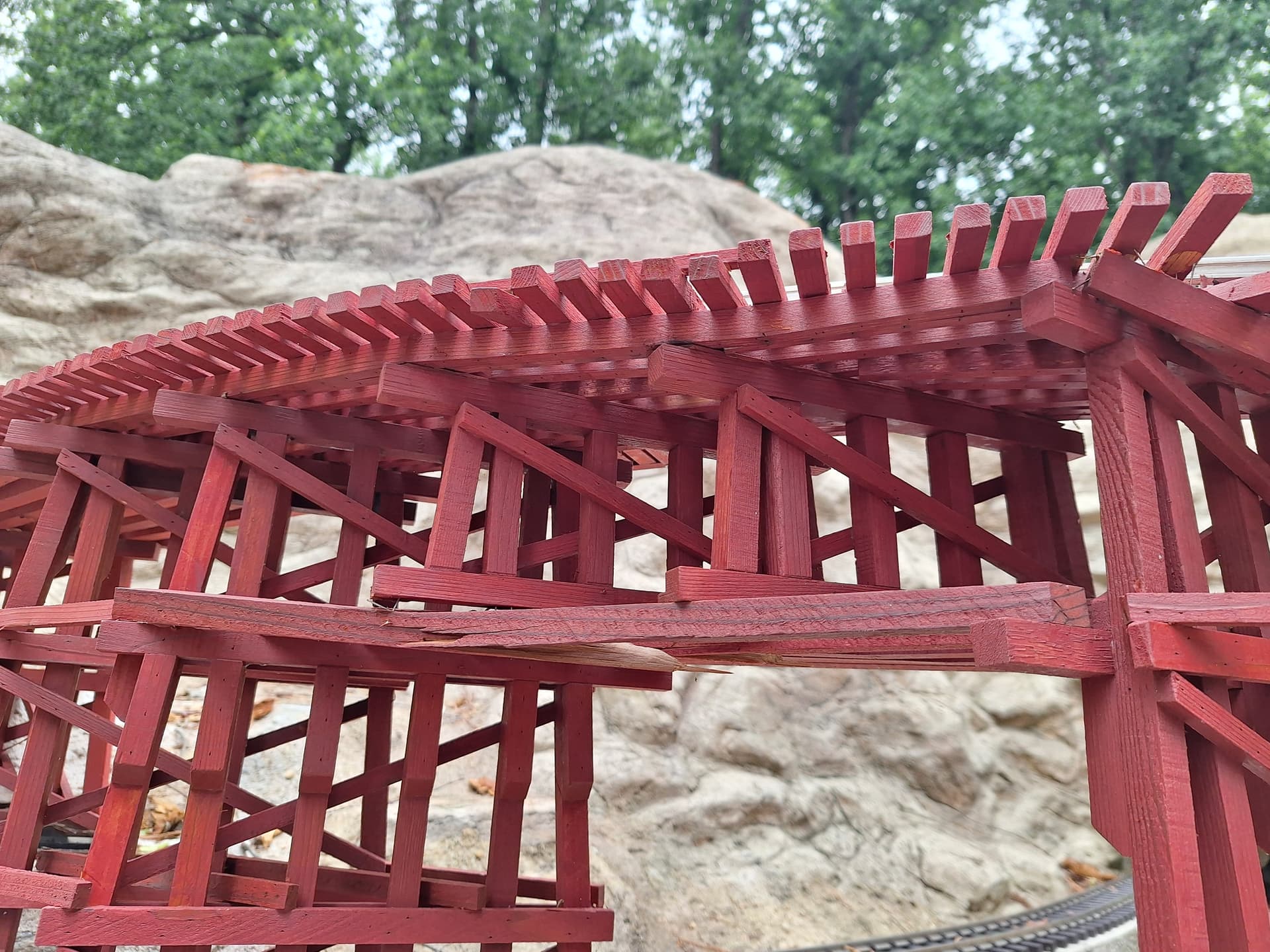

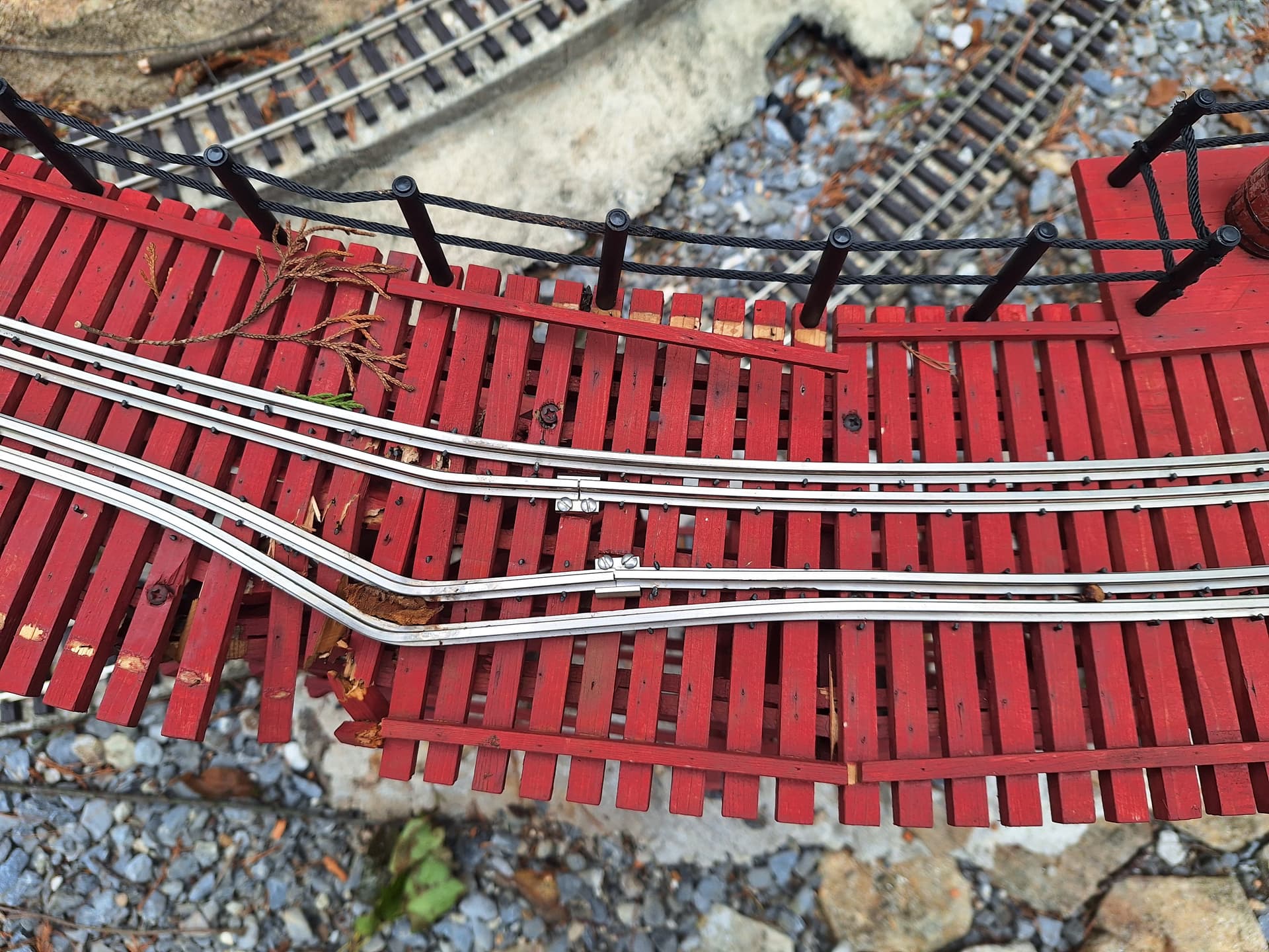

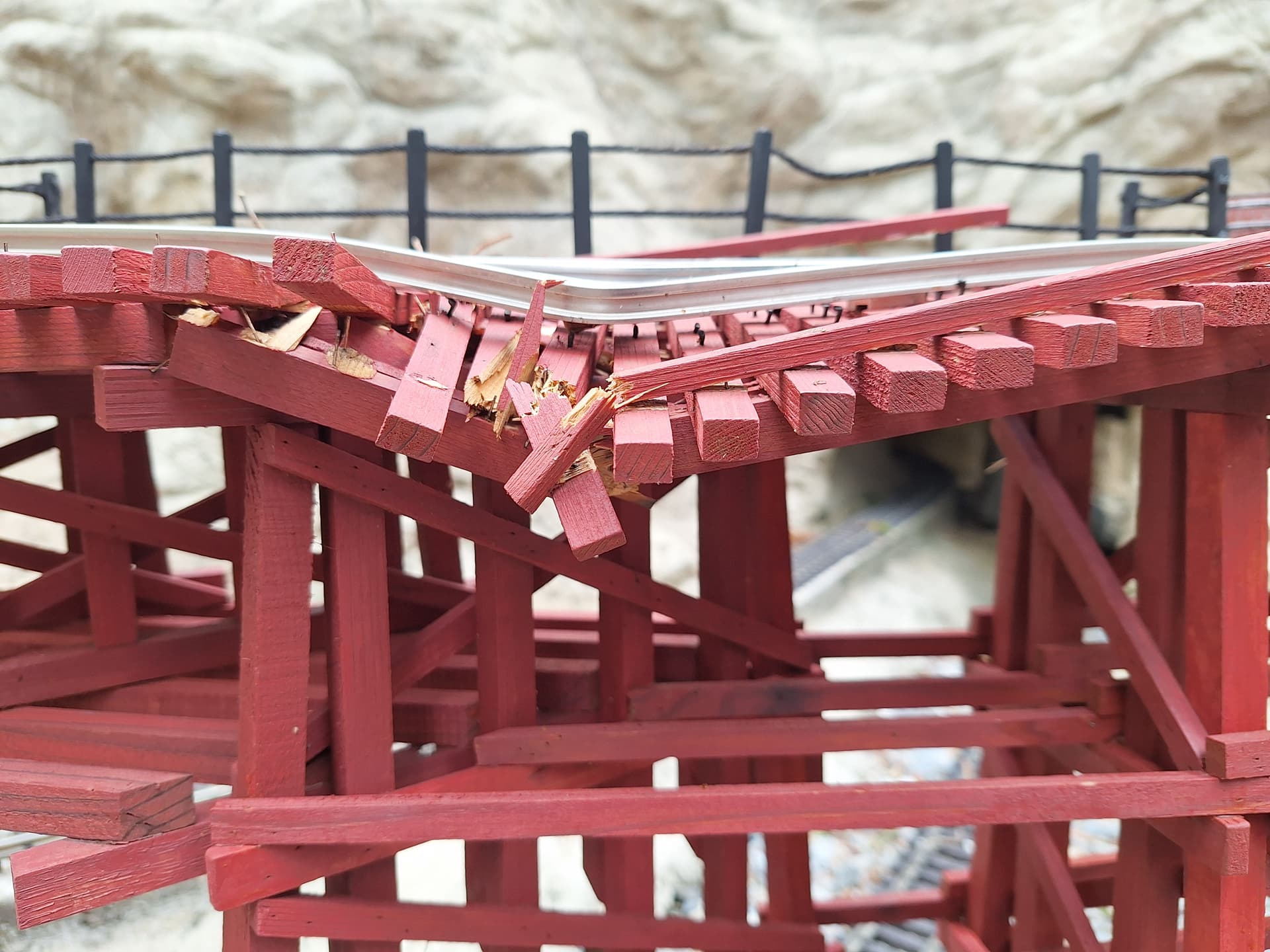

Beants all seem fine, and snapped back into position on their bases with a little nudging. About 2-3’ of rail, stringers and ties need repair. I’ll have to cut the rails and re-spike them after timber repairs.

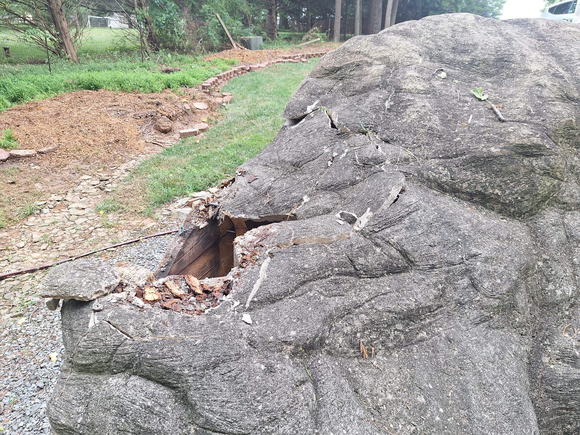

Mountain:

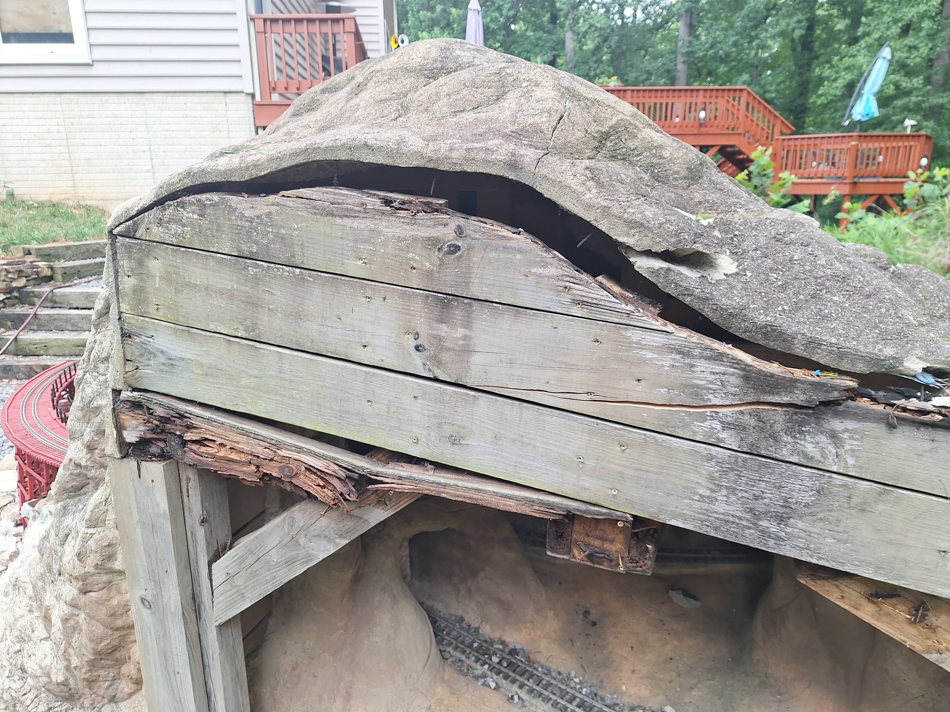

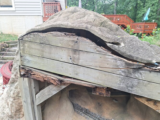

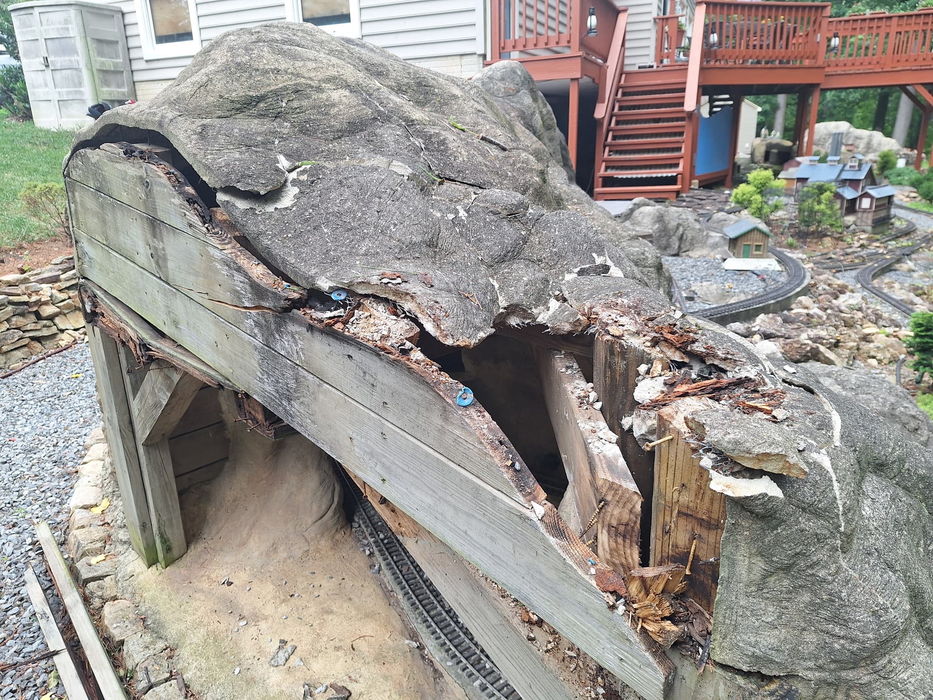

And area of about 3’ x 2’ broke and will need replacement. The facia for the cutaway scene was rotting already (treated 2-by’s suck…), and will get torn down. The posts are fine, as is the internal framing. Will probably re-work this opening to not have any exposed timbers, and look less chopped-off.

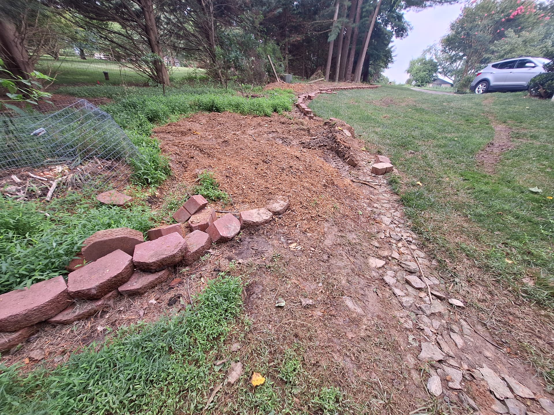

Need to repair the neighbor’s fence, re-lay a border strip of blocks, and rake out the dirt and chips resulting from stump grinding.

Thanks for reminding me, it survived fine!

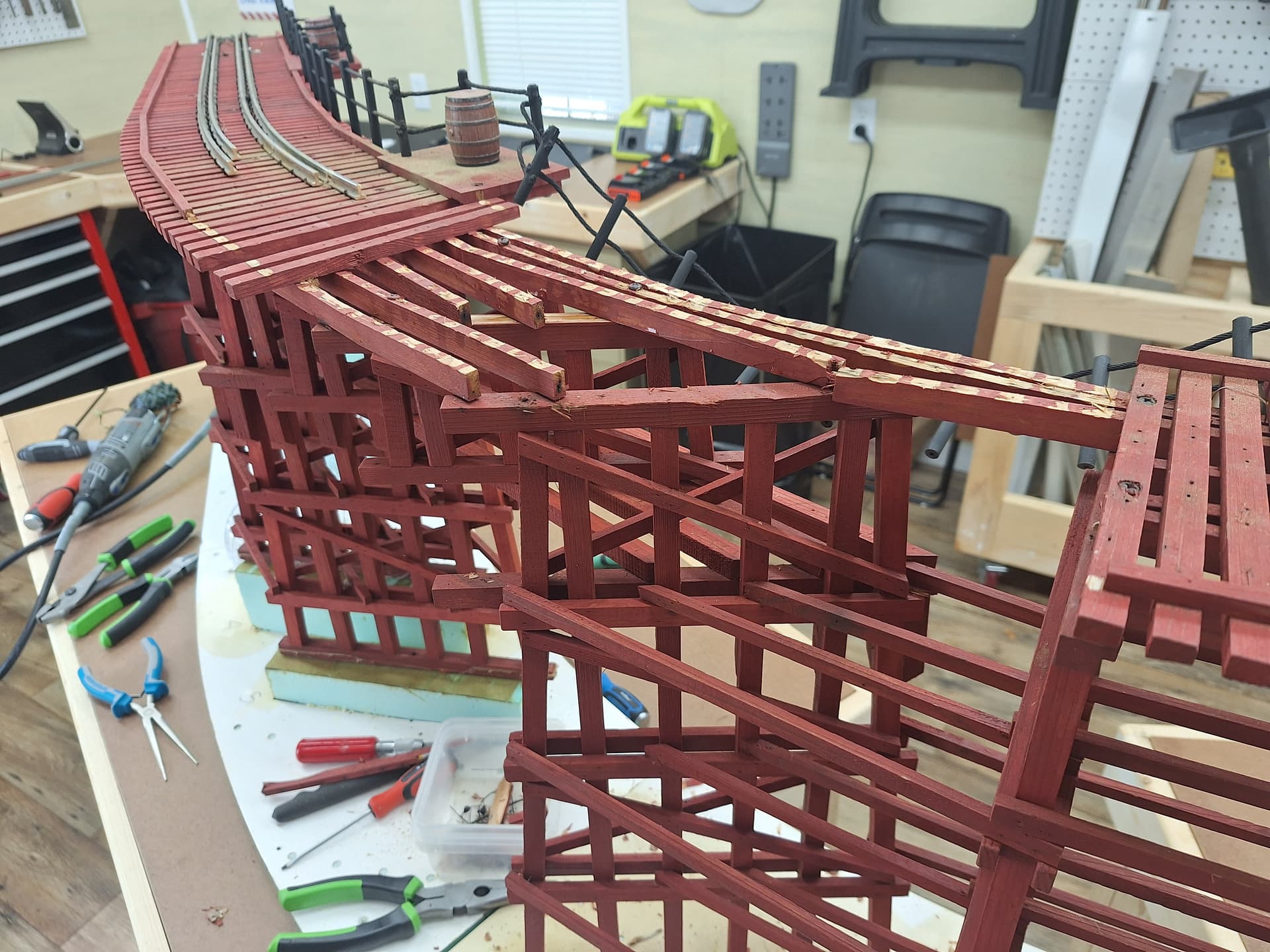

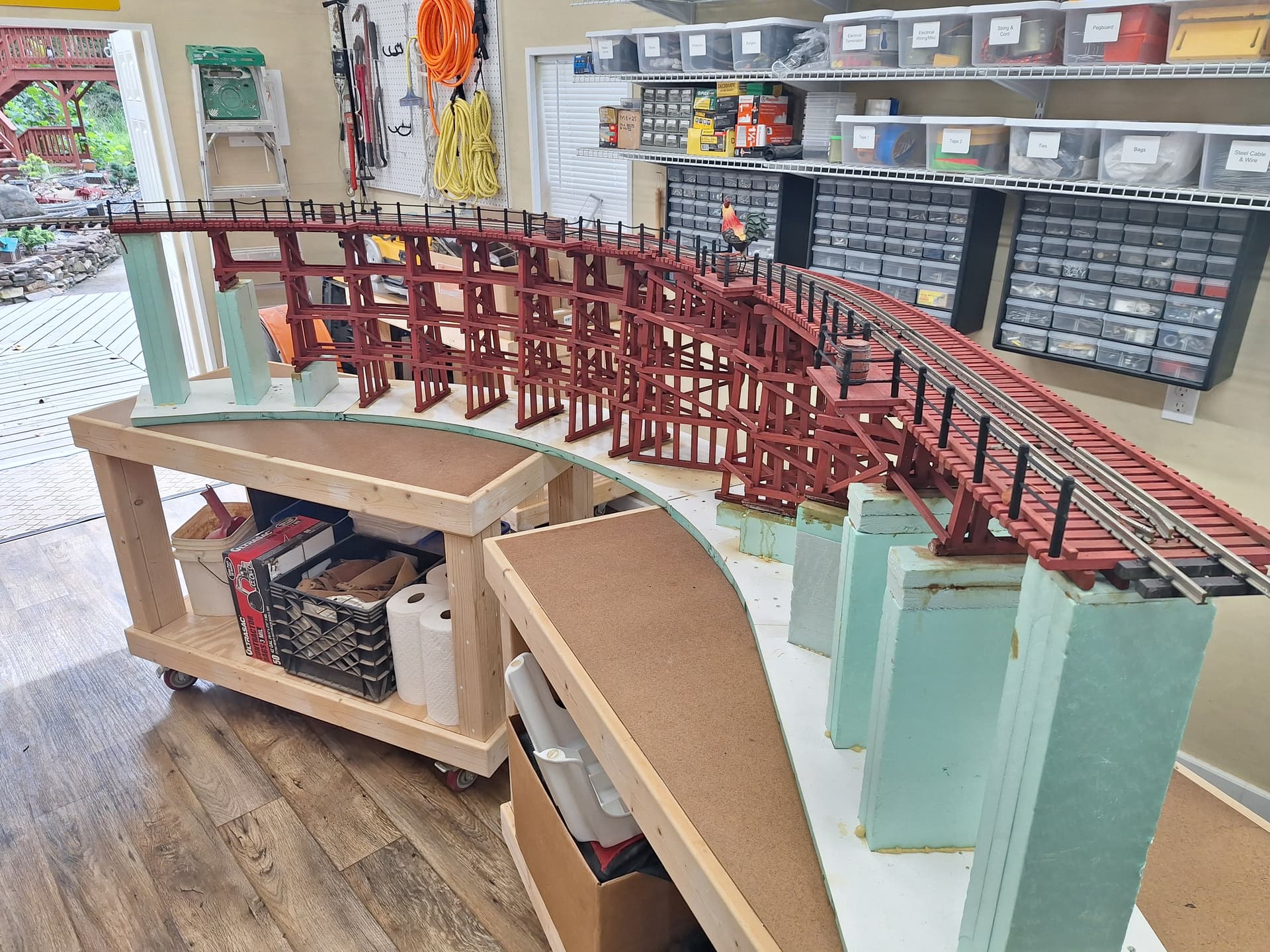

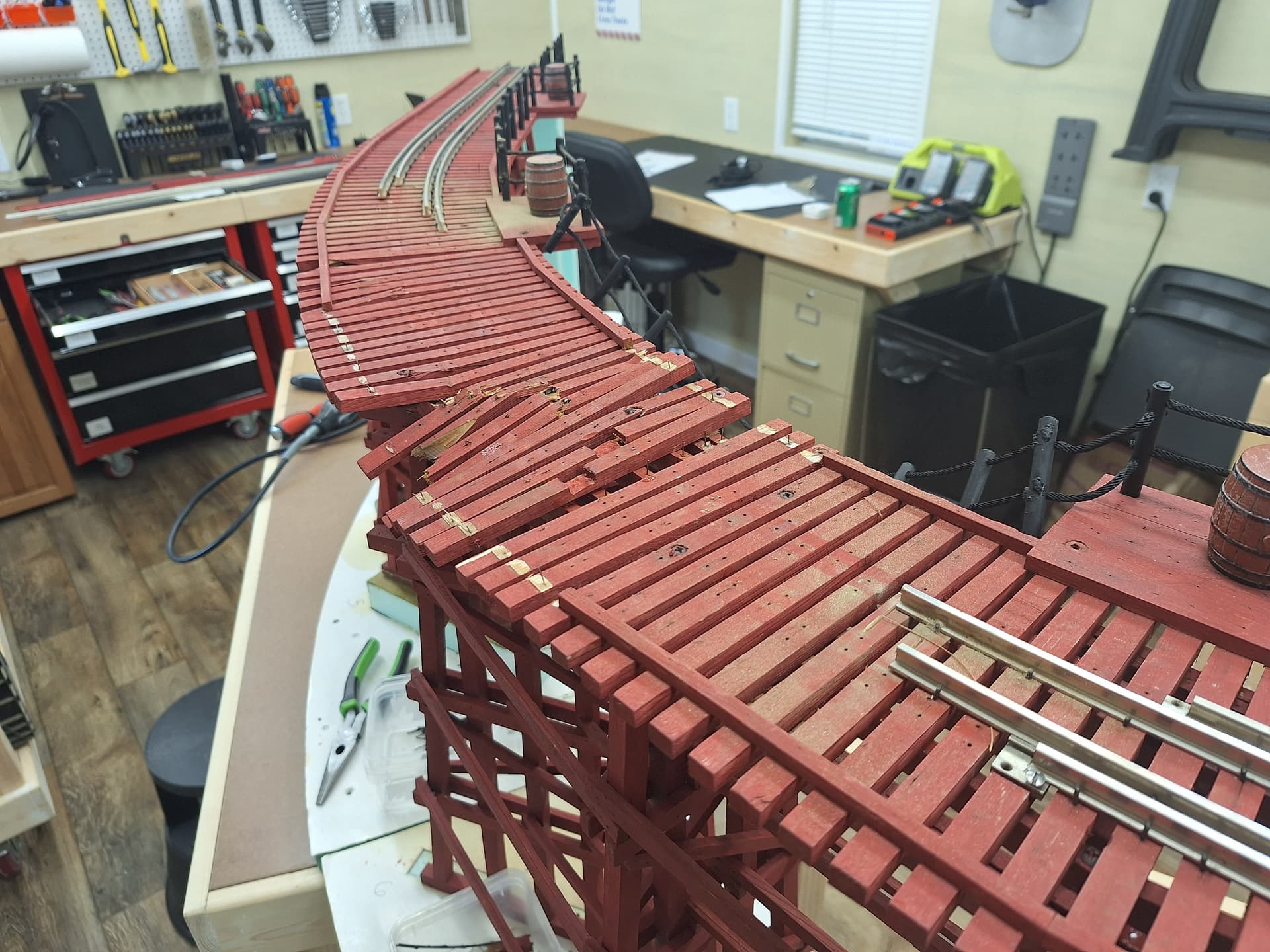

Finally got back to this. I cut and stained replacement timbers a couple days ago, and this morning got the thing into the shed. I was pleased with how easily the trestle came away from its piers.
And I’m VERY glad I kept the foam supports!
Now for debridement…

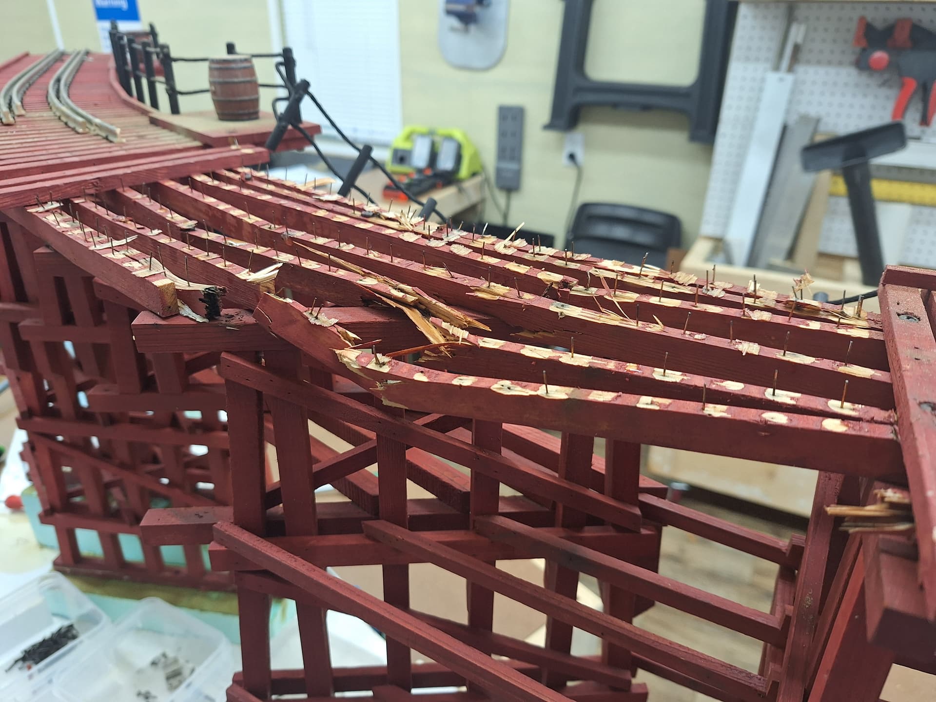

Damaged rails amputated…

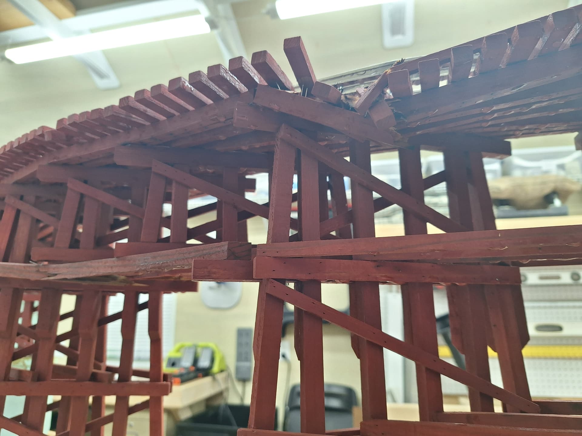

Broken ties extracted…
Broken stringers excised, remaining ones de-nailed and scraped…
Debridement complete; doctor and patient still appear alive. :sweat_smile:

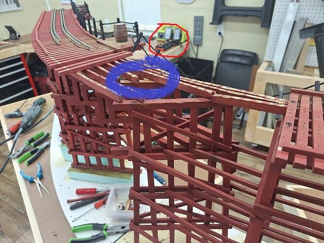

Cliff Trestle - Copy
So with the blue circle it looks like someone missed coating the top of that bent so you need to fire them!
Now with the red circle it appears that someone is ready for an all nighter.
Carry on!
