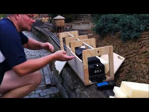

This video shows a type that was also used by Jack Thompson, and I’m sure we can find his pics, as he’s still responding to emails.
