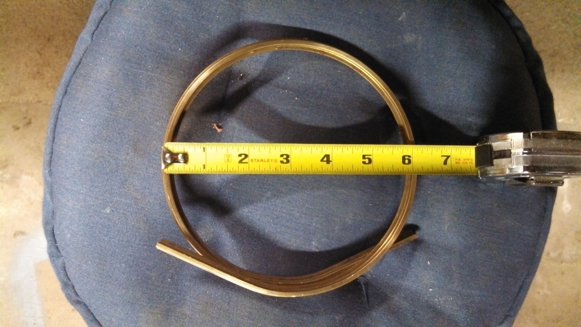

(http://i73.photobucket.com/albums/i231/paintjockey/IMG_20140308_142639_451_zps89a0f958.jpg)
Train-li dual bender closed all the way will do a 6" diameter circle. That’s LGB 332 brass. The draw back is the ends, it leaves about a 3" tail that can’t be bent. This piece of brass was about 24" long. Oh and the beauty of it is I bent it back straight when I was done! Although I think any bender could do that. All in all about 10 minutes of work.
Terry
