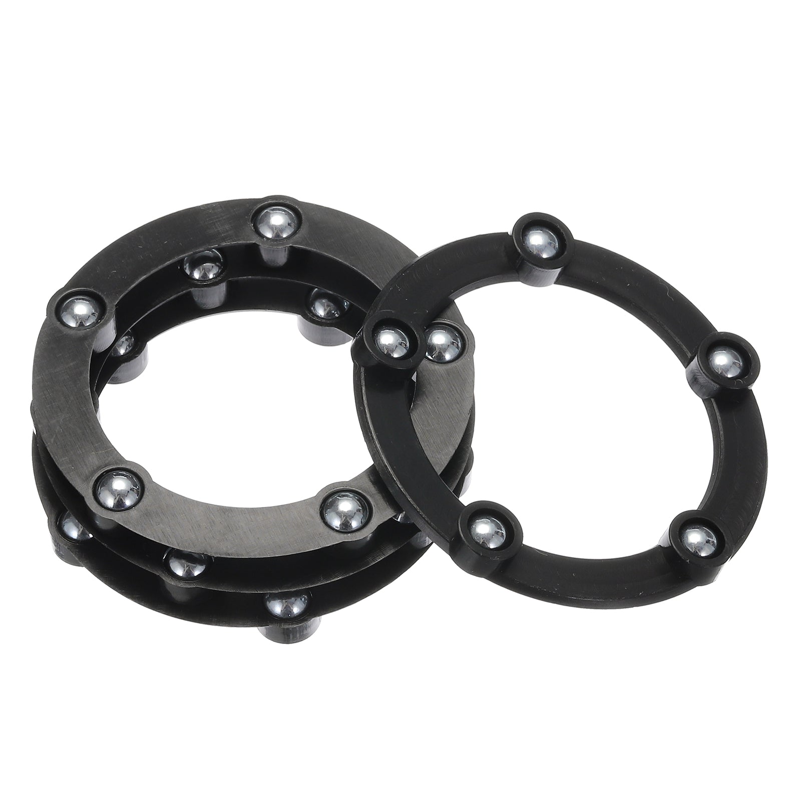

Is the drop due to the need of having the connectors loose to navigate around the curves? I wonder if a tight Lazy Susan approach might work? It might help keep the car from leaning into the curve.
All connectors are tightened then loosened just enough to allow for an easy swing.
In the first photo I just posted you will see a large washer that is keeping the rear of the lifting arm from lifting up but I do not think it is needed.
Where do you think the lazy susans would go?

To accomplish this I would cut between the red and black, then in-line with the yellow stripe on both lift arms. With those sections removed use the swivels Bill showed to re-secure the cut off areas back to the lift arms. By relocating the swivel point the arms will stay more in line with the track and the load will stay more in line with the car thus limiting some of that drastic over hang. You have to compensate for the unrealistic curves we all have to deal with.
