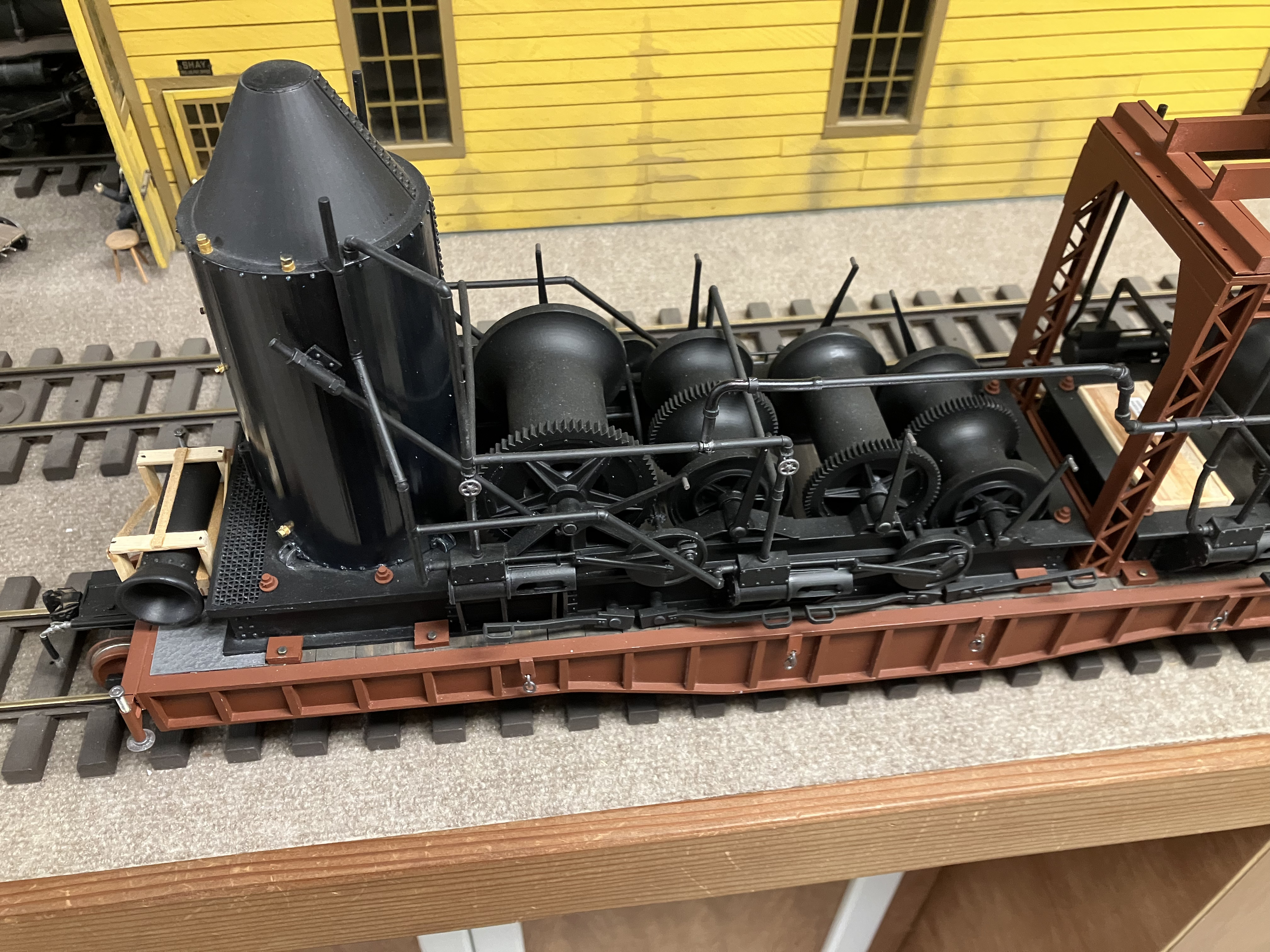

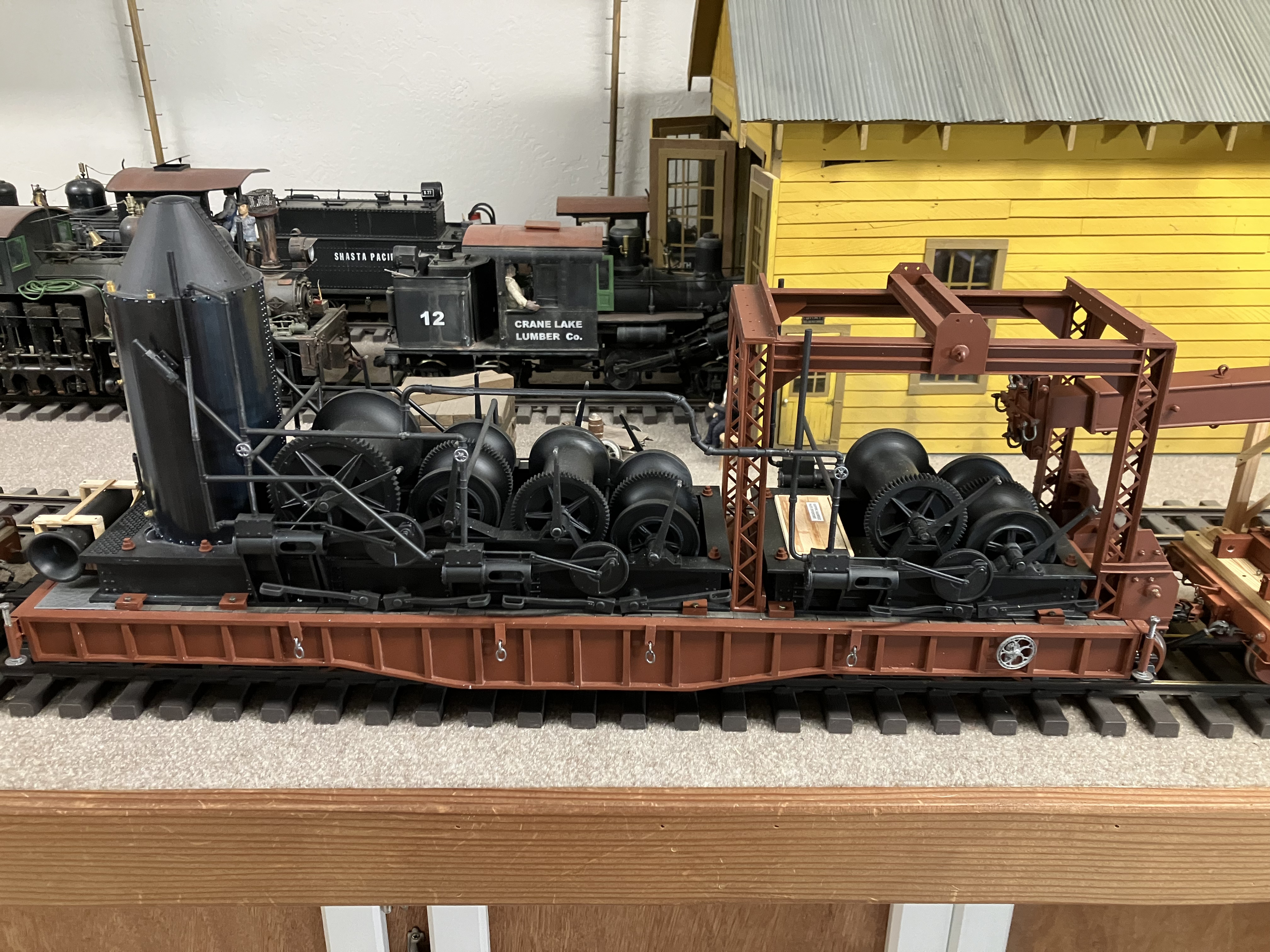

I built a much smaller and very generic version of the Tower Skidder shown above.
My intent was to show it arriving brand new from the factory on it’s cars with all major components.
The donkey engines and boiler mounted on the heavy flat car. when in service the the stabilizers are extended and the car jacked and cribbed and the trucks removed so that the empty log cars can pass under. Everything but the donkeys was scratch built from mostly wood, Styrene, and metal.
The tender car carrying fuel oil and water for the boiler. When in service it would be spotted on a parallel track and the water, fuel and steam lines would be connected. All scratch built from the same materials as above.

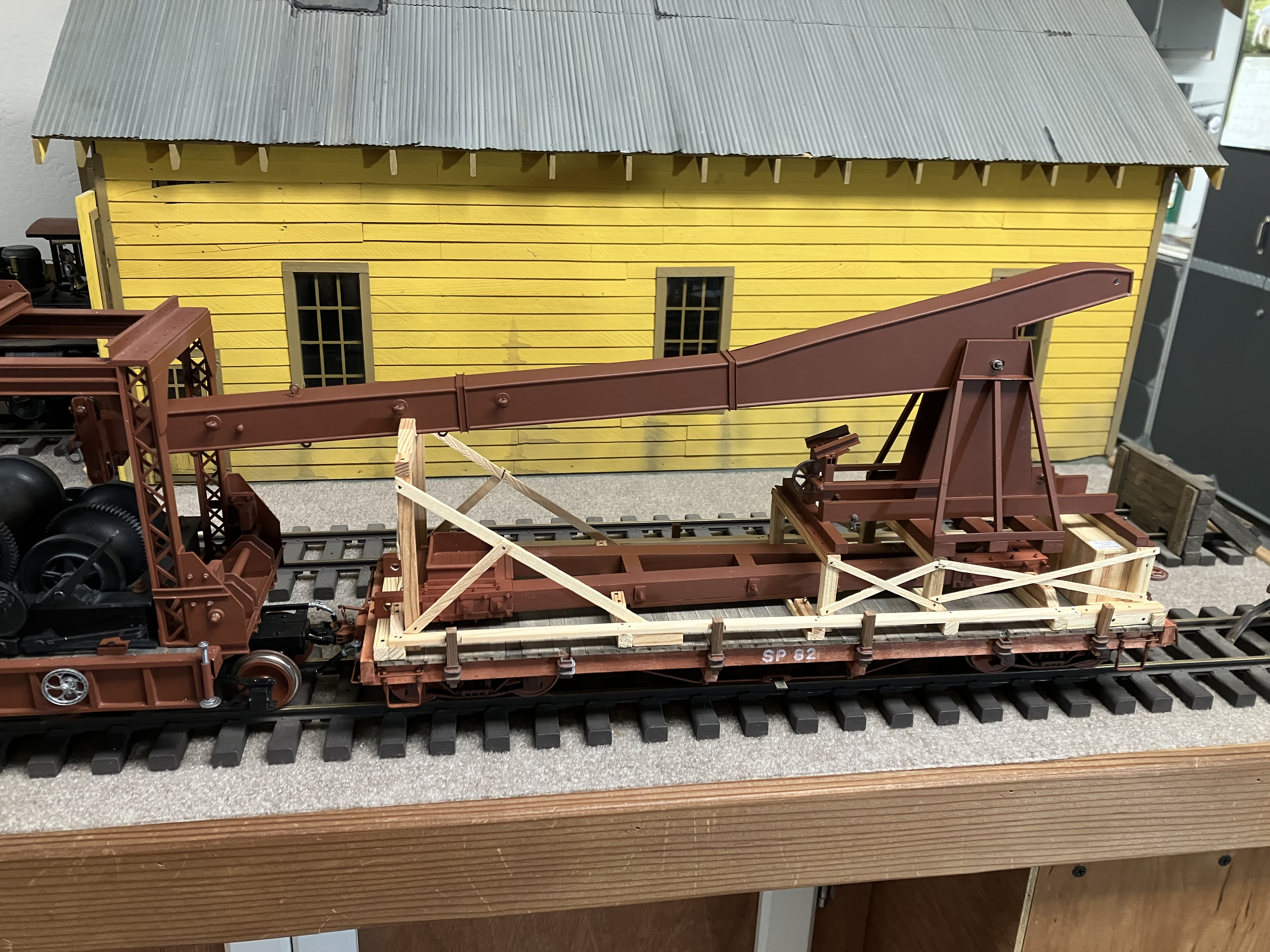

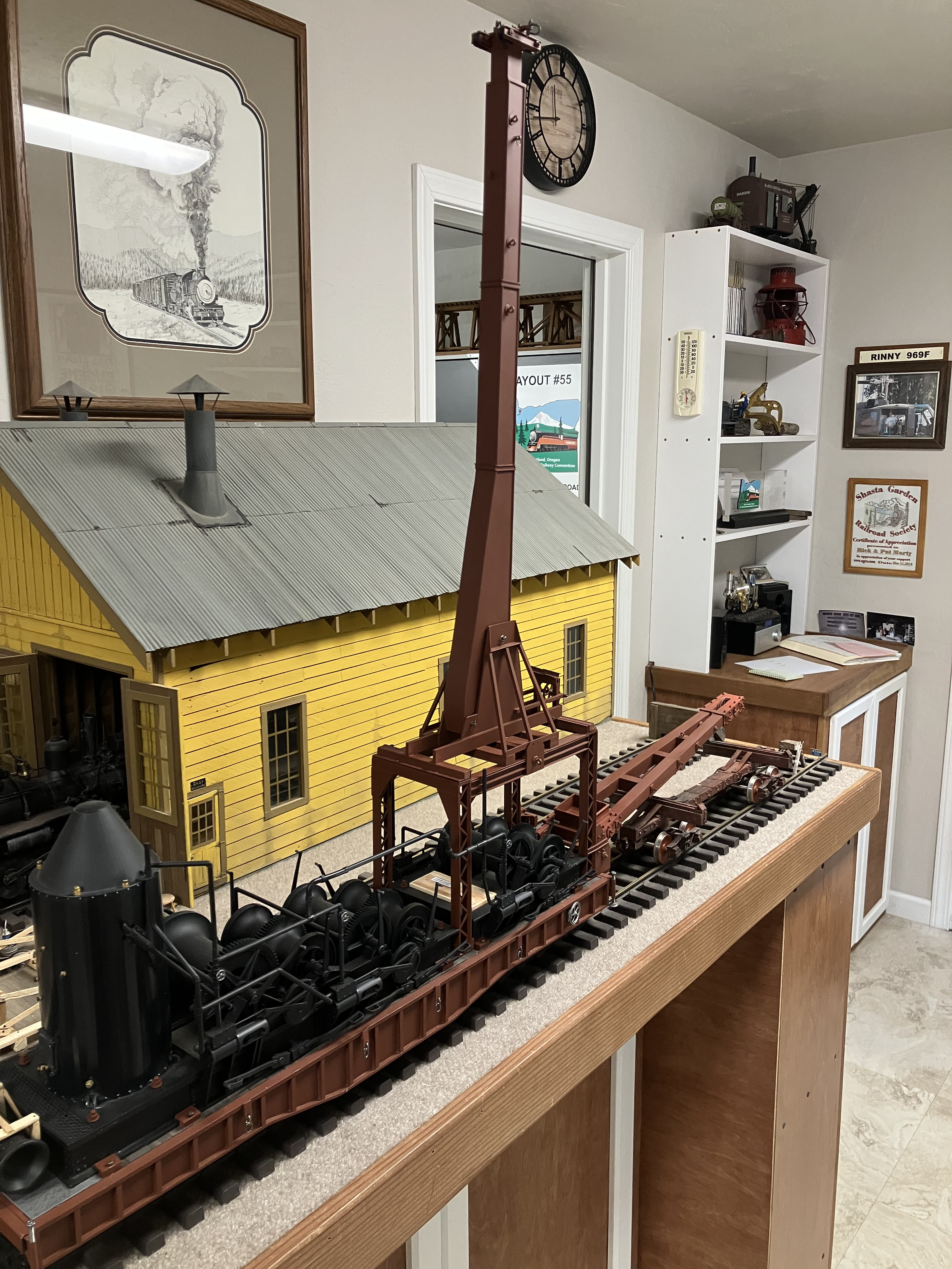

The flat car carrying the boom, tower base, tower and crates of small parts. The flat car is a Phil Dipple kit from years ago all other parts are scratch built.
Think of the transportation logistics involved to get this equipment from the factory to the woods.
It was built for a narrow gauge railroad but had to ship on standard gauge lines to the transfer point.
The donkey flat and the tender flat had to be mounted on standard gauge trucks and the narrow gauge trucks shipped on a separate car. The boom and tower equipment had to transfer to a narrow gauge car at the transfer point and the trucks had to be changed under the other two cars.
Now it was ready for the trip into the logging woods where it would take a week to set it up for operation.

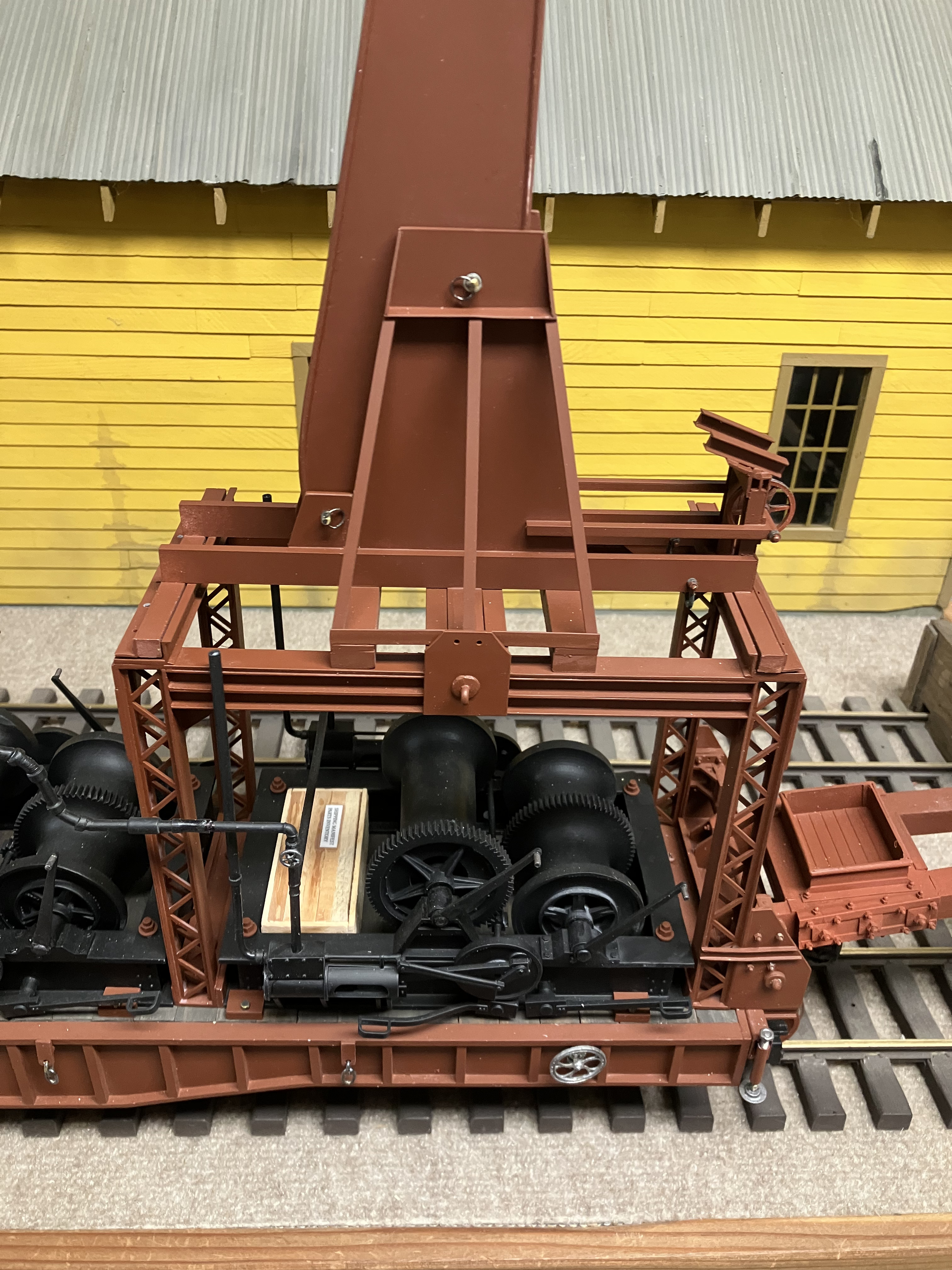

The tower and boom in operating positions just for reference.
A couple of close ups of the donkeys.
