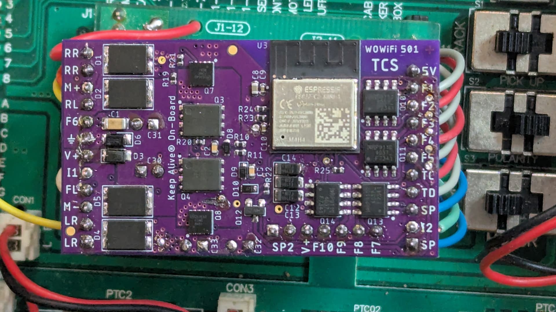

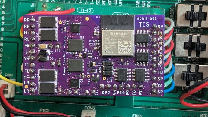

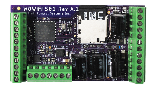

Below is a photo of the decoder backside. Note that the pin layout and size is such that if TCS desires they can easily release a version with pins instead of screw terminals that directly plug into a Bachmann locomotive that has a socket.
