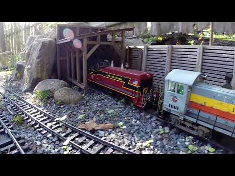

The MOW cleans up for Track Power
In this video the MOW crew is out and about and cleaning up the track for the track powered trains.
They use the Rail Sweeper rig that has a tank on it that is filled with soapy water and that drips through a T bar and on to a roller that wets the track and loosens the grime. The Dryer car follows along and uses a piece of face cloth to wipe the rail.
In this video the mainline is done and the crew concentrates on the Bypass, the Mountain route and the Reverse Loop. Happy RRing!
