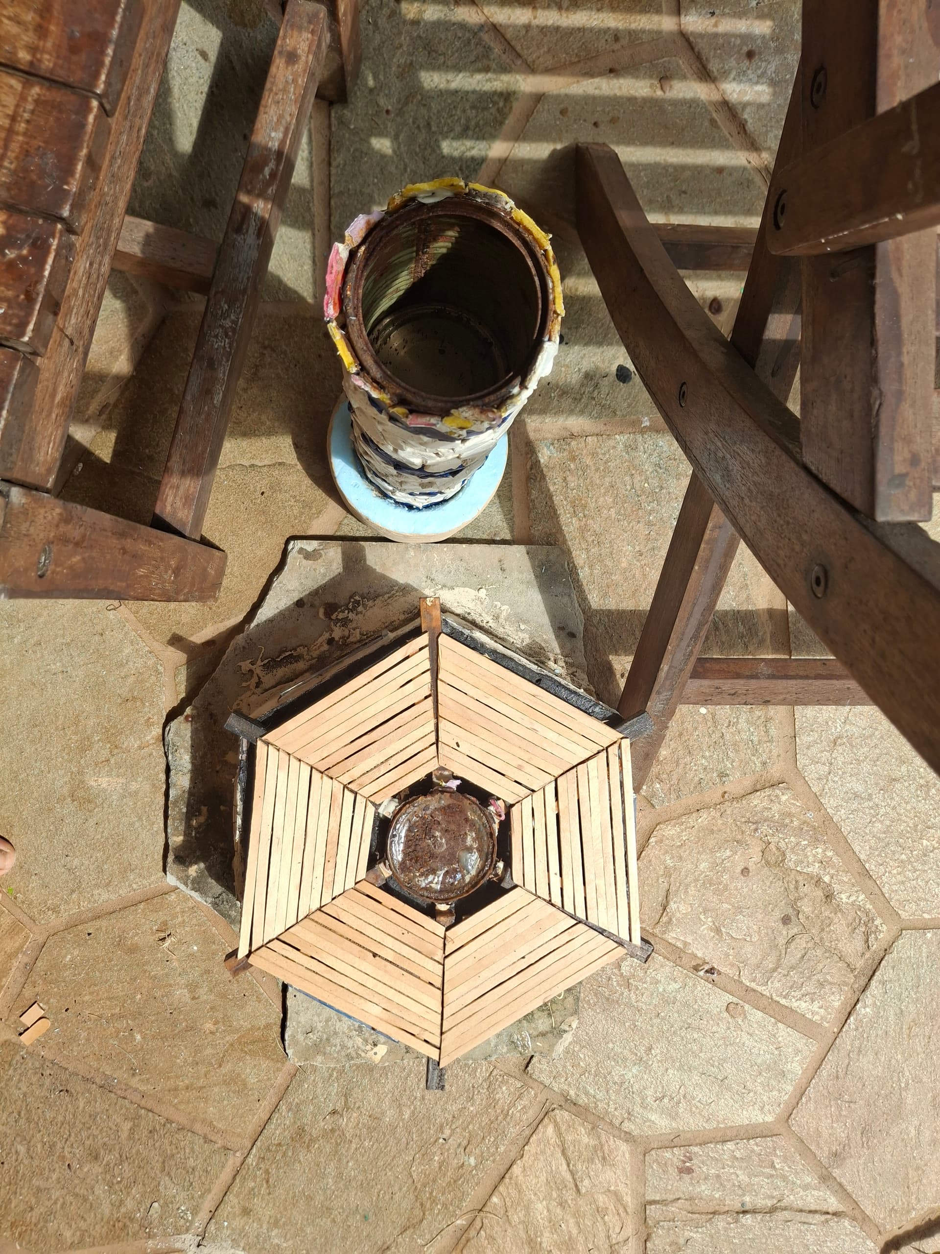

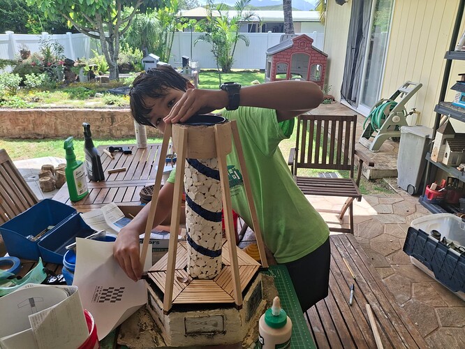

We finally got around to this project. I had stained all the “decking” earlier this week. Kid-zilla helped trim away some framing…
…and, after he left for the movies, the 1:24 gang arrived to shape it and hammer it in place.
I will note that Kid-zilla called me out for not wearing safety goggles! Good for him! Shortly after he left, the cutting disc broke free and shot across the lanai!
Meanwhile, I am again learning a lesson about building to common angles and sizes. The decking needs to carefully match so that errors don’t propagate from “pie piece” to “pie piece.” Basically, each deck needs to be laid down, marked, and cut so that it comes at least close to abutting the neighboring bit of decking and still has enough slack on the other side to be glued to the roof beams. Someday I will learn to accurately use a ruler…perhaps when I start a new - rather than rebuild an old - building!

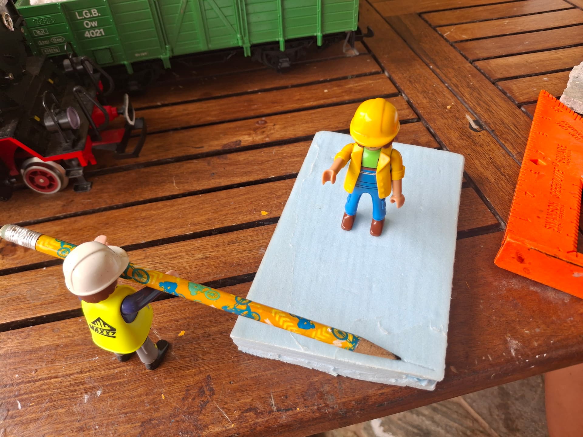

My power supply for my foam cutter arrived, so the light cupola is next.

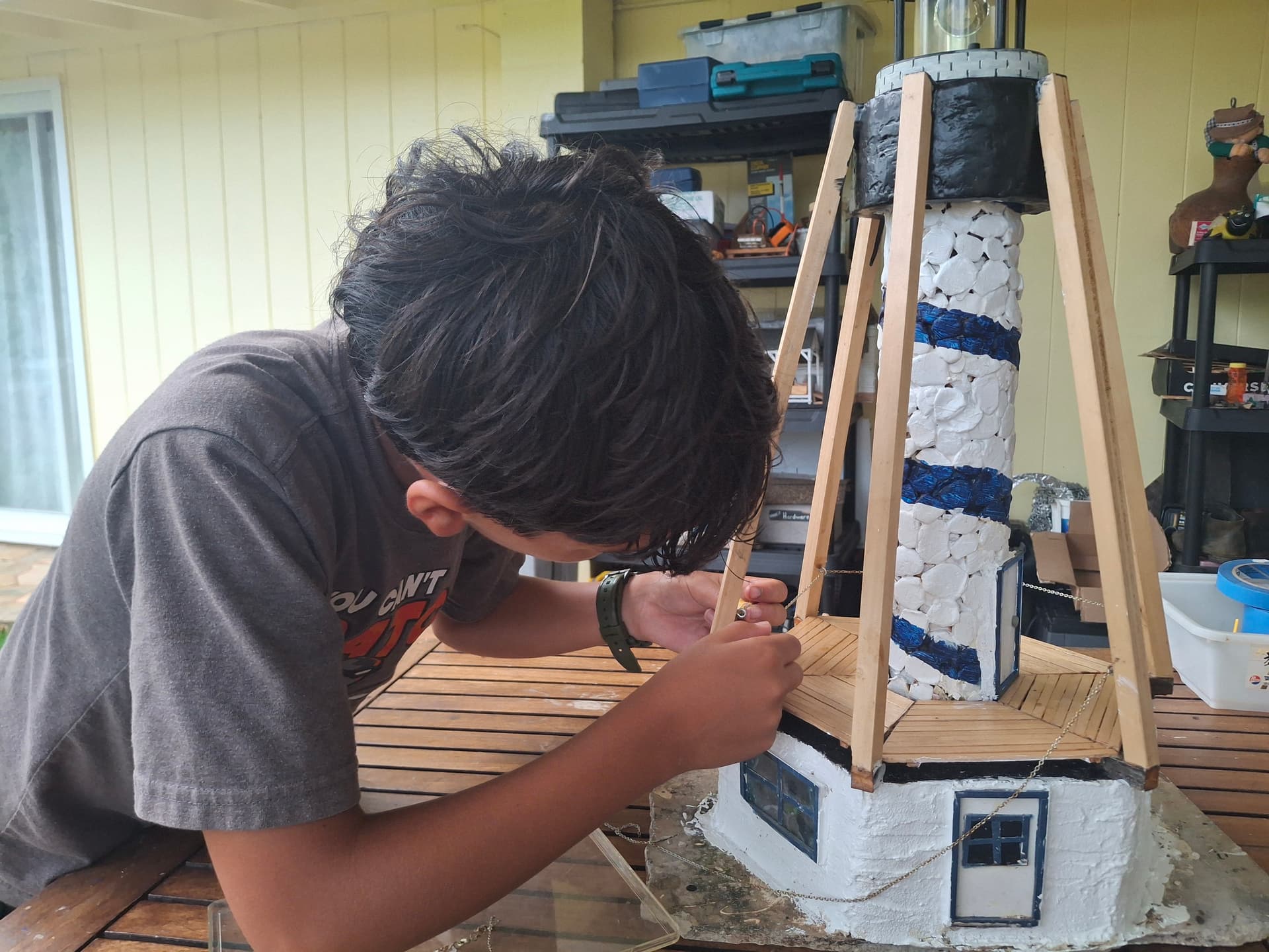

Update:
I finally got around to this project again. Kid-zilla cut and glued the new light holder:
Later, the 1:24 gang helped shape this with some sanding.
I remembered @VicSmith had tried to use woodfiller on his Vic’s 2026 Mik Challenge Darjeeling Streamliner and found it less than satisfactory, but I had some on hand that was in danger of drying out, so I gave it a try:
The results are good enough, per Oldest Daughter.
I agree, so we’ll move on. Next, we have to bore out a hole to snug this over the tower and then fit the basswood support timbers. The cupola will get a coat of black latex paint, too, to seal it all in.
Creeping along…

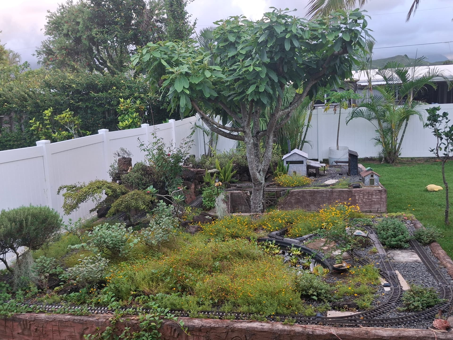

The rains have made it a struggle to keep the plants back and trains running…
…and last weekend was the first all year we had the road up and running in full! MOW always takes priority over projects!

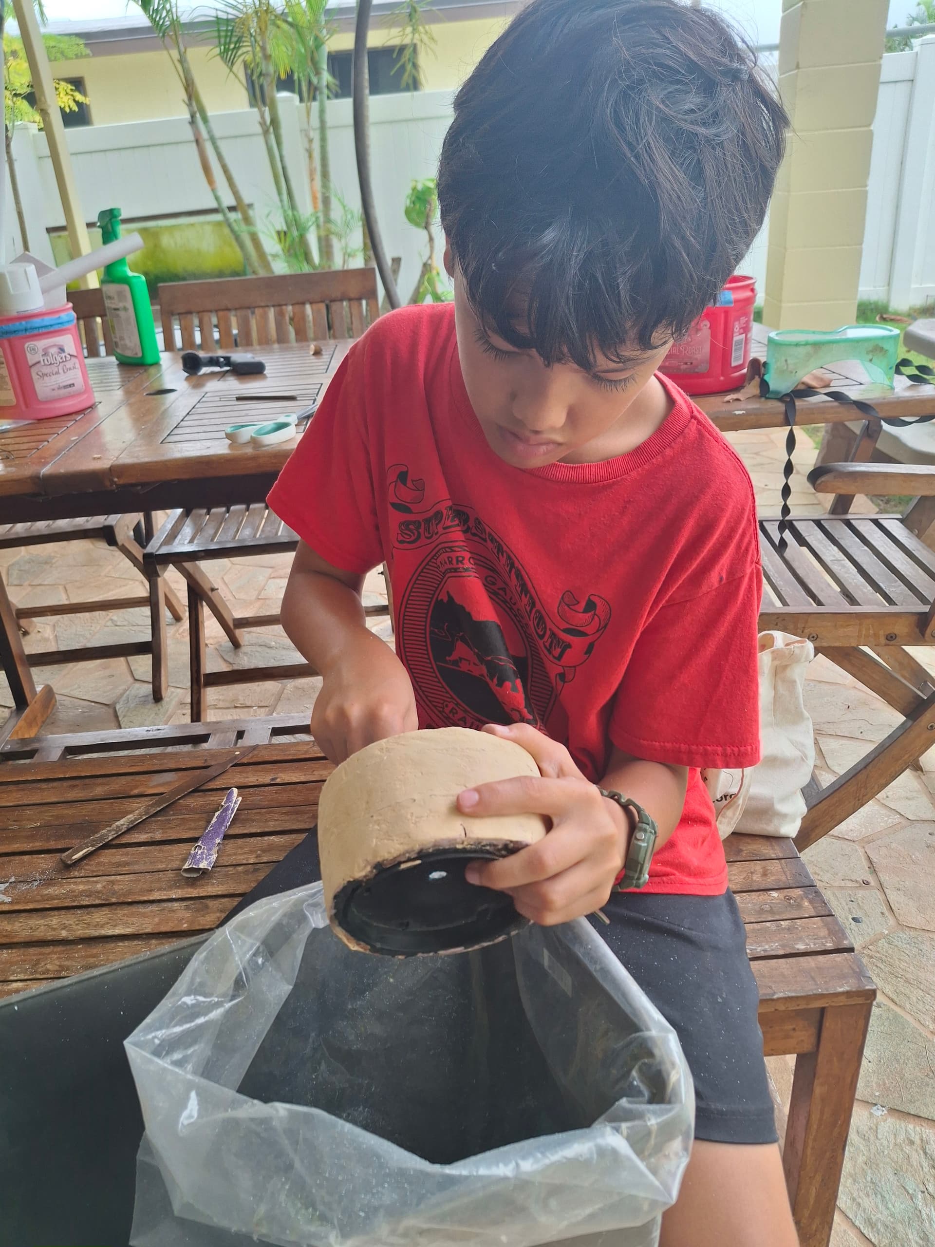

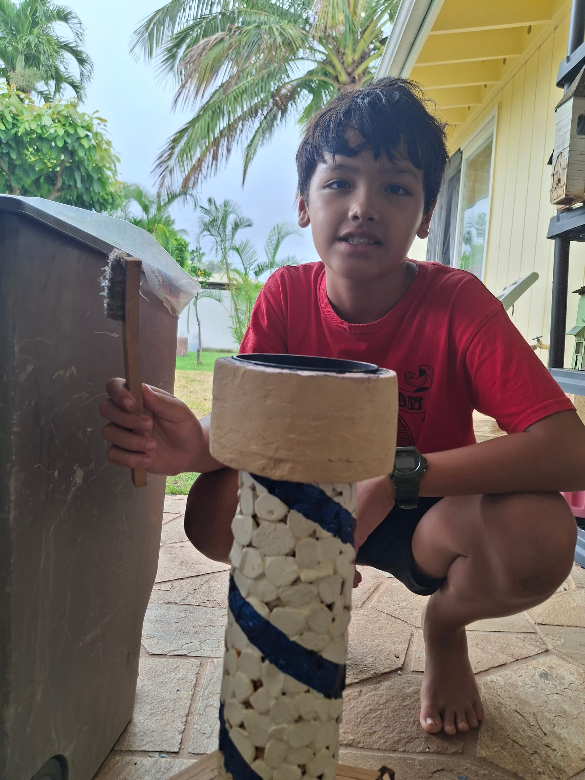

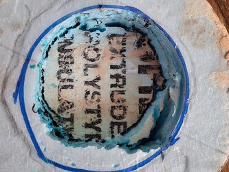

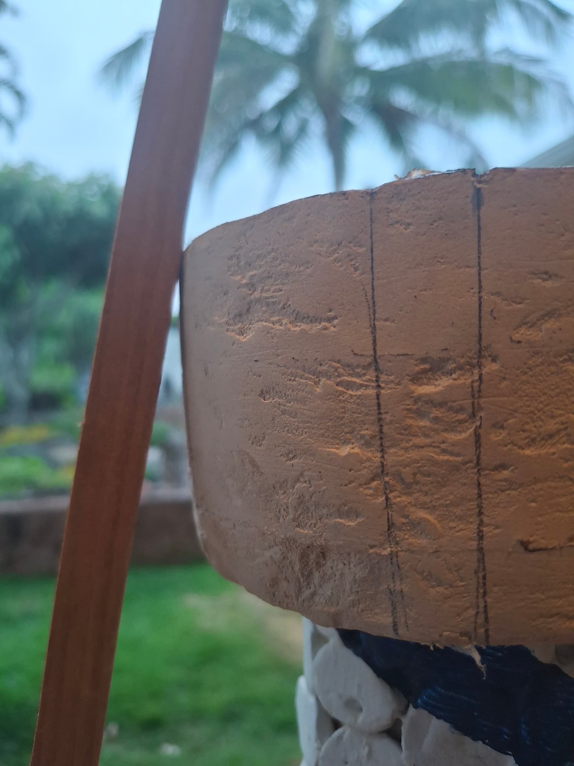

Excuses aside, Kid-zilla lent-to to hollow out the pedestal for the light, using a hot knife to make the cut.
Interestingly, the TiteBond III, as you can see in the picture on the right, was still wet in the central part of the pedestal!
We then took turns, alternating between MOW and sanding, to shape and fit the pedestal on the tower.
That’s when disaster struck, and the cans gave way…AGAIN!
We tried to support this with construction adhesive, but it is far from secure, bringing us to Question #1:

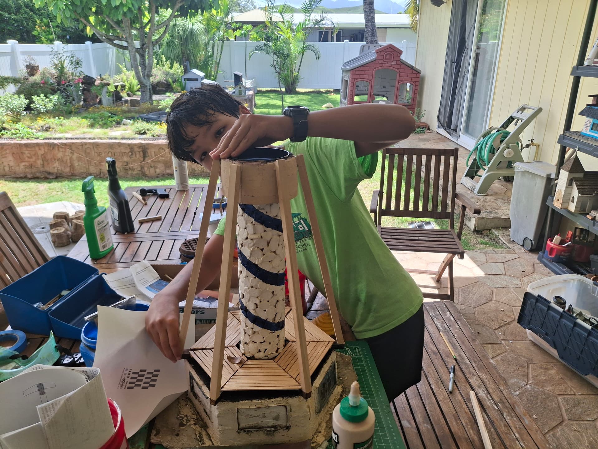

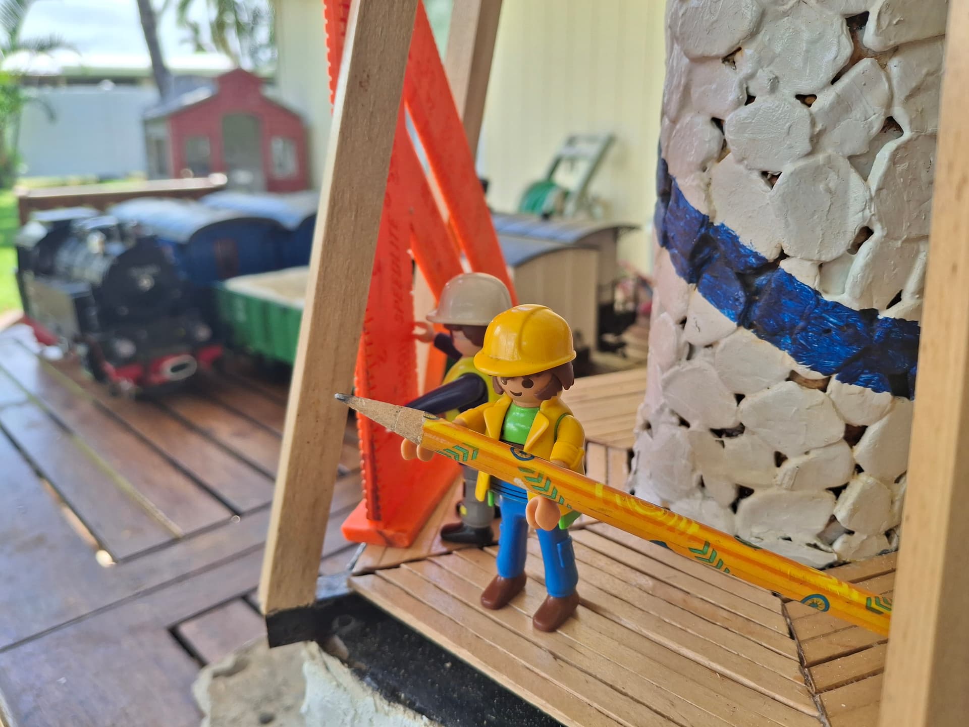

Today, O.D. took a crack at mounting the support beams, which, do the aforementioned breakage, will now be more than cosmetic! She lined things up and prepared to cut into the pedestal…
…when we both decided we’d better think this through. That brings us to Question #2:
  • Should we cut into the pedestal, forming a notch for the support beams to fit, or should we create a wedge or use a few timber braces and run the beam to the top along the outside?
We like the looks of the latter idea, but, Question #3:
  • How would we make that wedge?
Light was failing, dinner was ready, and, at O.D.'s suggestion, we decided to sleep on it and see if the community had some suggestions.
Updates as Progress Merits!

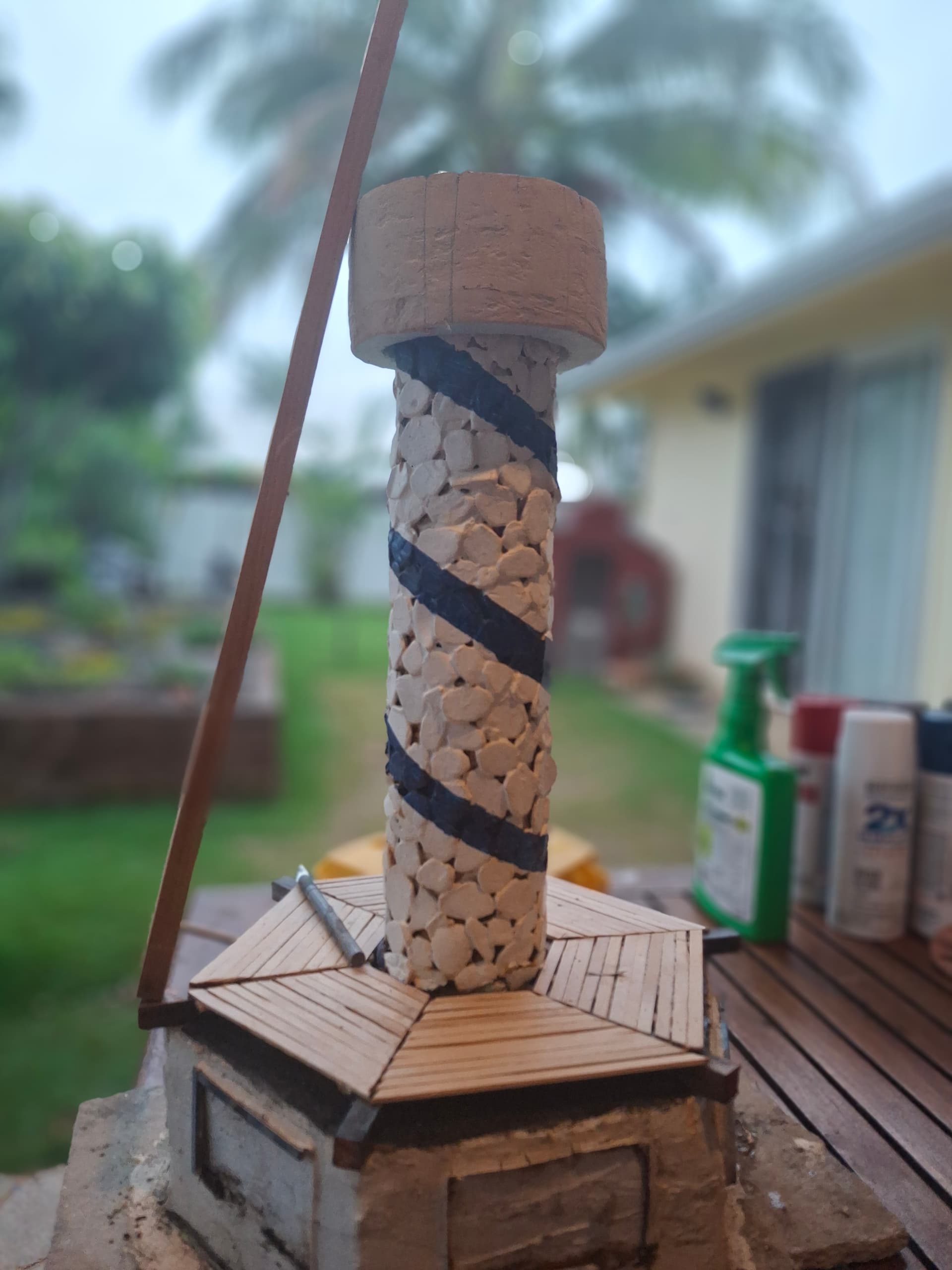

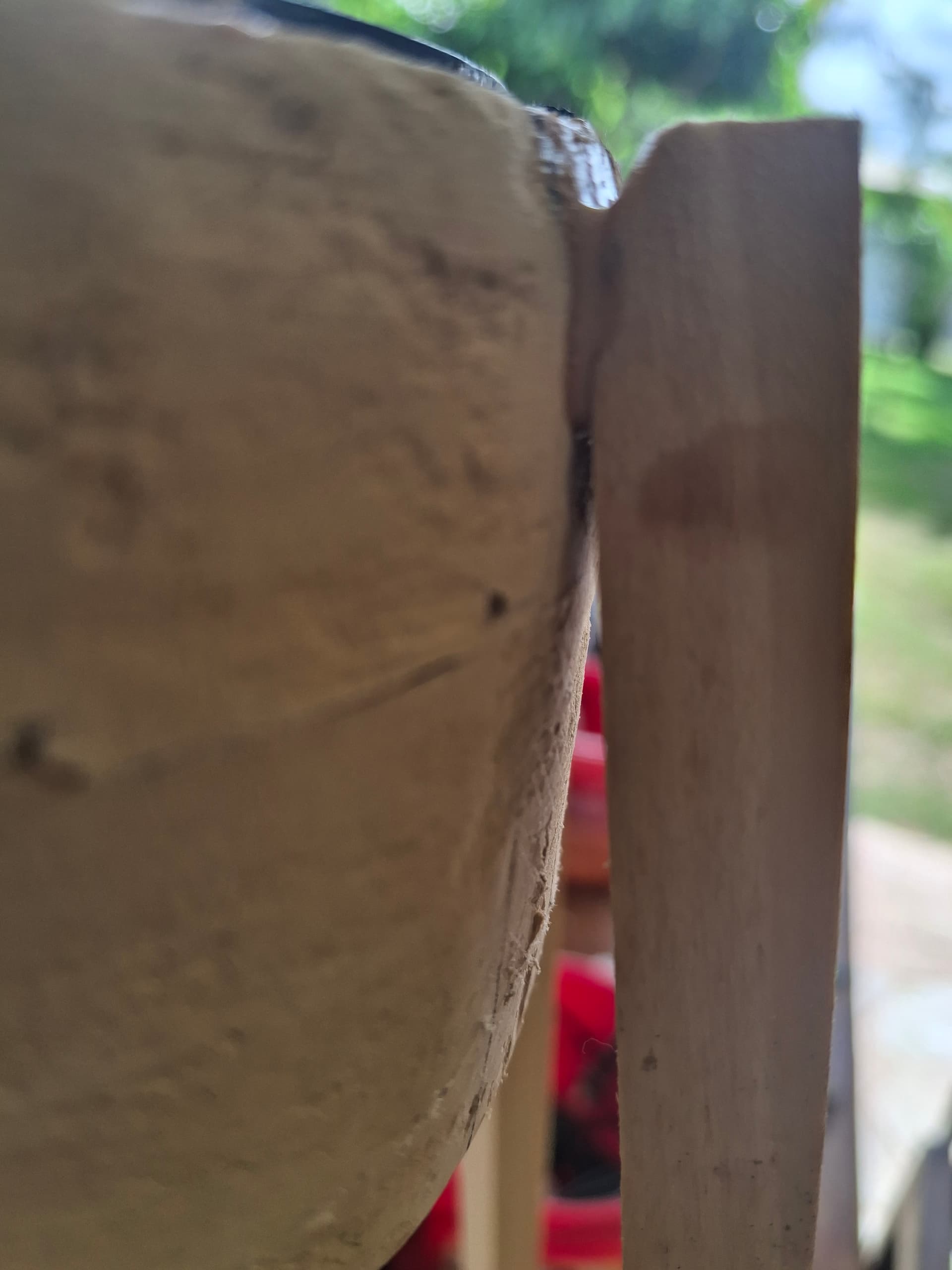

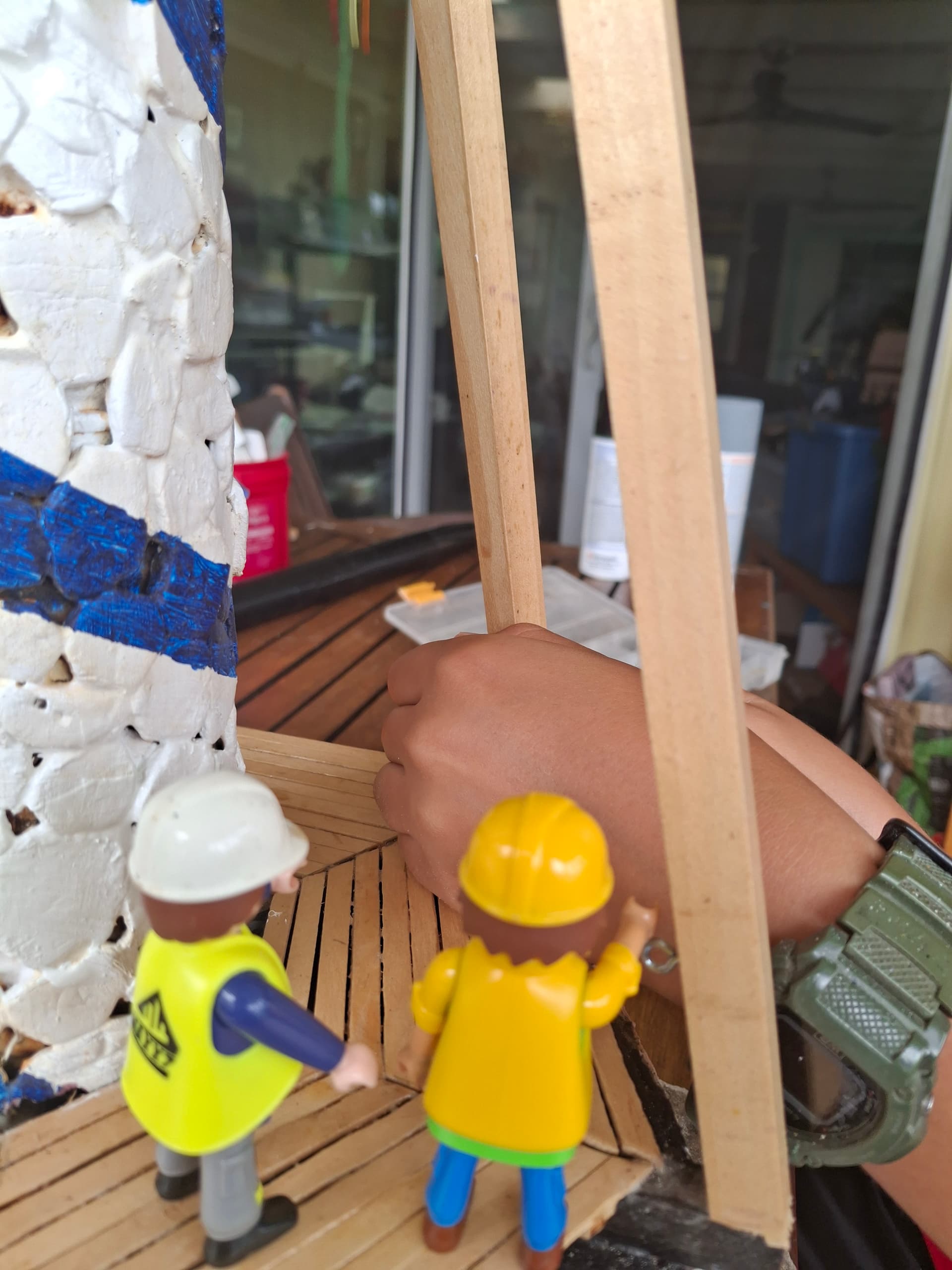

Kid-zilla and I puttered on this over the weekend, working together and solo to cut, shape, and place the beams.
He’s more photogenic, so no pictures of me! We opted not to scrape away the wood filler to enable a beam-to-foam bond. I hope we do not live to regret that! Our cutting and sanding was not perfect…
…so we used epoxy putty to fill the gaps. The support beams actually stabilize the tower, though I would not lift it from the tower or the support beams!

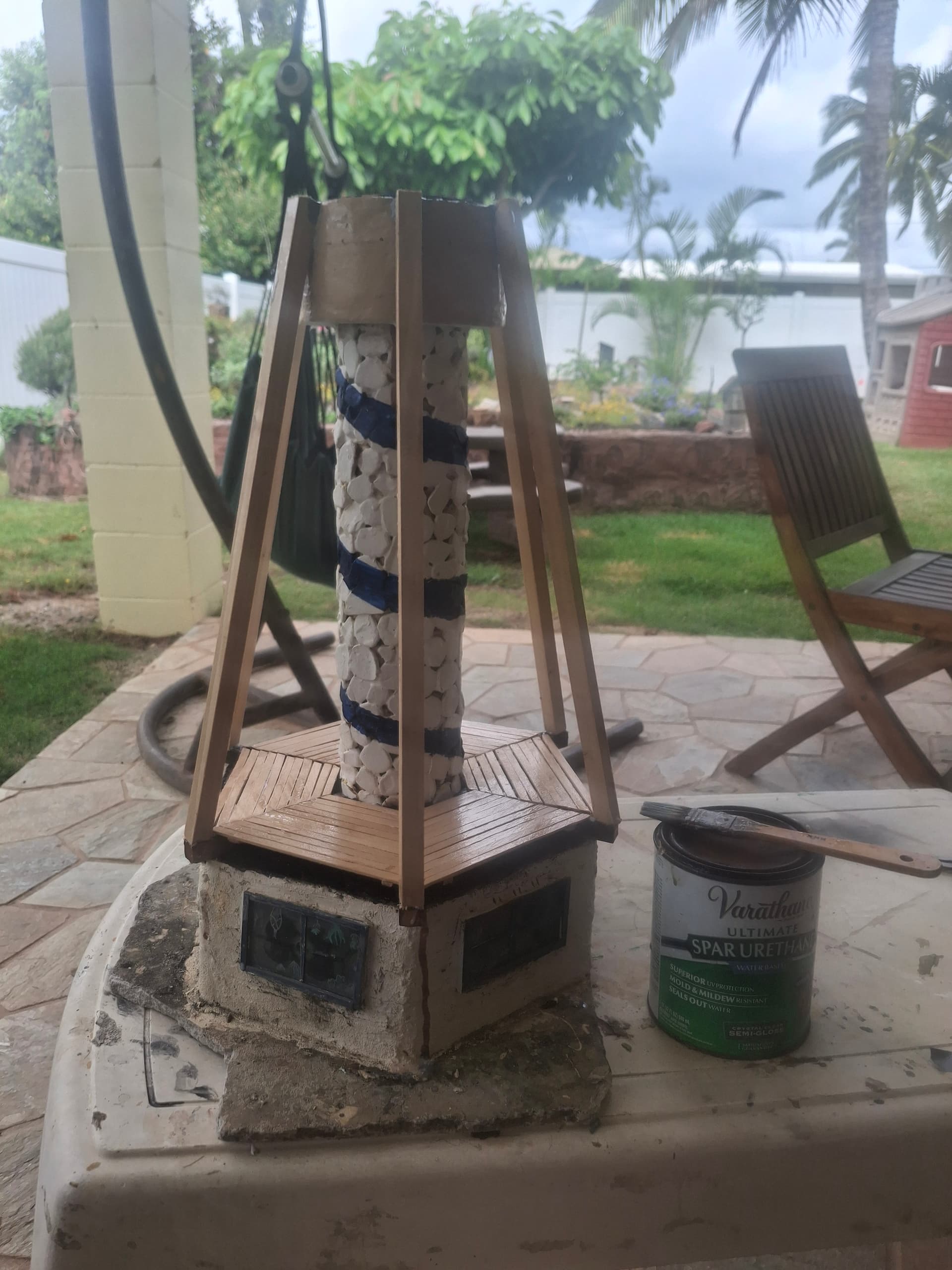

Today, I applied multiple coats of a water-based wood sealer, choosing this material because I had it on hand in quantities will in excess of any expectation of need.
I will let it dry for 24 hours, lightly sand, the coat it again, but I think this part of the project is, at last, done. Next i have to repaint the house, repaint the light cupola, craft some sort of exit from the tower to the deck, add the safety railings, and, probably, mount this on a less cracked piece of HardieBacker.

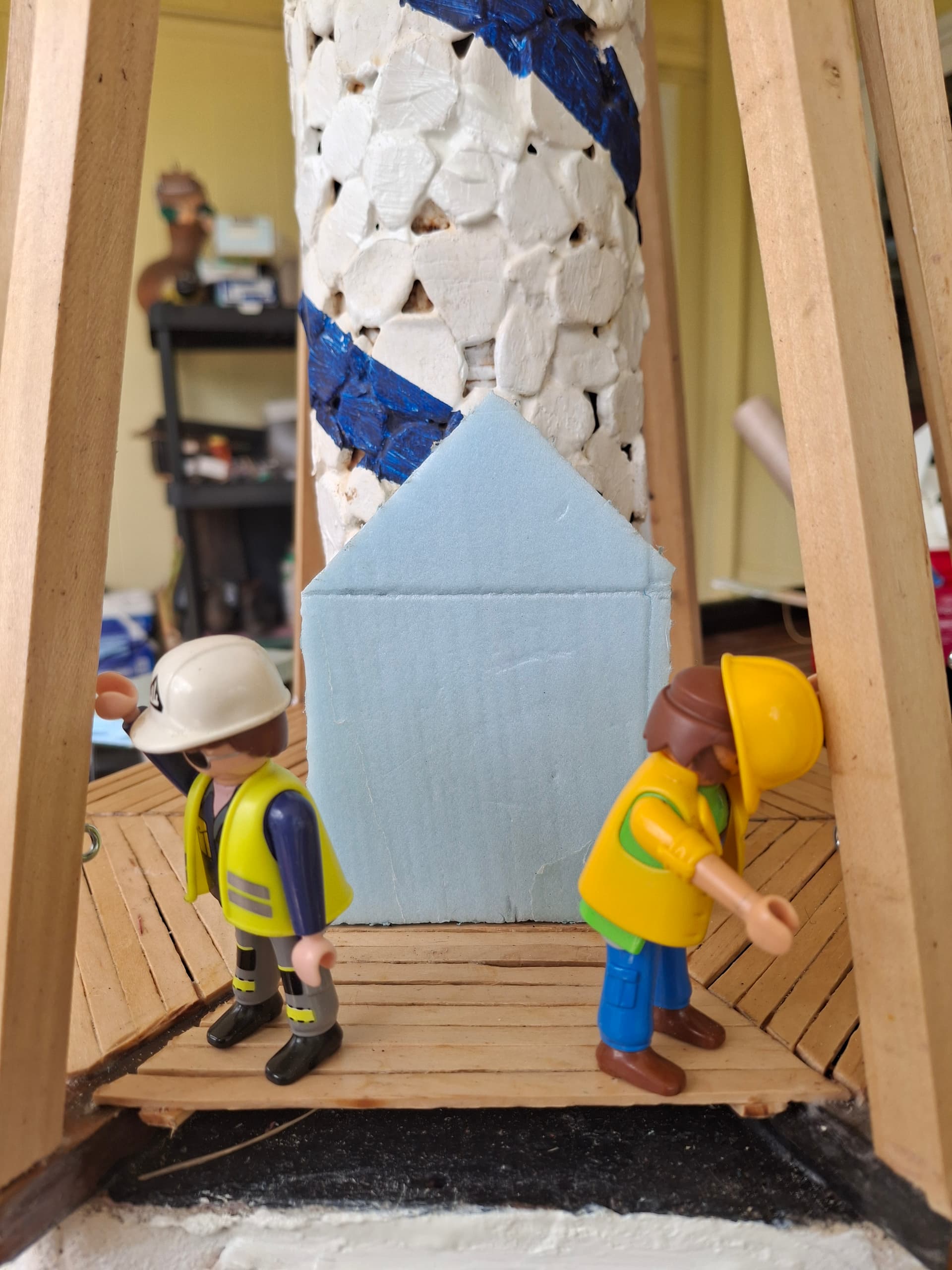

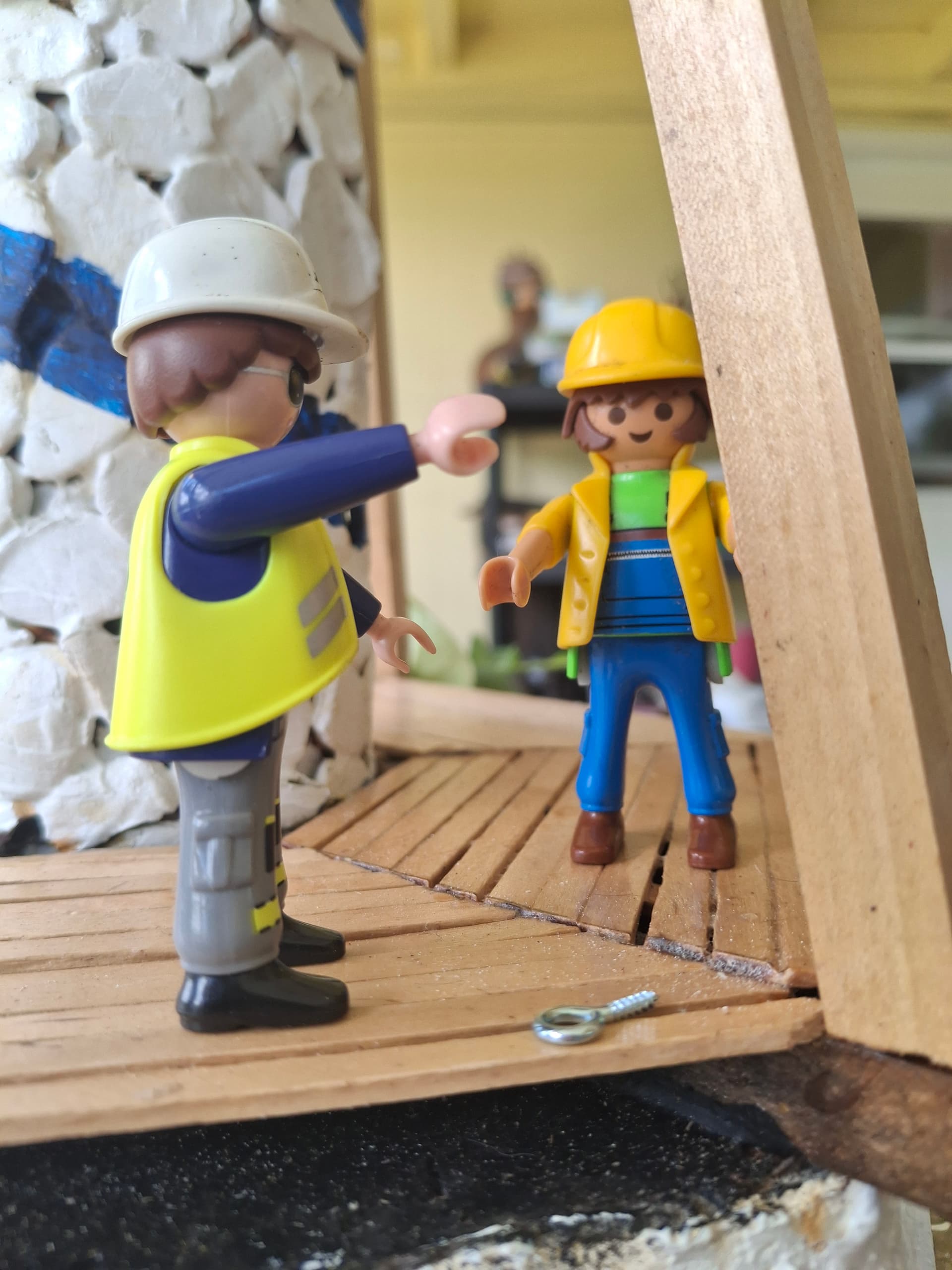

We decided to use eybolts to hold the safety chain, and we let the 1:24 gang set the height.
We then found screwing these things into the underside of the support timbers was pretty tough for 1:1 members of the crew!
There was insufficient space to tap a hole with a pinvise, so we had to drill a small starter hole using the tip of an old No. 11 X-acto blade. We got all the eyebolts in and sealed them up with TiteBond III.
Since the deck is raised from the foam core, the keeper cannot access it via roof hatch. Instead, he will need a door, which the 1:24 guys carefully measured…

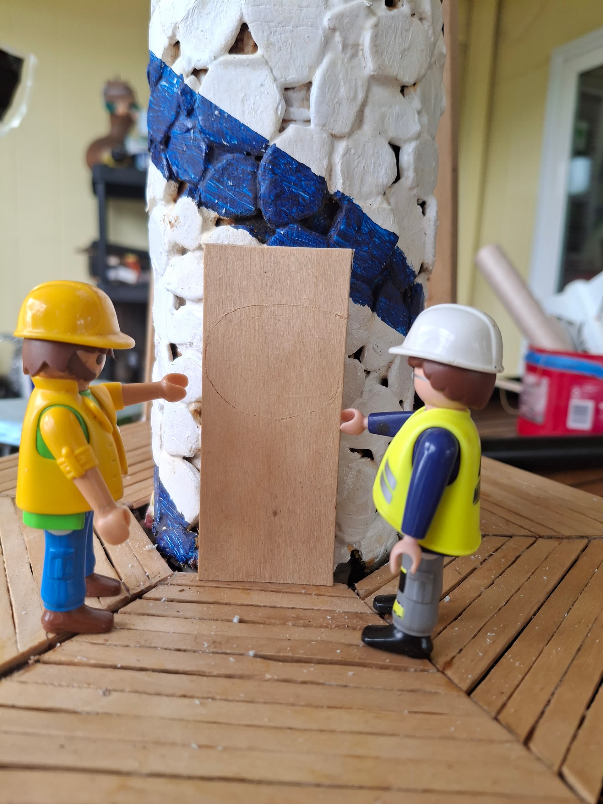

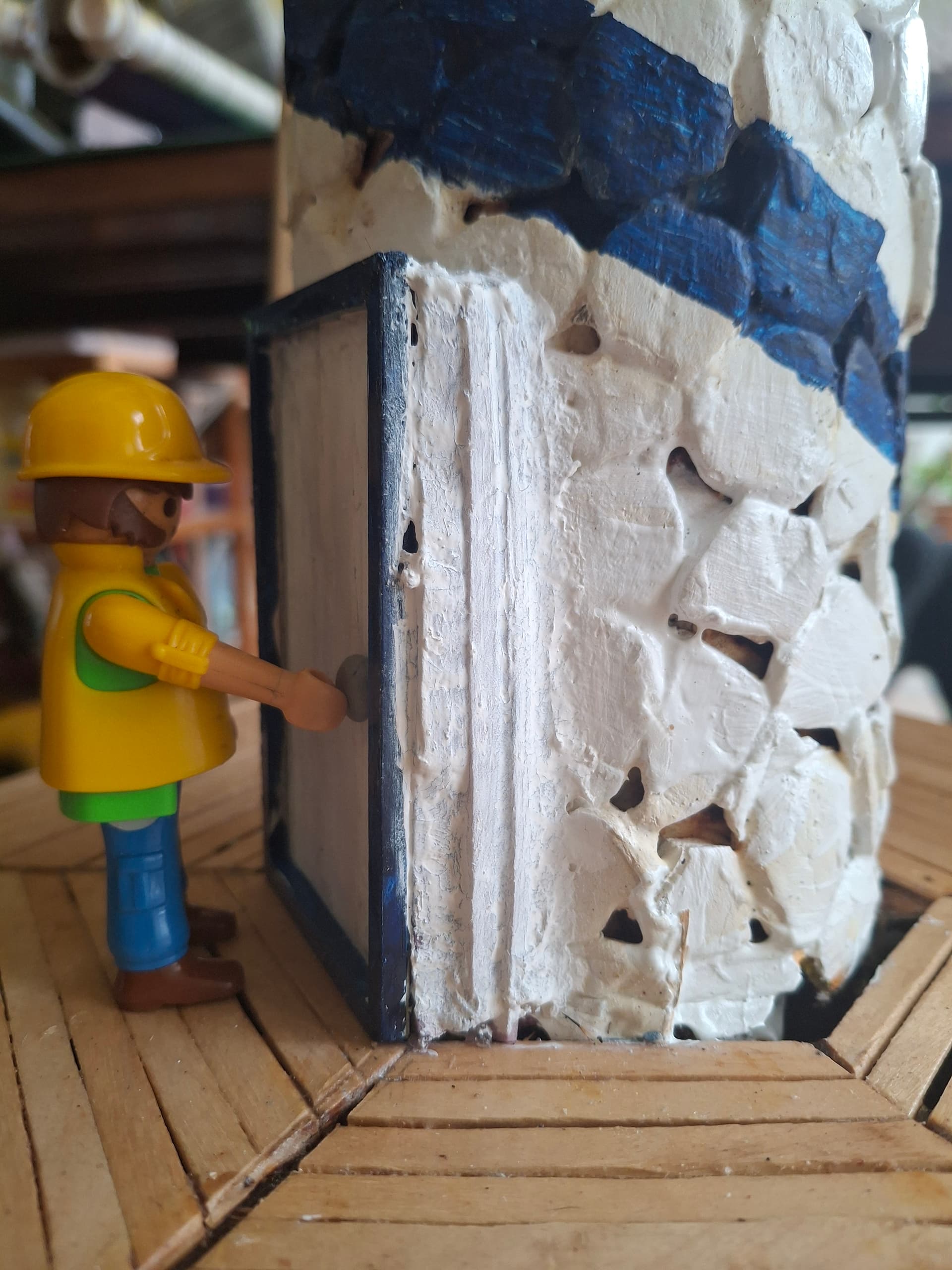

…only to have me screw it up…
…before screwing it up again.

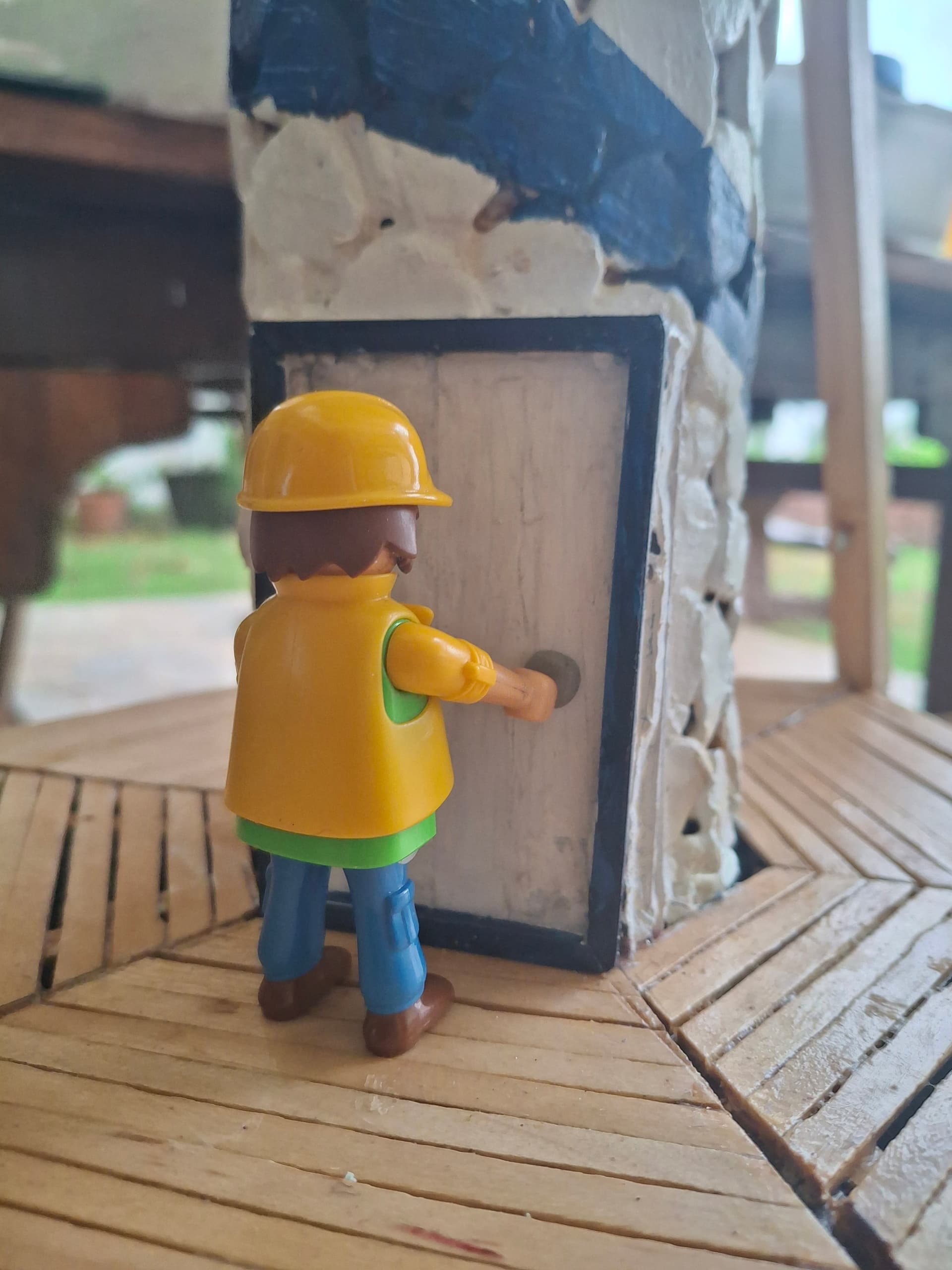

Even when I finally got it right, it turned out it was just too big. I tried sanding it to fit over the tower, but it wasn’t going to do. As a consequence, the 1:24 gang used a bit of scrap wood to test the concept of a flat door we could clue to the tower and then seal up with caulk.

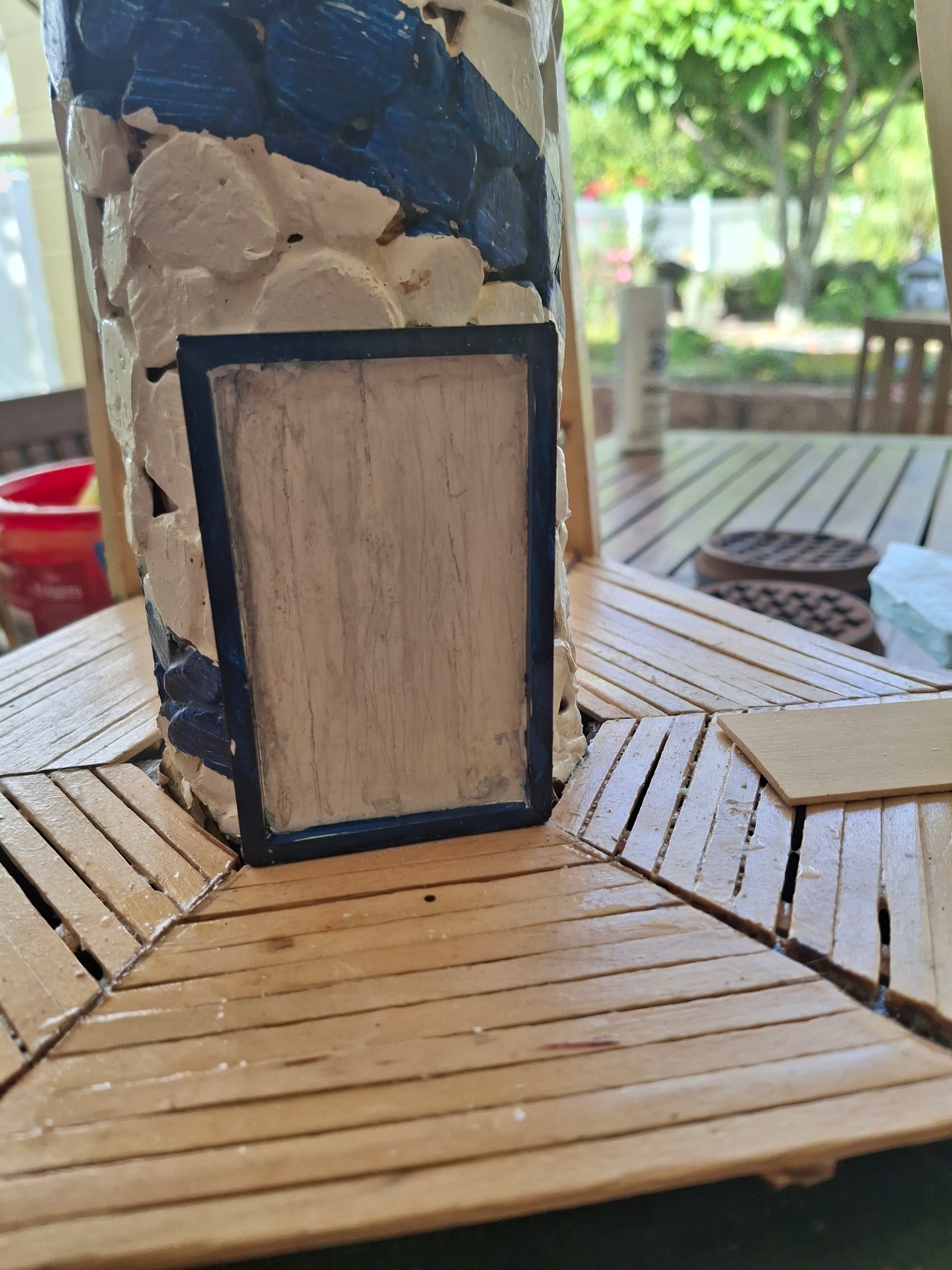

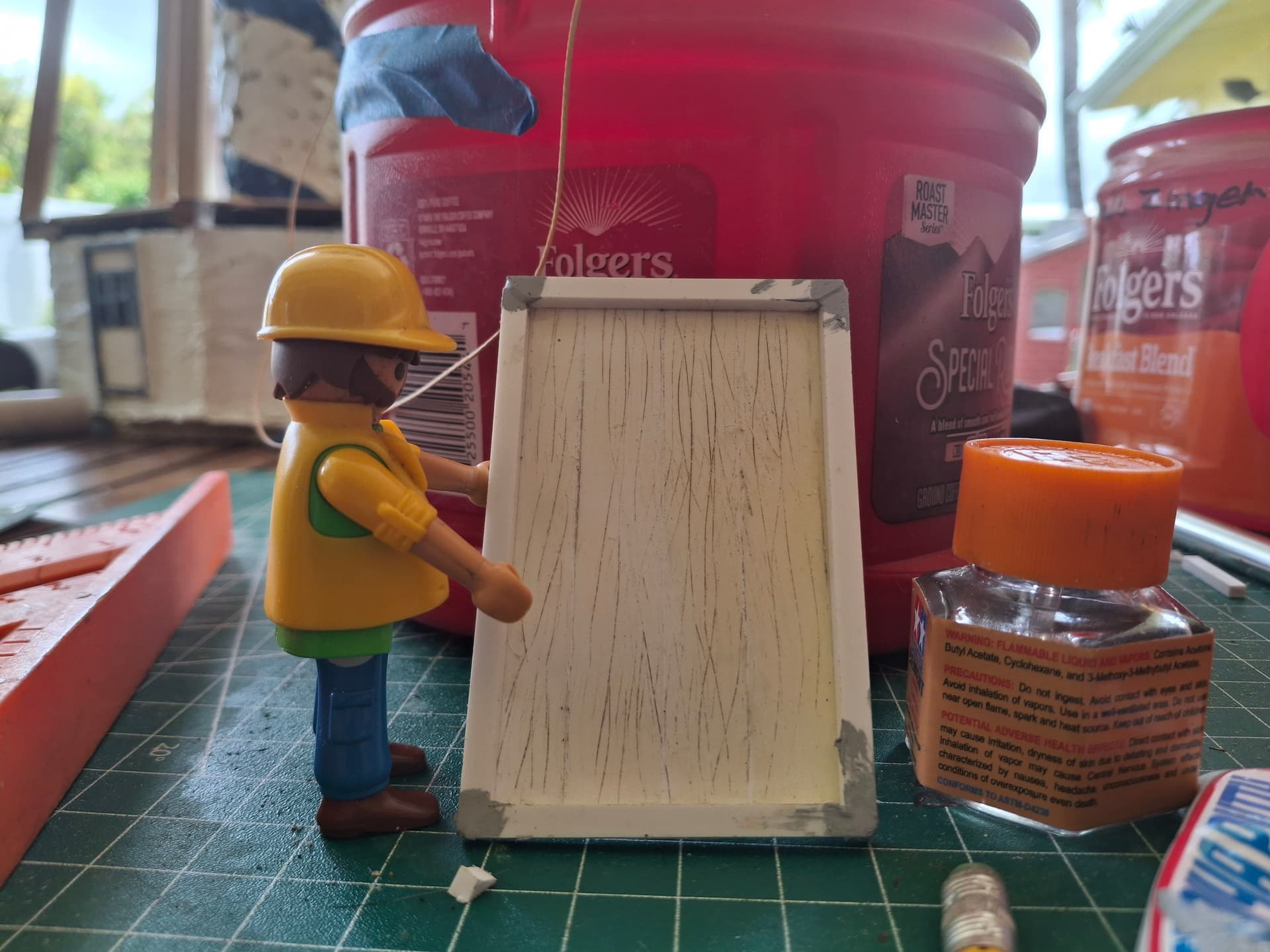

That’ll work, so Kid-zilla and proceeded to turning scrap styrene into a door. By the way, he doesn’t like scoring and snapping styrene!
A bit of putty, some paint, and a wash, and voila!
This is in the “let dry” phase. Tomorrow, we will caulk it into place. Then we will fit the safety rails and wait for the girls to come home to address the windows. We may use @Rooster 's “cheat” and use aluminum tape to represent windows in the event the girls choose not to replace the destroyed panes.
We are finally getting somewhere!

A flat black works as well. The ticket to the cheat is using vinyl pinstripping (or sliced masking tape) for the rails,stiles and mullions. If you want to use masking tape stick it lightly to wax paper or (PHOTO/glossy) printer paper.
Then lay out your lines and cut it on the paper backing, paint it OR color it with a sharpie. Then just peel off an end, stick it in place and peel off the backing as you go. You can peel it off the backing in one shot but it may curl up and stick to itself. This makes 12 over 12 windows much easier. It’s also easier if you boys stay out of the beer or mountain dew till finished.
Update:
Lots of small stuff happened over the last two weeks to bring this closer to completion.

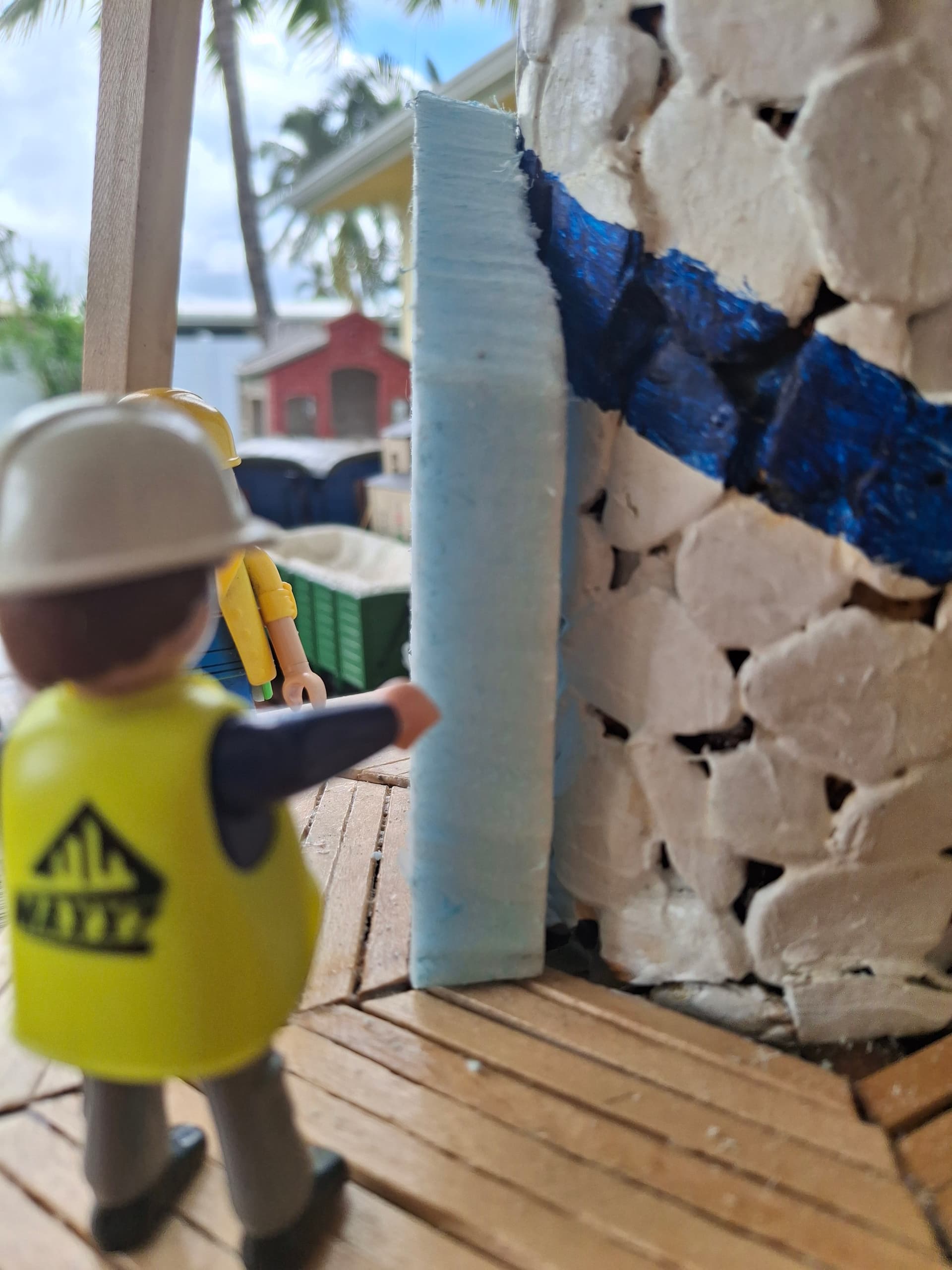

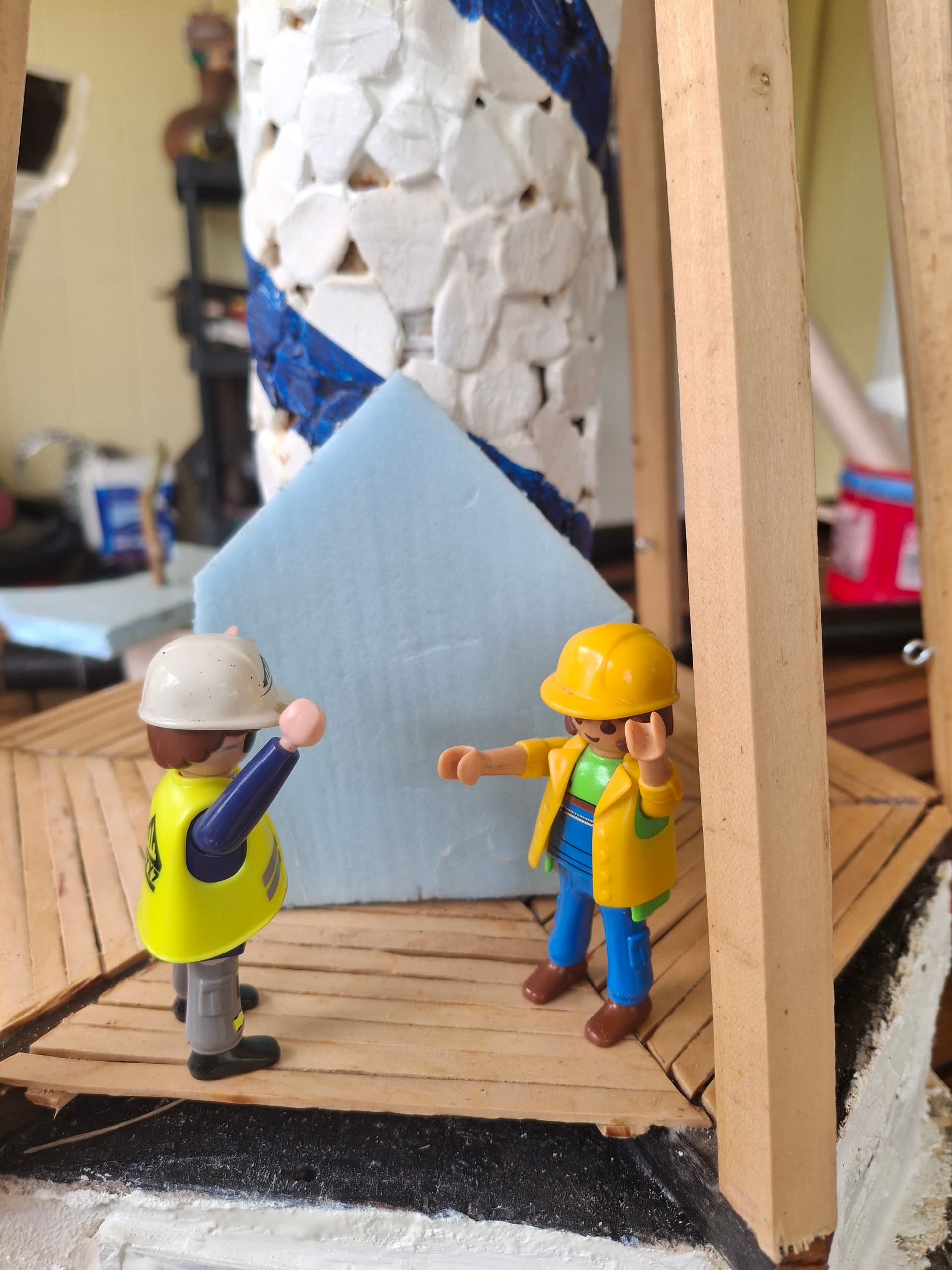

Scrap foam got wedged behind the door frame to make the door look like it was connected to something. Then a ball of epoxy putty made a door knob.
It passes the 10 foot rule!

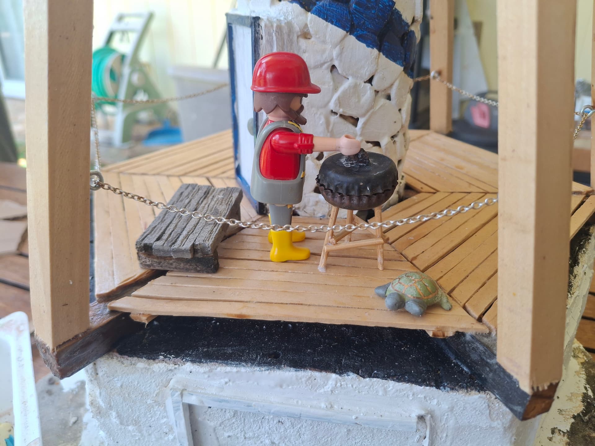

Kid-zilla, insisting my hands were too big, installed the safety chain.

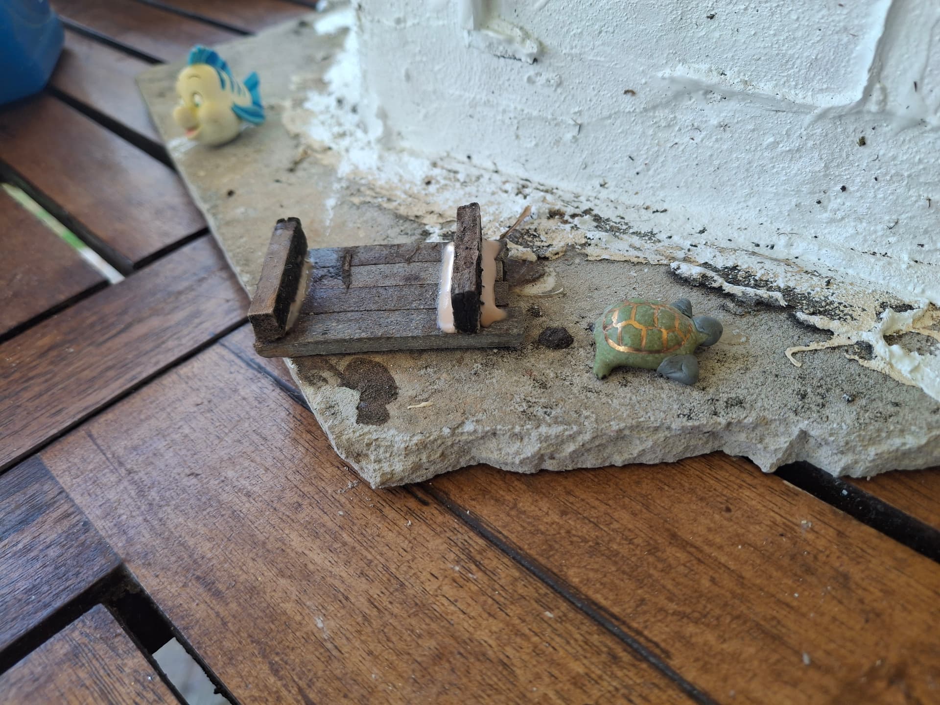

At some point, I opened the project bucket to recycle or dispose of scraps, and I discovered some of the original detail bits the kids made. I reassembled a bench made from other scraps, and a turtle got new legs and a head.
The turtle could use some paint, but it already looks a lot better with all of its body parts!

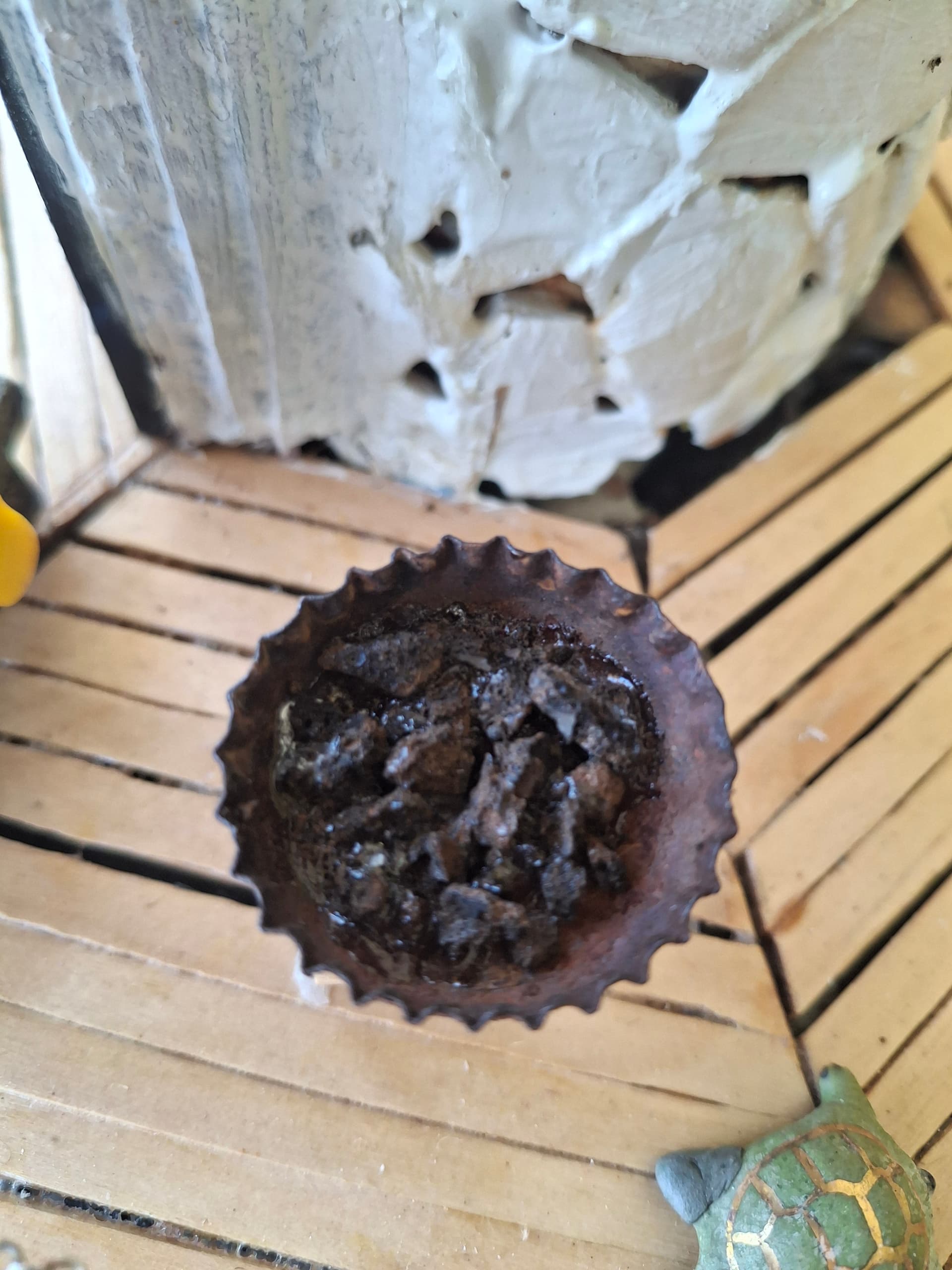

Next, Kid-zilla repaired the hibachi, which he crafted from bottlecaps when we first made the lighthouse. The bottlecaps were fine; the legs were long gone! He also crumbled some charcoal to make…charcoal!
The 1:24 gang was most appreciative!

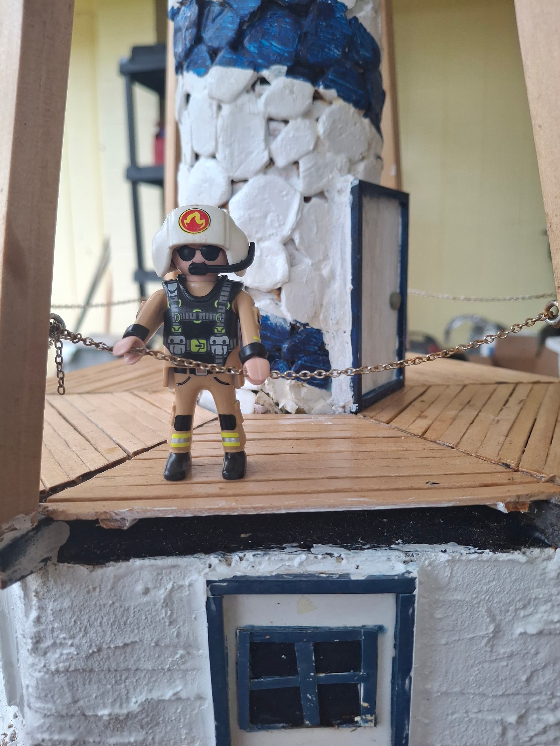

Update:
Six months…still a window short…Ugh…
Still, I felt the need to tinker with this project as I waited to see if we would get yet another hurricane. I didn’t really like the way the “flying buttresses” supporting the light were affixed to the beams on the roof. I really thought that they should be supported, so I salvaged the old support beams and cut them to shape. First, I used a handsaw. Then, I opted to use my old nemesis Sabre Saw, rationalizing that getting better with saws actually required their occasional use.
Despite myself, I was able to make relatively straight cuts, and, with a bit of sanding, fit the new supports to the existing structure. The fits isn’t perfect, but it goes a long way towards giving the appearance of a building subject to normal earth gravity, and it breaks up the color a bit.
I also found a piece of HardieBacker that I affixed to the base, much of which had chipped away over the years. I’ll get some paving stones to ensure the improved lighthouse is eventl supported across its base when it is in use. Some basic work will go to blend the to HardieBacker slabs together, too.
Now to await those windows…
