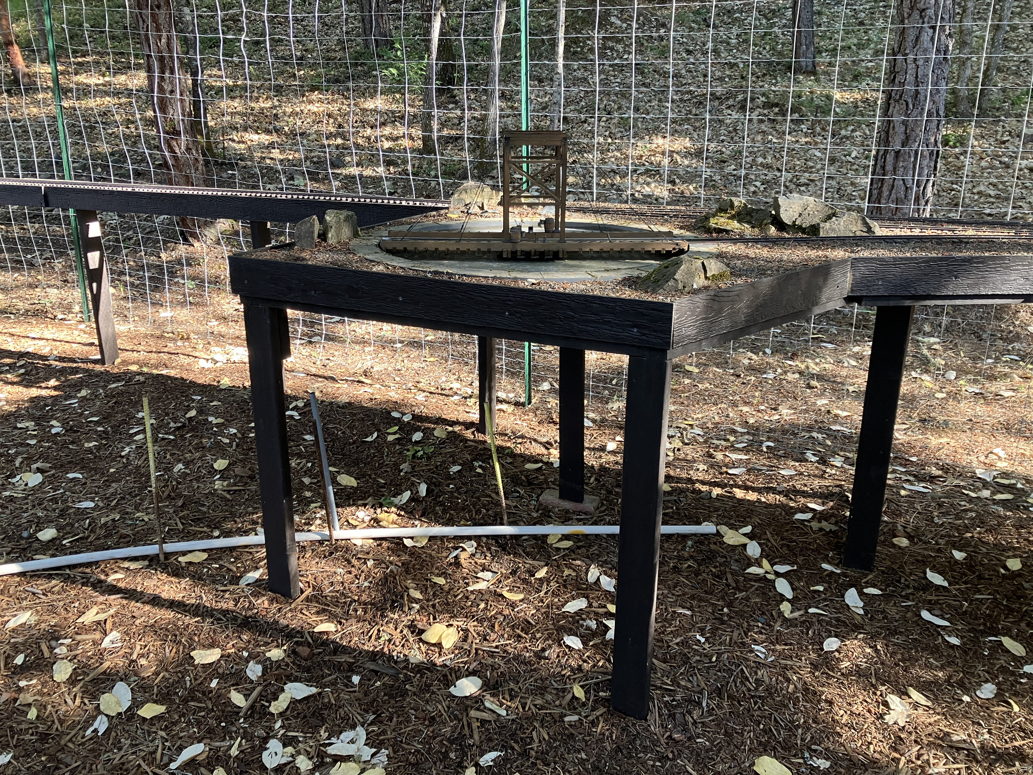

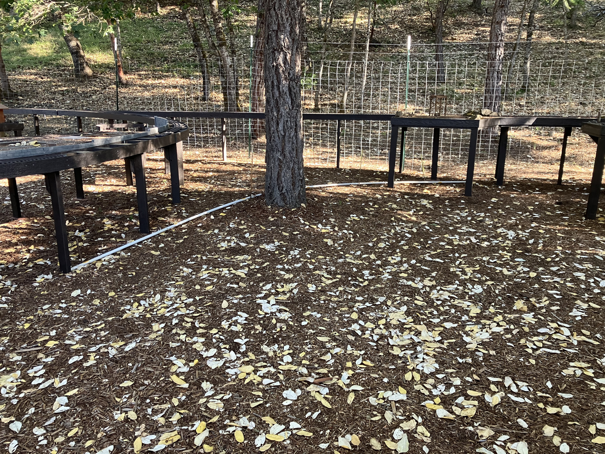

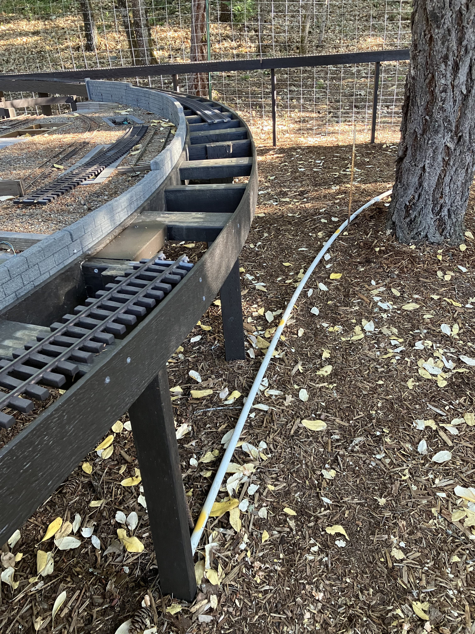

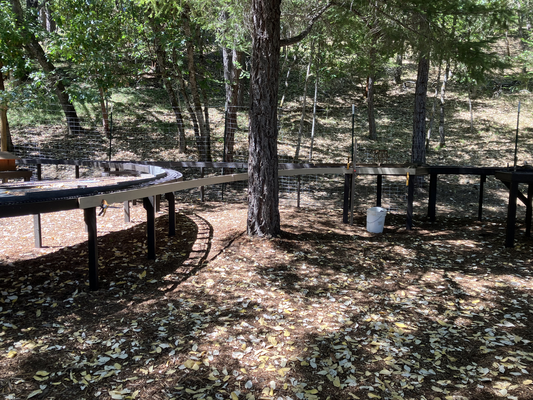

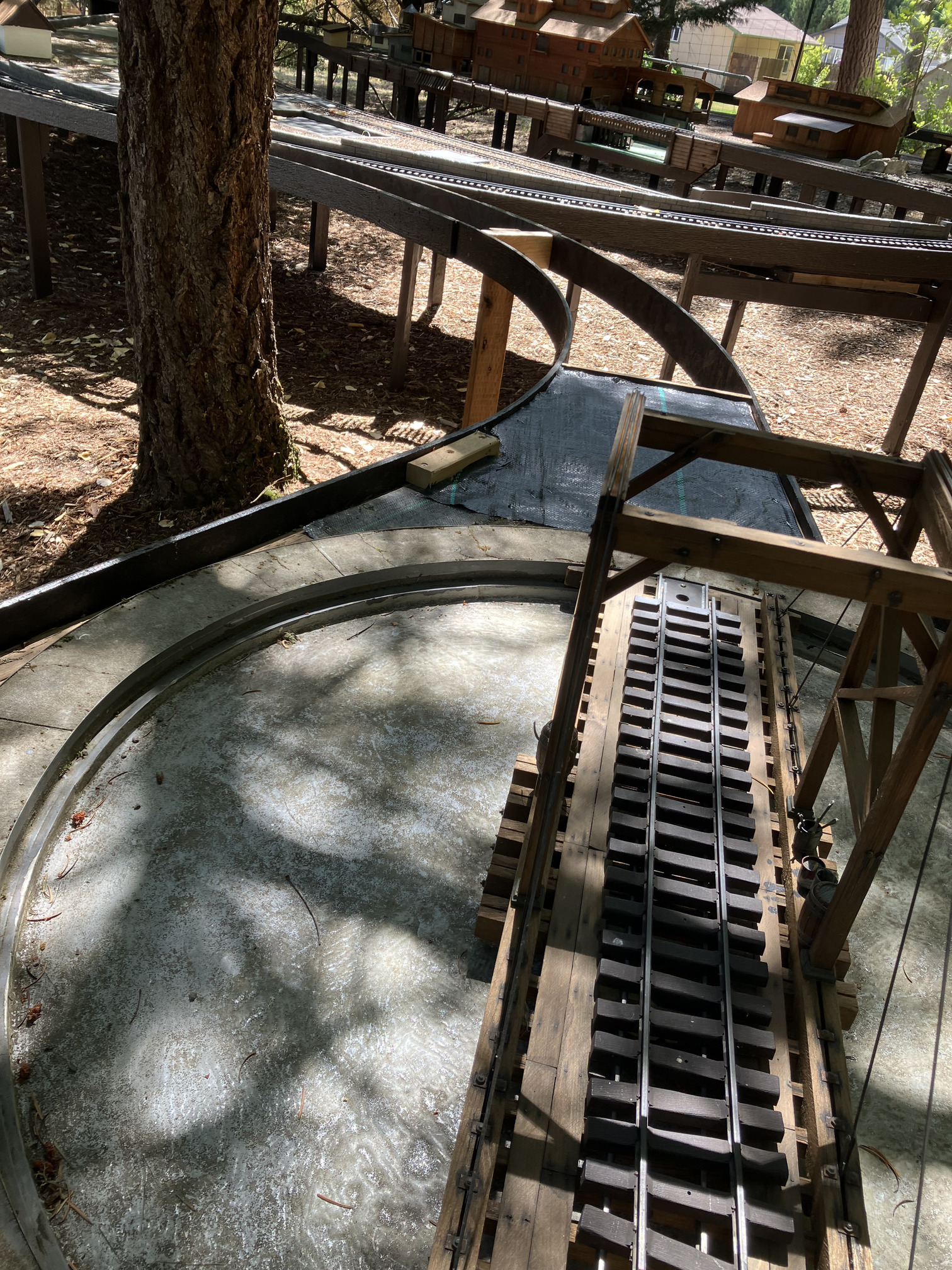

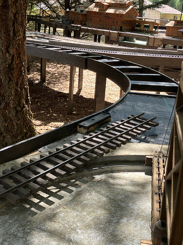

Here you can see the layout of the situation as it exists. The mainline loop on the left goes up grade from front to back. The mainline across the back goes down grade from right to left. The PVC pipe on the ground is a layout to get a feeling for the curve involved.

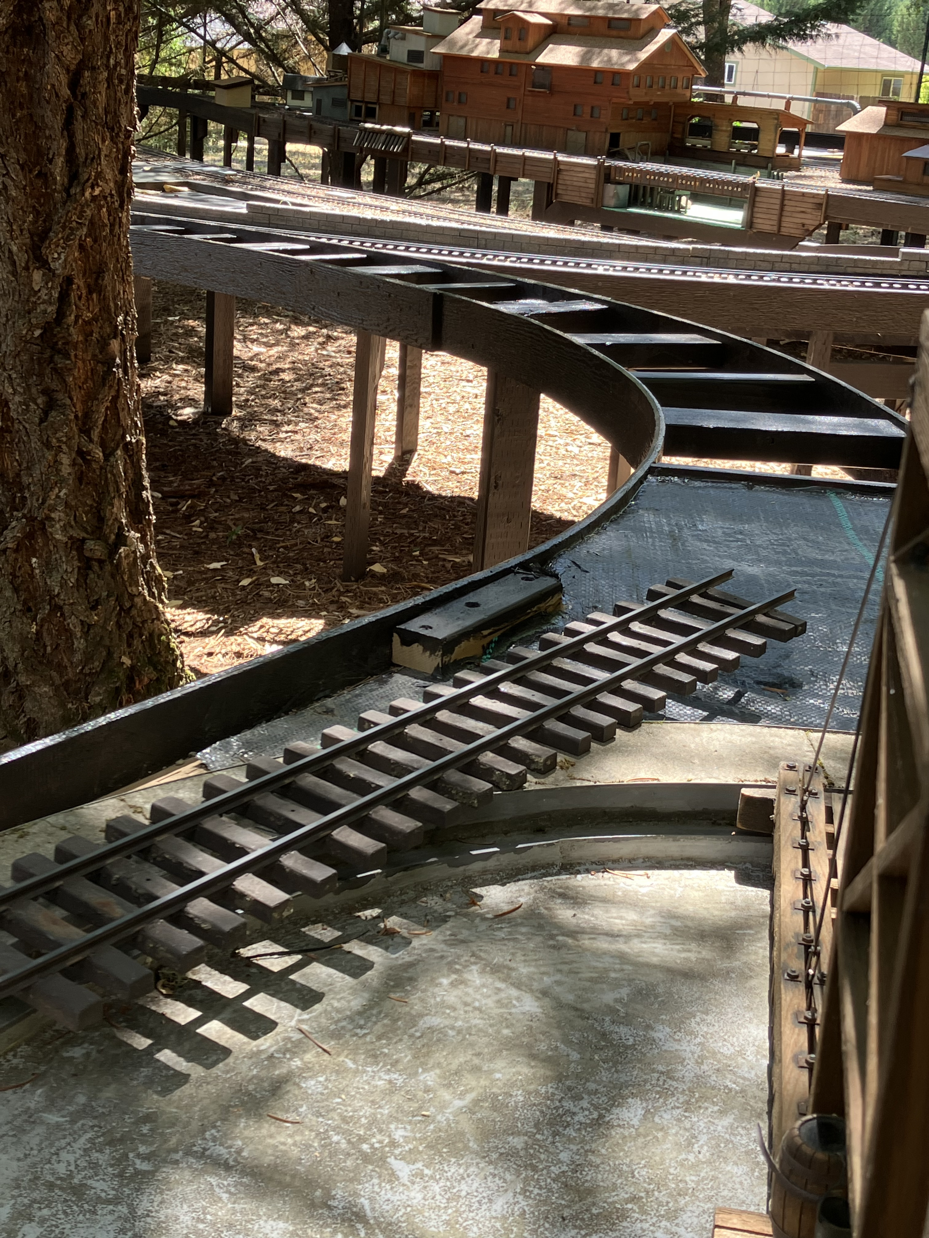

The cut in location for the switch on the loop mainline
A closeup at the turn table end, I just couldn’t abandon this neat old square gallows turntable.
More to follow.

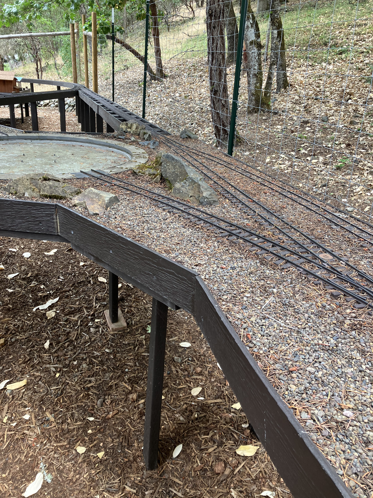

Not really enough room for any of that to work. Can’t really shift TT or tracks to the right in this picture because of fencing and can’t expand to the left because of walk way clearances. Besides the TT pit rim is poured concrete and the base is cement board about a foot larger than the TT pit. Just for reference the TT pit is 34 inch diameter inside.

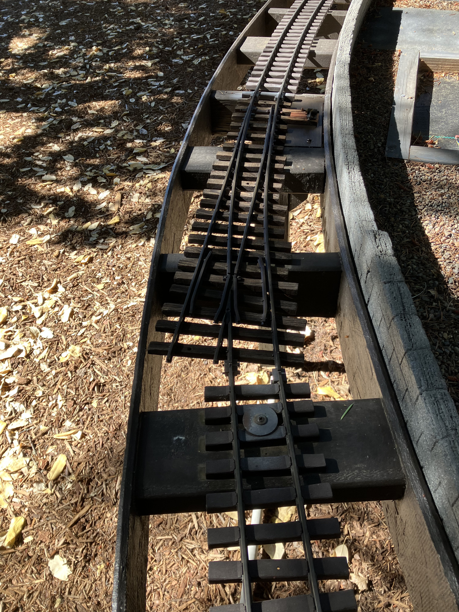

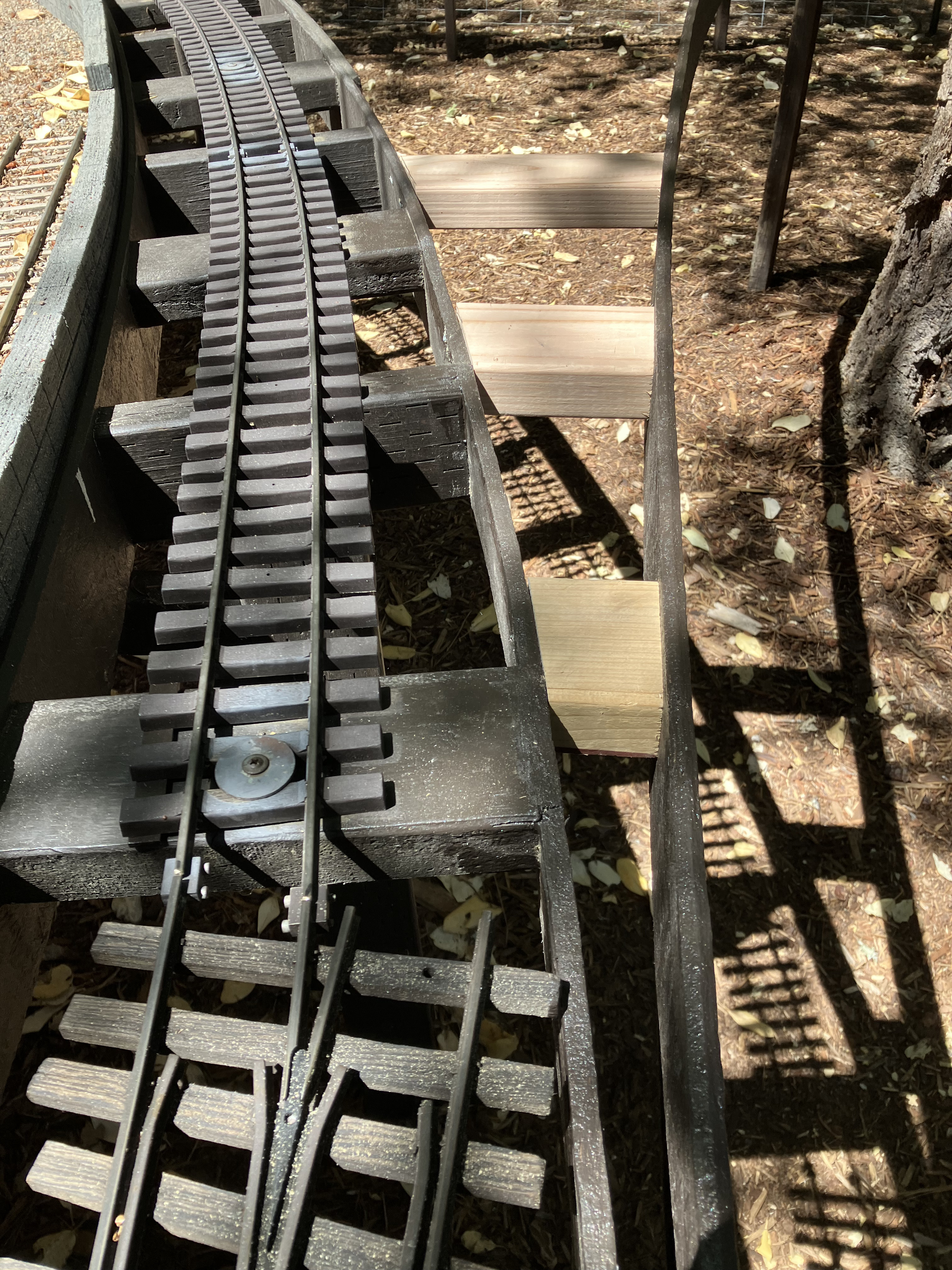

The left hand Llagas Creek switch matched my radius almost perfectly, so it was an easy install. You see that the switch throw is very close to the stone wall that’s why I changed it to a ground throw.
Just proving the run through of the switch on the main.

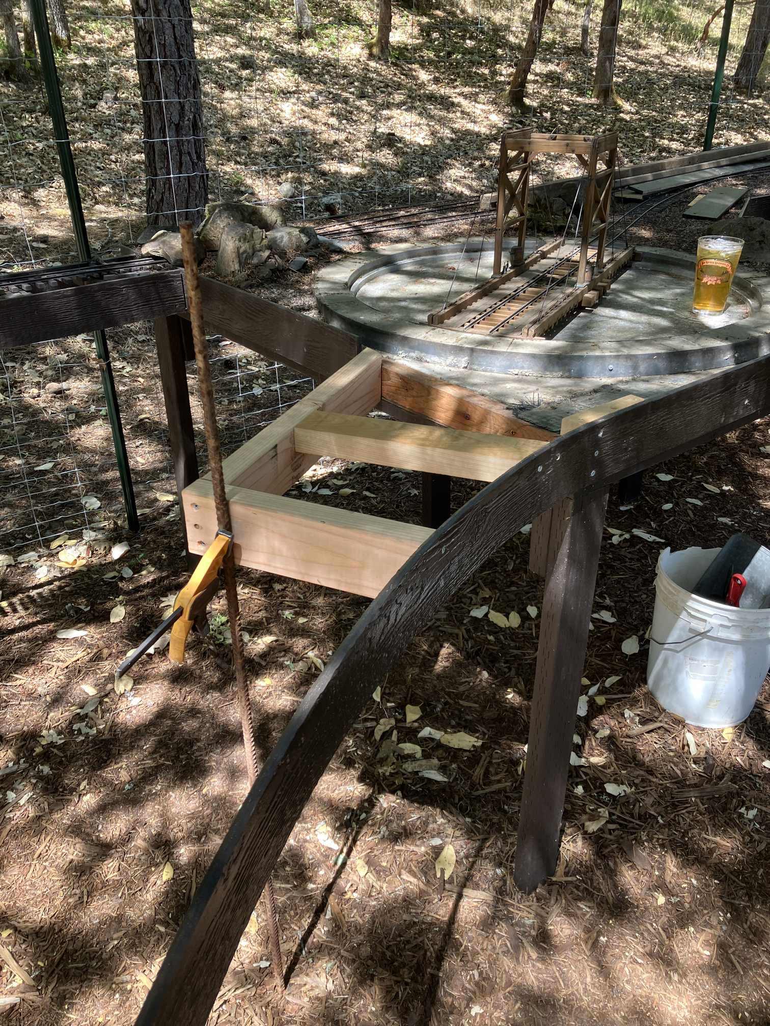

Starting the install of the outside facia board. This is before prime and paint.

Getting the blocking and framing in.
Structure complete and painted ready for track

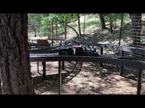

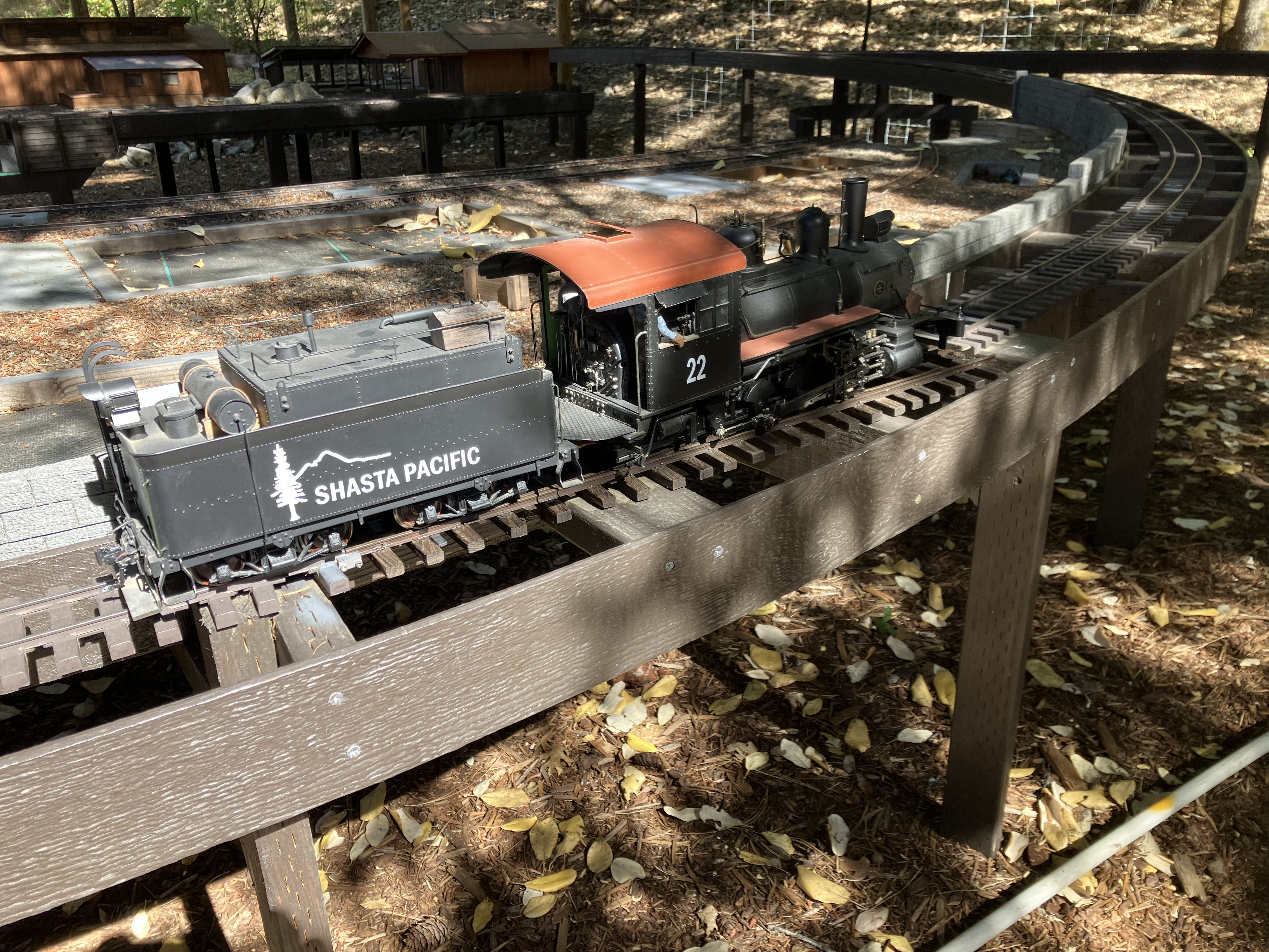

A short video of the first engine run on the new cutoff. As careful as I tried to be I still ended up with a slight bit of “tip over” you can see it just as the engine hits the TT bridge.

Looks great. It’s pretty prototypical for there to be a bump entering and leaving a turntable. You might want to have a permanent slow order in the area.
