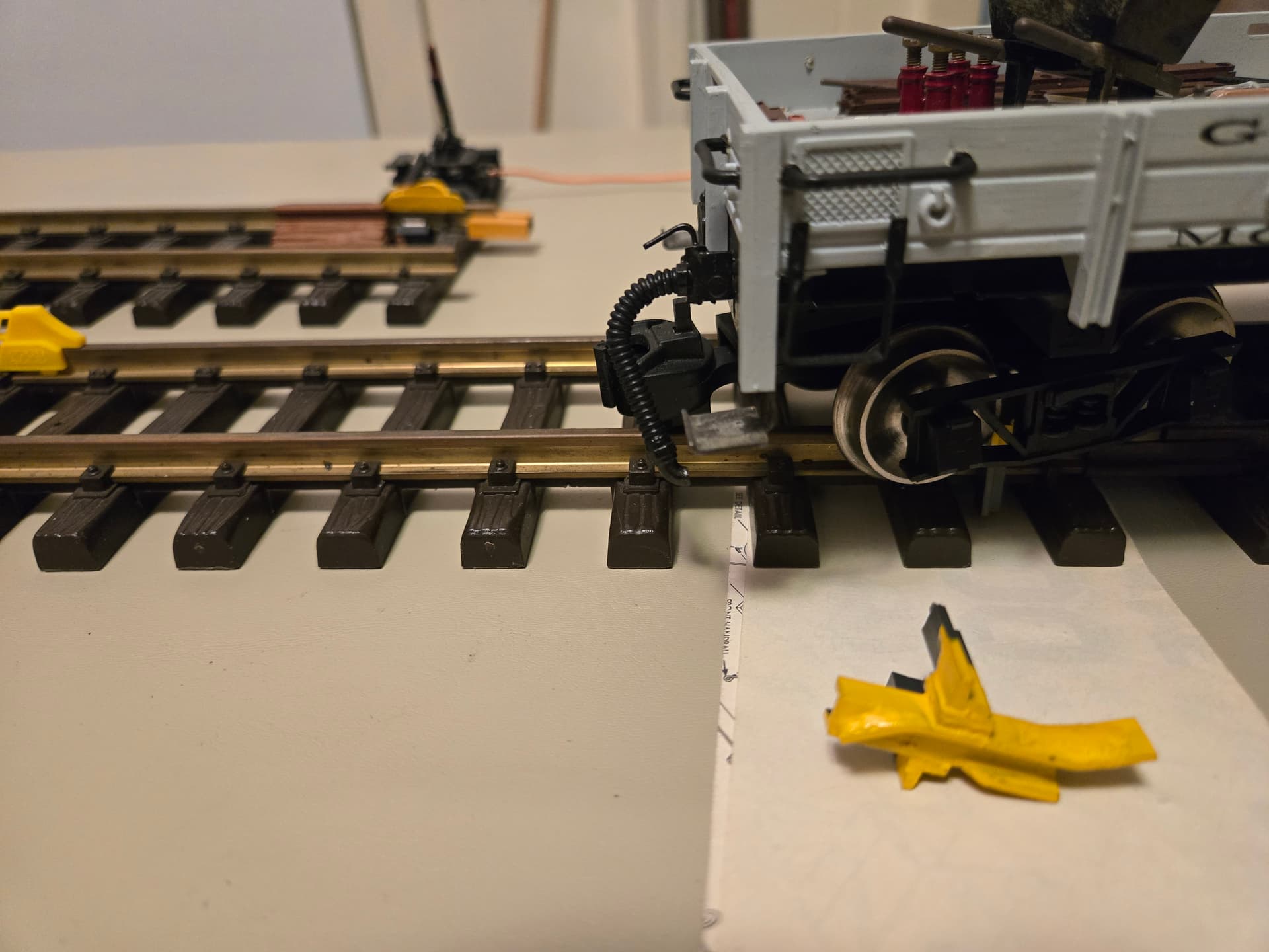

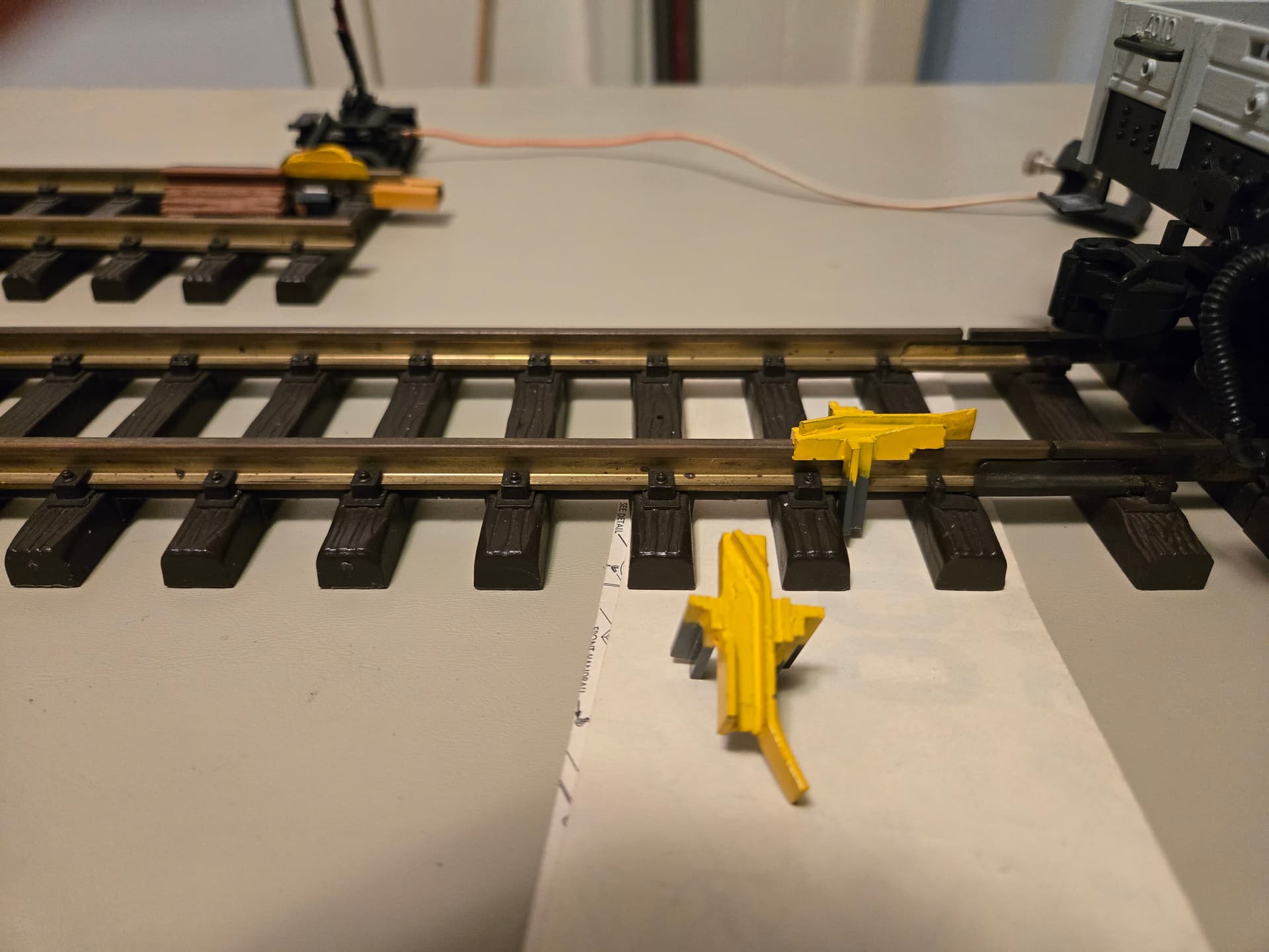

I remembered Kent’s wise saying when I needed to solve a problem with the garden railway I used to have at the back of our yard. I had one siding that sloped downgrade toward its switch no matter how much I tried to correct the grade. I just couldn’t allow a car to slowly roll into the switch and foul the mainline! The solution was to cobble up the derails shown below from scraps of Plastruct “H” and “L” beams. plus a few bits of straight styrene. A little work with a razor saw and some small files will make a credible derail. The yellow paint is optional, but it makes the derails easier to see. When a car rolls slowly towards the switch, the derail will put the first wheelset on the ground, and that usually stops all forward motion. (As in the second photo.)

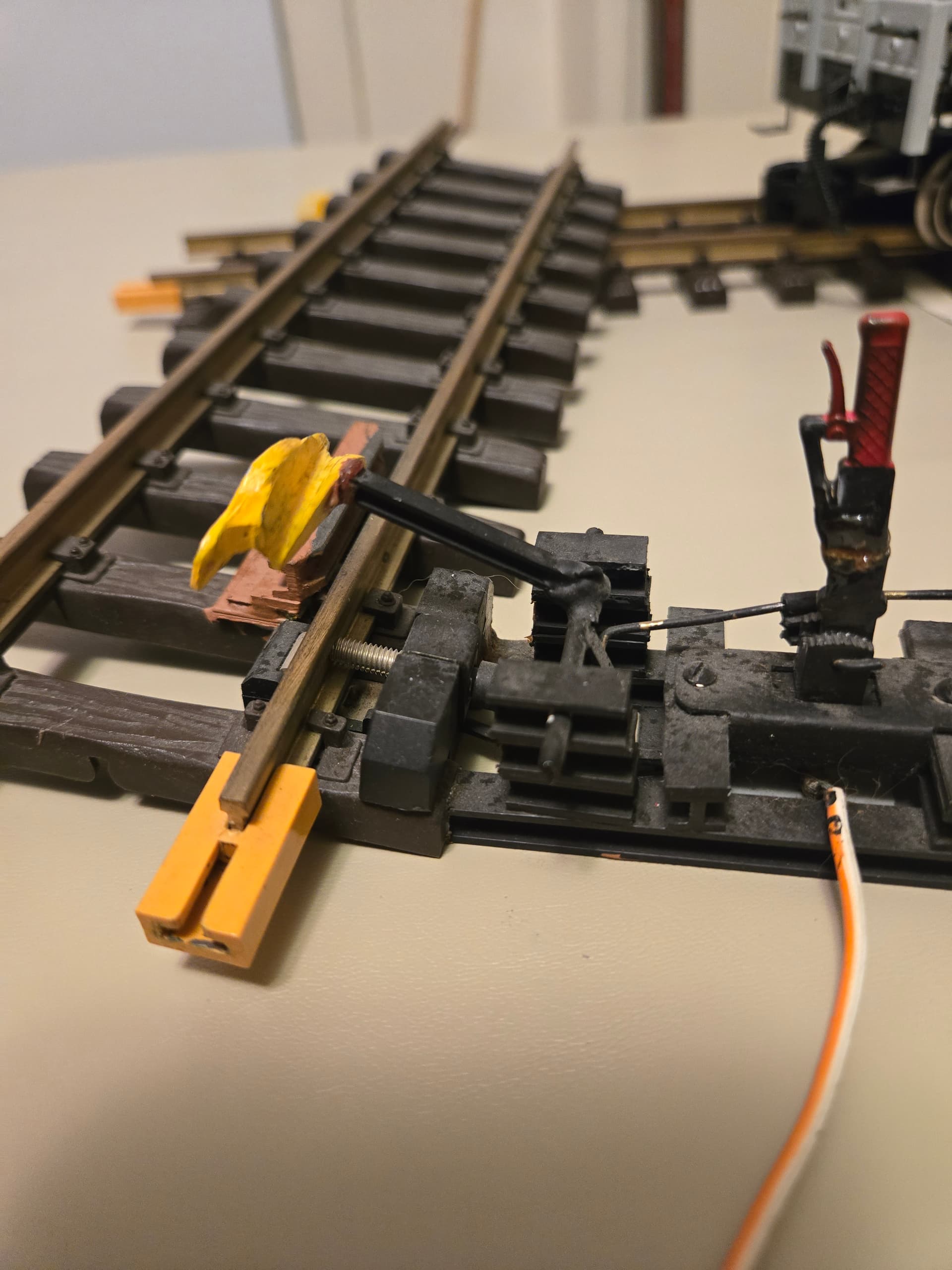

I also made a more fancy derail to use with a siding at train shows, This derail has a built-in toggle switch that cuts power to the siding when the derail is engaged.

I’m intrigued by your electric version. How does that work?
John;
The red lever is glued to a miniature toggle switch. Pushing the lever towards the track causes the OFF setting. The throw is too short to effectively lower the derail, so I have a pull rod attached to the base of the lever to finish that job. The pull rod becomes a push rod for raising the derail and the ON setting. There is also a styrene check rail (also scrap Plastruct) mounted at the approach to the derail to keep wheel flanges aligned properly.
