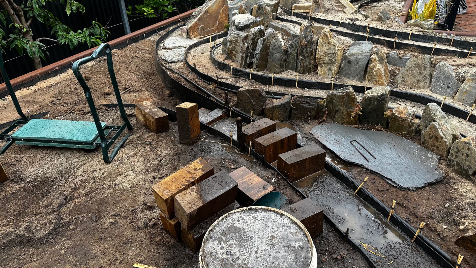

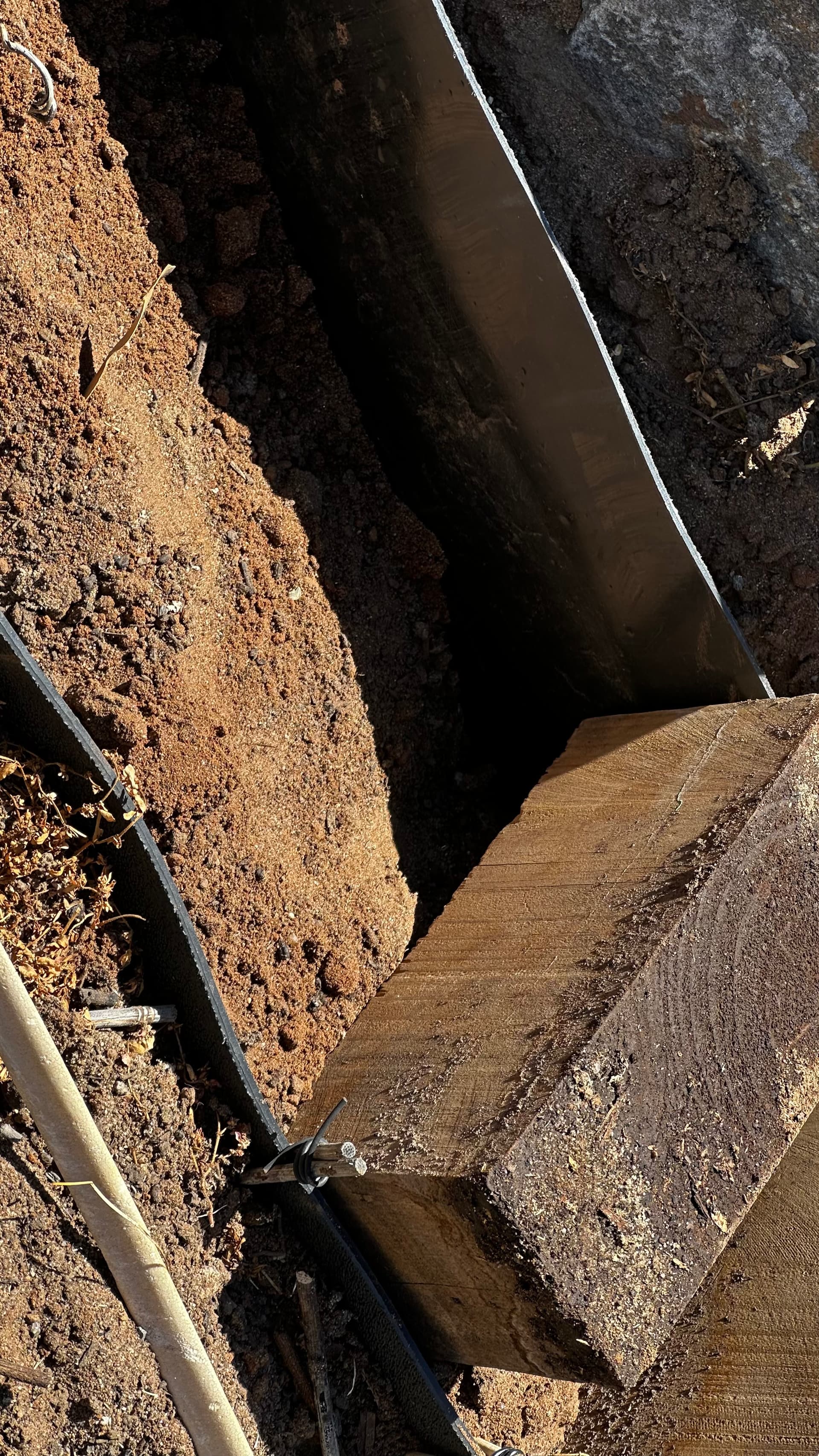

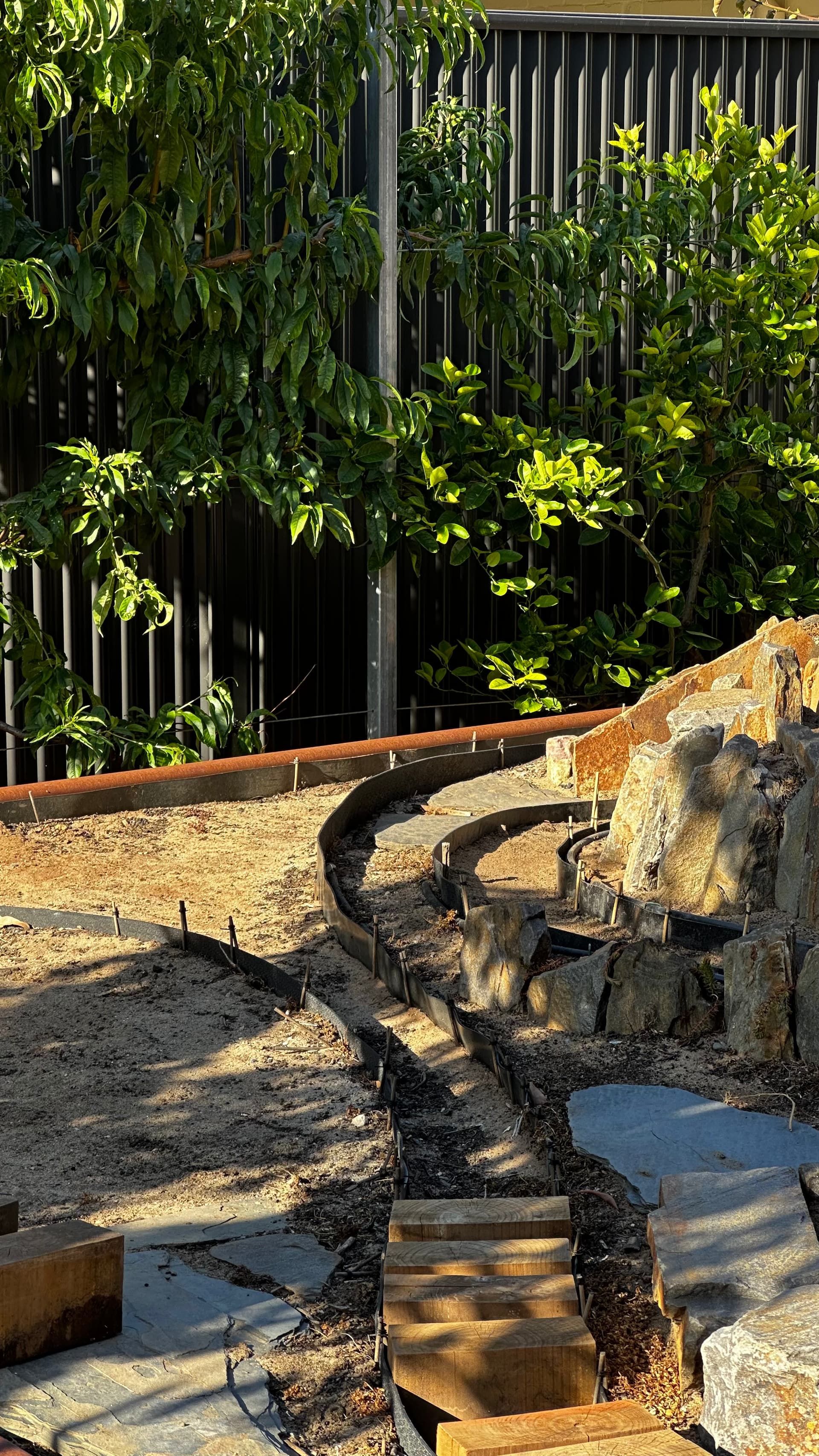

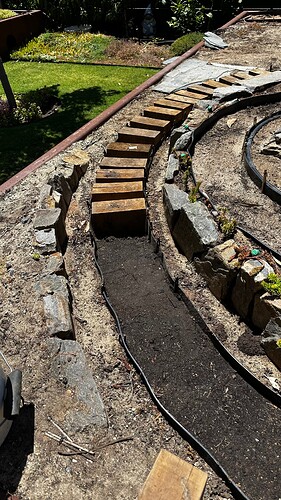

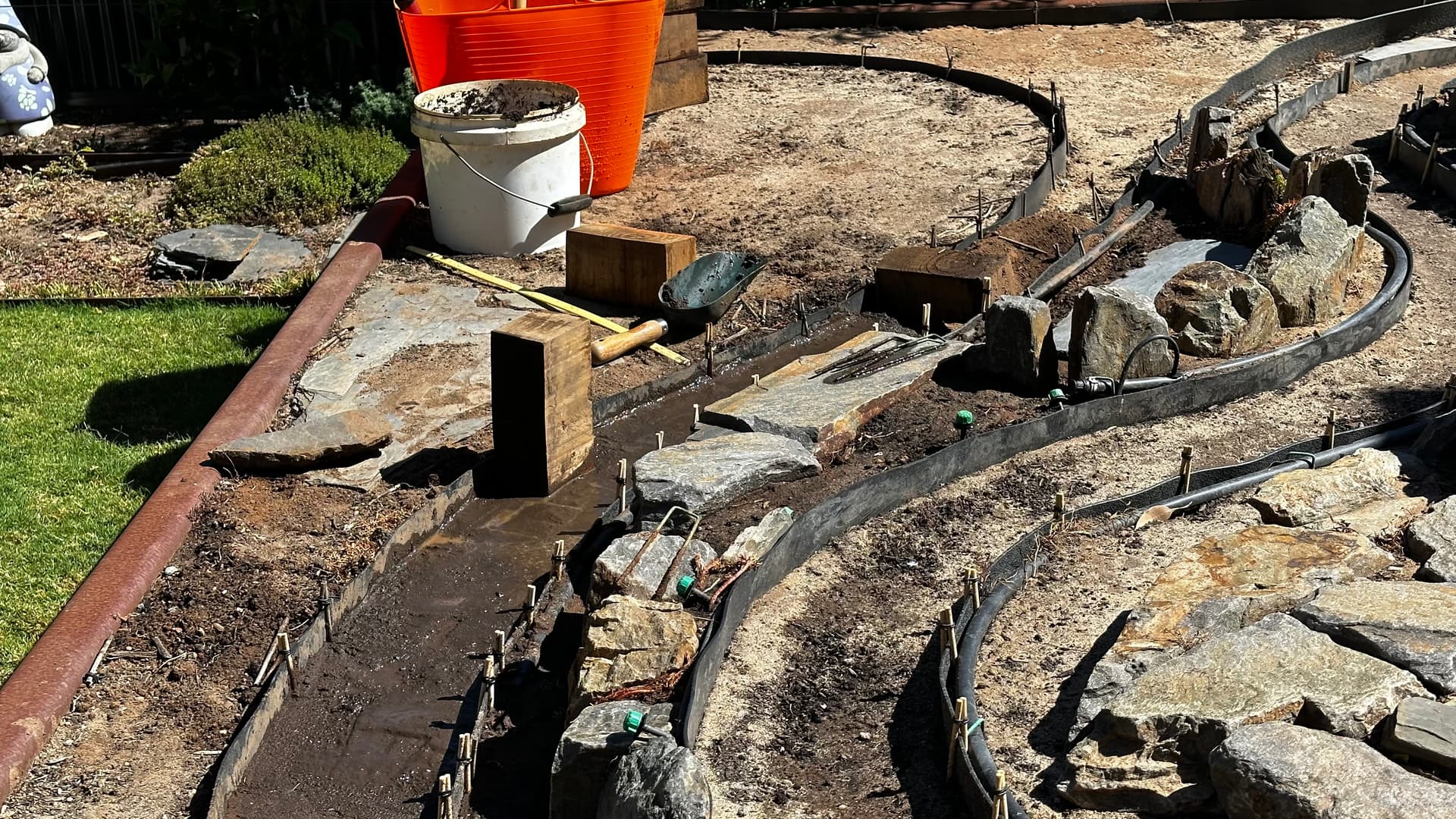

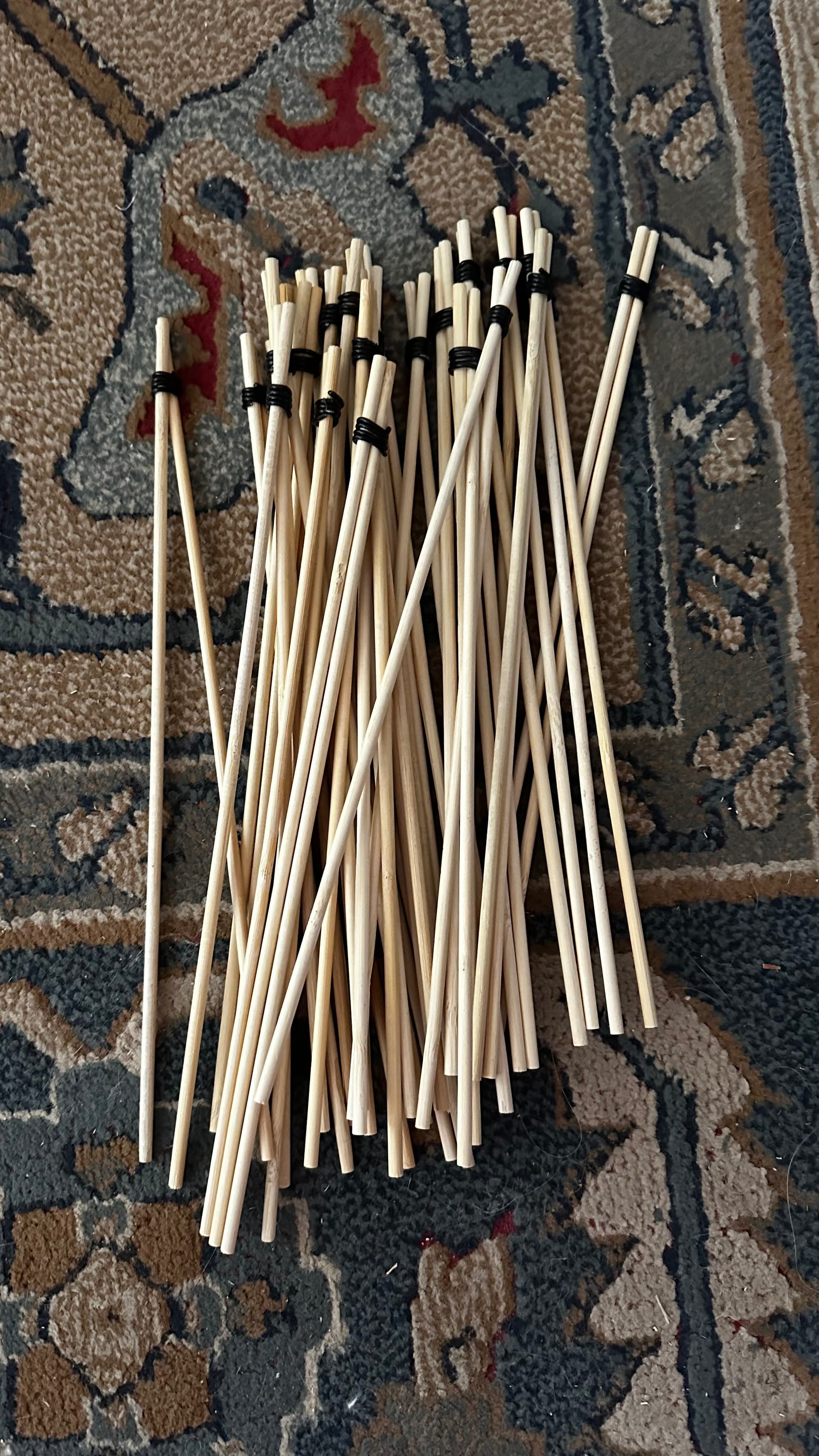

Metal & plastic stakes are surprisingly expensive and quite obtrusive, so I am using bamboo plant stakes and wired them together with bonsai wire. The idea is that I can control both sides of the edging and keep it from riding up during the build. It worrked well for The DÜRR PART 1.
They hold the garden edging down until the soil settles, then can be pulled or left to rot.

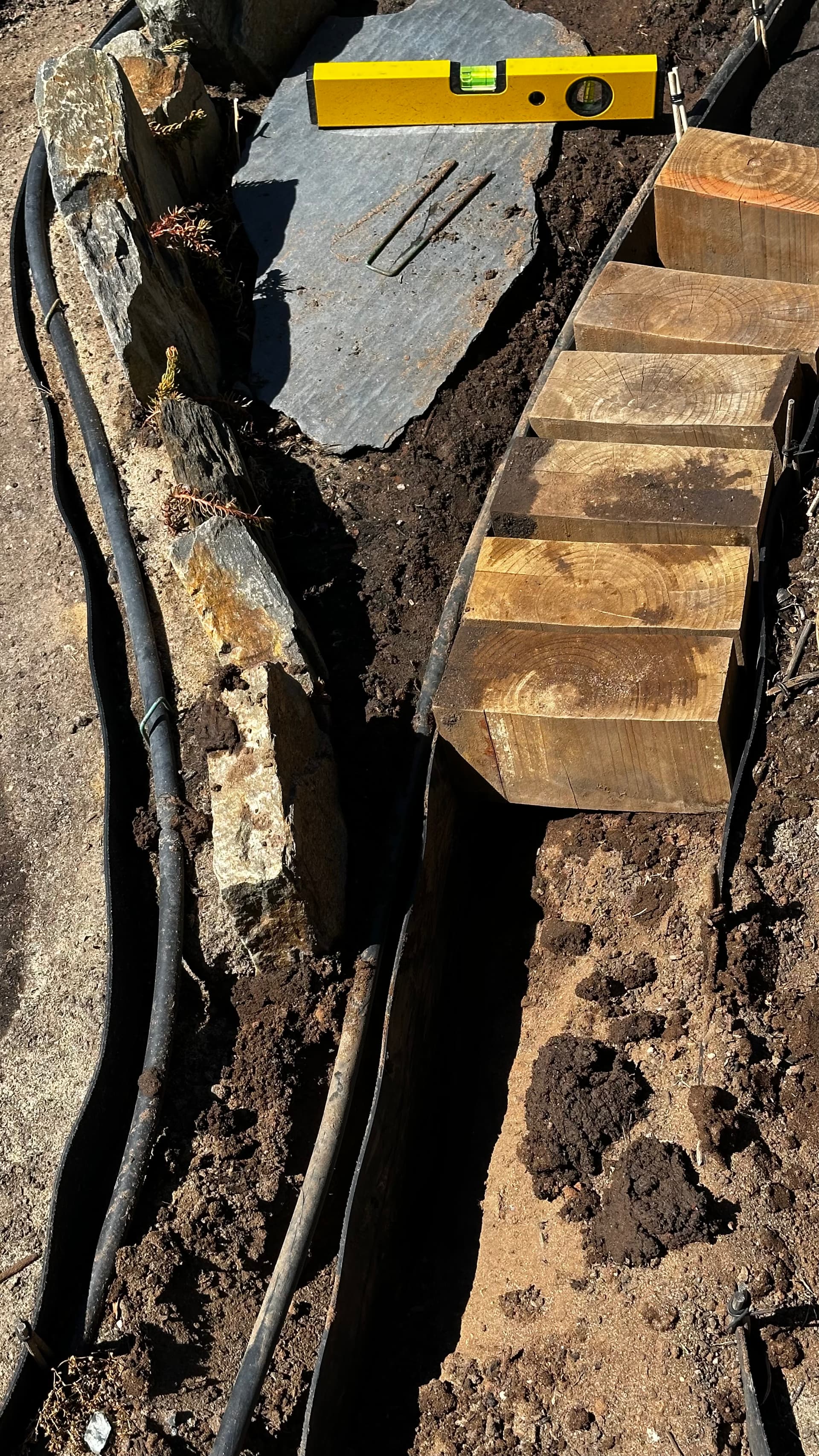

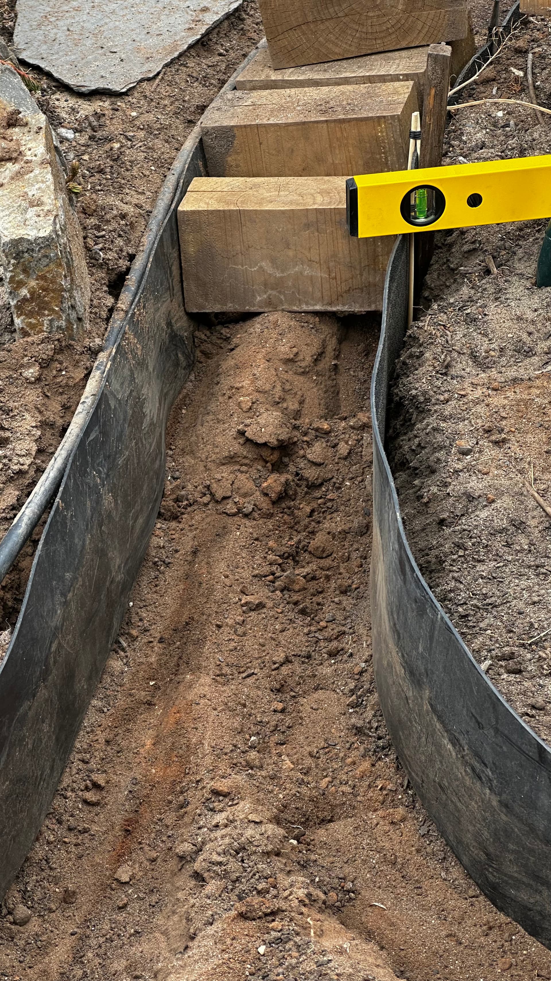

I cut a number of wooden blocks from the sleepers cut-offs that were left over from the vegetable garden bed build.
They space the right of way.
I am using vegetable garden mix sandy loam for the garden and the garden railway it settles, holds, fast but allow roots to weave their way through the soil.
Once I get the spacing, and level correct, I use the stakes and make a slurry to tamp in place.
It is kind of like building a sand castle at the beach, but with much more swearing.

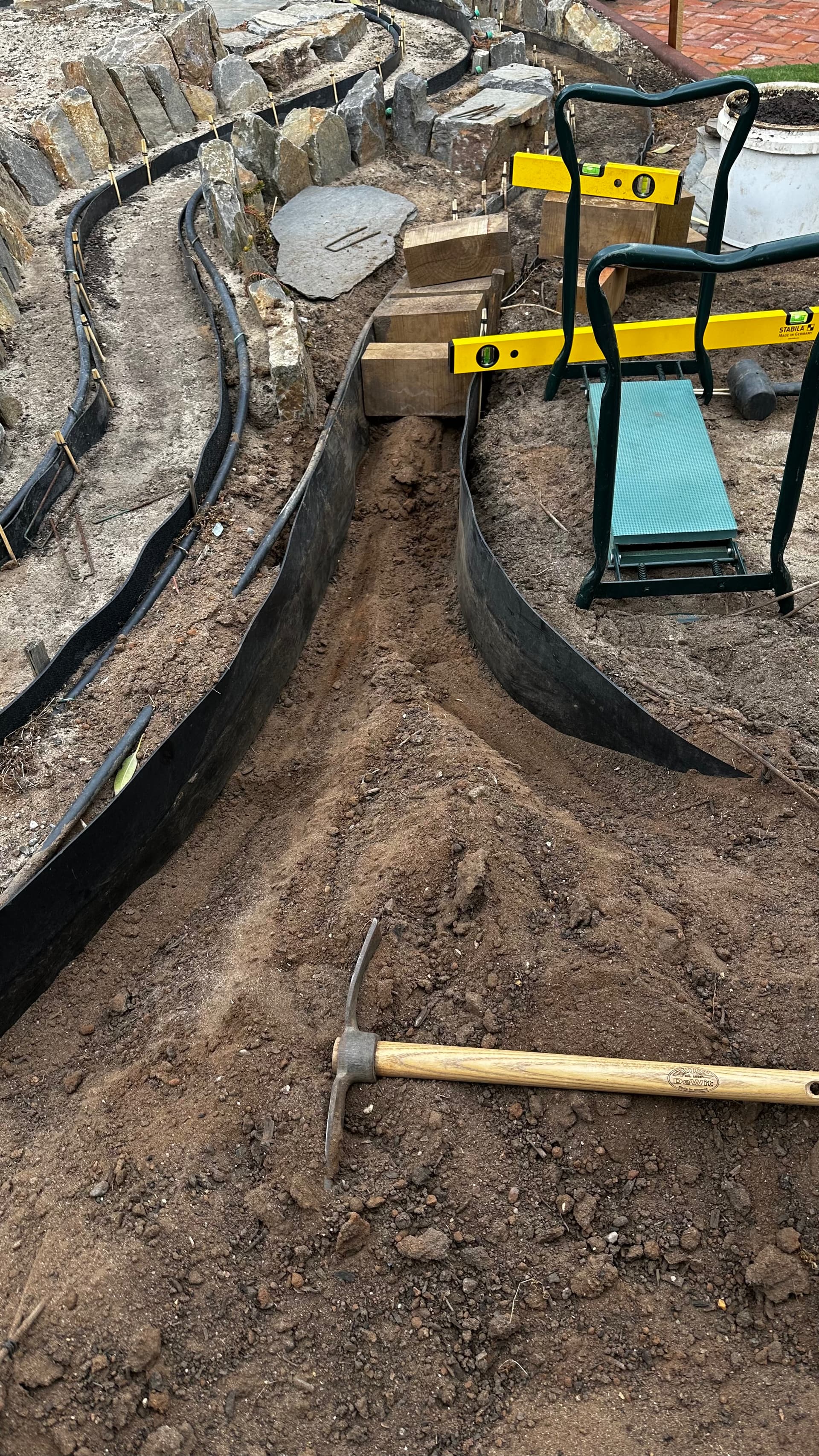

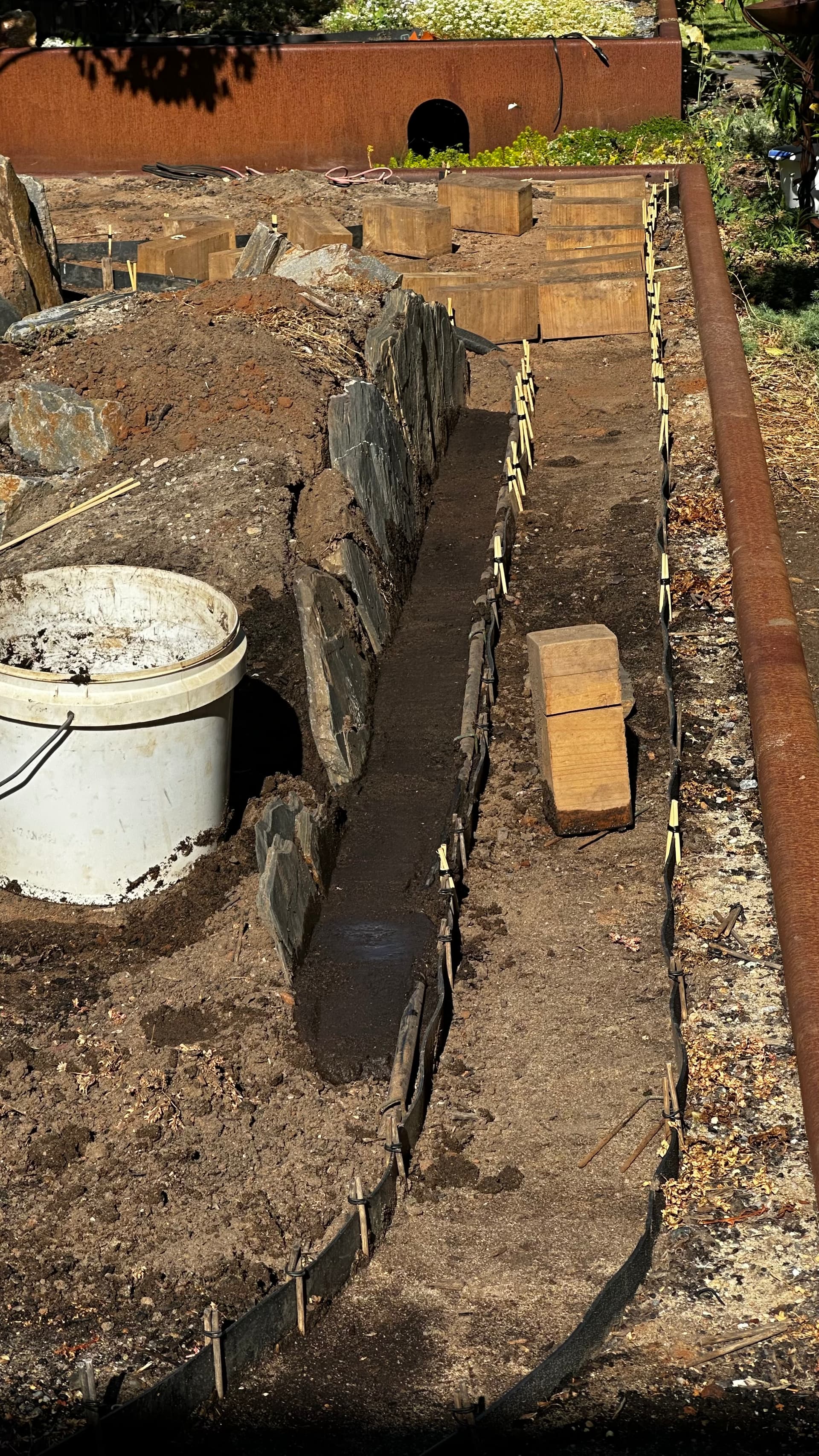

This section pictured here has been the most labour intensive as both sides of the edging came out of the ground
and I am at the maximum length of my level, so need two to get this section finished.

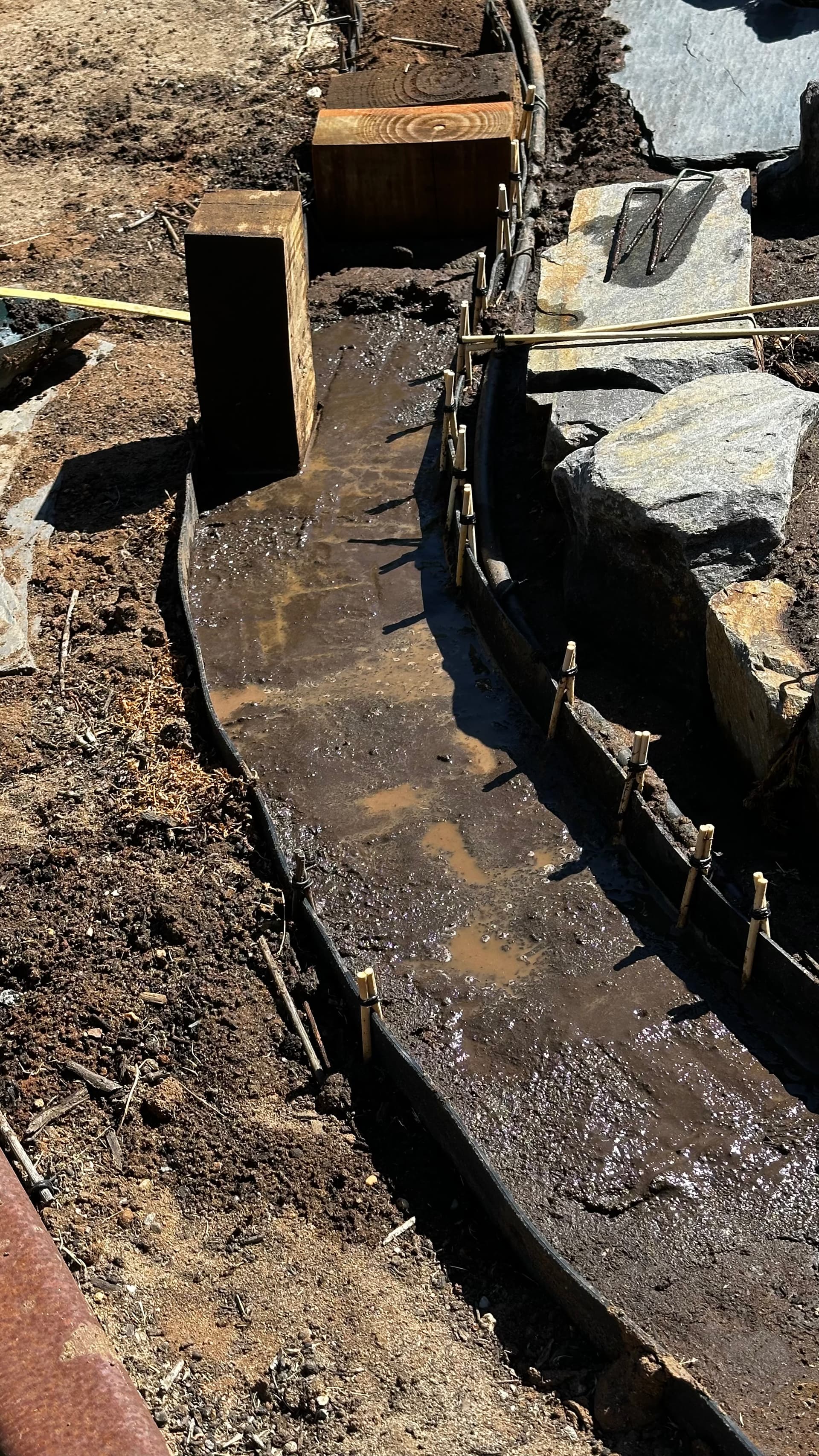

Once I have the spacing correct I pour a bit of the slurry in between the edging strips then try to butter the other sides with the sandy loam.
Then I pat the wet slurry down to get it to settle. Later I will walk in the trench to ensure compaction.
Put the level on a longer straight board. Immediately you have a longer level.

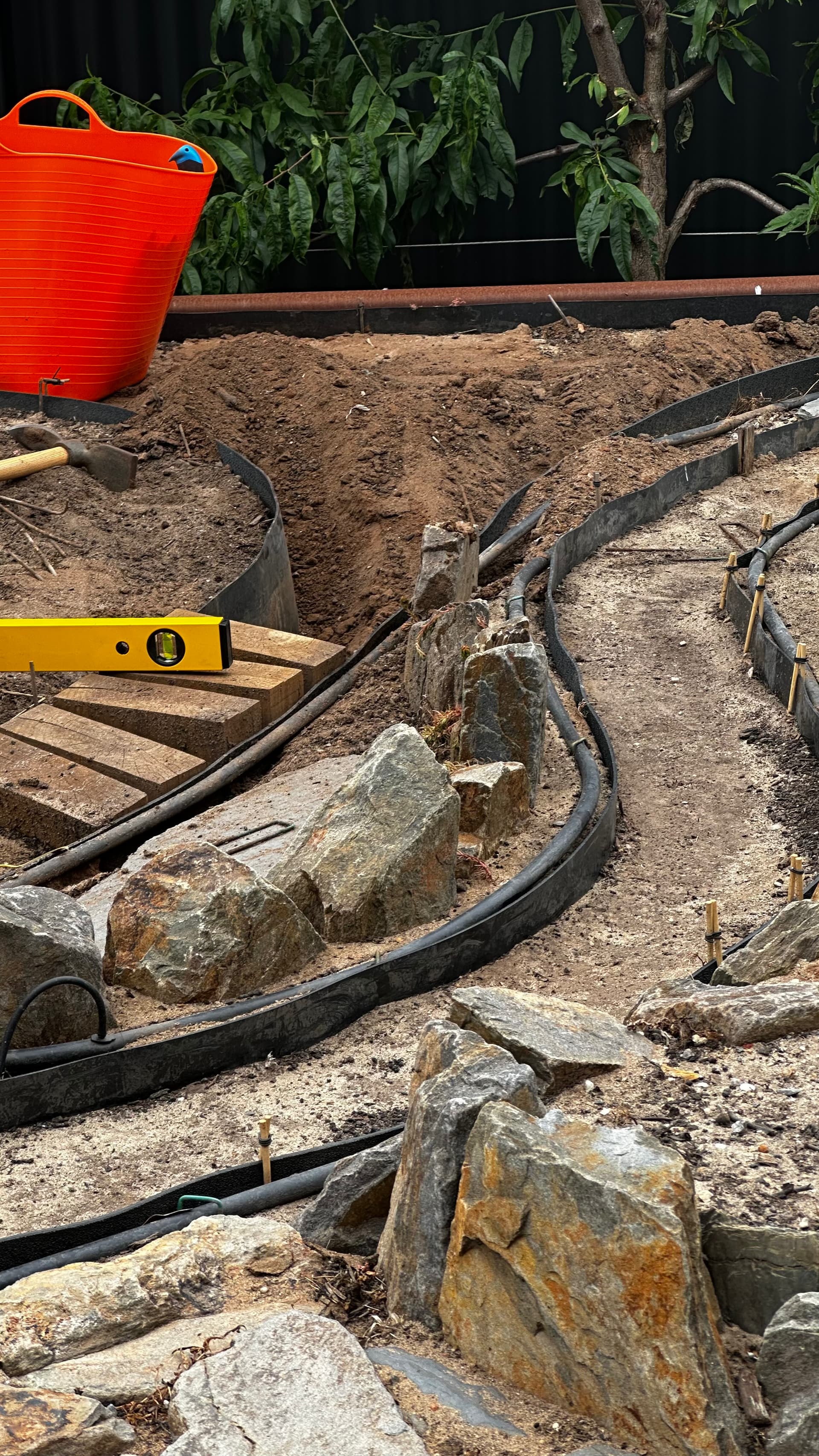

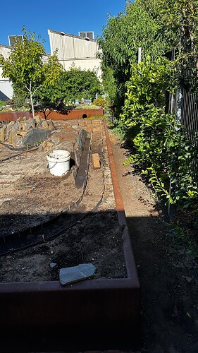

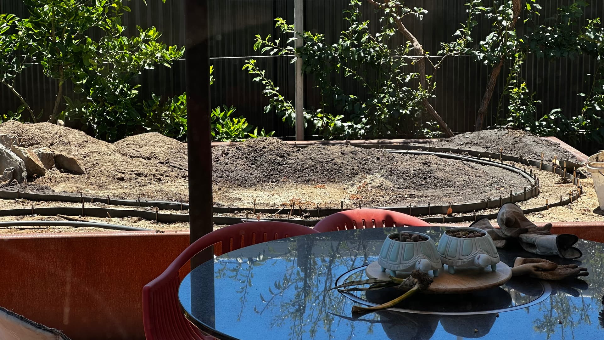

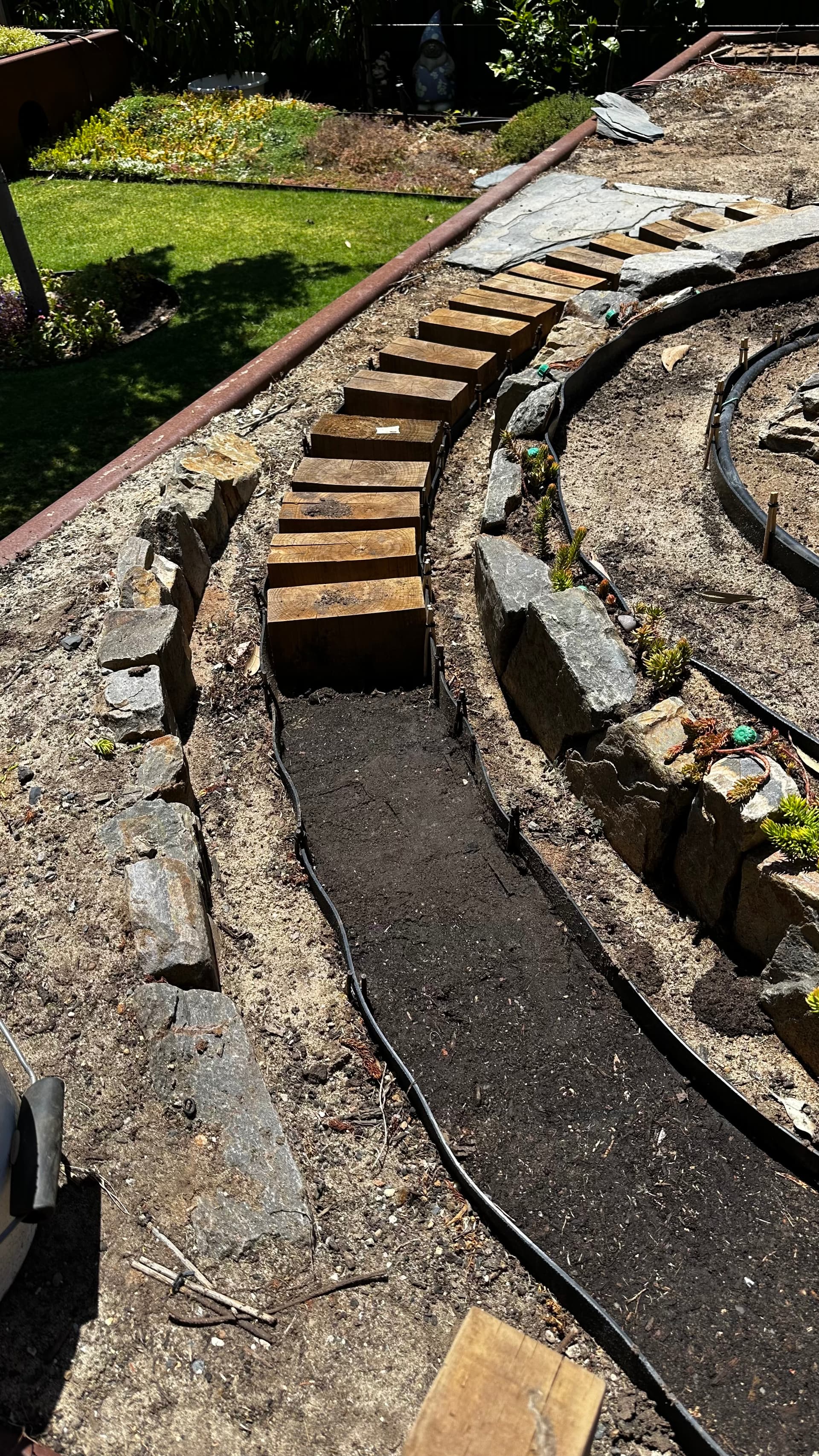

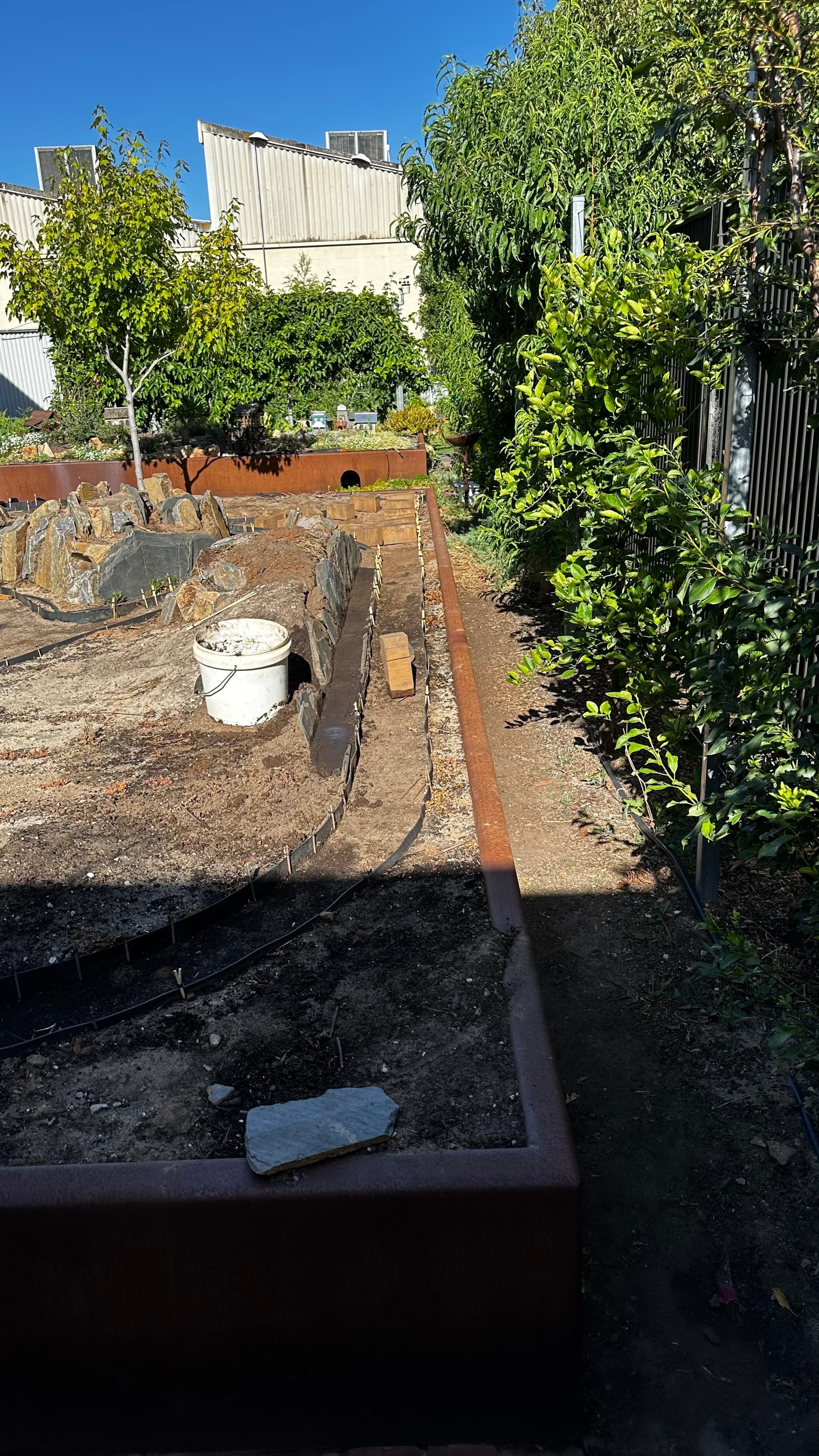

It doesn’t look like I’ve done much on the DĆȘRR in this update, as I’m finding the rebuild of this section of layout is taking a lot longer than expected. I suspect it’s because the soil is mostly a sandy loam variant. When dry it’s quite hard, yet it behaves nicely once hydrated, so I’ve been remixing the garden soil a bucket of water to make it workable.
There has been some diacritical issues as well. Korm, so far the umlauts are holding up as promised, but as Eric predicted they’re now making a lot of noise in the heat. I really wish I’d known about kahakƍs earlier. However I do understand that there could be future problems with the track lay lei.
And of course, since I’m disturbing the soil anyway, I have found that I couldn’t live without improving some minor eye sores so I have straightened out and extended the mountain cuts, as I’ve repaired the future road bed.
Additionally we have been breaking state temperature records every day. This week’s temperature hit 46 °C (115 °F) and that hasn’t really helped the build either. However, by the end of the week it will be NZ’s problem. Apologies Neil, but the rain you’ve been complaining about is going to clear right up.
Adding insult to injury during the re-vamp I’ve managed to chop the watering system in two places, and lost a few plants. I’ve learned the hard way that Herself was right to roll her eyes when I purposefully buried the irrigation pipe 2–5 cm below the soil surface. So I’m now raising it up wherever I can as I go along.
As I write this I notice that I’m finally having whimsical thoughts, like wouldn’t it be nice to be working on something else indoors? Perhaps I should have started a MIK project
