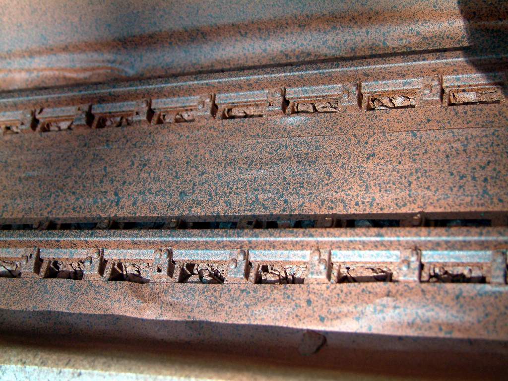

I used real rust…
See below.

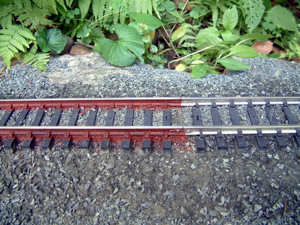

For use outside I use a mix of Rustoleum rusty metal primer (which to my eye is too red to be used alone) and mix in Rustoleum yellow til it looks good to my eye. It comes very close to matching Floquil rail brown which I used when I worked in HO.
What is interesting about rust is there is not definitive color. Rust varies with several different factors. The age of the rust will change it’s color. The alloy of the steel (all rail is not necessarily of the same alloy) will affect the color. The weather conditions and location (ie inland away from water, near a lake, or salt water) will affect the color. Acid rain will affect the color. So in my opinion, the color that looks right to your eye, is the right color.
I agree Bob, and I think the photo Forrest linked to says the same thing. Even the inside and outside rails of the same track in the same location can vary in color.
Me; I’m basically too lazy to mix up that perfect color. I use a Red Oxide or Ruddy Brown spray can primer to get a solid color then mist with a semi-gloss or flat black to darken the red and suggest some staining from grease & oil…
Far from perfect, but easy and looks a boatload better than the shiny stainless or aluminum rail I use. Looking around the railroad this spring, I think I may have to do this again. It’s been almost 15 years!
John Caughey said:
I used real rust…
It continues to age and change color with the weather.
While not as easy as paint, I like it.

I like it too! If I had the time and the patience I’d use that method too. Not sure how well it would hold up in a wet climate though. I’ve used the rust solution on my concrete walkway crossing several times and it fades away in less than 6 months. Your method is a little more involved than my attempt at just slopping on some solution with a paint brush.
