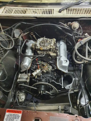

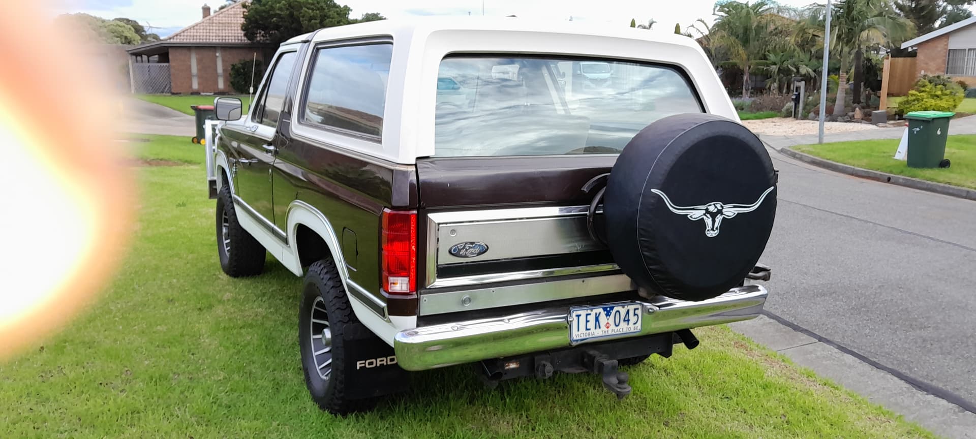

This is on day one 5 years ago. Had been sitting in a shed for 11 years before I got it. During the rebuild I have had 2 heart attacks and now have end stage kidney failure. Hence the reason for taking five years and also why you good people have not seen me. Just been to plain sick to do anything.
!982 Ford Bronco. 351 Cleveland C6 auto.
20220901_153712|690x455

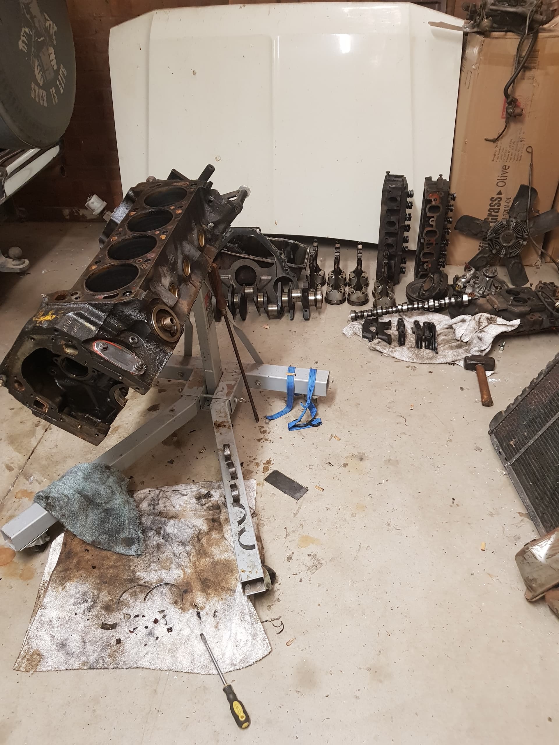

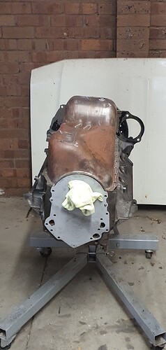

the engine teardown

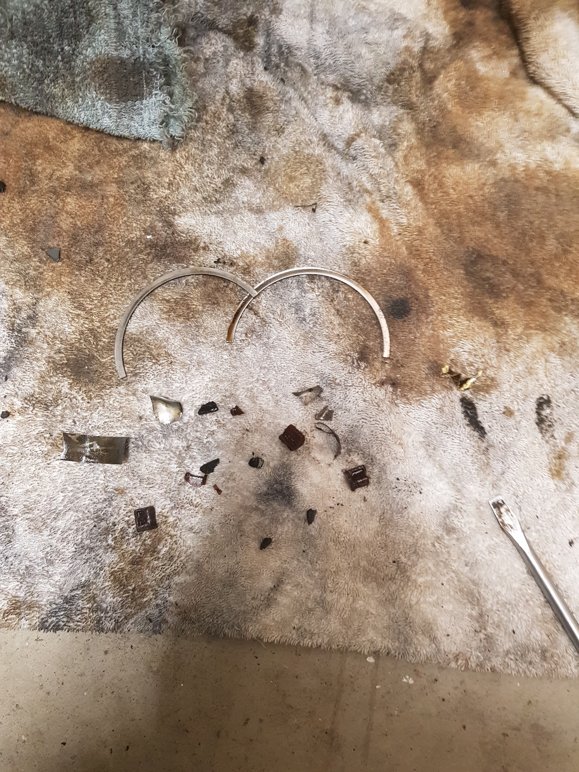

Wat was found in the sump

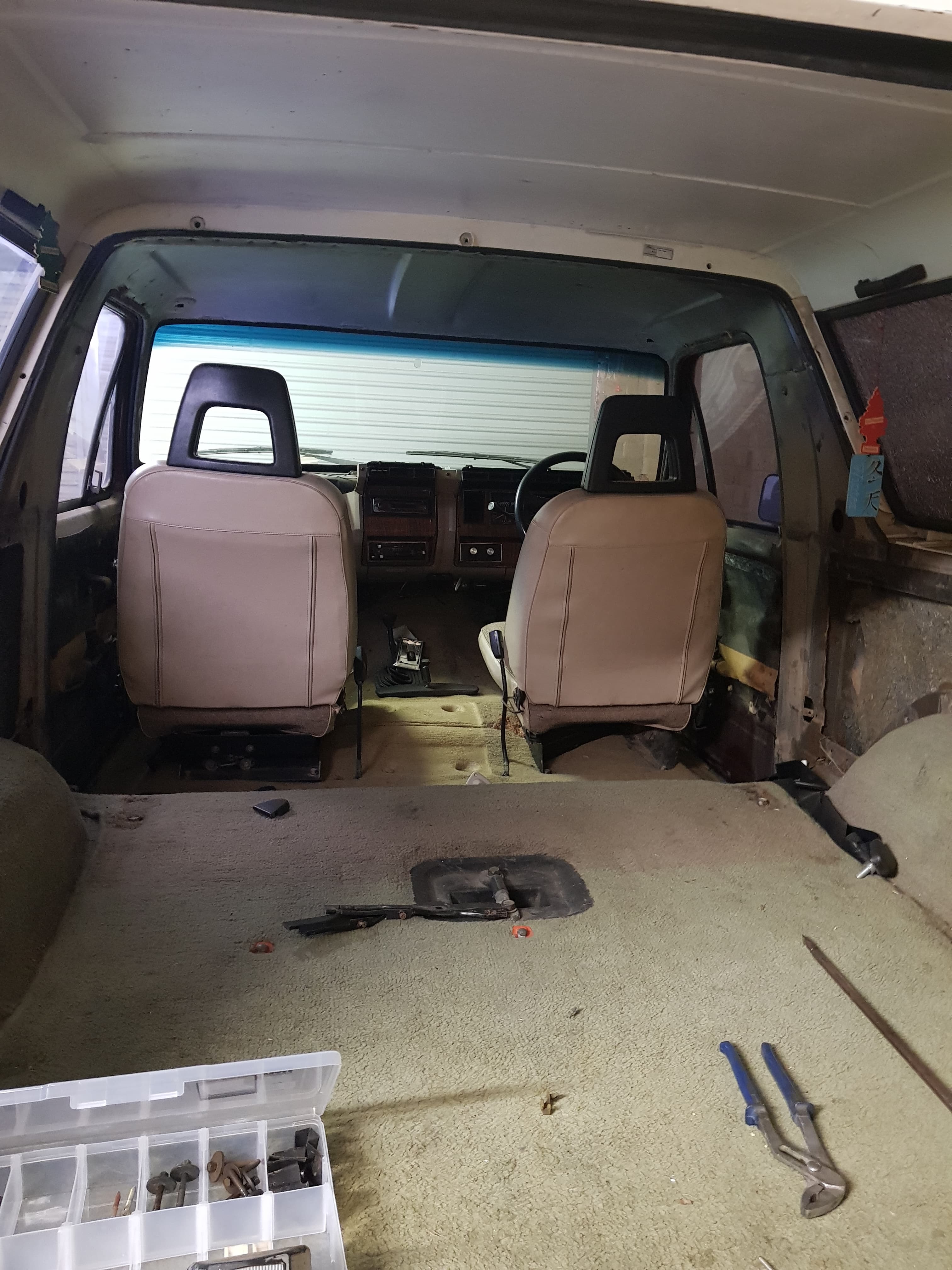

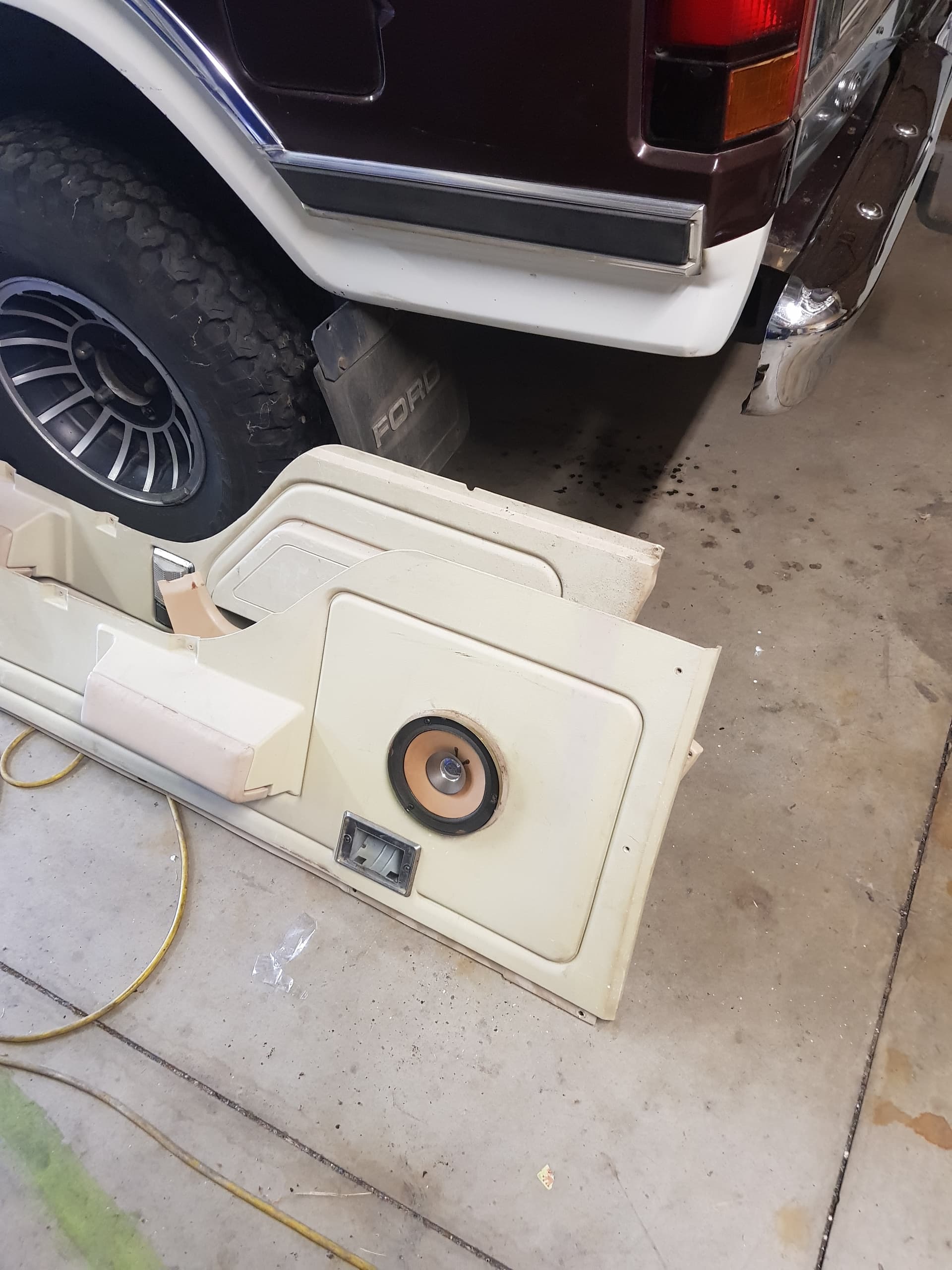

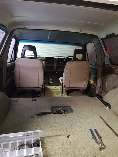

Gutting the interior while the bottom end was away getting rebuilt.

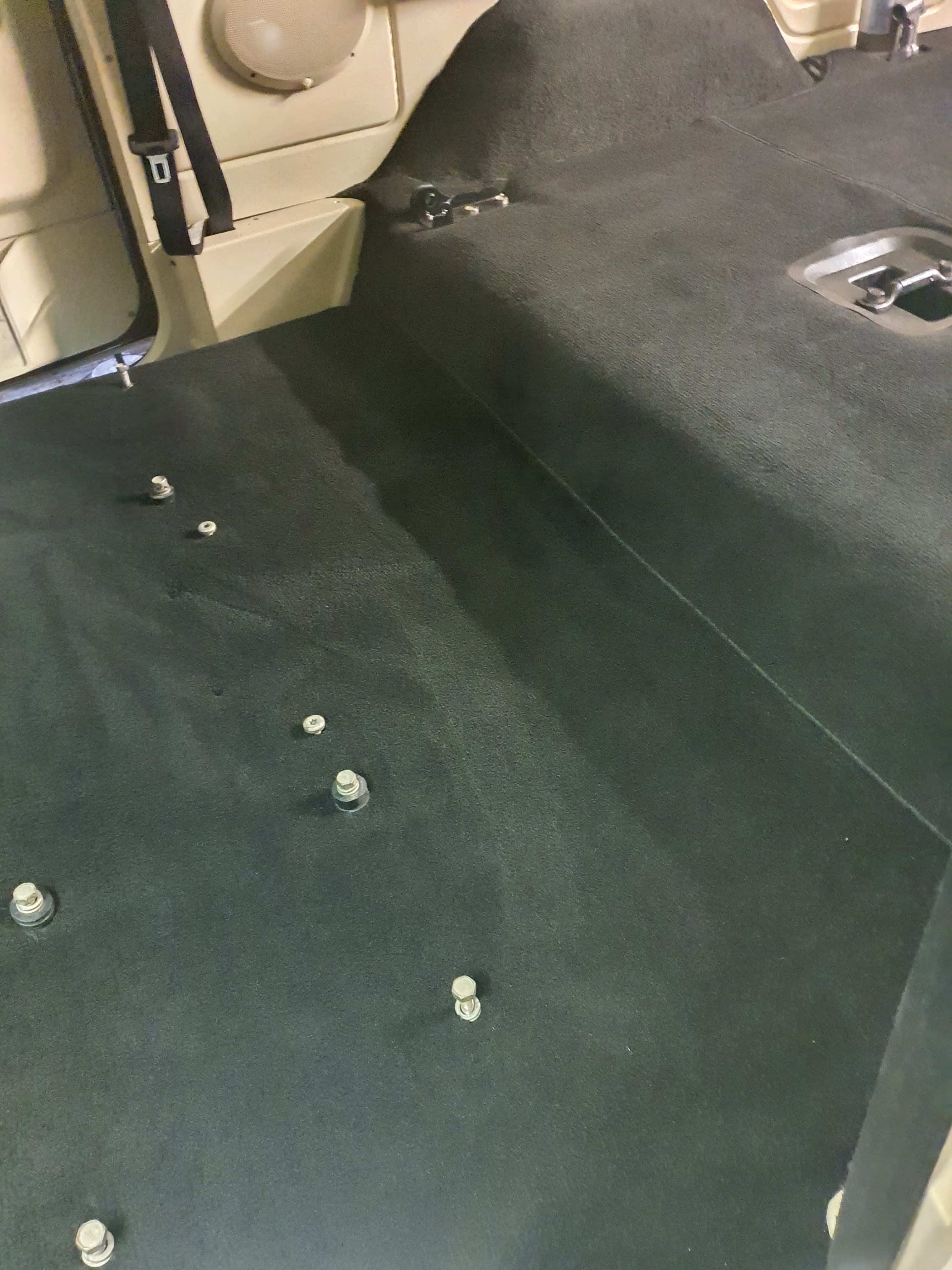

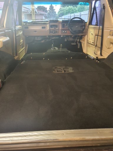

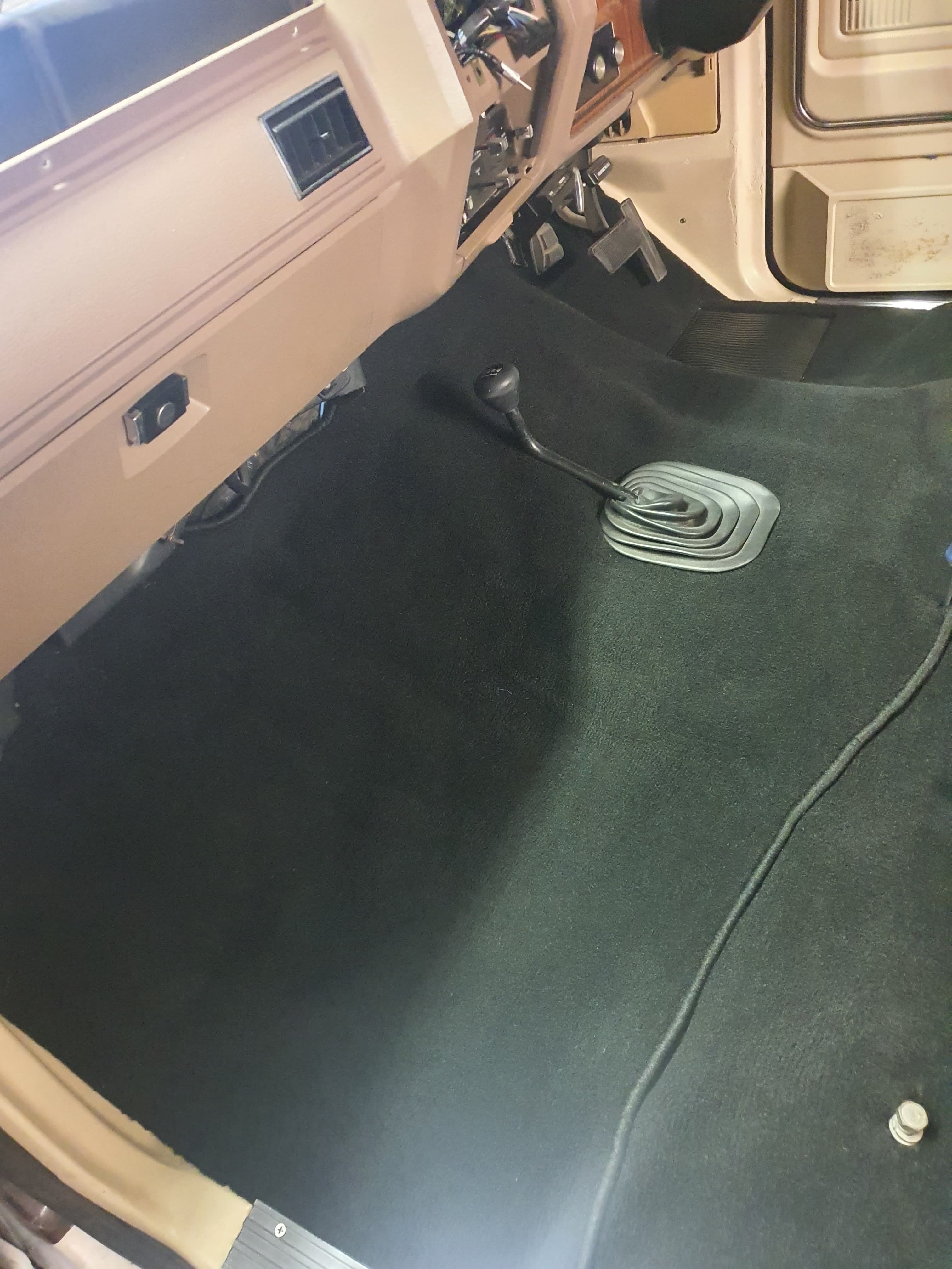

New carpet being installed

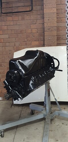

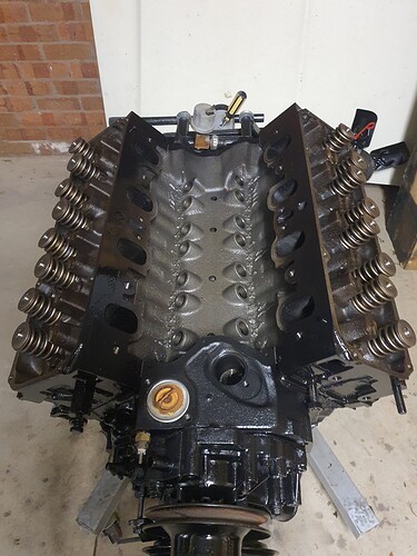

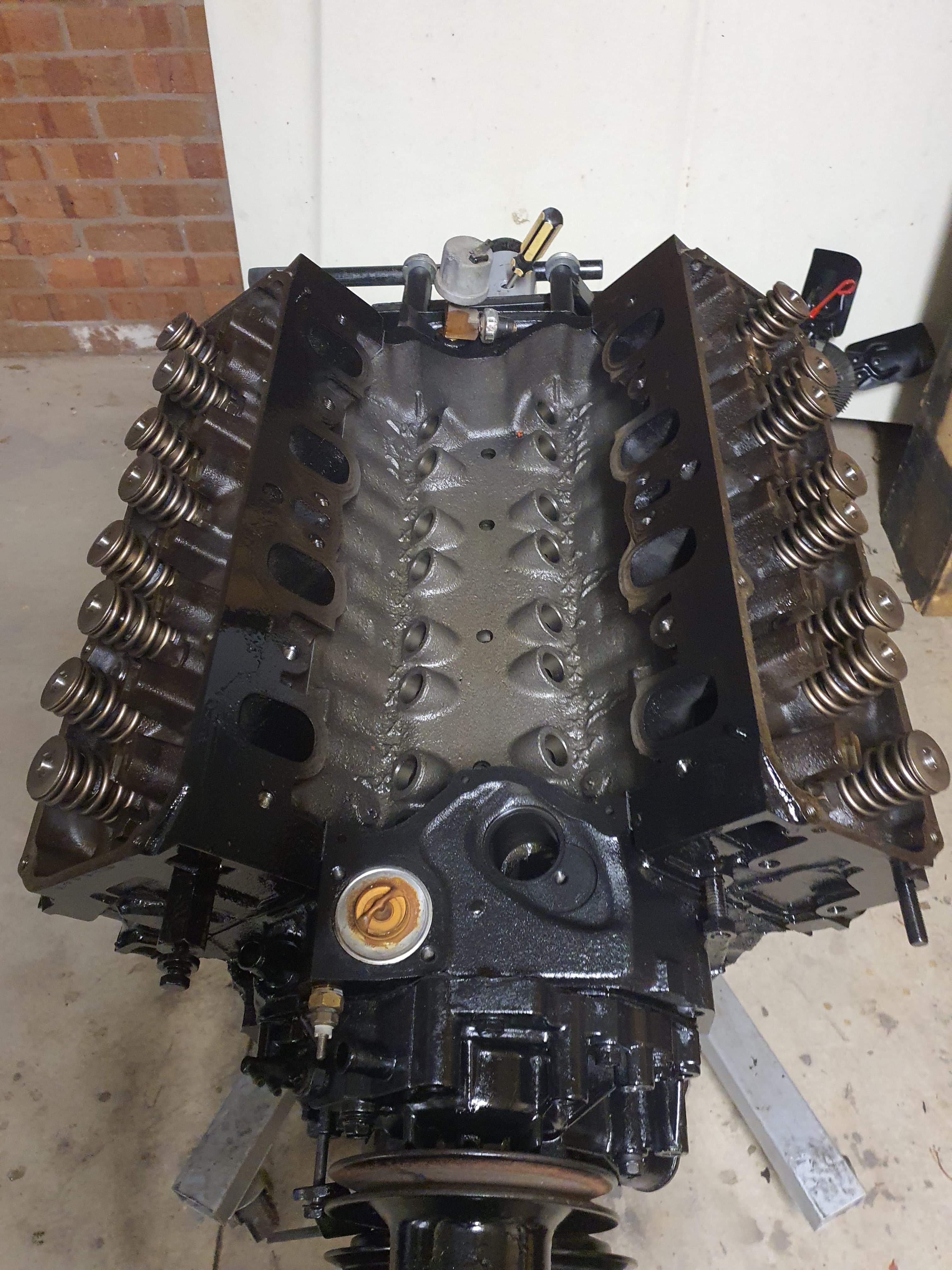

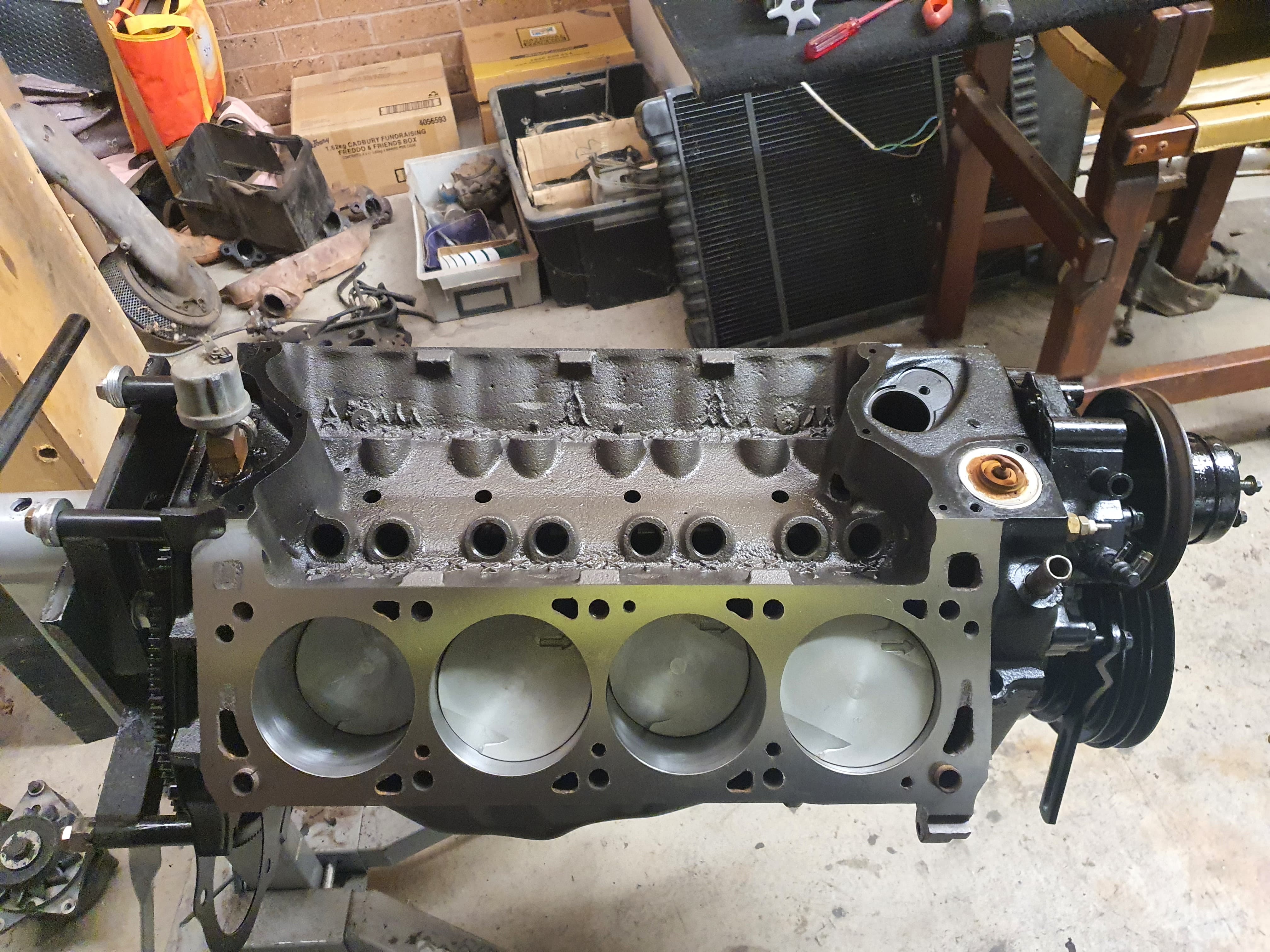

The bottom end returns after 6 grand outlay

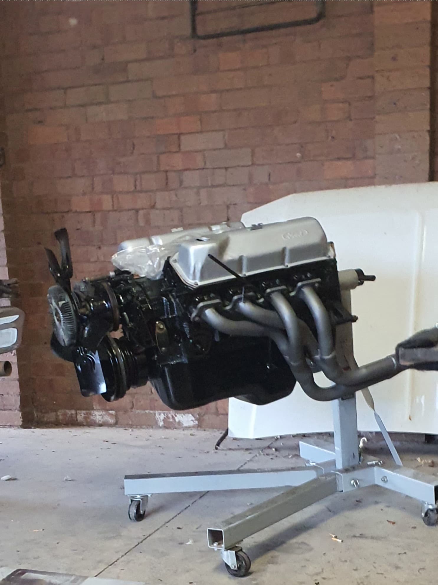

Crank grind new pistons 20 thou over, Better cam to wake it up but not to stupid lumpy, Crank was balance to 4 grams bob wieght at 10 thousand RPM, resized and balanced rods , I could go on but you get the picture.
All finished and ready to go back in. Heart attack number one hits.

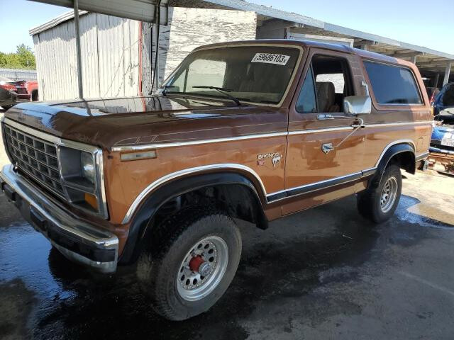

I had an 81 Bronco in two-toned brown. Basically this:

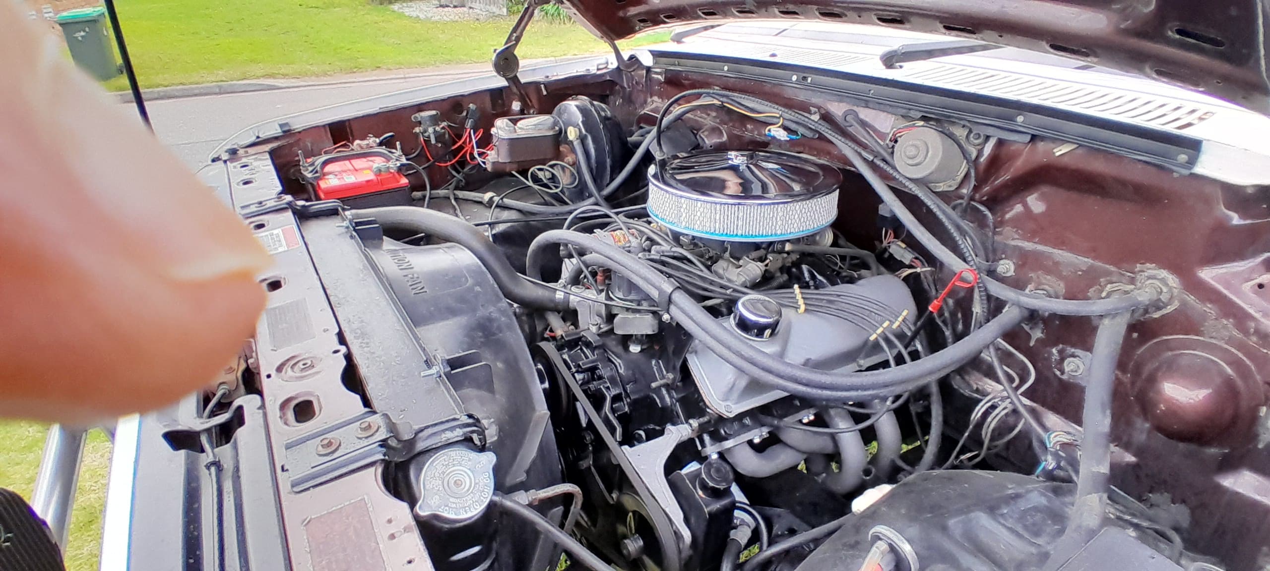

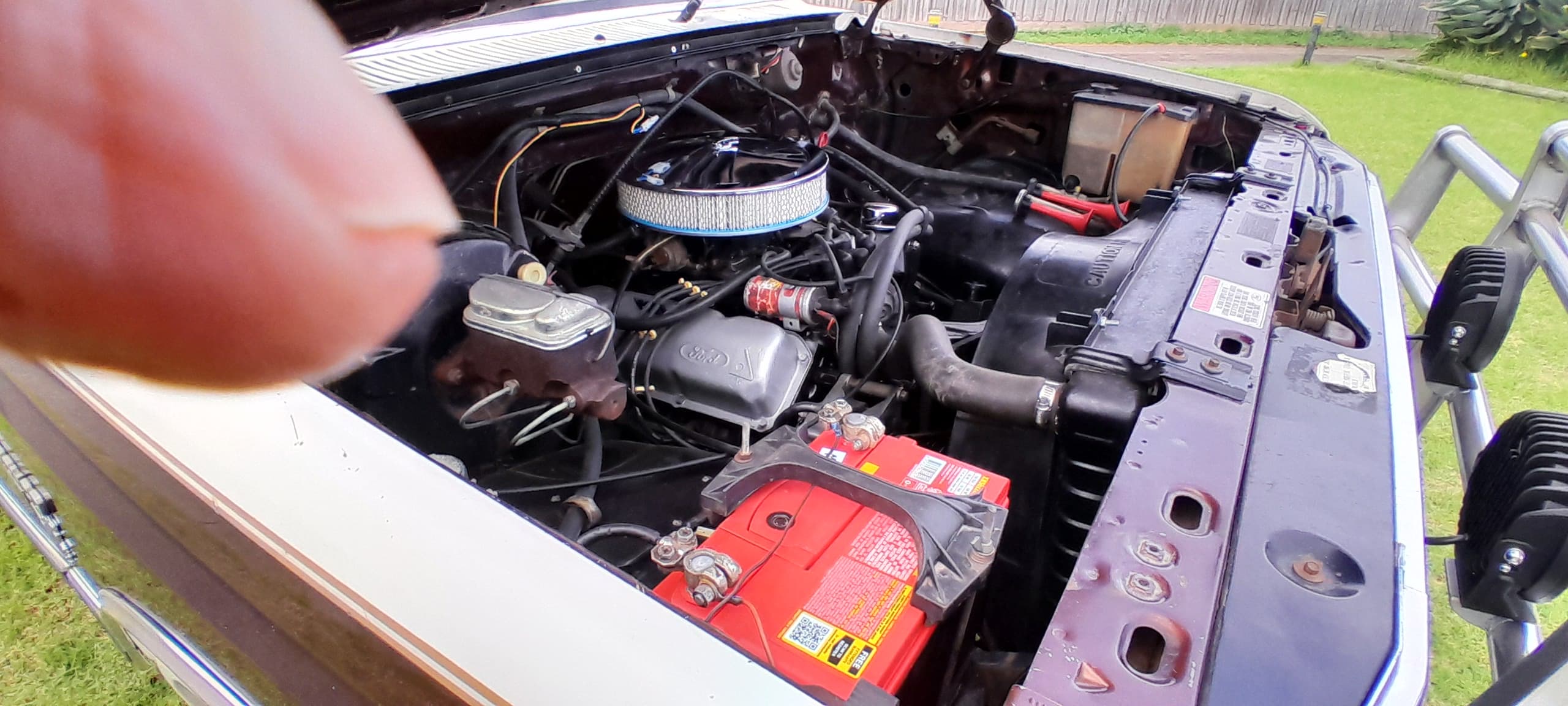

The Cleveland goes in and it looks small in that engine bay
cam break in. No exhaust system after the headers and the garage doors all shut. I did warn the neighbours that this was for about 40 minutes

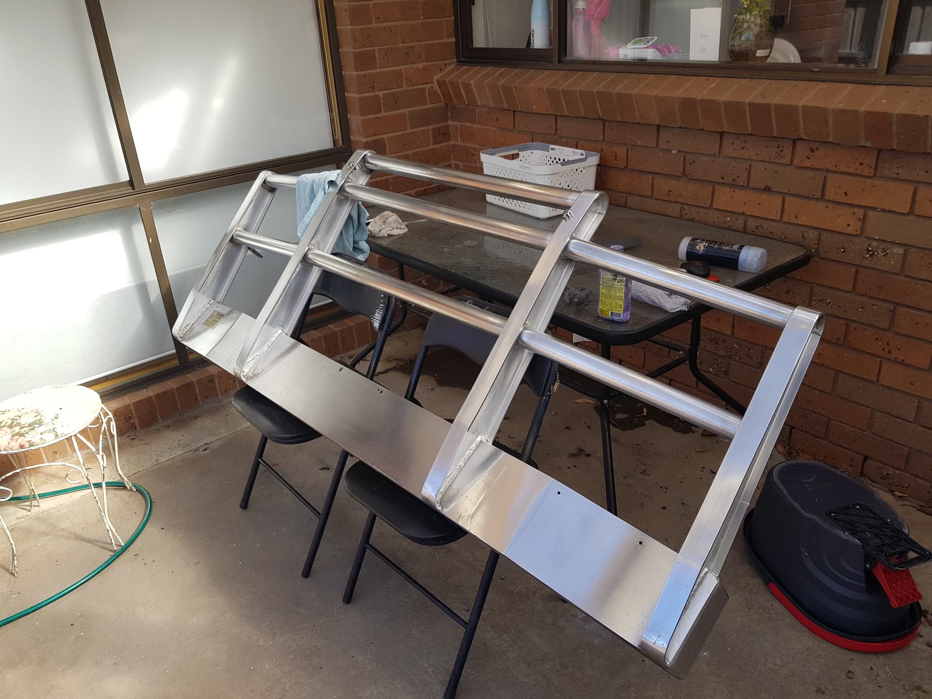

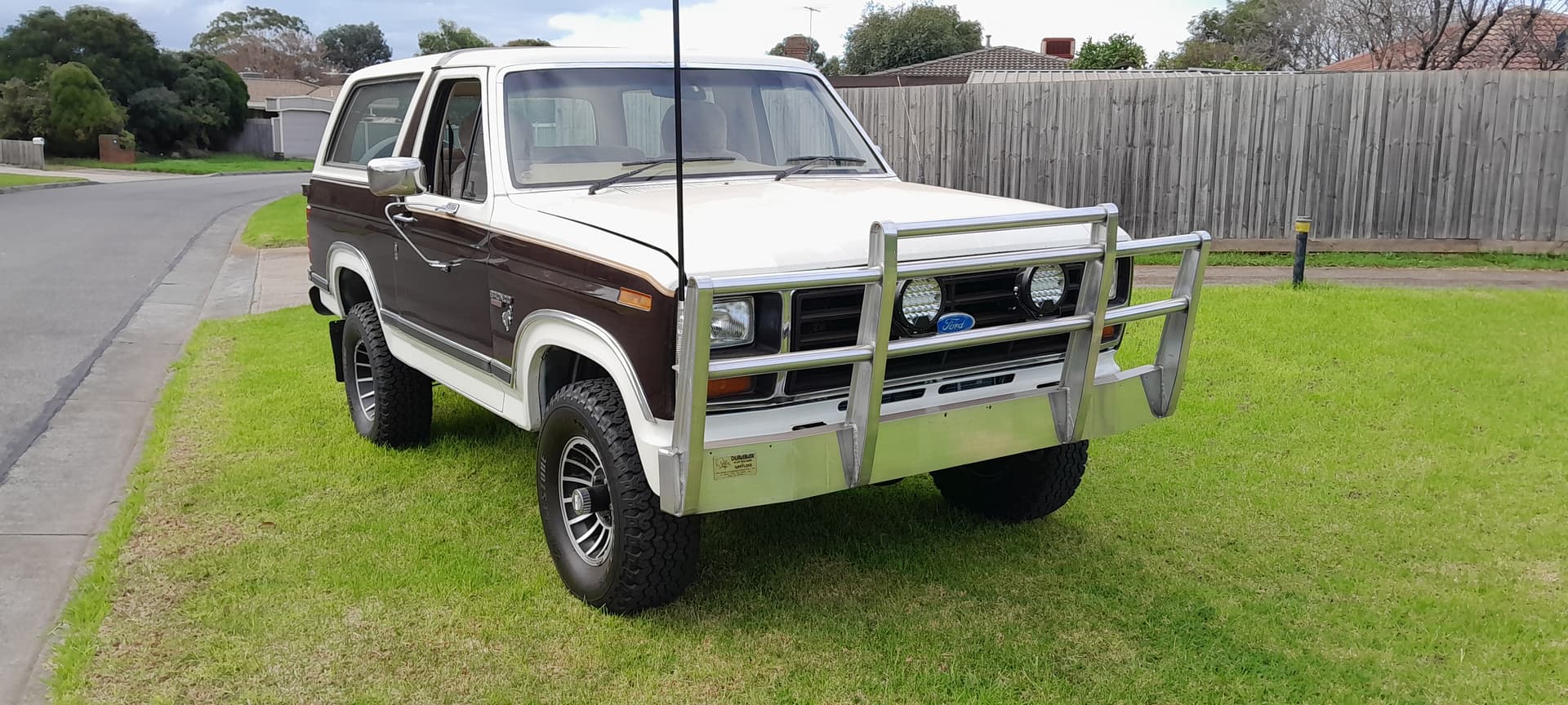

The Bull bar after hours of cleaning with WD40 but not yet polished

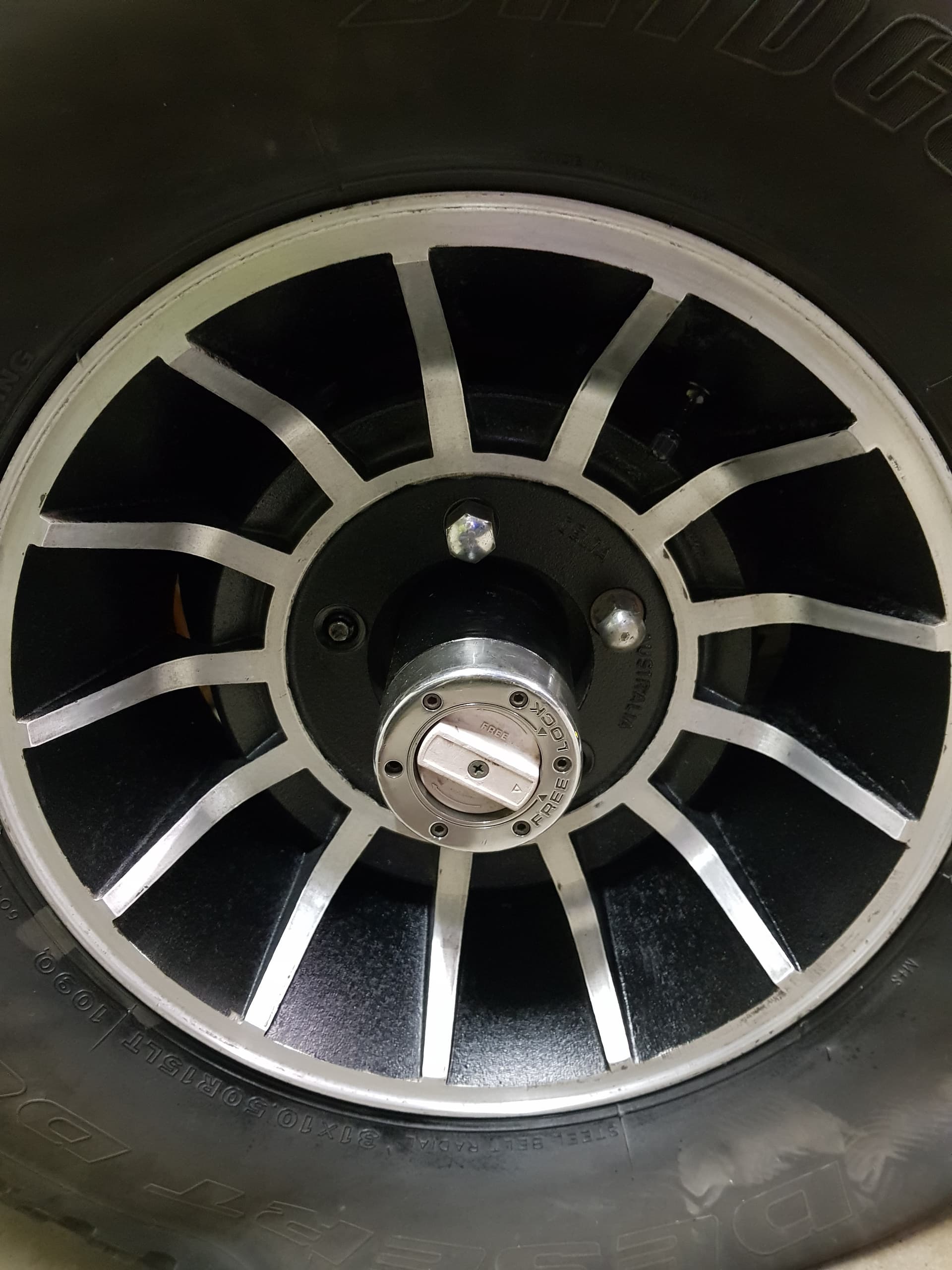

These Hurricane rims were an absolute nightmare to clean up. They are almost impossible to find these days.

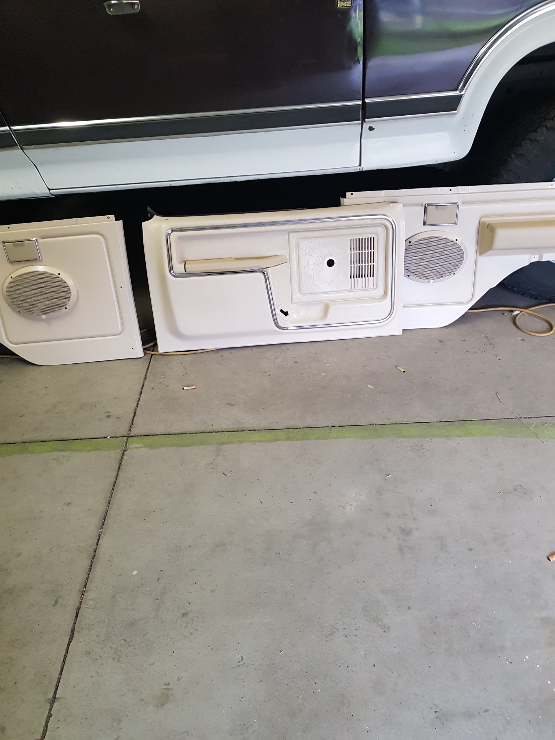

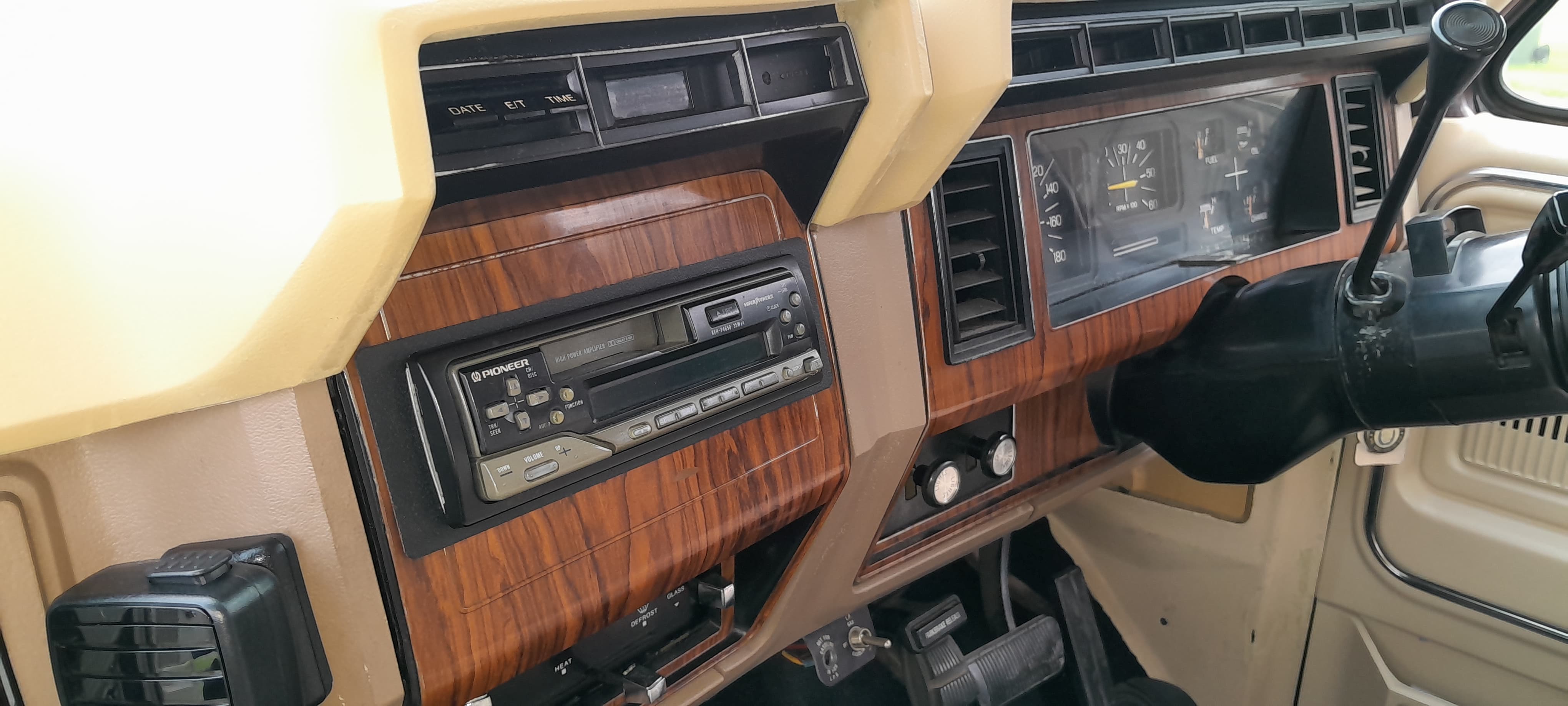

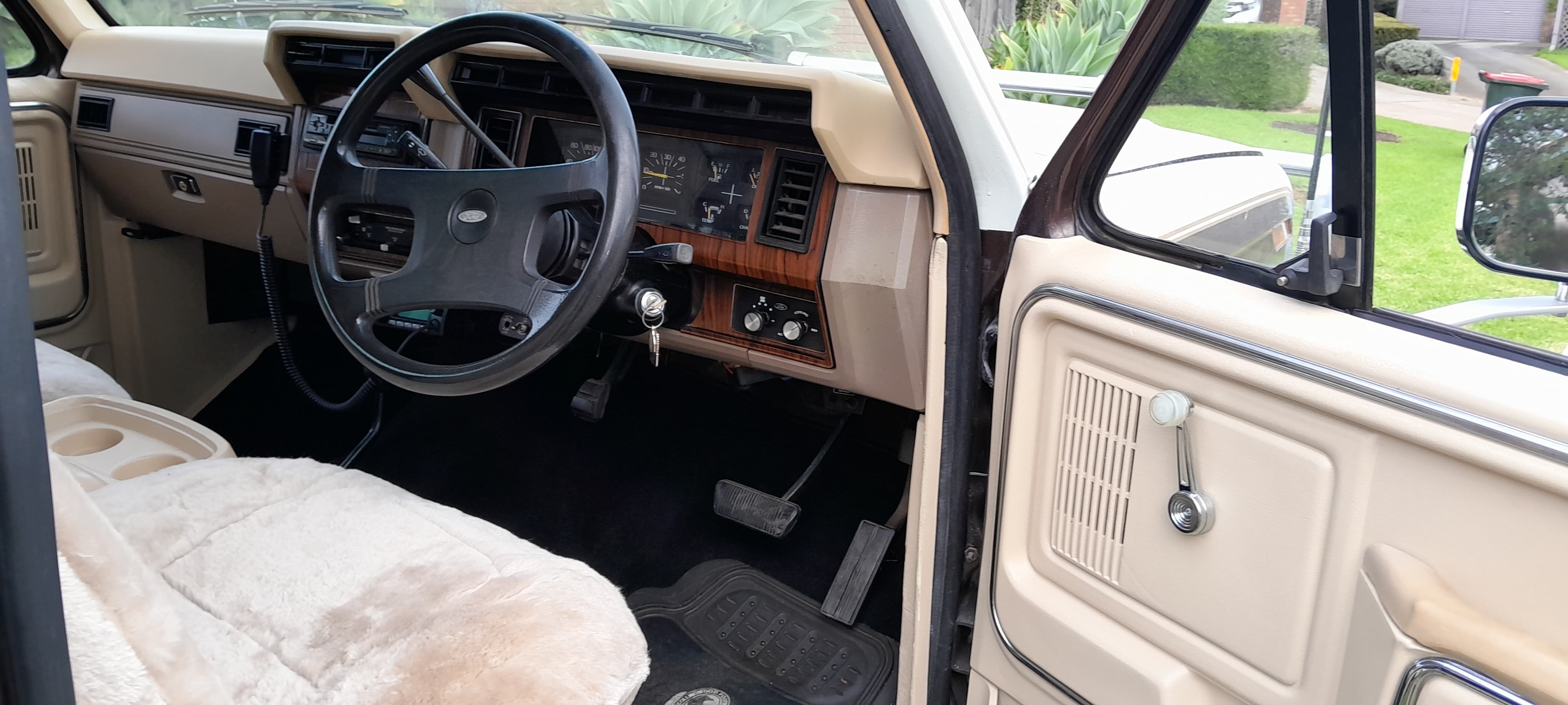

All the interior trim was resprayed the same color as original with a special paint supplied by Western Paints here in Melbourne.
Before
After

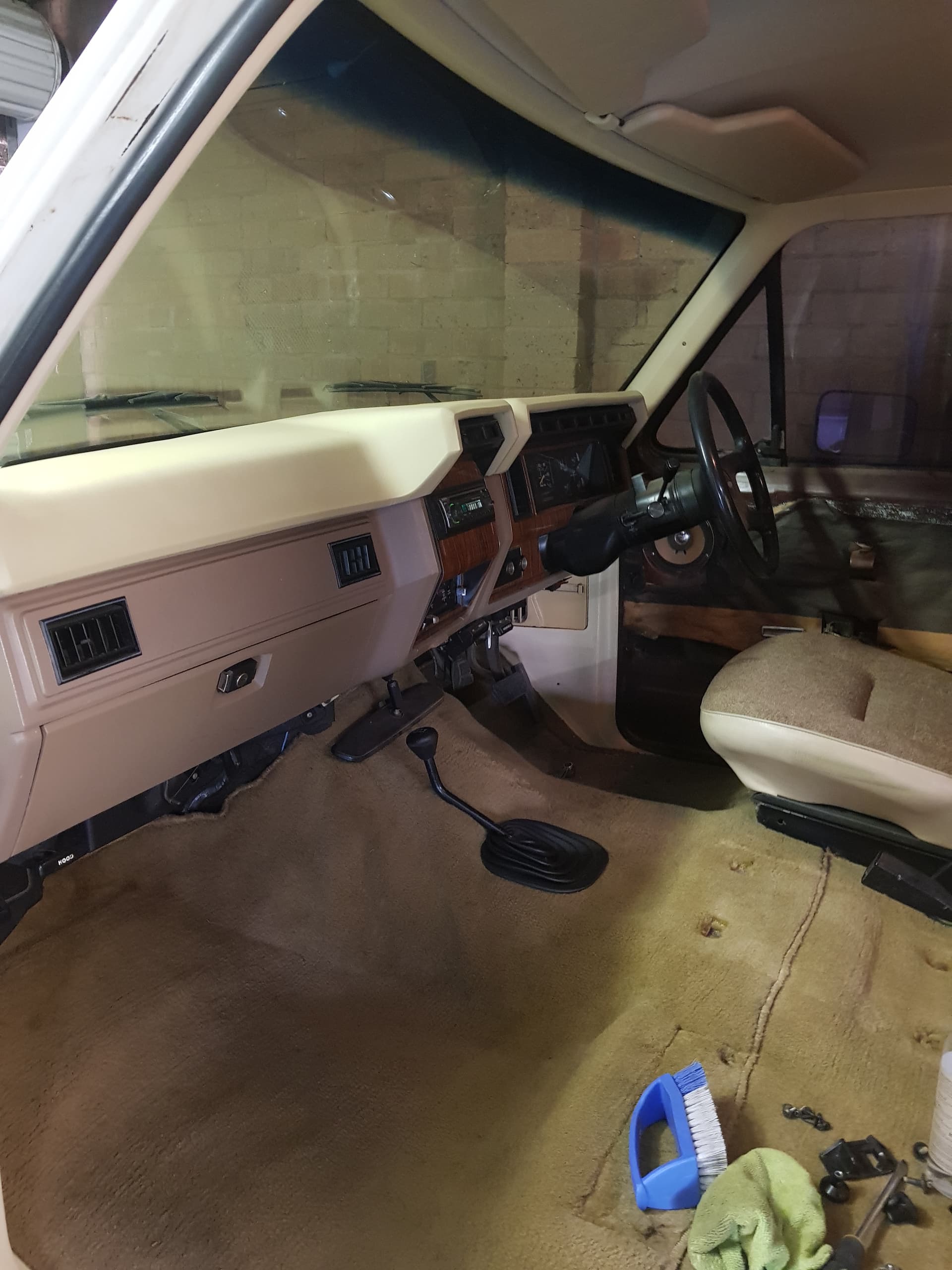

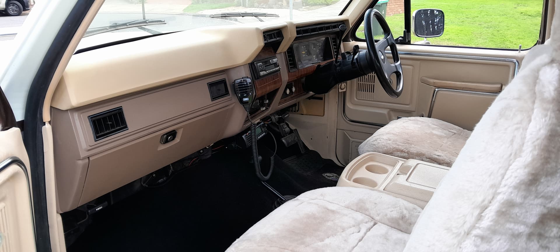

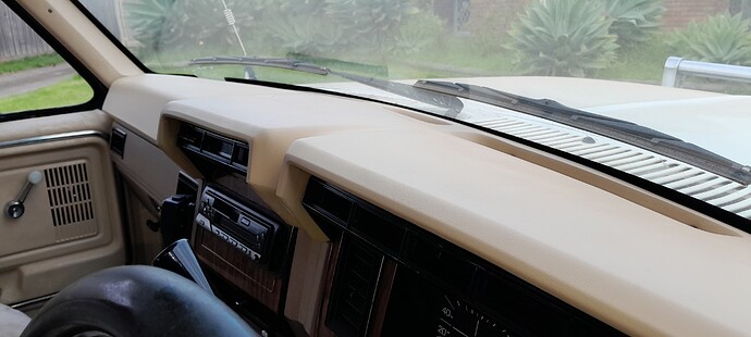

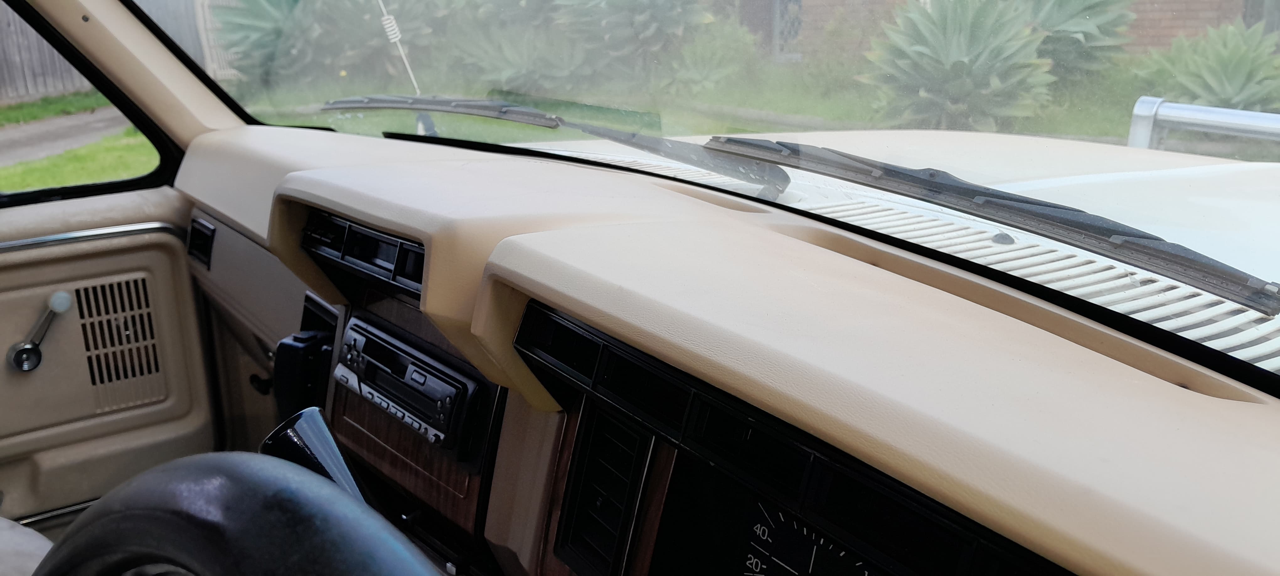

I was very lucky with the dash pad as it only had a minimal crack in it right in the centre near the screen
Crack repaired and resprayed

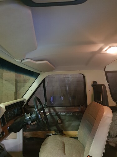

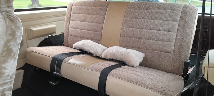

New headlining. This is cloth like late model cars and not vynil

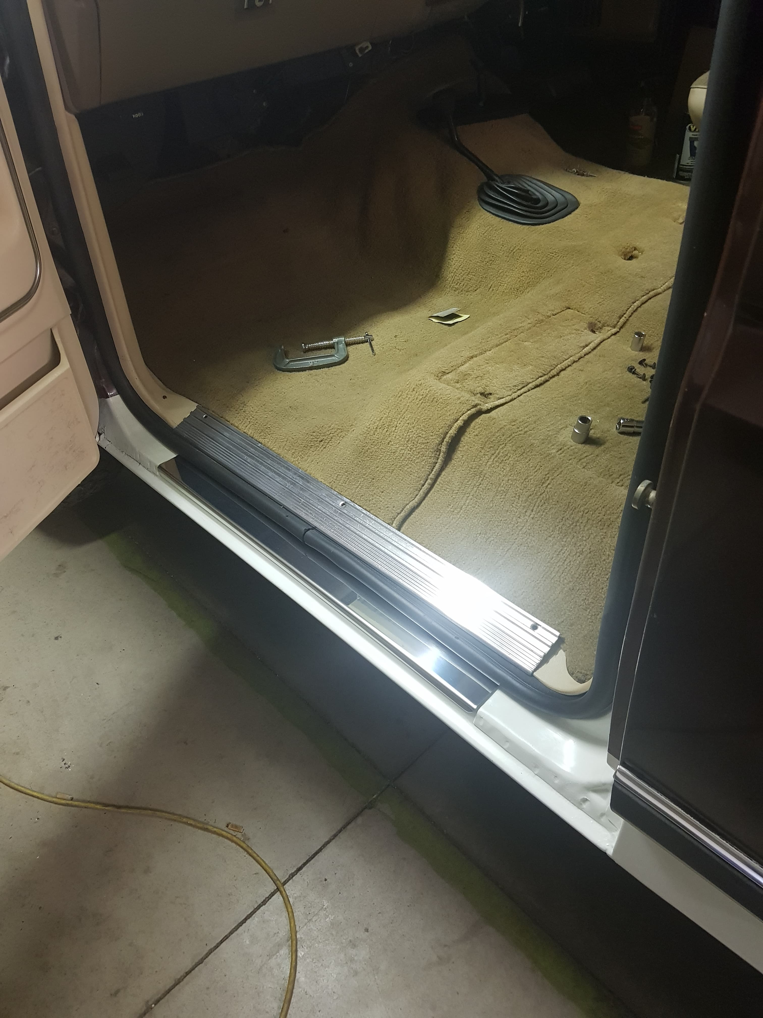

New door rubbers and that stainless step guard was a lucky find. I got the last pair available here in Oz.

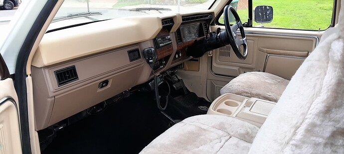

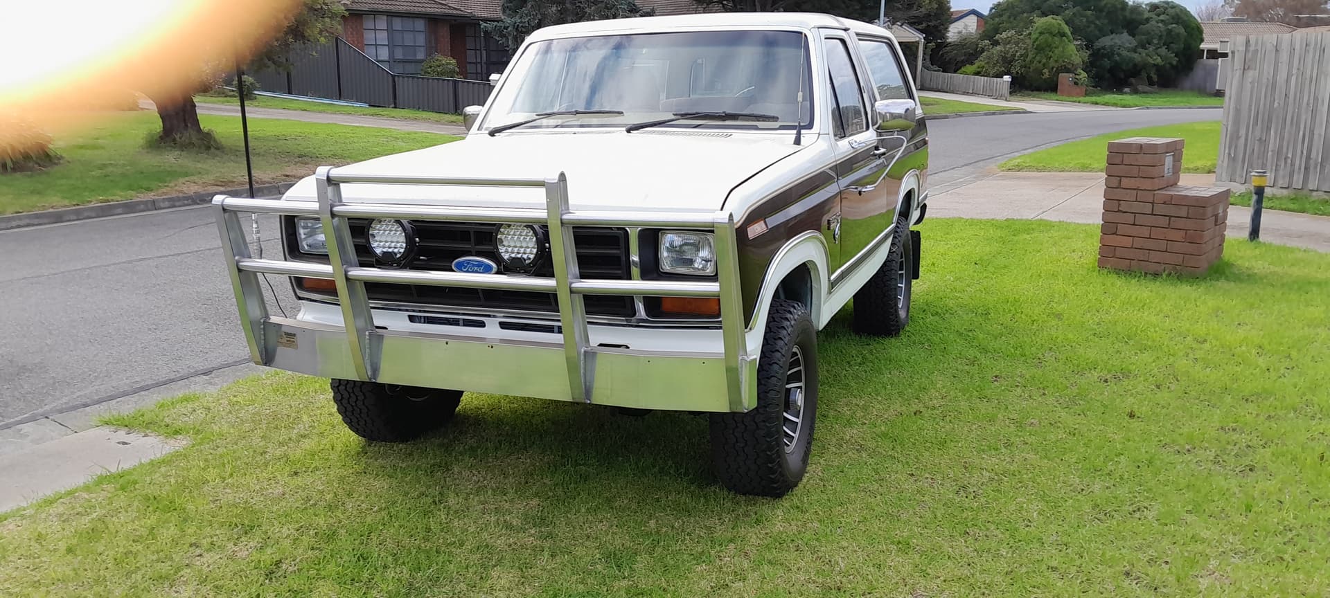

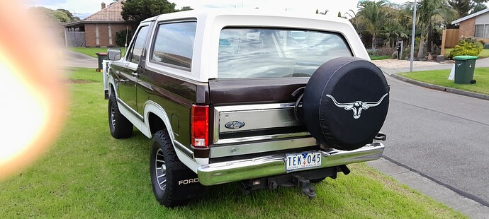

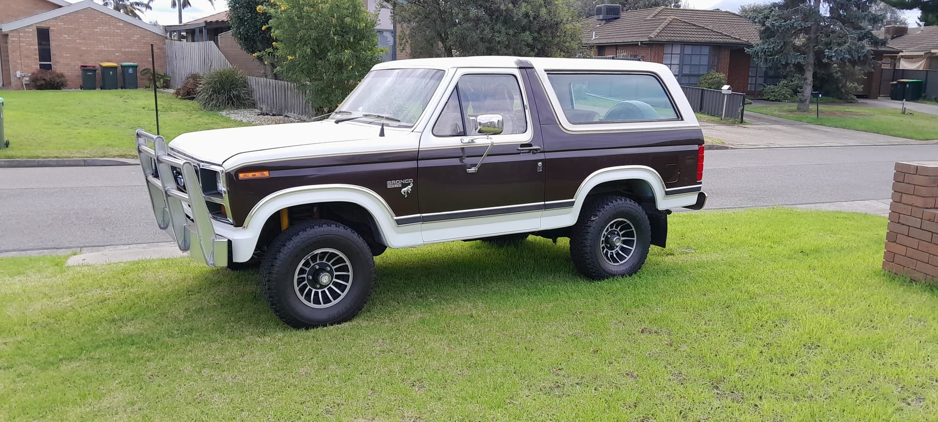

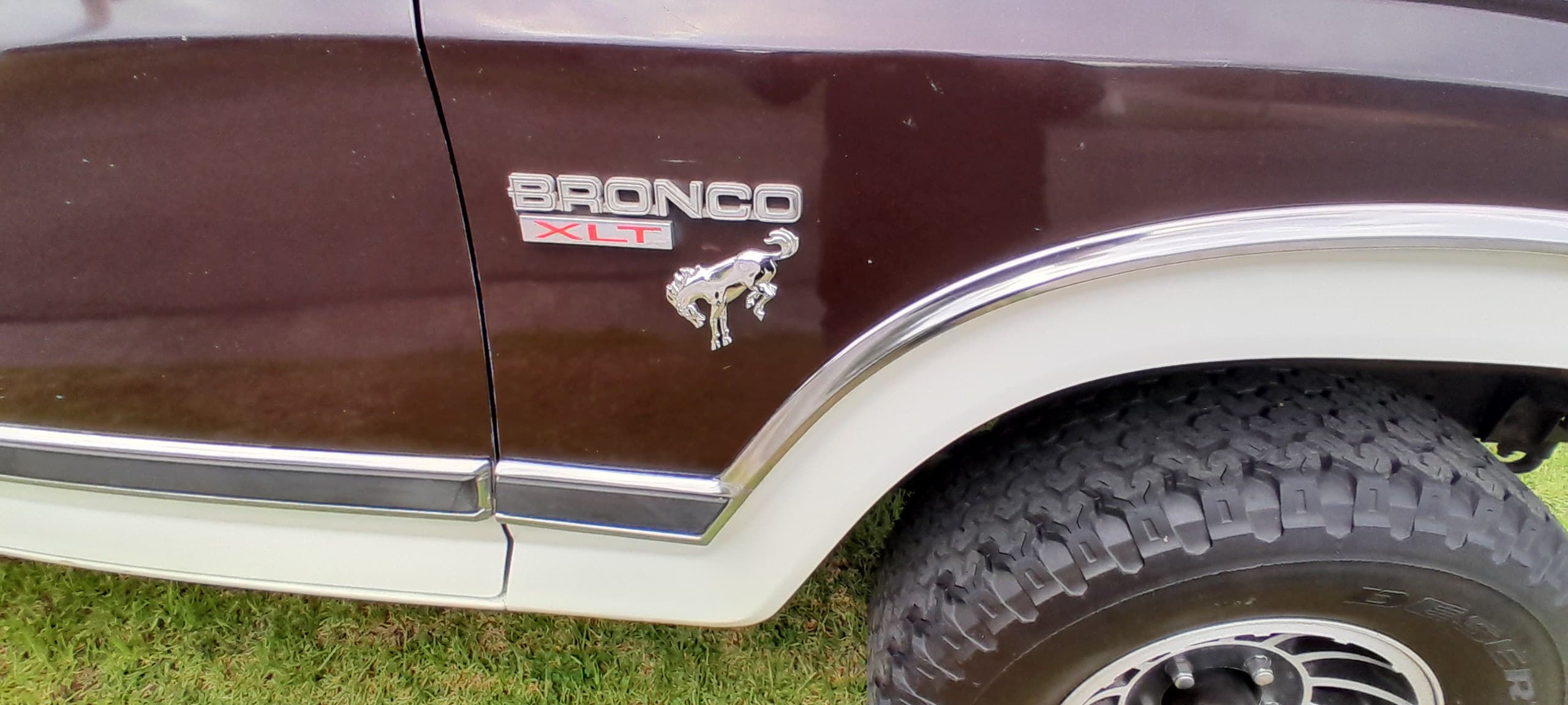

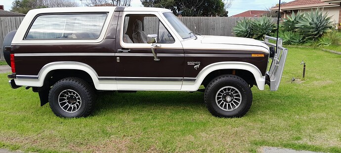

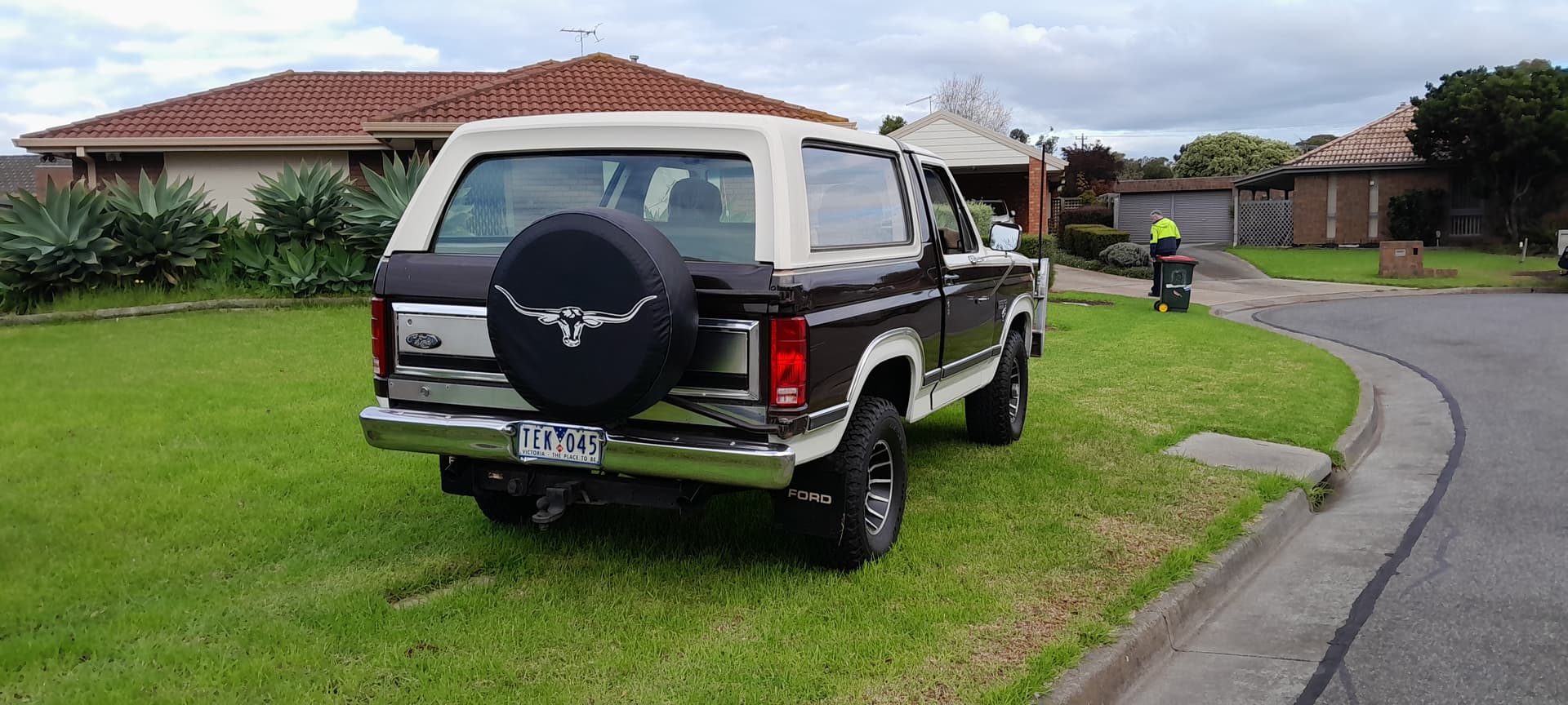

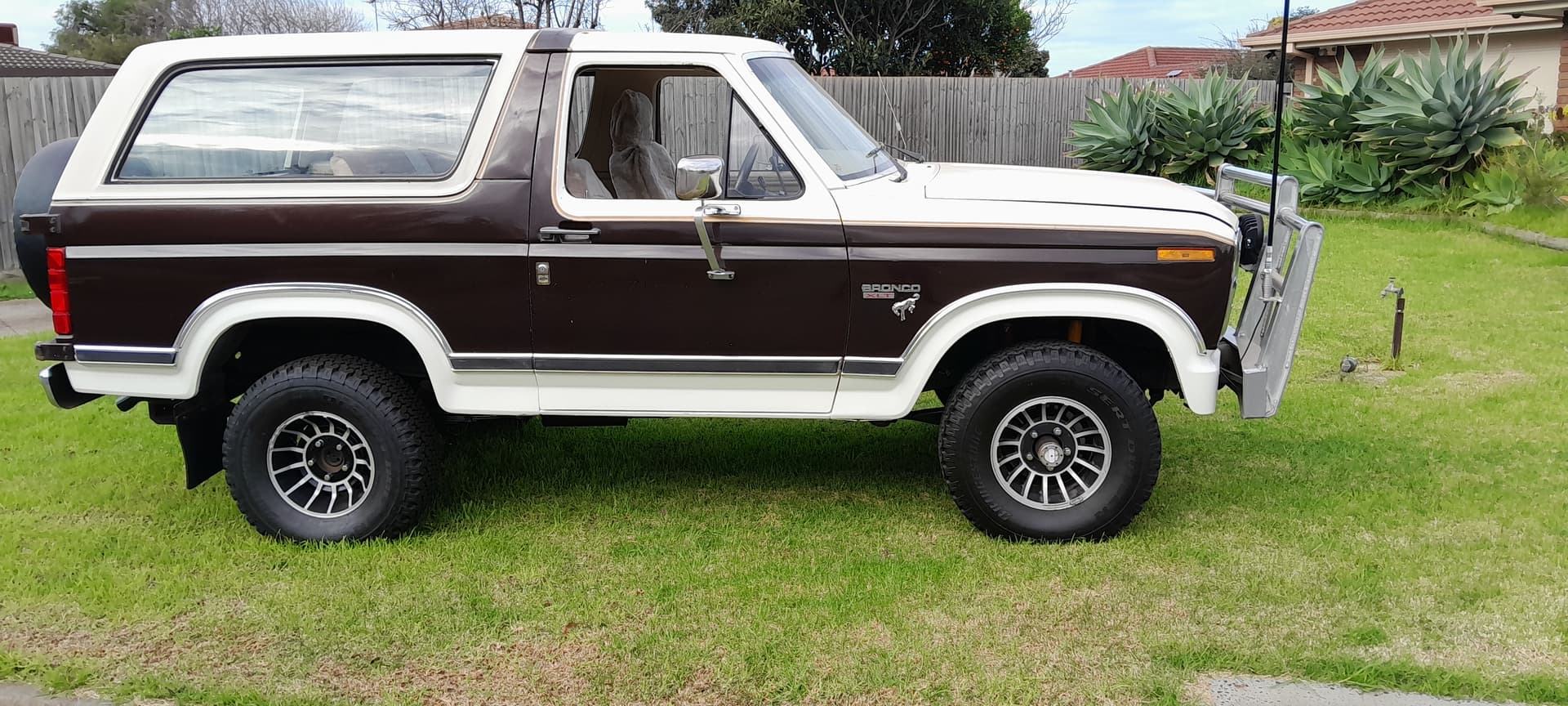

The end result:
Finito.
Wow that looks great, so nice and clean like it was new. The wheels and 2 tone paint really make it.
Great job… now go put some miles on it … seat time !!! :star_struck:

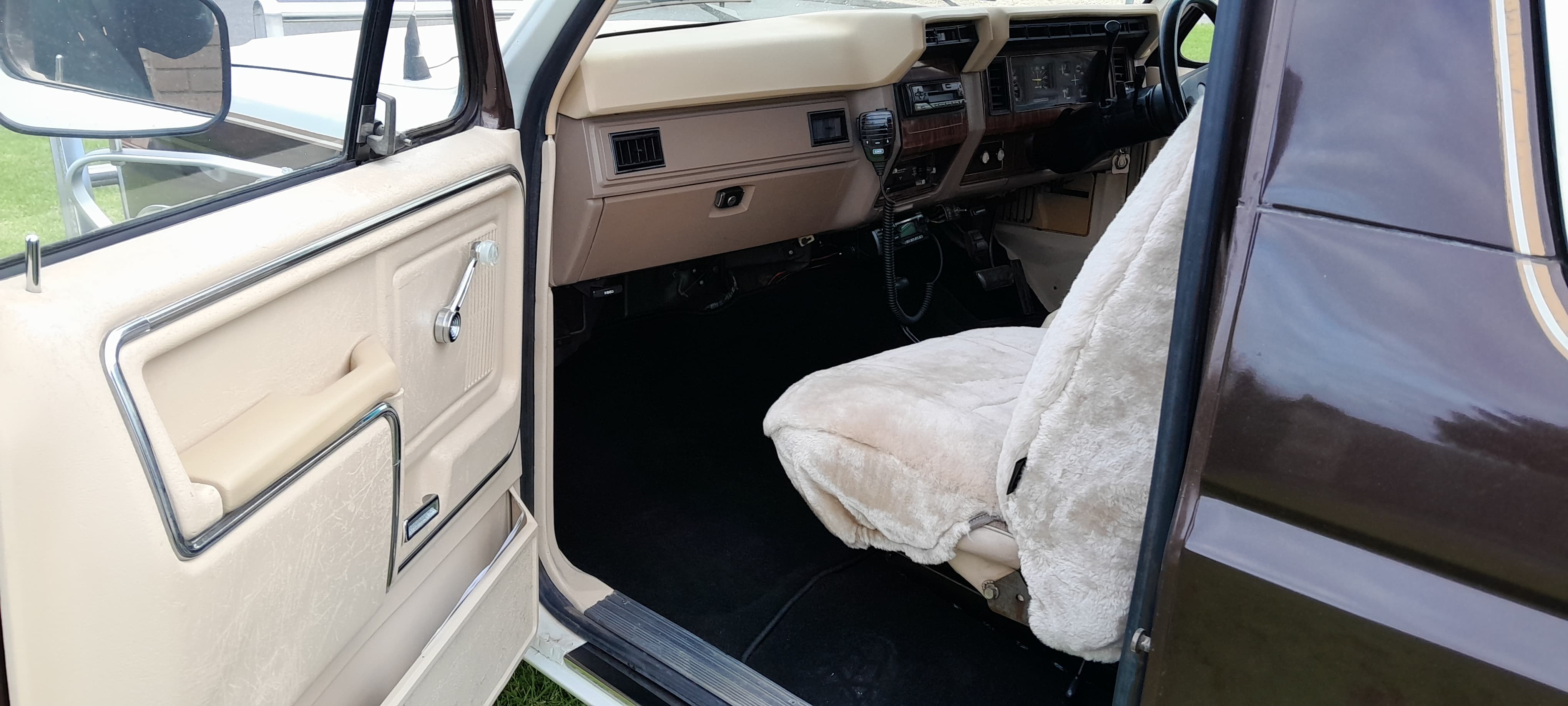

Grant;
Hummmmmmmmmmm! Right-hand controls. Did it perhaps work a rural mail route once upon a time?
Best, David Meashey
Ah, I saw that it is in Australia. Please disregard my query.
It is STUNNING!!! :+1:
