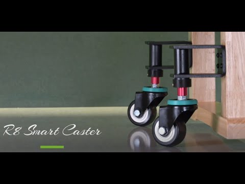

With limited space, I’m hoping for an honourable mention in 2028. My most recent find is a set of casters that work like a retractable bic biro.
Has anyone used these?
That’s pretty cool!
That looks like good idea for light tools but I would not want to lift my planer (400# of cast iron) or table saw up to get the wheels down. The picture shows what I use, push down on the handle and pull or push it. The tools have a piece of steel with a hole and the handle has a pin that fits in the hole to hitch them together.
You are so right Mark.
I’m still looking and weeding my way through reviews. Many of the reviews of alleged industrial casters that I’ve come across have complained the weight ratings were overstated. Photos of ball bearings ruptured and shattered plastic wheels fill the comments section.
Then of course there amazing casters like these blinkle levelling casters from Germany that cost $183 a piece.
But you have to get down on your knees at each corner to lower them off their wheels. On the other hand an uneven floor is easily compensated by levelling casters.
Bill, I looked at the type of casters you last posted, but yeah, expensive. I needed so many that I just stuck with simple, foot-lockable ones. Yes, it takes awhile sometimes to find the locking paddle with my toe, and no, they don’t adjust for uneven floor (which I have). But they’re affordable. I ended up getting something like 12 sets of these.
My concern with the ones you posted on is capacity. They look fine for an unloaded workbench, and my back could handle that lifting as well. But for something loaded with tools or materials (my stock rack is several hundred pounds loaded), those brackets are asking to be bent, even if I could lift one end. And their wheel diameter is relatively quite small, in view of the loads. Just my 2 cents, fwiw. They might work just fine.
