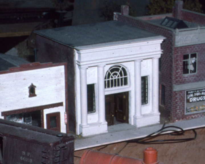

Way back last century Model Railroader published an article on building a bank.
In that same century, I built a model based on that article, making some changes to make it easier to build.

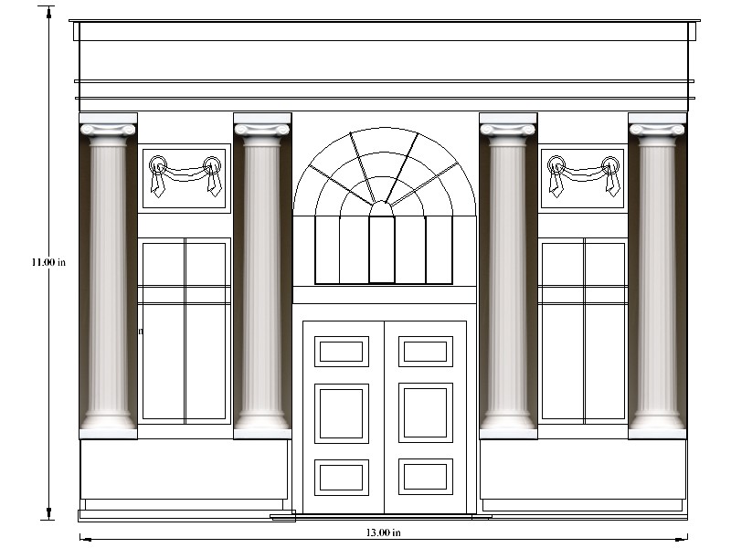

I decided that I liked the changes I had made last century when I made my original model. I wanted something that looked like a bank, but the prototype was a little too fancy. So, I ditched the fancy railing on the top, and the massive rectangular columns on either end. I started thinking of how I might want to build this. I really enjoyed building my textile mill with acrylic, so an acrylic based was a given. I first thought about using acrylic columns, but Jean suggested I head over to Michaels and check the cake decoration section. There I found some neat columns that were 7" high and would be just perfect. Not only that, they were cheap - 4 for under $5! I drew up a plan in TurboCAD and used the pictures of the columns to see how they might work.

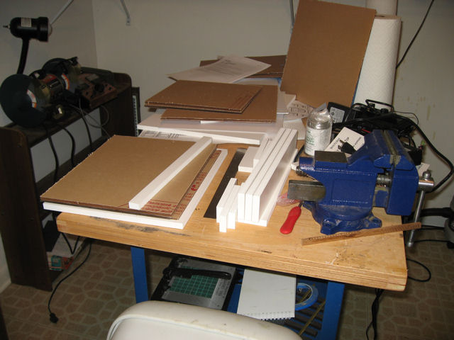

So, yesterday the UPS guy leaves a heavy package on my porch. Aha! It’s here!!!
(http://www.jbrr.com/Pics/Structures/Bank/IMG_3382.JPG)
I got some PVC that’s almost 1/2" thick for the front, the base, and some of the pieces above and below the columns. All cut to size. Neat, it’s like a kit. Russ always adds some extra pieces, and this was no exception. Handy stuff, too. One of the extras was pieces of PVC cut to size from my column bases. I had only ordered 2 pieces and was planning to use some scrap to make the base - he cut 4 extra pieces. Three of these are used for the base.

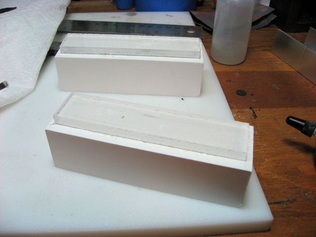

(http://www.jbrr.com/Pics/Structures/Bank/IMG_3384.JPG)

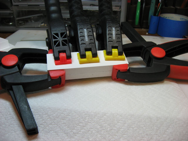

I start by gluing two of these together. Lots of clamps are needed. Two bases, plus the top piece are glued together and let dry overnight. Another extra was some clear acrylic strips. I cut these to length and glue them to the bottom of the base. Shown upside down here.

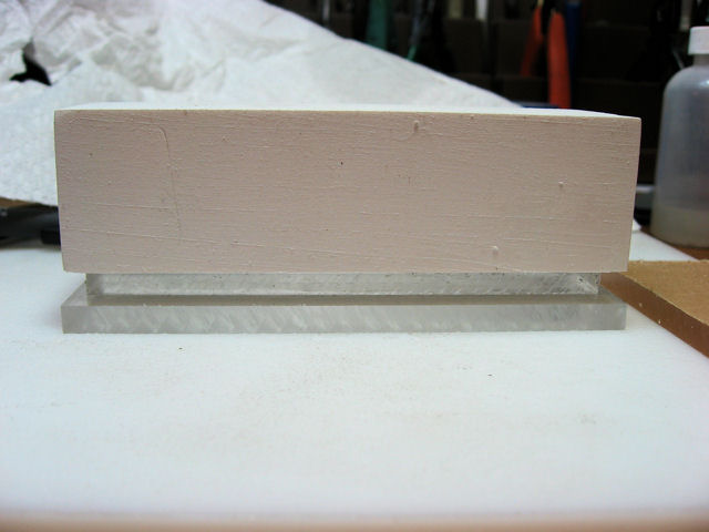

(http://www.jbrr.com/Pics/Structures/Bank/IMG_3390.JPG)
Another slightly larger piece (another extra!) is glued to the assembly, and my column base is about complete.
(http://www.jbrr.com/Pics/Structures/Bank/IMG_3395.JPG)

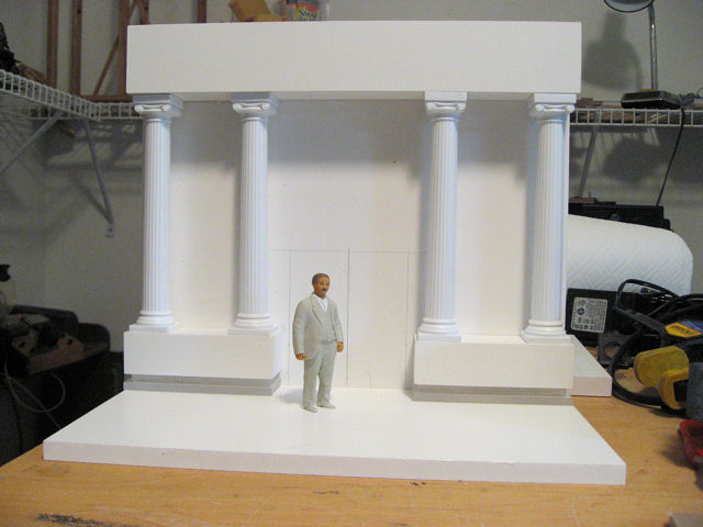

I can’t resist setting this up to see what it looks like.
(http://www.jbrr.com/Pics/Structures/Bank/IMG_3400.JPG)
NICE! Dont even have to paint it.
Actually, it’s a little TOO white. So, I’m thinking of Ivory…or maybe a texture paint.
Very nice! I saw those columns at Michael’s too and was thinking the same thing! They look even better on your bank than I imagined they would.
Definitely needs paint. Maybe a very light gray, like granite or limestone?
