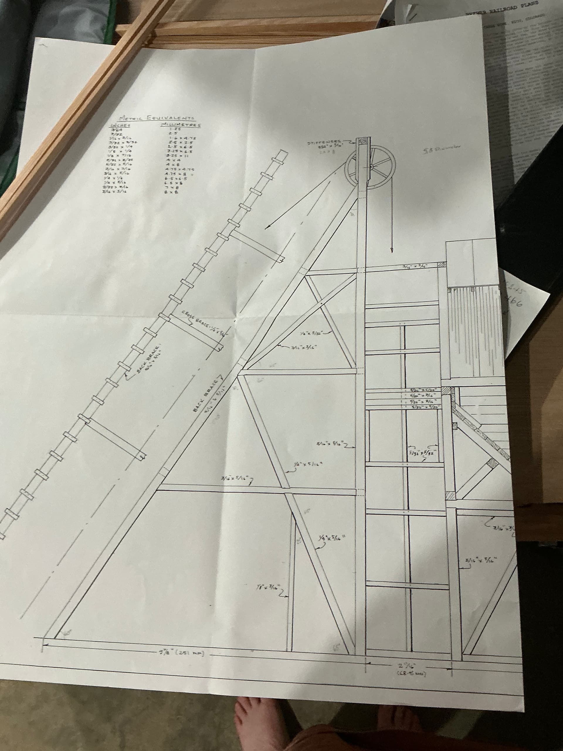

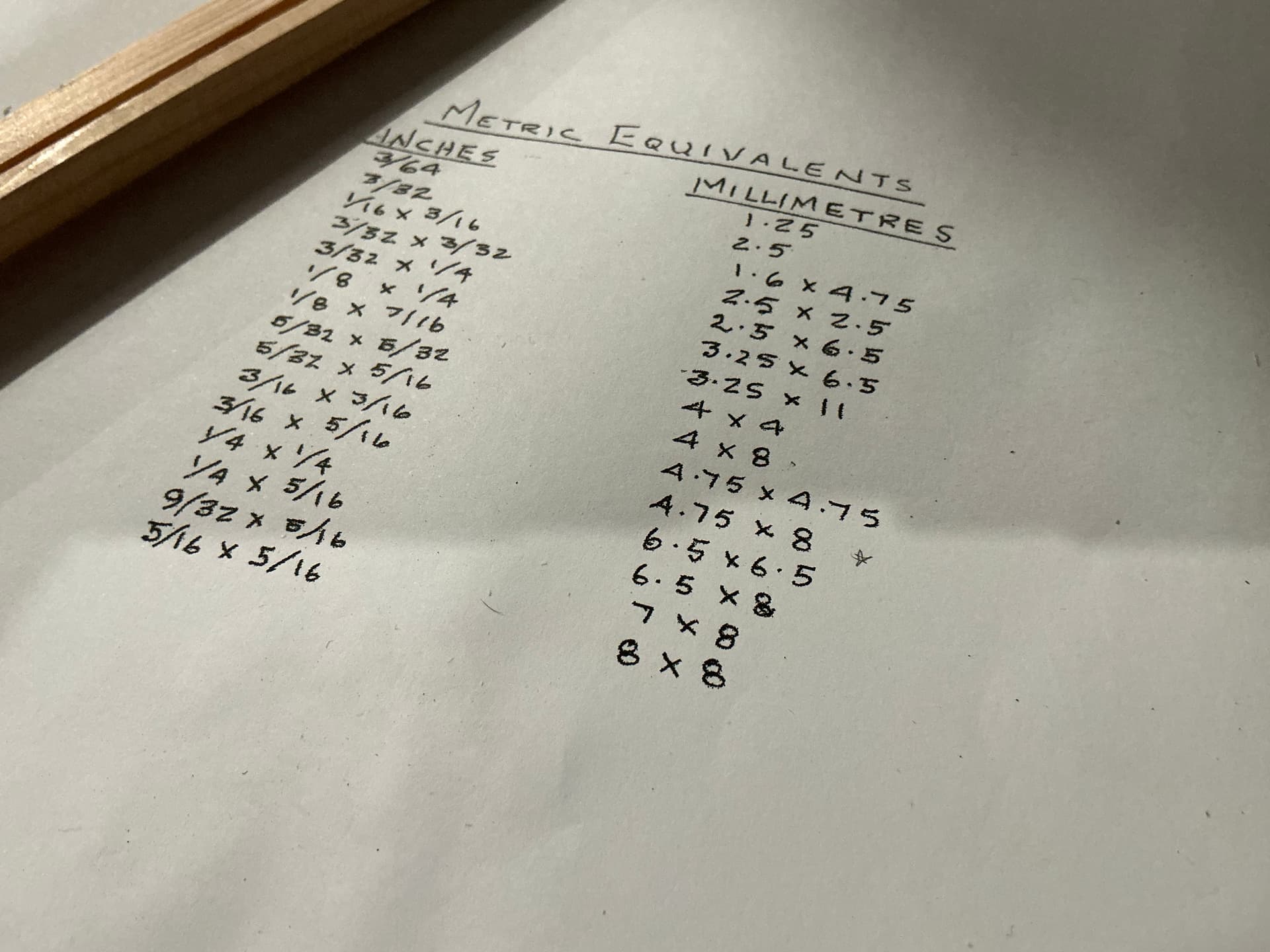

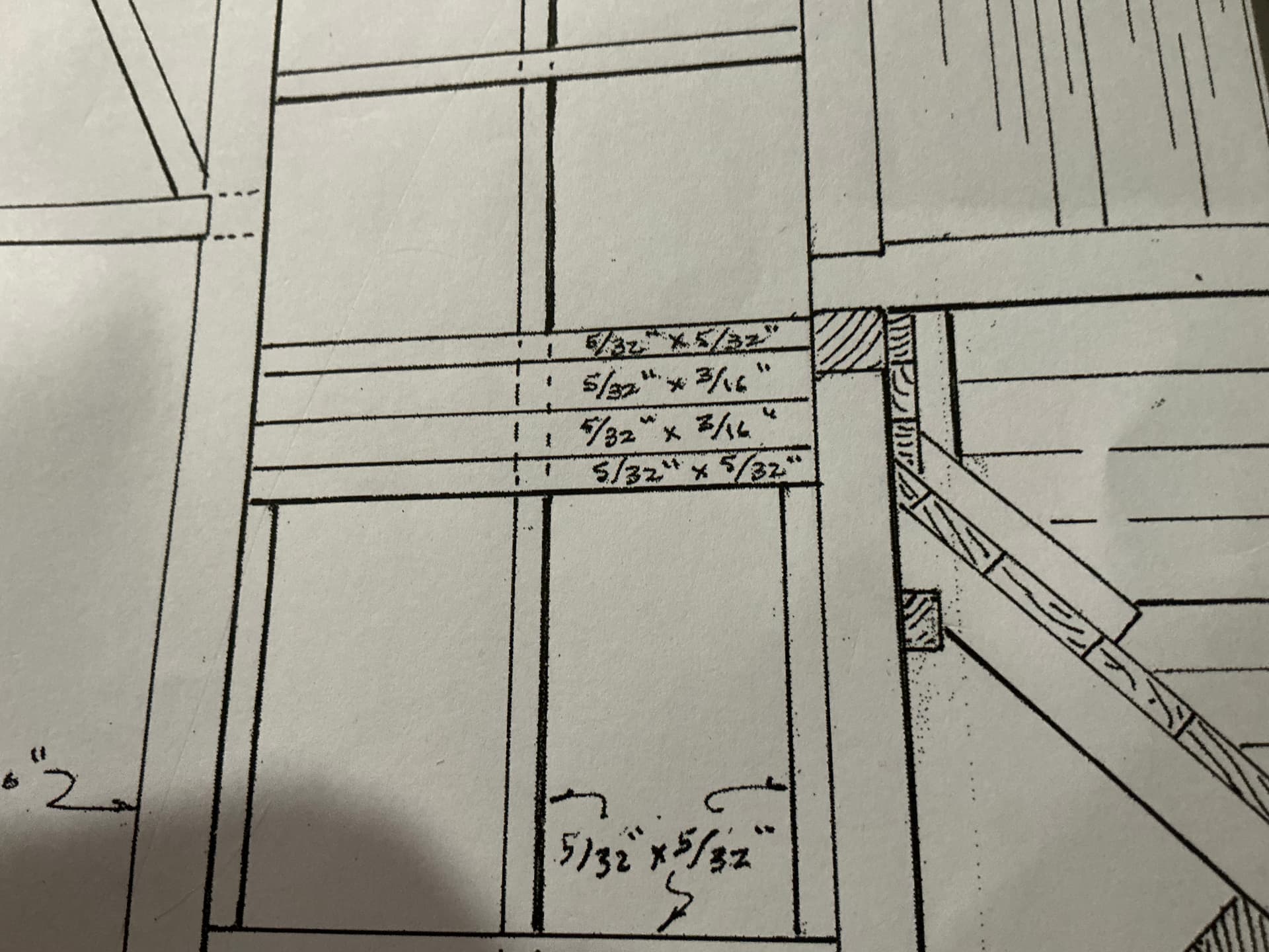

I’ve received a set of fairly detailed plans for a mine poppet head, and some of the specified plank sizes come in as narrow as 1/16". On paper—and on the bench—that level of fidelity looks spot on.
But it raises the bigger question: where does the 10 ft rule come into play?
Im worried that at normal viewing distance, a lot of that fine work won’t really register, and over time outdoors those smaller sections are also the most vulnerable to losing definition or simply breaking.
I’m keen to get some advice on how others approach it, especially if their structures live out side.
Bill how many people who will see this would know what the timber sizes shold be. Also a lot of these structures would have been built out of what was on hand.

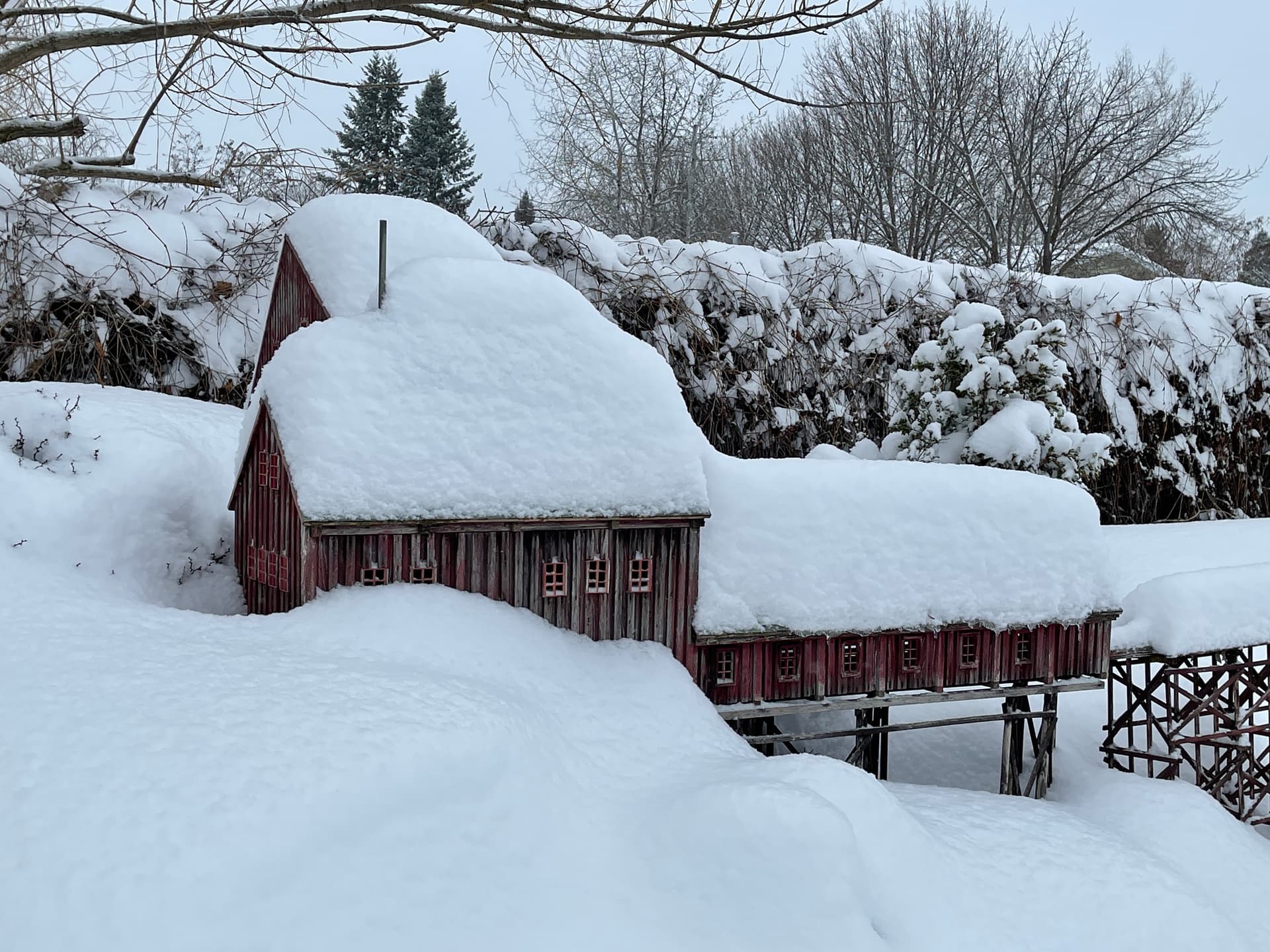

Details don’t last outdoors in my area where we have a true 4 seasons with temp swings from 0-100F. I generally build things to convey an idea of what they are for and the details are skipped because they will eventually disappear. They will rot away, the glue will fail, a critter will chew it off or the leaf blower will blast it away.

All are built to last outdoors year round and weather naturally.
Aluminum or cedar roofs, cedar sub structure and cedar siding.
A good quality exterior paint.

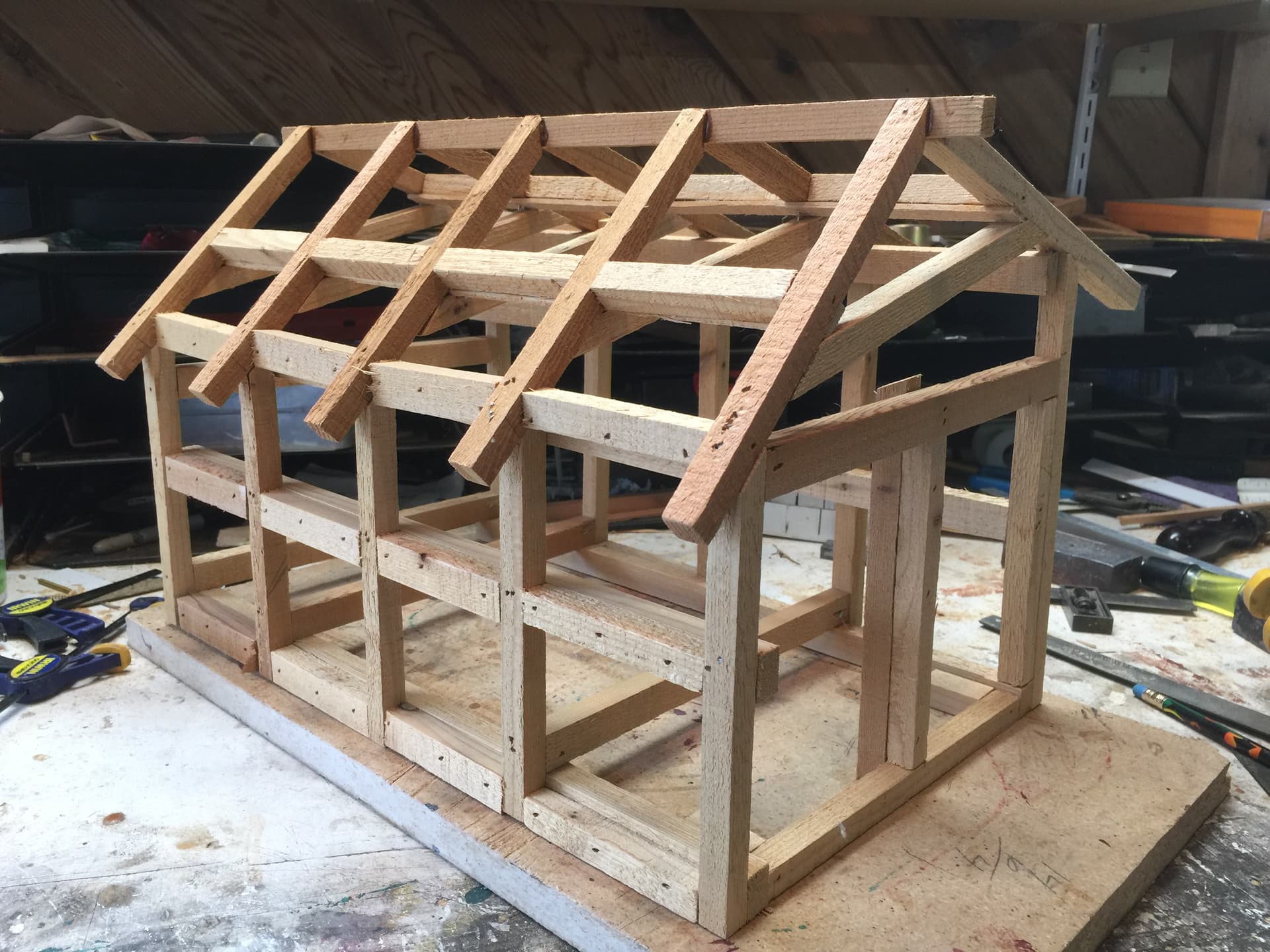

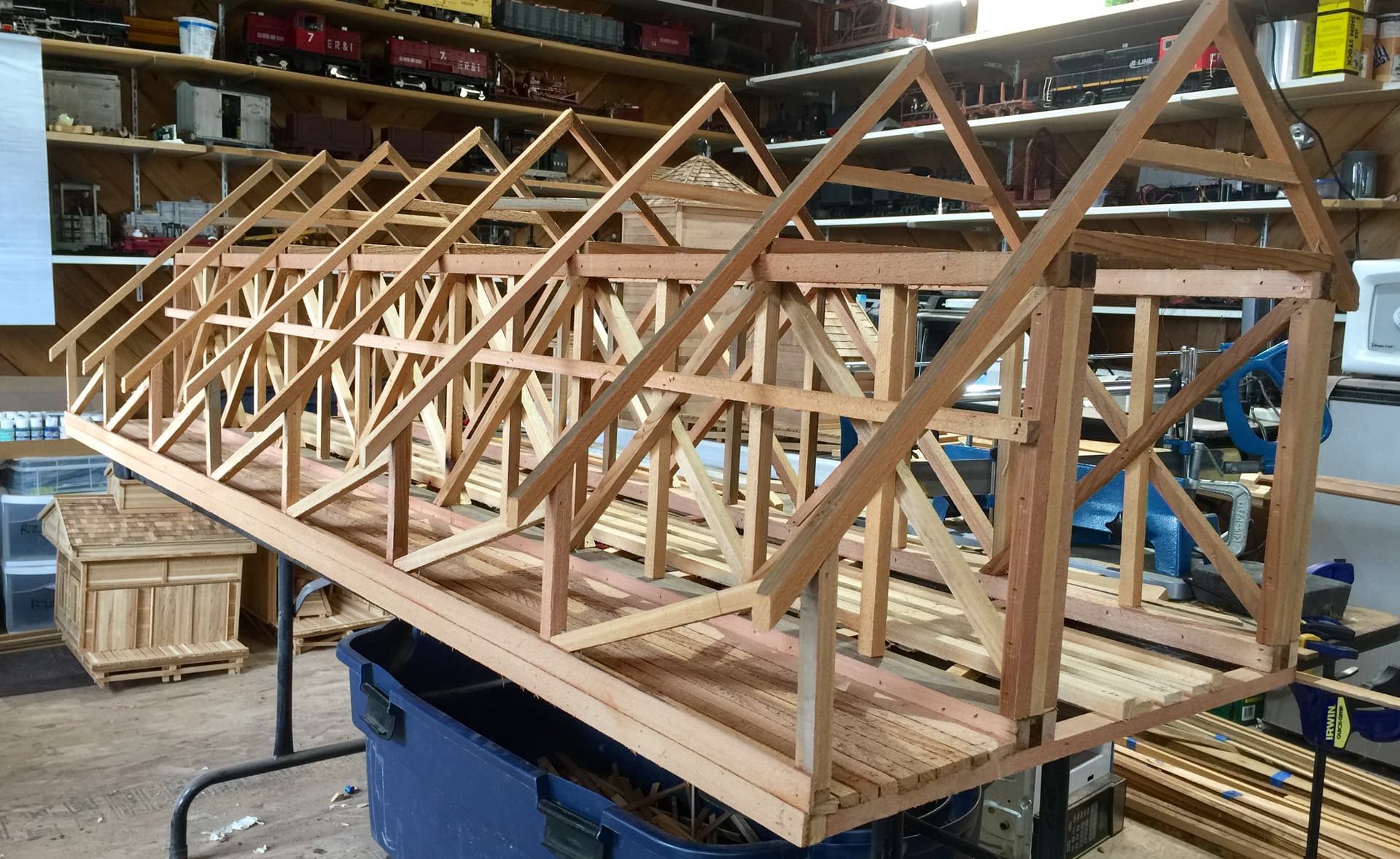

if you are building an opened sided or roof saw mill, for example, I would prolly make my beams, etc more or less to scale using cedar and tiny bolts (and pins and glue).
The inside of my buildings are all 1/2 x 3/4 and 1/2 x 1/2 inch. (mostly).
Realistically I wouldn’t use anything less that 1/2" square outside, especially if its out year round. Many of my outdoor Mik projects were made out of literally 2x4s and 4x4s. I used pressure treated lumber and believe the nails will rust away before that wood deteriorates.
