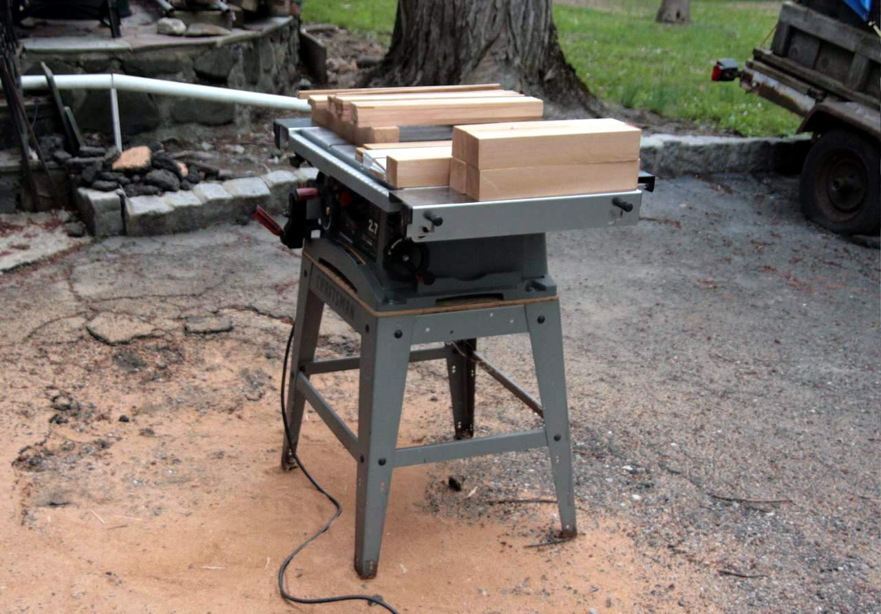

All good suggestions. I have a Craftsman 10" from about 10 years ago. It was under $200 at the time, has a few more features than the really cheap ones and it does what I ask it to.
EDIT to add: One thing I did that helps a lot wit accuracy was spend a boat load of time getting the bade and the fence true as possible. It’s still tough to mill long planks with uniform thickness due to limitations of the fence. You can upgrade the simple fence to a much more accurate after-market fence if you want.
I have a Craftsman 10 inch table saw very similar to jons. Mine was a hand me down from my dad. Its about 20+ years old now. It seems t work well, it does what I need, like Jons the fence is not perfect so it takes a little extra work getting it perfect. I added a thin piece of wood that fits over top the table saw. Then I ran the blade through it. Thats how I got my zero clearance insert for cutting small stuff. Make a D block this will help add a little more protection when cutting.
