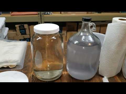

Hi Bill, yeah, I’ve been reusing the alcohol way too much because I didn’t want to throw it out! I have done, but I didn’t like it. But my prints were getting gummy coming out of the wash, so it was time to either pitch it or figure it out.
So after watching a number of vids on YouTube and failing at my favorite hopeful method (cure-the-resin-in-the-alcohol-in-the-sun-and-filter-it-out), and not really liking / believing the others, I’m gradually coming up something that works for me. I think.
I’ve got a couple minutes before my “herself” (uh… that doesn’t sound right?) hits the dinner bell. So, here’s my process so far.
At this point, one can let it settle for a few days and carefully pour off the clear alcohol into another container.
To get more out, the residue can be poured through a decent-weave cheesecloth, and slowly squeezed out like a cheese ball (yumm!!).
At least, that’s how I’d hypothesize at this point. I did a number of extra steps today, but now I think maybe they’re not needed.
So, like I said, a process still in development.
Cheers!
Cliff
Tell me your secret sauce for straining the resin. Nevermind I see you posted it… I’ve been recycling old paint stripping alcohol for resin baths.
Instead of trying to pour off the clean-ish IPA and mixing in some of the gunk on the bottom, I bought a 500ml syringe and just skim the ipa off the top
That’s a really good idea Bob. I can apply it at work with used paint thinner. I keep about 5 gallons of mineral spirits in various states of oil based paint contamination. After the first discard sits and settles for a week or so, I can pour off a fairly clear “used” batch. Trouble is, as I pour, what has settled out begins to go back into suspension. If I were to carefully draw off the top I wouldn’t disturb the sludge.

So it’s the Alcohol you are distilling/cleaning not the resin?
Cliff, roughly how many prints can you make before you have to buy new resin? …and is it because you’ve run out of resin or because it has become cloudy?
A great song Bill, HAHahahHAAA!
Sorry for the confusion, but yes, I’m cleaning the alcohol, which is used as a bath for cleaning resin prints. The uncured resin gets left behind in the alcohol, and that’s what needs to be gotten rid of when it builds up too much.
FWIW I explained the cleaning process a bit better with a set of videos. I guess the main thing I wanted to show was how fast the resin particles react to the uv light.
