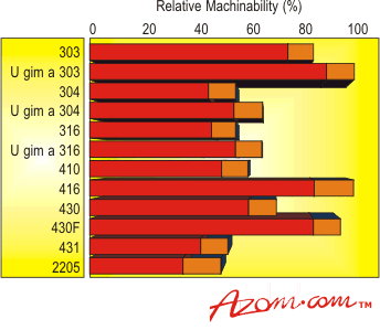

There are numerous ‘types’ of stainless steel, with each type formulated for specific properties such as ease of fabrication, machinability, weldability, atmospheric corrosion resistance, etc. These types range from 100 Series austenitic chromium-nickel-manganese alloys to 600 Series martensitic precipitation hardening alloys, to Type 2205 duplex ferritic/austenitic alloy. The term ‘stainless steel’ covers many, many alloys, and the performance of each alloy will be unique to that alloy. The two most common types are the 300 Series austenitic chromium-nickel alloys and the 400 Series ferritic and martensitic chromium alloys. Generally speaking, the 300 series (types 304 & 316 are the most common) have excellent corrosion resistance, with no visible ‘rusting’ when exposed to atmospheric moisture. They are relatively hard to fabricate, with specialized cutting and welding required. Some of the type 400 series have a higher iron content (thus the name “ferritic”), with many of them being slightly magnetic. These materials are somewhat easier to fabricate and to perform special manufacturing operations such as hardening. Use in cutlery is one example of type 400 SS. Many 400 series stainless steels also exhibit a higher degree of effect from atmospheric corrosion: Some say they ‘rust’. On a relative scale, all stainless steel alloys are significantly less effected by atmospheric corrosion than corresponding steel alloys, but it is very possible to find some ‘rust’ on stainless steel. Happy RRing, Jerry
hey Jerry, your statement is right on the spot, look at the chart. by the way, i use mostly 303 stainless, today with carbide and M42HSS, it is no problem to work with 303. think global Pius Improved Machinability Grades Recently a number of manufacturers have offered “Improved Machinability” versions of the standard austenitic Grades 304 and 316. These steels are produced by proprietary steel melting techniques which provide enough of a chip-breaking effect to significantly improve the machinability, but they still remain within the standard grade composition specifications and still retain mechanical properties, weldability, formability and corrosion resistance of their standard grade equivalents. These materials are marketed under trade names such as “Ugima”. For “Ugima” the improvement in achievable machining speed is about 20% over the equivalent standard grades; in addition it is commonly experienced that greatly enhanced tool life is obtained, which considerably reduces the cost of machining. In many instances this is of greater benefit than is the improvement in cutting speed. A “Ugima 303” is available as a “super-machinable” grade; like other 303 stainless steels weldability, formability and corrosion resistance are compromised in order to achieve maximum machinability. Relative machinabilities of various stainless steels, expressed as comparison of achievable cutting speeds, are shown in the graph of figure 2. Figure 2. Relative machinability ranges (in orange) of stainless steels
