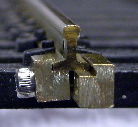

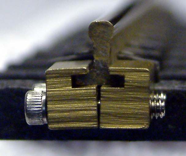

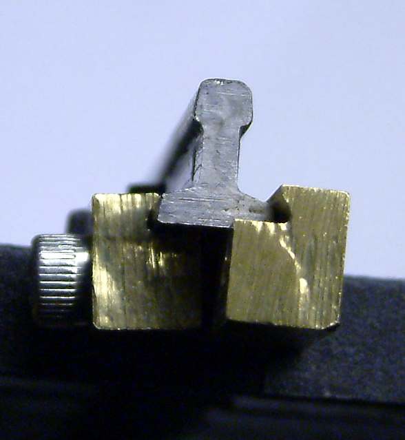

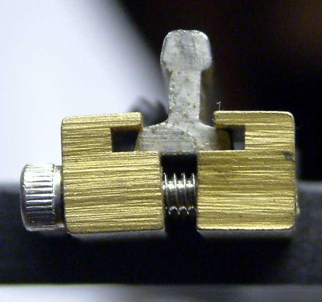

I don’t think you need to worry about galvanic action. SS and Brass are mixed all the time. Copper and Glavinized Steel are two different animals. As far as clamps go, use the ones designed for SS Rail. As Mik says, the profile is slightly different. If you put Hillman’s clamps for brass rail over the stainless and tighten, you will break them with moderate tightening. Split Jaw also makes his SS clamps slightly different from his brass clamps. Split Jaw Brass Clamp on Brass Rail
(http://www.cvsry.com/images/SJC-Brass.JPG)
Split Jaw Brass Clamp on Stainless Rail
(http://www.cvsry.com/images/SJC-SS.JPG)
Hillman Brass Clamp on Brass Rail
(http://www.cvsry.com/images/HRC-Brass.JPG)
Hillman Brass Clamp on Stainless Rail
(http://www.cvsry.com/images/HRC-SS.JPG)
Did this research long ago when no one made clamps for the Aristo stainless rail.
