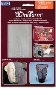

The above mesh is this:
and can be found at craft stores.
The above on the other hand is fabric, somewhat stiff, used in floral decorations or to make sachets by some, again available in the craft stores in the same area as the plastic cake columns.
Maybe they will help(http://www.largescalecentral.com/externals/tinymce/plugins/emoticons/img/smiley-cool.gif)
That’s the stuff you want there, Devon…good call Marconi…I’m heading down to the store this weekend to get some of that contour mesh. The plastic stuff I have is rather crude looking compared.

David,
Both of those wires look great. I am glad you showed the one in the top picture because I saw that online and wasn’t sure but on your train looks great. The other stuff looks equally good. Now I know where to at least start
