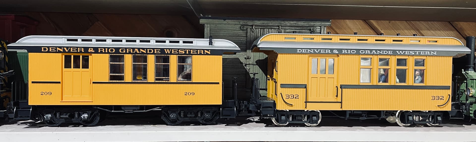

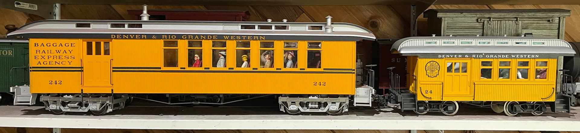

I’ll compare some different cars and post them here, if anyone is interested.
Piko (left) USA (Right)
Sorry, I don’t do pictures…

You will also note that in pictures, the Piko cars are almost just shorter versions of the LGB products.

The first thing I noticed is the one on the right either offers a better ride or has significantly cheaper fares. The one on the left does not have a single passenger. :grinning:

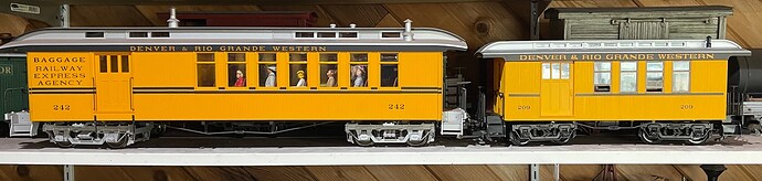

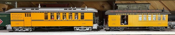

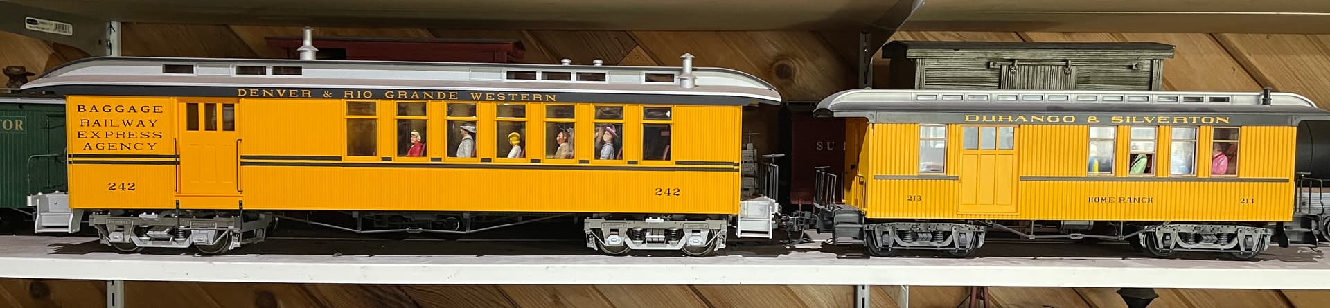

I have a Delton Long, Hartford long and Aristo short. I just have to dig them out.

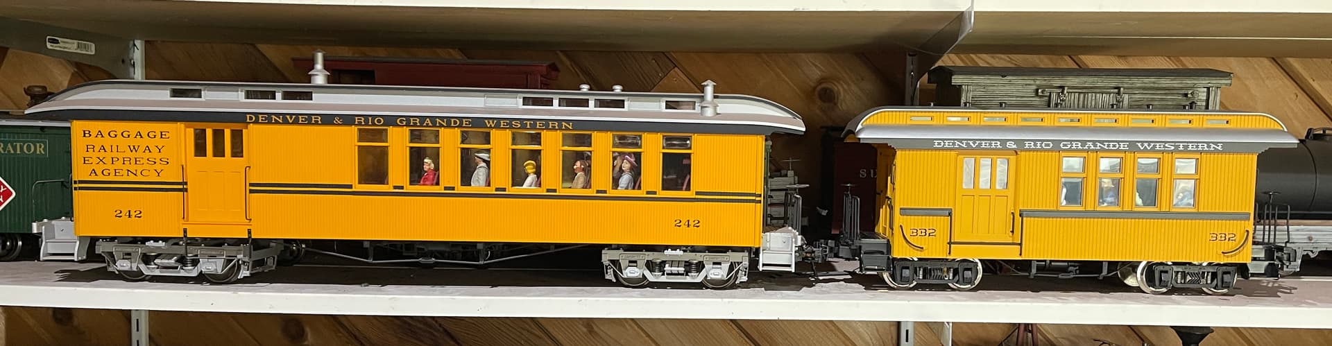

Acucraft - bachmann
Accu - LGB
Accu - Delton short
Accu = USA short

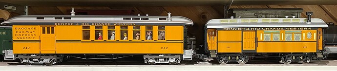

Accu-PIKO
Almost makes me want to get out some of my passenger cars for comparison.
Between the USA and PIKO shorties, I think the USA is a better model. It has more detail like roof vents and metal handrails. PIKO has no vents and all plastic handrails.
The Delton’s are well detailed and in a class of there own as the shortest.
LGB and Bachmann are basically the same. On the Bachmann’s, I have replaced all the porch rails and grabs on mine with metal ones and added roof vents.
I haven’t got around to adding roof vents to some of the LGB yet.
The PIKO has moved into 4th place as to details and finish in the shorty models.
I even rank the Delton above it.

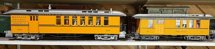

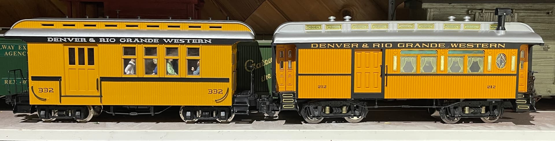

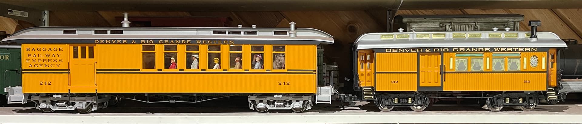

Accucraft-Aristo Craft
USA-AristoCraft

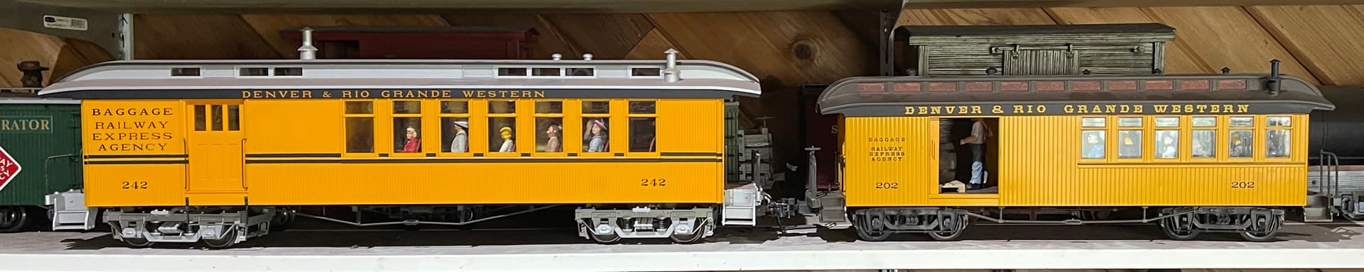

So the Aristo 212 in interesting.
This is kinda going into the other thread of Shorty cars but is there a prototype for that arrangement especially with the double vestibule doors on the side?
I’m asking as a 56yr old young guy and do not no these things. So I gotta ask an old guy as I lost my old guy information source at the beginning of this year!
As an old Geezer, I haven’t seen a side door vestibule shorty picture of the real thing.
So I’m guessing it’s Lewis Polk’s idea.
I believe you are correct. I did a little more digging and I’m beginning to think it may have been it was a interurban NJ fantasy. Hard to say but 212 would look pretty cool with pantographs. Hard to say but the man had a mission which he accomplished.
