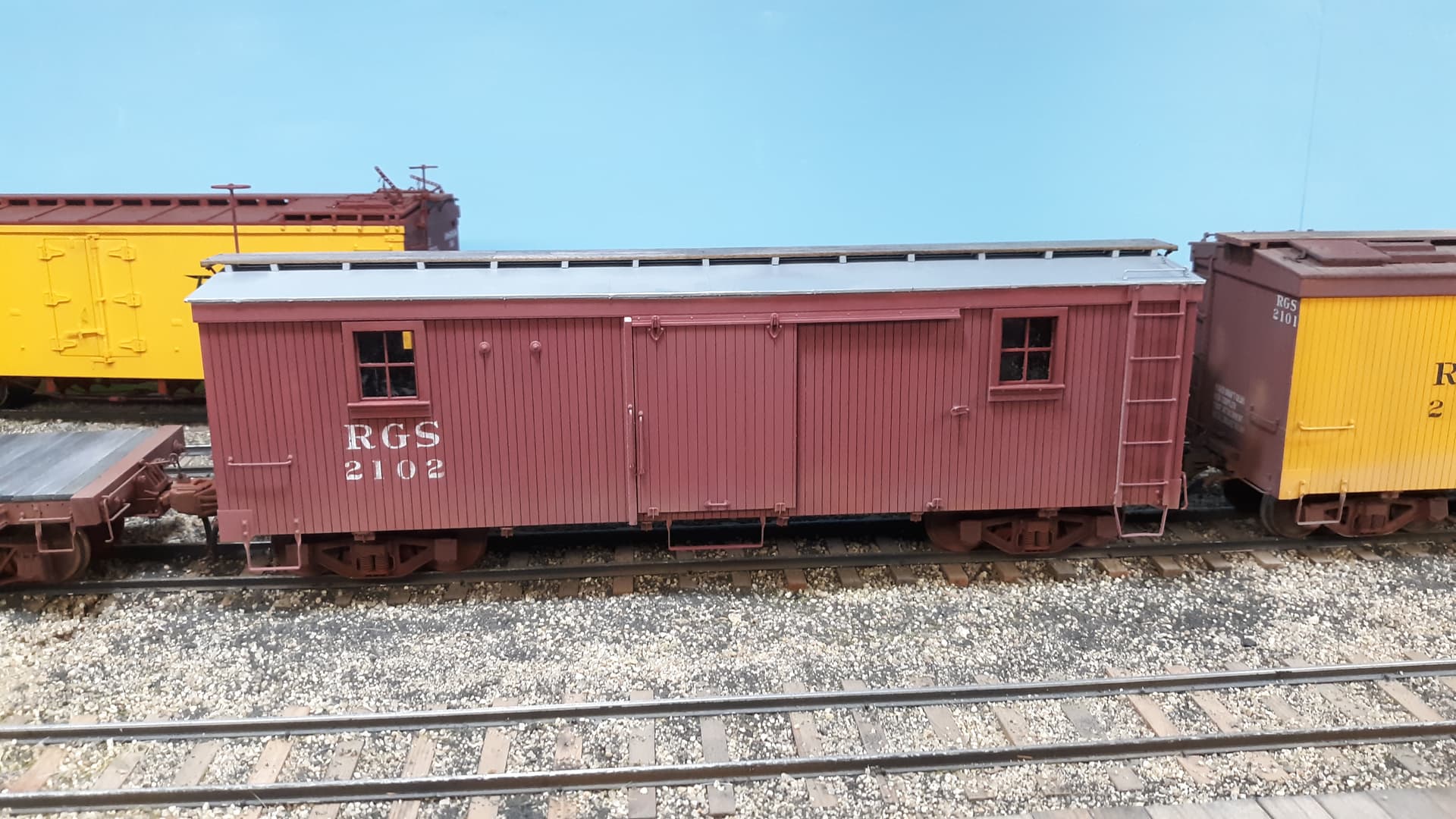

While i did not document the builds on these two new cars i did want to share the results:

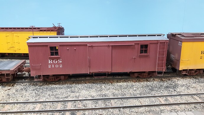

This first car RGS 2102 was a C&S Refrigerator car converted to work service circa 1940 by the RGS. it was made of laser cut wood for the most part, similar to the refer to the right. the major difference is that the side and end ladders are now 3d printed, along with the stirrup steps and most of the other details, including the brake wheel.

Beautiful work, Al.
Are you using the “Tough” resin still, or have you found something even better?
Cliff,
Yes, but a new formulation. i am finding it a little more difficult to work with on the support side of things. it is now black instead of grey.
Al P.
Doing your own decals and trucks?

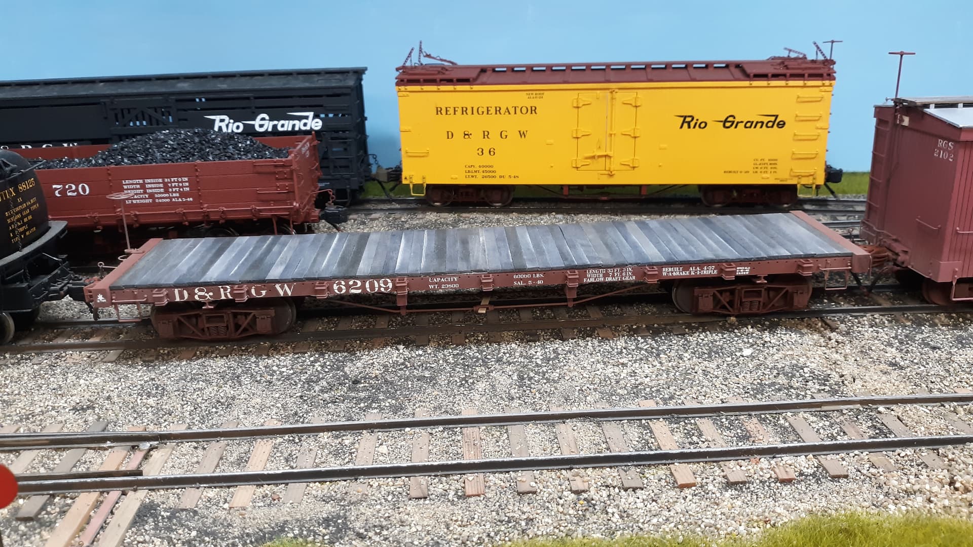

Cliff, I had a decal set for the 6200 series flat car from San Juan decals, and the RGS 2102 decals are one of the last sets i had Stan Cedarleaf make.
i do something that others shy away from. i use lacquer thinner to dissolve the decal film. I use a small brush and work carefully in the right light. once it looks good i then follow up with an over spray of the thinner. then i can scratch with fiberglass brush to distress.
AL P.
the trucks on the flat car are from the bachman framed tank car. i changed the bolster ends to more correctly match the prototype.
the work box trucks are available from Ozark at times. i have models of this truck but have yet to find a material that i can print them in with out deflection.
Al P.

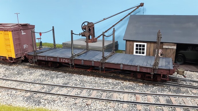

Another car finished today. this is actually a RGS car, but the RGS just blanked out the D&RGW. for my railroad i needed reporting marks so i left the D&RGW bur distressed both it and the car #.
Starting point is an AMS gondola, which i remove the gondola sides and ends.
This one has been a long time getting done, as there was quite a thick layer of dust when i recently resumed construction. the code 215 Ligas nickel silver was machined extensively for the log bunks on my mill to make them fit together like the prototype.
