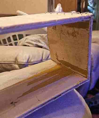

And here is the boo boo I was talking about. Need to saw those corner pieces out and move them up after I build the deck and frame.

Devon… Do you have an Oscillating saw? It’s made to order to cut out those corner blocks…
If not… then a sharp chisel. But are you allowed to have sharp objects alone without adult supervision?
No Dave I wish I did. It’d be perfect. I am just going to use a hack saw blade and patience
or you take a big drill, drill a hole from below into that piece of wood, and then just chisel away the rest.
Thats a notable option. I might start there
Another idea that would save cutting the corner blocks: Try building a deck with the corners cut out so it will recess as you desire. That might require some blocking for attachment.
There in lies the biggest problem. Those corner blocks were going to serve dual duty. #1 was a place to screw up through the bottom of the deck to hold it all together. Notching out the deck and then adding more blocking to screw into seems counter productive. This really isn’t the end of the world. Sawing it out or more likely doing what Korm suggested and just drilling and breaking it out is the right was to go. I will clean it all up and remove the pins that shot through with the dremel and then just put new blocks in. It definitely isn’t a show stopper. Thankfully its all in the interior.
Korm’s idea worked like a charm. After the home was drilled it busted out quite easily. Not pretty but it’s not gonna be seen. Cleaned up the pins with a diamond wheel. It’s all very serviceable and didn’t mess up any of the outside or damage anything.
