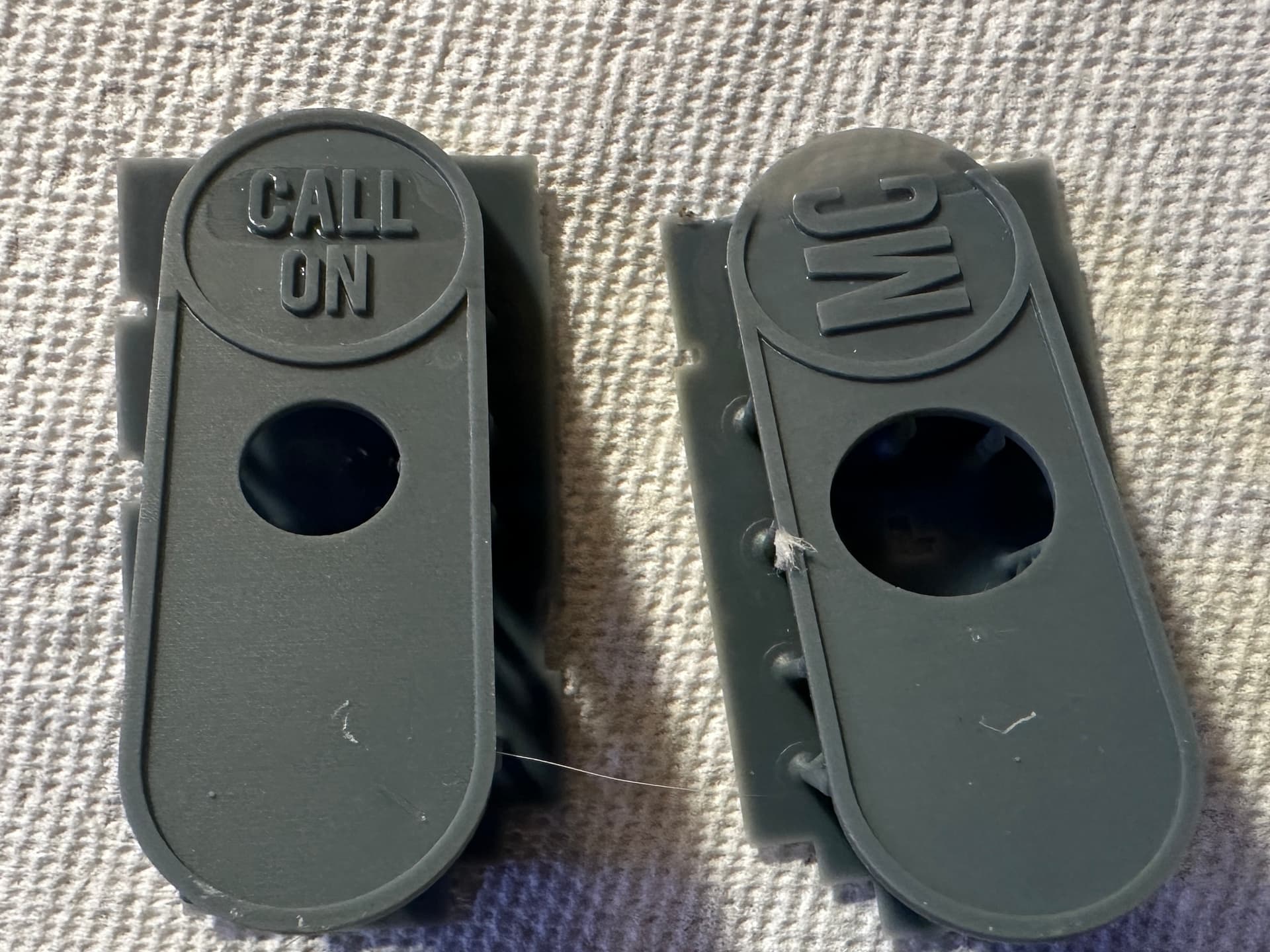

With the exception of a support failure on the maintainer call plate, they come out really nicely off the resin printer

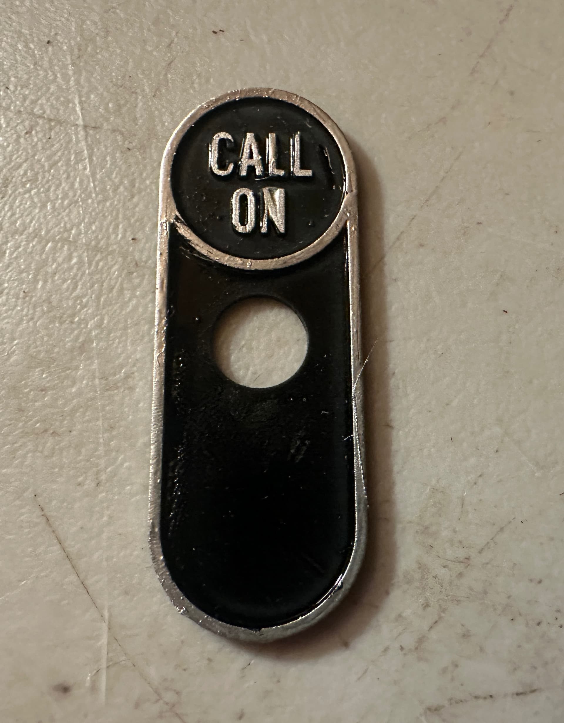

Quick coat of paint.

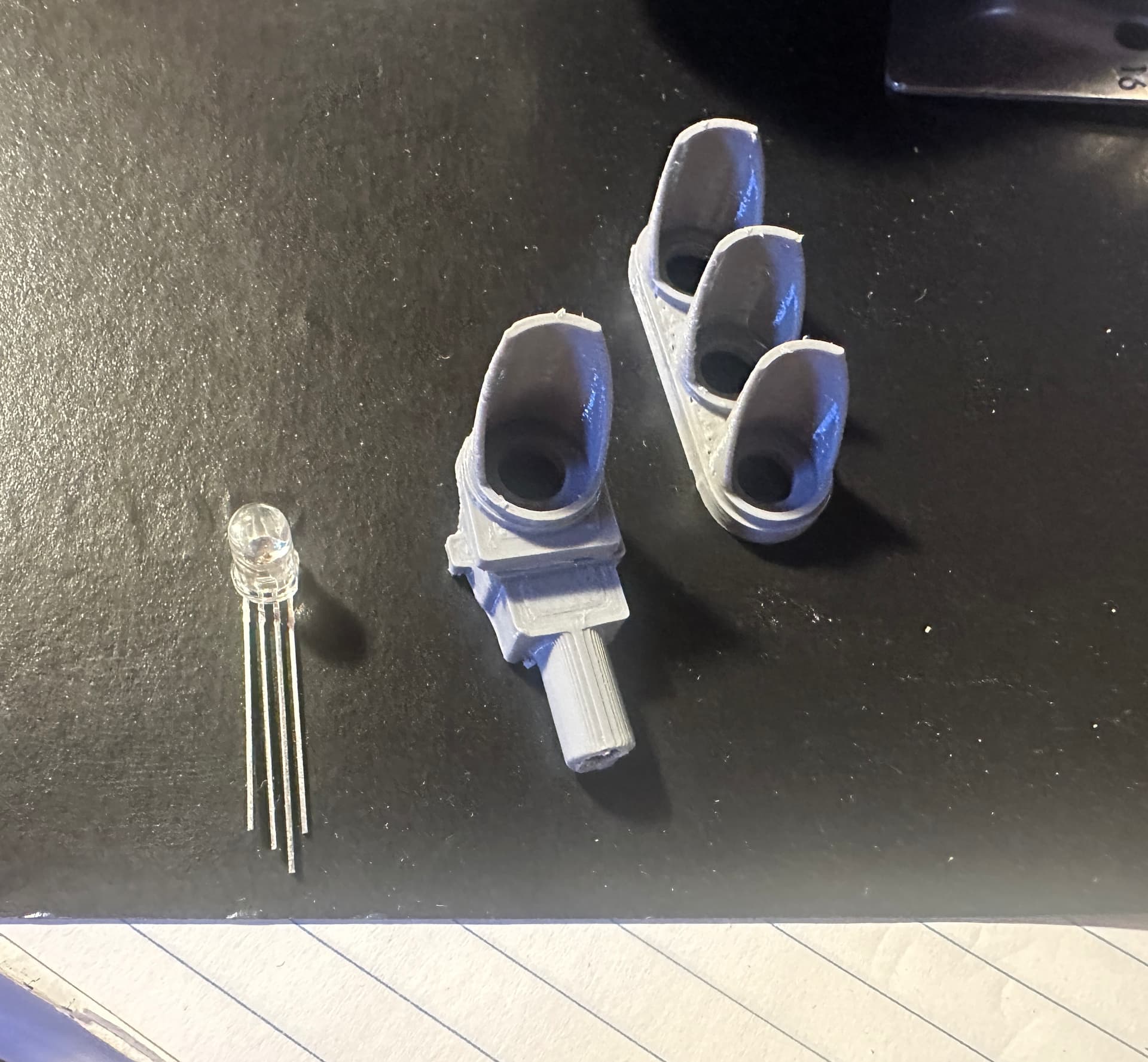

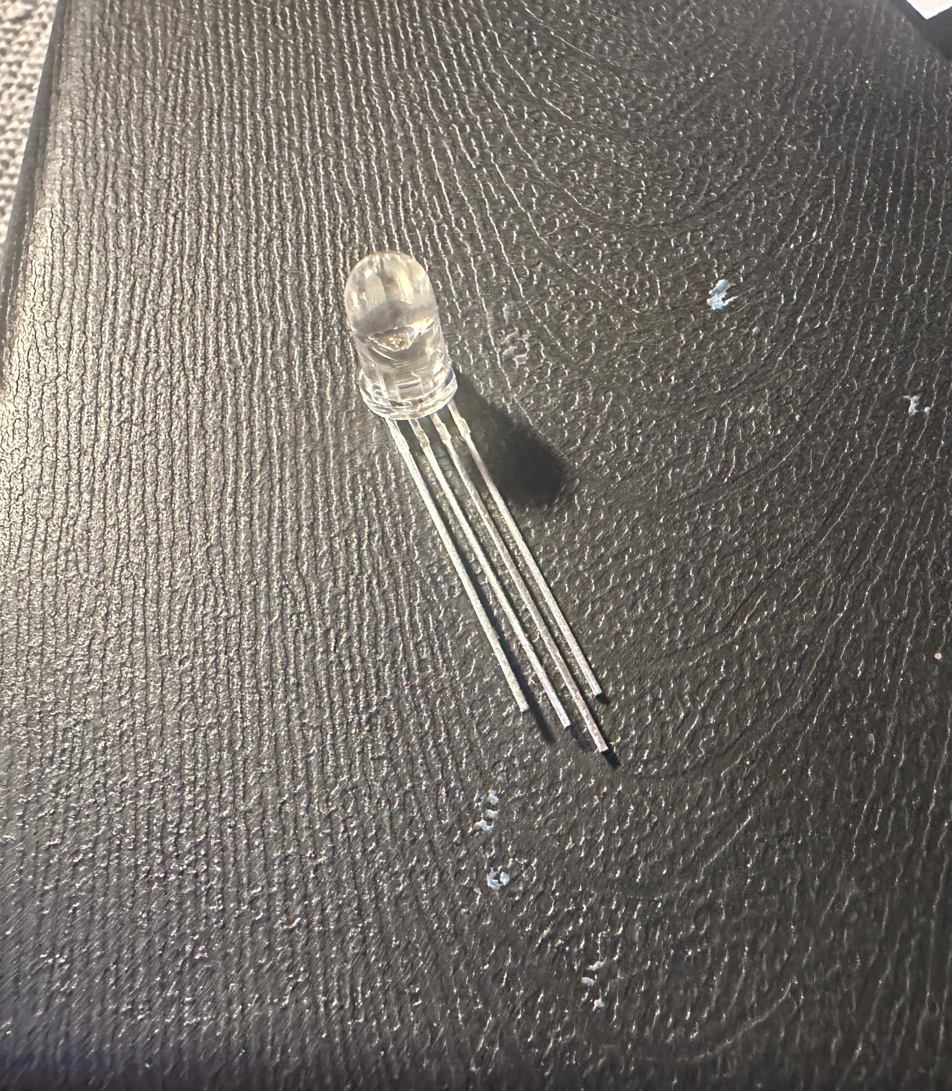

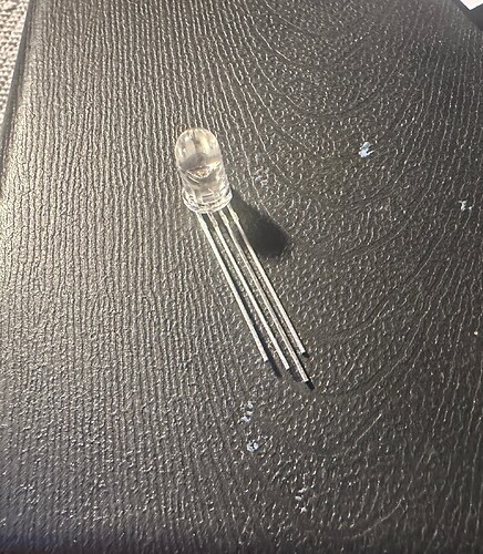

Behold the elusive tri-color (Red/Yellow/Green) LED. These have been hard to find not in a surface mount configuration, but I found a supplier. This will allow me to make single-lens dwarf signals, which will be less prone to breakage.

Nice. Somewhere, in a box around here I have a film canister full of 5MM RGB LEDs. I went with the more rare common Anode to work with systems that switch the ground side.
I just realized yours are R Y G, not RGB. No wonder they are hard to find!
Yea, exactly. RGB are everywhere because they’re used as individual pixels to make huge LED displays.

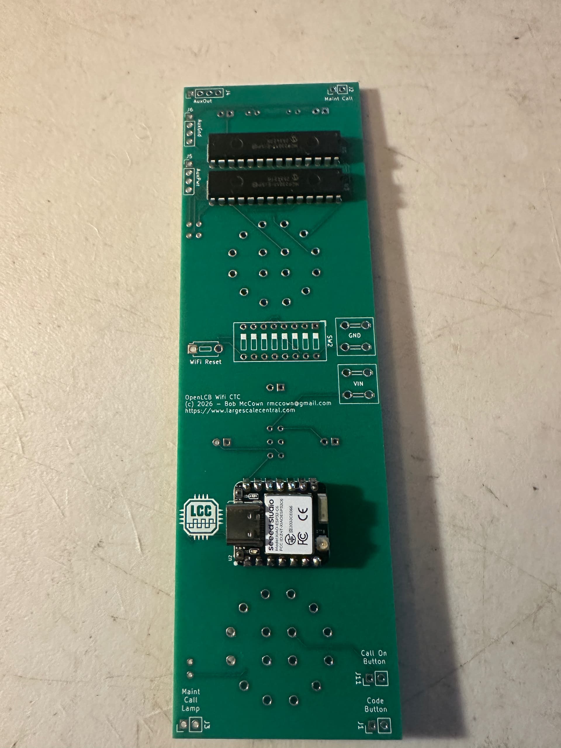

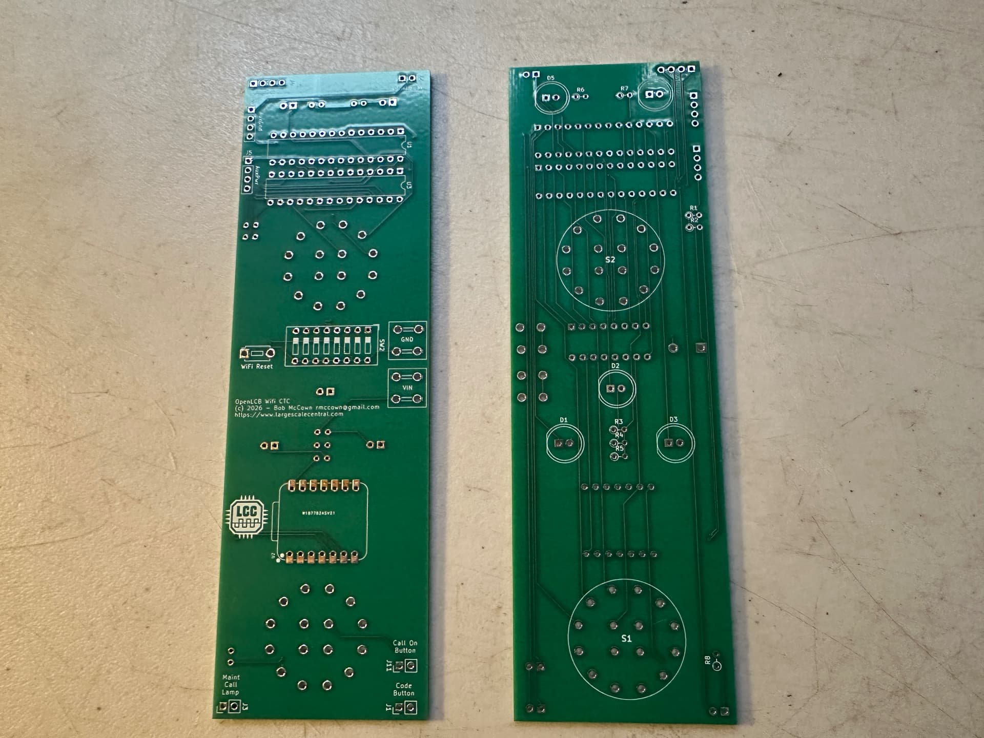

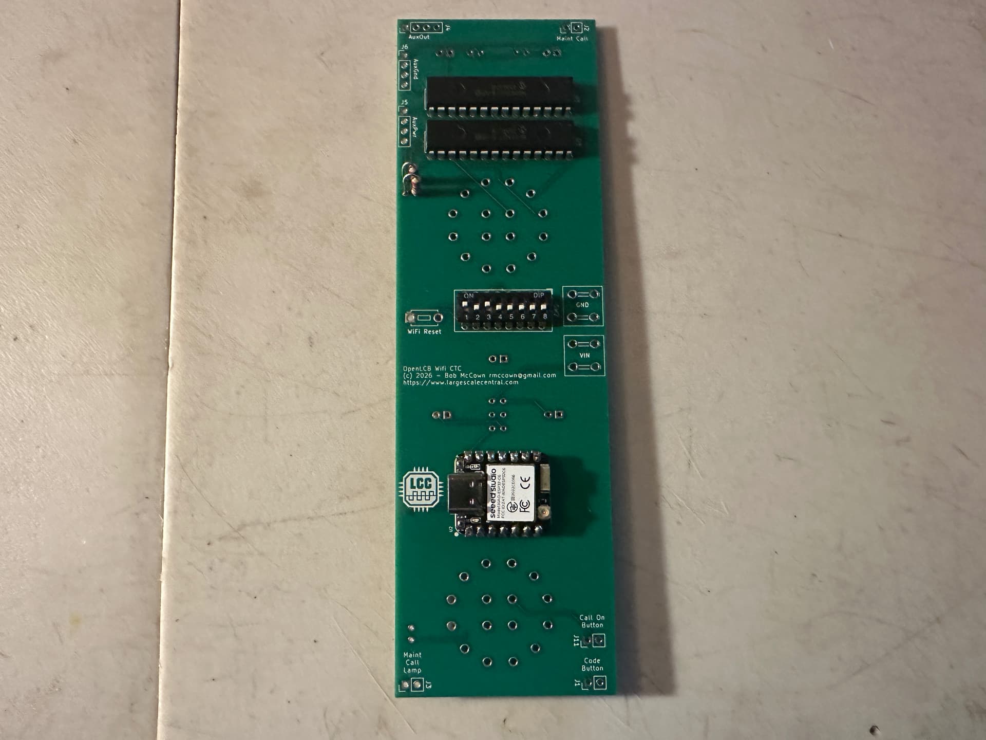

The CTC boards showed up today. Looking at them, you’d almost think I know WTF I’m doing. You’d also be wrong.
But anyway, first order of business is to install the processor board and the two IO expanders, and make sure that I didnt screw up the board layout.
And I didnt screw it up. Next is to install the DIP switches for address selection. That’ll be after dinner.

Address selection seems to work.
Please forgive my ignorance about these things- when you install the processor board, DIP switches, etc., do you have to solder them in or are they kind of a press fit? This is all very impressive to me, to design and implement such a complex system. Thanks for showing what goes into it.
