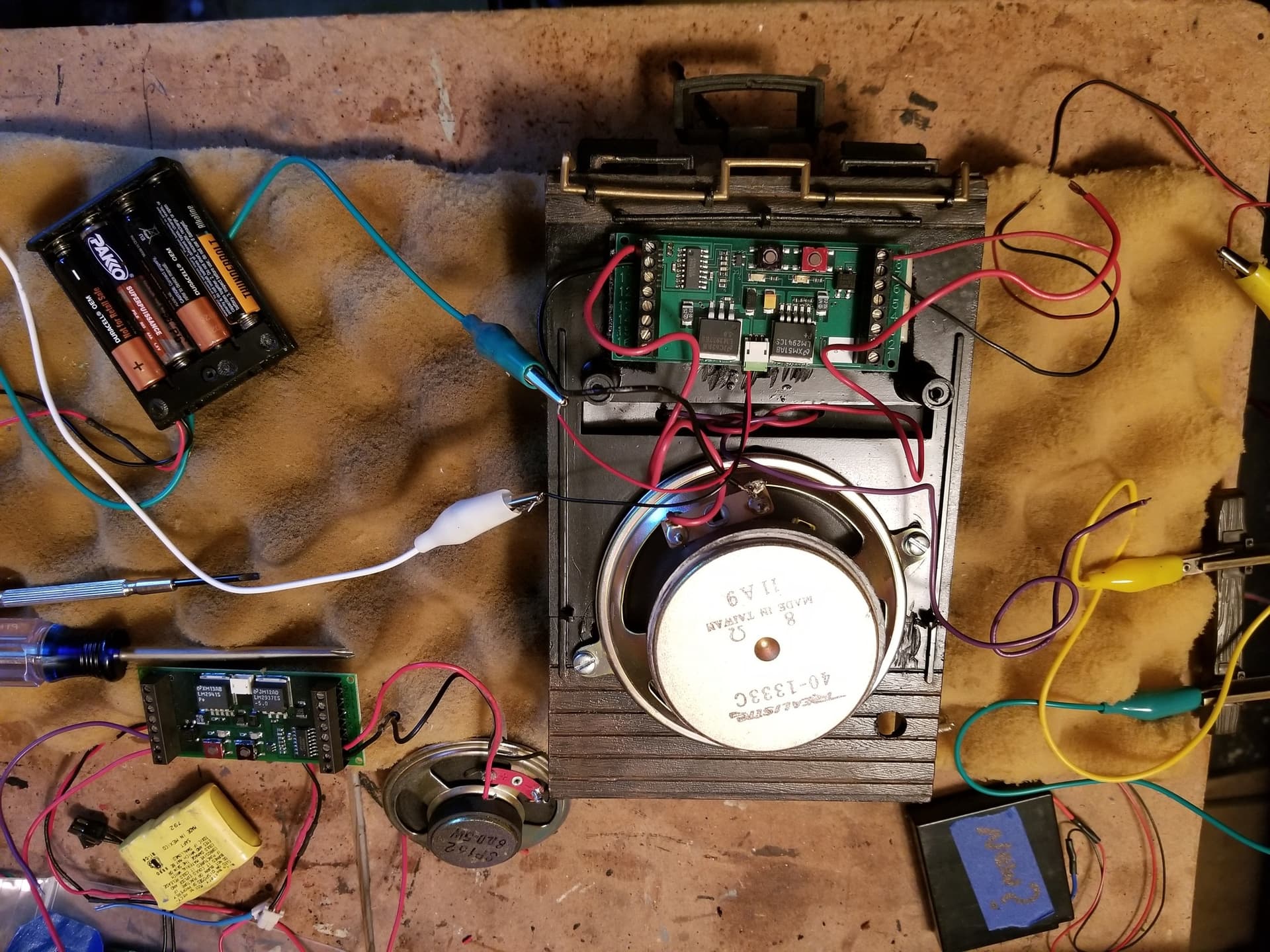

I have 2 Sierra sound cards that may have died. In the most basic wire up, I put power from a transformer and a speaker and all I got was farting noises. I then hooked up a battery to it and still just the farting/skipping noises. There is no bell, whistle or chuff that used to be triggered with increases to the track voltage.
What happened? Any ideas?

Try a different speaker and see what happens. Just a thought…
It’s funny that you mention the speaker John because I fixed the boards.
It turns out that the one in the tender was having a problem because one speaker wire was hanging on by a thread. This setup started failing while moving down the track.
On the loose card I was testing I didn’t push the battery pack plug in deep enough. They can be tough to unplug so I pushed it in half way to test and the card just wasn’t getting the power.
How silly is that. Lesson learned, Always double and triple check that your wires and batteries have a solid connection. :grin:
Now to figure out where to put that extra card. It has a nice tone to it like an early steam train would.

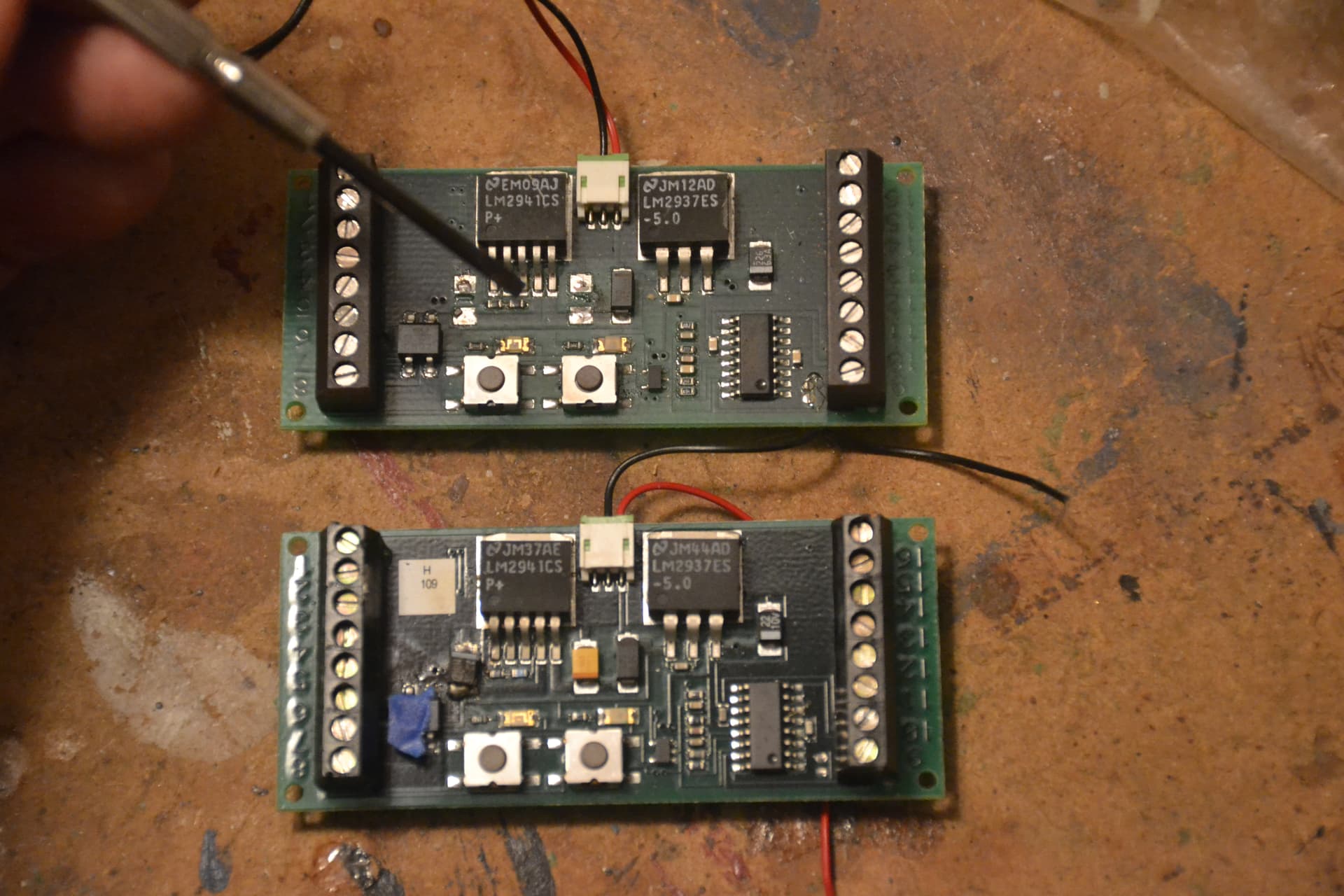

More Sierra card mysteries.
I have 2 cards that released the magic smoke years ago and I put them aside thinking that someday someone could fix them. I decided to test them again and surprisingly they worked… sort of.
In this photo I’m pointing to a spot where 2 little black things got so hot that they crumbled off the board when touched. Surprisingly this card is still working. What were those things that heated up and how can the card work without them? Are they relays?

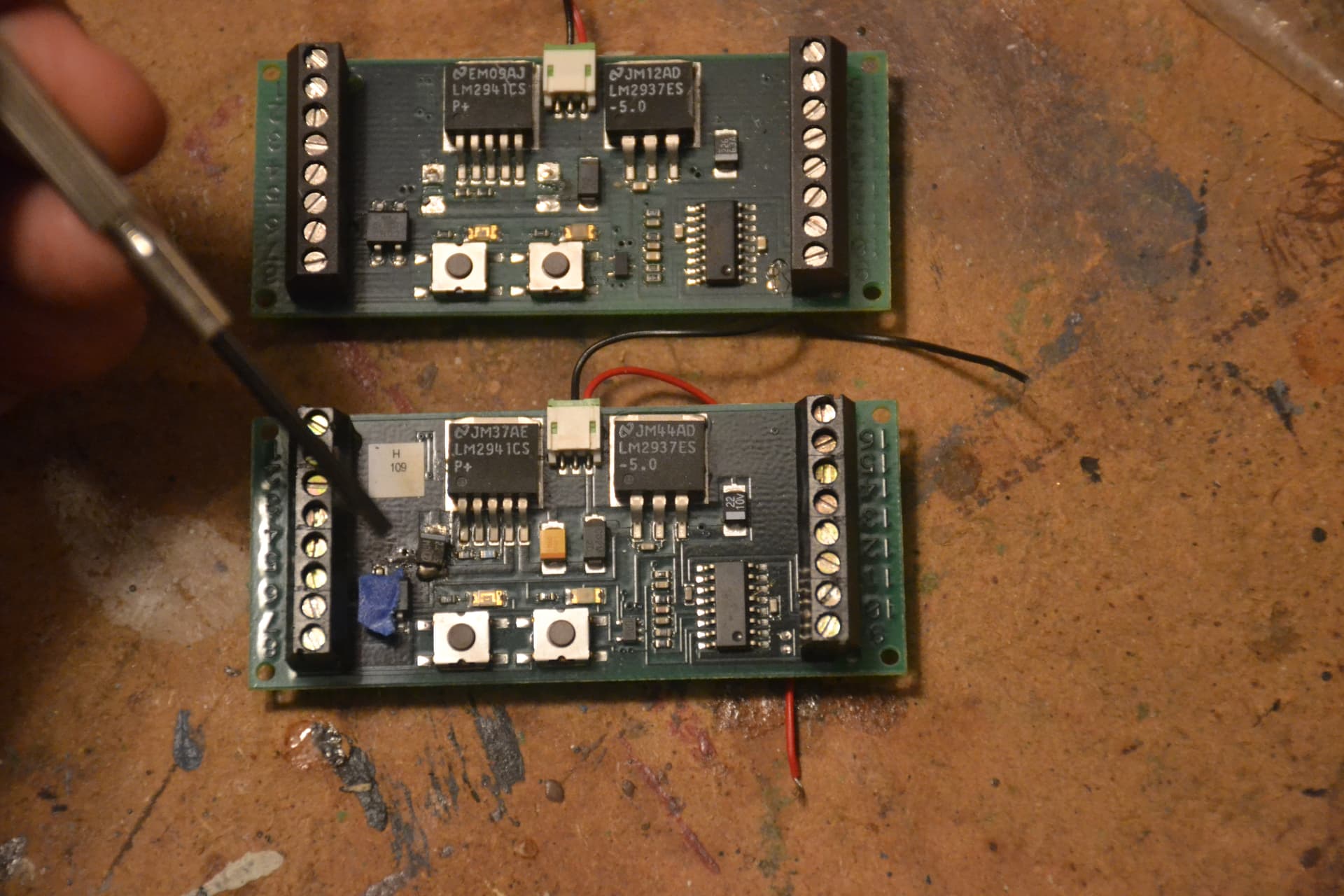

In this photo I’m pointing to a spot that smoked when I tried it out. It was working until the smoke poured out. I put a piece of blue tape over the problem “relay”.
I think the card on with the blue tape is officially cooked but I think the other one with the 2 missing relays, if that is what they are called is still serviceable but I’m not sure if I trust it to put it into an engine.
Maybe I should try taking the relays off the cooked one and put them onto the “good” one?
Not relays. More likely diodes, caps, or resistors. The sound may still work so as long as it gets sufficient voltage, but it may fail to recharge the battery. It may also smoke at a later time.
The other board looks like that would be a voltage regulator under the tape.
