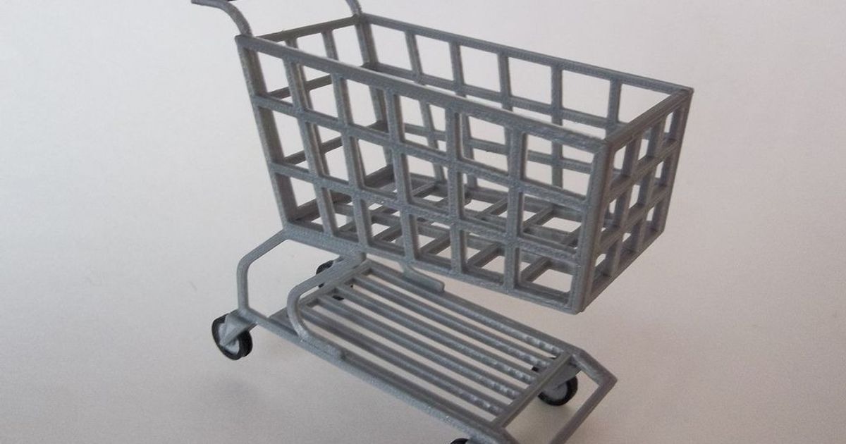

I saw this and thought surely a 3d printer could do this.
…and
Apparently so!
IMG_9613
Looks good Bill, quote me a price on 100 delivered with the Purity logo on the swing down seat :grinning_face_with_smiling_eyes:
i would be content with just half a dozen. in scale 1:1 please.
Korm, I think we can do better than that.
Instead of 12 trolleys in 1:1, how about 1 trolley in 12:1?
IMG_9616
whow! in that one would fit all the merchandise of my store.
