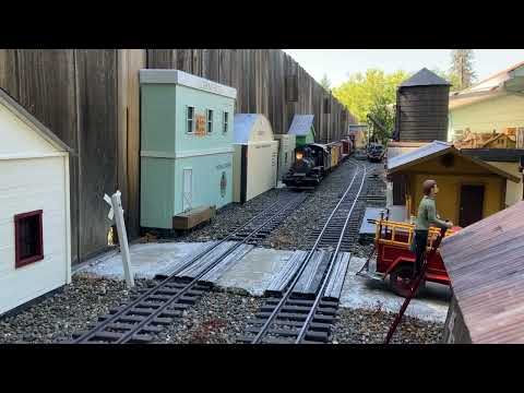

Posting a new video, not much of one I’m afraid. Since I am new to this video thing I was just using a not so great one to practice editing etc. I searched all over for simple editing software and then found out I already have a program installed on my computer. Jeeeze, how are you supposed to know these things?
Anyway, here it is.
Another gorgeous model, Rick!
