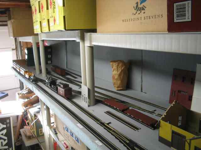

Here’s a simple set up I made for my 0n30 switching layout:
(http://rgsgardenrailroad.com/0n30lyt.jpg)
I borrowed this switch list idea from Bart Salmons and modified it to fit the Salida yard. Since all the industries are contained here and I’m too lazy to change the numbers on the cars, it won’t matter which car is set out as long as it matches the type car on the switch list.
(http://rgsgardenrailroad.com/SW01.gif)
I have a blank piece of card stock I lay over the switch list and just move it one day when I’m done with whatever day I’m switching. For example: On Monday the meat packing co. should have 2 stock cars on the siding. The stock yard is empty…etc. On Tuesday, the meat packing company siding is empty, so you pull the 2 stock cars from that siding and take them with you. Since the stock yard is still empty, the stock cars go to the fiddle yard which acts as an interchange to be picked up by the next local freight. And so on down the list for that day. When that day is done, you move to the next day. For this layout it takes about 2 hours to do the whole week. On your layout, a mine siding can have a diverse set of cars on it. Gons and boxcars for loads out, boxcars, flatcars and reefers for loads in…etc. Even a tank car sitting there for water…or a passenger car being used as a bunk car or cafeteria car for the workers. On friday nite you pick up the passenger car and take the miners into town for the weekend…
