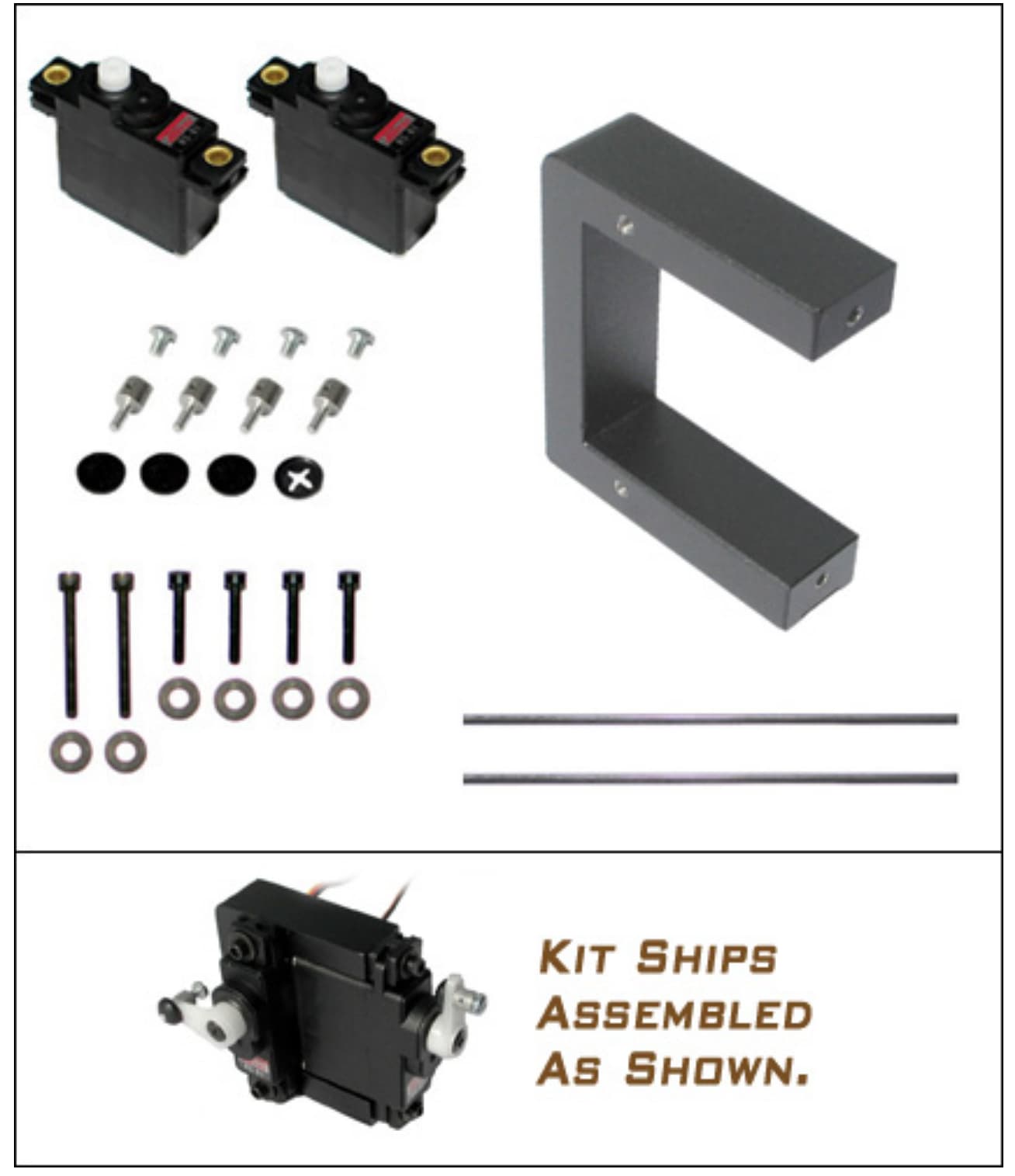

I am looking for a servo holder that fits in the slot on the back of my Accucraft Mimi Ruby. I can’t find one anywhere. If someone has a plan to build one, that would be great too. It would have to be built to withstand the torque of the servos. Thanks in advance.

I post this on the hope that someone will look at his ‘kit’ and reproduce something similar.
Very clever and efficient design. A single 3DP part with threaded inserts, plus servos and hardware.
Bummer that it was “temporarily sold out” 3 years ago, and the page was last updated 21 years ago.

I’d be more concerned about the rigidity of the structure holding the servos? For anyone bemused by this discussion, here’s a screen shot from his website. It’s really very clever:
Nor have I, though I’ve seen a number of servos in LS locos. I was merely trying to answer your comment about filament withstanding the heat. For rigity, if one knew the temps involved, some testing with a toaster oven should clear that up.
