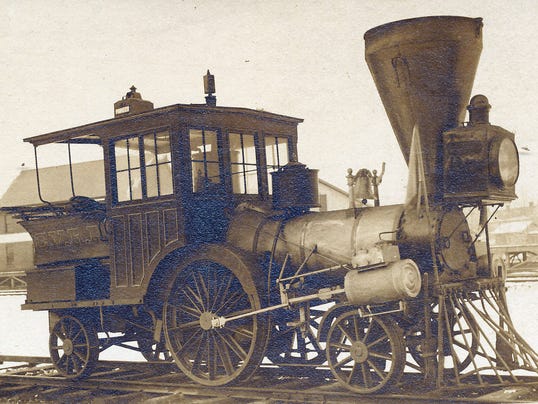

that is one cute little loco in your pic.
as spindly, as it is (apart from smokestack and headlight) it could well be pre-civil war.

Korm,
It is Pre-civil war and it used to ride the rails about 300 ft behind my home. over 1/2 of the CVRR mainline still exists to this day. She now resides at the B&O museum.
http://www.borail.org/cvrr-pioneer.aspx
BTW …Same builder (Seth Wilmarth) as the bell crank loco I modeled (Utility). Lots of similarities to the Pioneer and Utility. Pioneer had a sister loco named the Jenny Lind which was they CVRR pay train (pay loco)

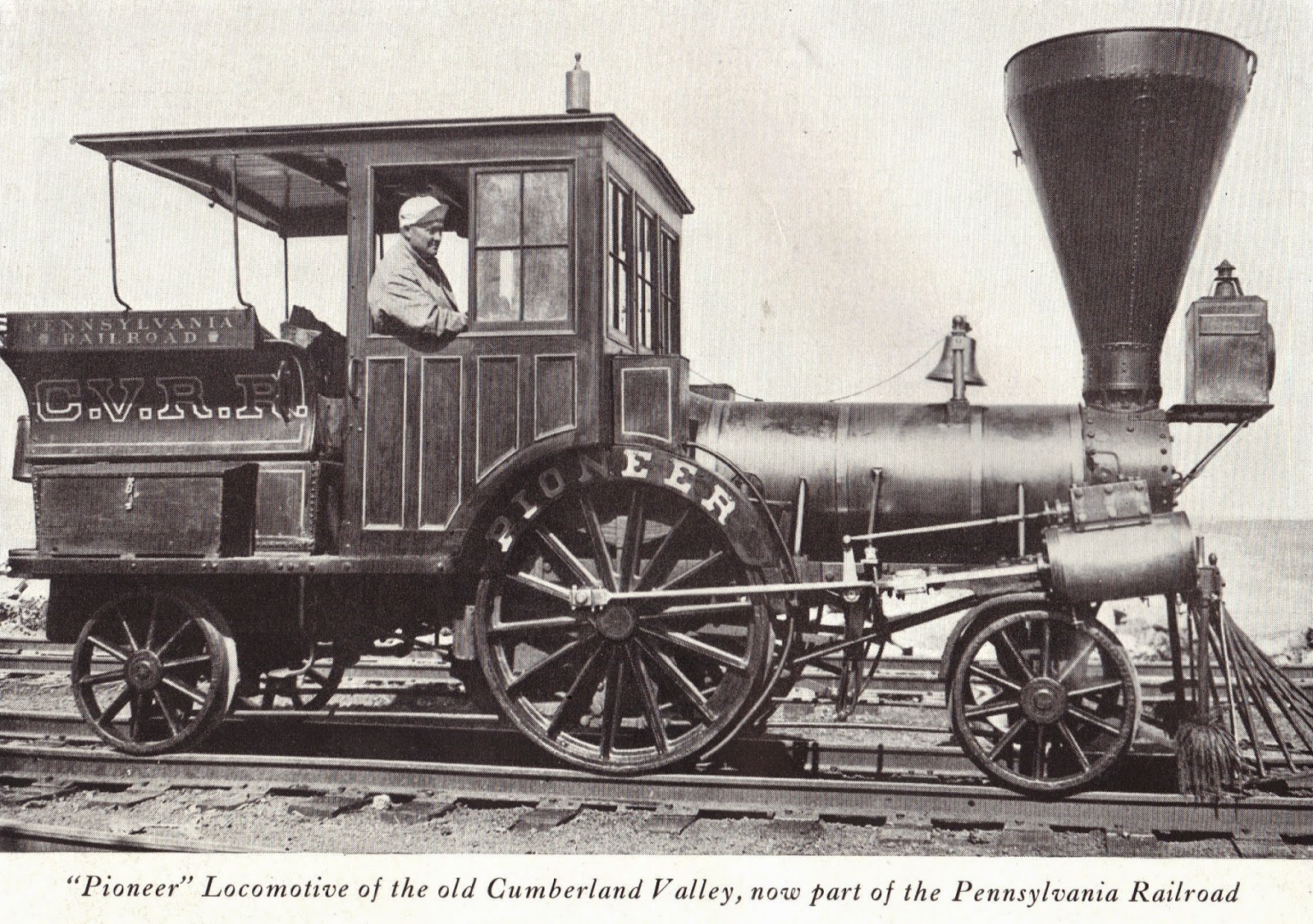

I chose the Pioneer for it’s age and it was at the top of the page…

If you google images of the Pioneer you will find that later in it’s life the sanding dome on top was removed and sanding “boxes” were put on each fender or (splasher). However when they restored her they put it back to original.
Them’s some BIG flanges on the rear truck/pilot…
The 2 things that look like upside down palm trees just behind the cowcatcher are brushes to clear the railhead?
**Greg Elmassian said:**The 2 things that look like upside down palm trees just behind the cowcatcher are brushes to clear the railhead?
looks to me like oldfashioned straw brooms. (well used up)
and TWO sandboxes! above the wheels.
