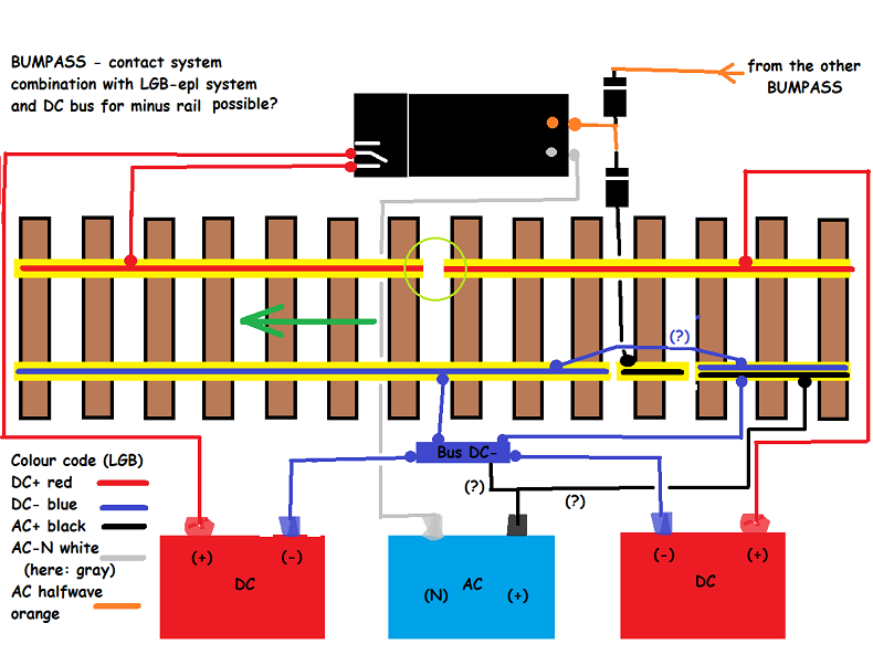

i made a sketch below, to show, what i would like to do, if possible.
(there will a little bit more to it, like daisy chaining switchmotors, to make sure, all southbounds are arrived, before the northbounds start etc.)
my question:
can i add to a (DC-) bus one leg of an AC bus? (lower right, blue and black cable)
Yes. When I devised the Tortoise Bump Accident Sentinel System (Bump ASS) it was not to throw a turnout, but rather to active a relay to turn off the the opposing loop before the two trains collided. Which ever train reaches its Bump activation first turns off the other train for a predetermined time span. The EPL is just a latching relay.
But the “wheel gap activation” is the the ticket and I share AC and DC on the common rail including the lighting and turnout motors without problem. But, IIRC, I put the “Bump” activation on the “live” rail. In my case, if the rail is not live, there can be no collision and the system is unnecessary.

on the upcoming layout, i will have only one epl-turnout-motor (for the two alternating northbounds) the other turnouts will be hold to their direction by fishing line with fishing weights and cut open in the other direction.
the other epl combos plus Bumps or reeds are used exclusively to shut off or turn on the isolated sections, where the locos wait their turn.
is that necessary, or better?
i ask, because i got the DC+ rail planned to use strategic feeding points plus diodes every foot to have slowdown and speed up sections.
No, not better, just different. Either should work the same.
Know that any/every metal wheel that crosses will also activate whatever. In your example, this is not a problem so long as your train is not so long as to span both sets of “bumpers”.
But if it was an applications like a “leap frog” you would only want this to be activated by one contact (the reed), because every set of wheels would trigger the trains to alternate and they would jossle between each other until you have an accident.
For the “bumper”, I just use two rail insulators with a short piece of rail long enough to fill the gap between the two. Solder your wire to this rail just under the railhead before inserting it.
I also do the diode sections for speed up/slow down on my point to point mine line and use them to slow things through the station where the trains leap frog.

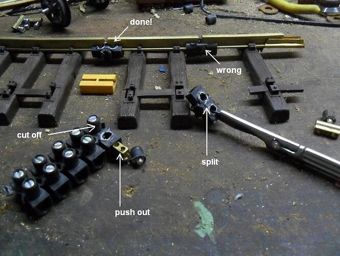

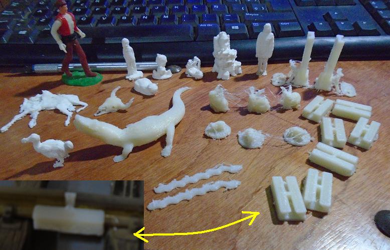

got about 16 epls. but the isolators are a problem. the yellow ones have too much slack for the short rail-pieces. my 3D-printed break too easy. but i found and tested a solution.
the plastic-sleeves from cable-connectors. cheap, avayable, from elastic material, keeping the rails centrated. just one drop of Fastix (silicone) needed between rails.

Have you tried printing in ASA? This is the most tolerant filament of environmental influences (both weather and UV resistant) and retains more flexibility (i.e., less likely to snap on you) than PTE.
You need an enclosed chamber (best ~50 degrees C) and run the extruder at ~260. Make sure the fan is off.
BTW, the black LGB insulators seem to work better than the yellow insulators for this sort of thing.
These are obviously 3D printed:https://www.ebay.com/itm/326417282331?_skw=lgb+insulators&itmmeta=01KJ8NZWZ65N9TKKDF03SMJB5D&hash=item4bfffc751b:g:8sYAAOSwncVnlC2T&itmprp=enc%3AAQALAAAA8GfYFPkwiKCW4ZNSs2u11xCRK1fLY1mxoxiklPTMlEXq8nfCvcQEICUeKy4qOnaCjxgVQpNiP31UbQqN6gFUDZg61rMGmkgmpL2e1JSXBK2cez3i%2F8Vz8smH%2FiXXybdxt3Z3ZOqH%2BIX5DgU%2FzS8KKWbPWPct5wxQYtKsRq6XP4agQWuwTFQhoGcbbf5RSev9M4jd2IvHe%2Be5Z5yR4IobYtkv4YpTYBYWIg5VEKPyMj6Zi9AOIkoXGa8oeiavsr9Ih8gGefk2CPhQUa3MwVnEEXQCMhUWSad875wa2prAgddg1NQ69Ke0nE2bozucUFy9gw%3D%3D%7Ctkp%3ABFBM5s__lZJn
no, my old DaVinci printer feeds on ABS only.
