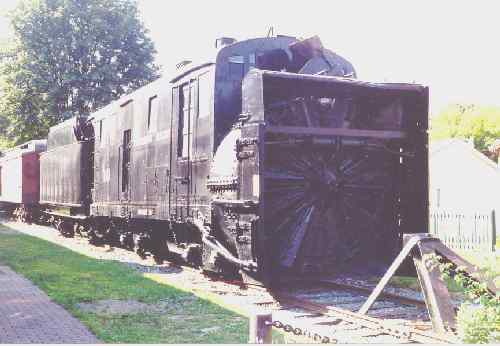

Rotary Plows explained
Todd thanks for the description and videos. I do see what your saying about the pre-cutter doing the bulk of the work also the heavier snow. All in all a fun project though. I just have to many to my list.
Here’s my snow thrower that’s almost finished. I’ve have it on display at the ECLSTS in York.
http://www.largescalecentral.com/forums/topic/23043/something-i-ve-been-working-on
I followed your link Rick and that is one fine looking rotary you built there. We need to see it in action soon.
Ideal blower wheels for a rotary plow should look like either type 2 or type 3 in the Cincinnati Fan link here: http://www.cincinnatifan.com/blower-wheels.htm. This design wheel will be non clogging in both directions or rotation, allowing a more prototypical design for your railroad. These folks do not have any thing that small, but I am trying to provide the best solution in terms of a fan wheel. I will continue to look for a vendor who may be able to supply something.
Bob the type 2 one I could see being made from brass sheet and some soldering work. I get where your coming both from a clog stand point and a rotation stand point.
This maybe a stupid question but did the real thing spin both ways? Purpose? is this for shooting snow to different sides?
Thanks Todd, and shortly I’ll have a post on the redesign installation and a working video for everyone to view. I’m just waiting on a loco machinist to drill the shaft down to 1/2 so we can attach the Kirby vacuum blade.
Bob, I have a supplier that has several new and used Kirby vacuum metal blades, when those run out we’ll have to go to the plastic version. But, I do like those version you suggested from the link. I’ll see if their interested in designing a small verison.
Yes Devon, the prototype could discharge snow on either side of the rotary. This would require the blades to rotate in either directions to allow the rotary to discharge on whichever side the railroad needed. You certainly would not want to discharge into a rock wall where there is a cut on one side of the line and a large fall off on the other…
