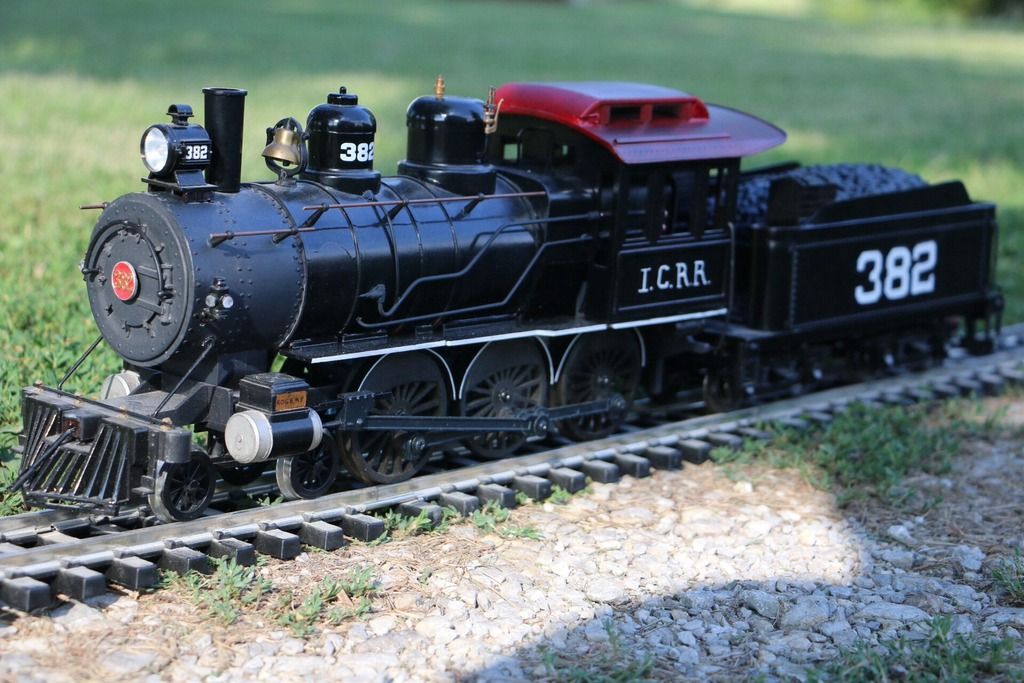

Hello LSC! With a pending move coming, it was time to roll out a few projects that have been sitting on the bench. This one has been in the making for about a year now, which might be a record for me, but i’m sure no one here has had this problem lol
This 10 wheeler is based in 1:22-1:24 range. Most might know this one from the famed last run of Casey Jones.

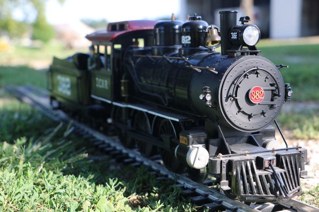

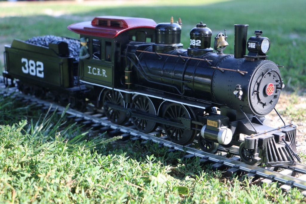

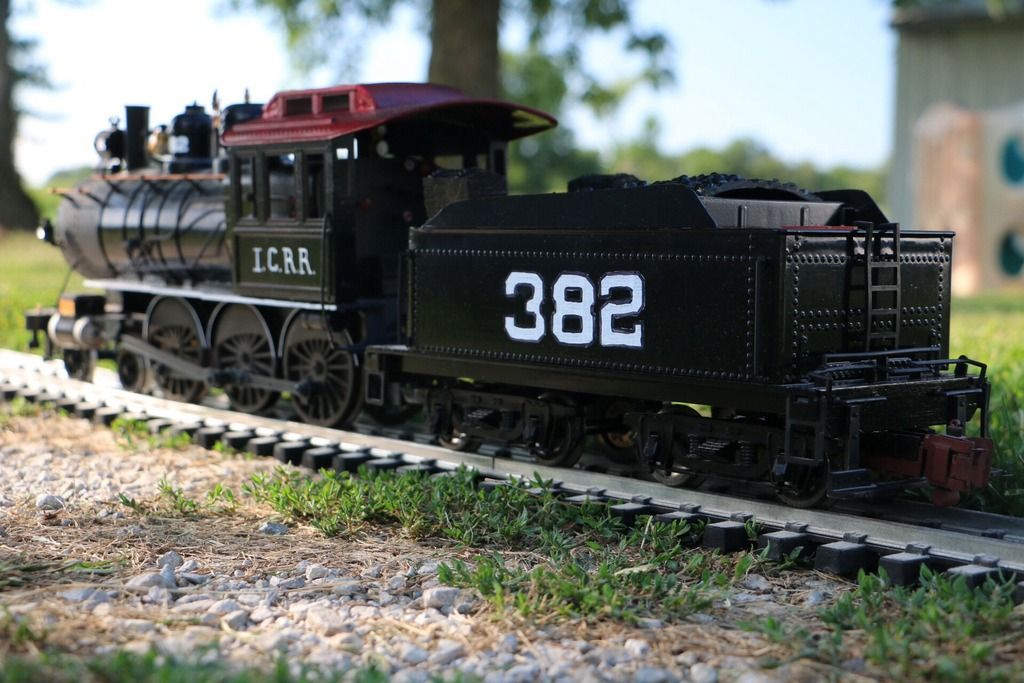

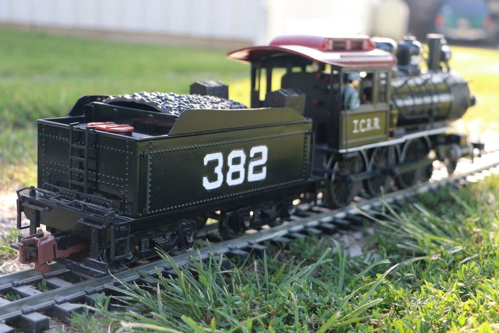

Built on top of an Aristo-Craft Pacific drive, then a new boiler from 2 1/2" conduit, then Bachmann 10 wheeler cab, domes, headlight, shortened tender with passenger car trucks, pilot, and Aristo delton C-16 cylinders. Here is the result so far
still a few little details to finish yet, but almost there. This was a challenging, yet very fun project. I learned a lot doing this one, and a lot to never try again lol
Forrest, it was probably the part I struggled with most in this bash short of the drive modifications. I used Bachmann passenger car roof parts for it, but the slope had to be reworked a lot and filled in to get the right match. still not crazy about the splicing I did, so I may try to touch it up a little bit. I do really like the look of that type of roof though, I did a similar roof on a backdated shay I did, makes it stand out nicely
