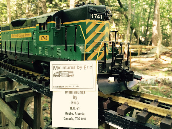

Rockwall Canyon GP7s: #1741, 1742, &1743 have received new snowplows and high hood bells in preparation for the colder seasons ahead. The photos show all engines with plows and one unit with the bell mounted. As of this evening, all units are now completed.
Here we see the combination of Kadee whiskars and snowplows coexisting! Also, there is no problem with trippins from rolling stock interfering with the plow either. Case closed on that old concern!
Plows and bells were custom designed and produced by minatures by Eric. The prototype locomotive for the detail parts is NHN 1757 ( formerly of PRR vintage). Thanks for a great job on the details Eric!

How hard were the plows to install?
I hope they are sturdier that USA’s!
Can we get a behind the seen shot on were the plows are mounted?
They look great!
Do you think they will hold up to plowing snow?
Charlie Brown saw these and he might want some on his Geeps!
Hi Sean,
The installations were pretty easy. I used Kadee #905 body-mounted couplers directly bolted to the front sill using brass micro fasteners. For the plow, I had to file a bit of the train line connections on each side to create a flat surface for the plow frame to set. (The back side of the plow has 2 narrow vertical plates for mounting). I used an aggressive contact adhesive (“Amazing Goop”) to join the plow to the frame.
I like this contact adhesive better than a plastic cement or hard epoxy. This product produces a somewhat rubbery bond that withstands a bit more abuse and is resistant to shock failure…for a plow, this is nice.
The application technique is a bit strange. First, apply glue to the plow, and press it onto the engine’s sill. Next, remove the plow for 15 seconds and then reapply the plow. Once the glue has set the plow is finished. Additional glue can be added to the joints to further reinforce the plow if it seems to be needed.
How come you didn’t bolt them on?
Hi Sean,
On my first attempt I made 2 brass angle brackets that were bolted to lower plate of the plow and front sill of the loco. This worked well, but it was difficult to get to the bolts fastned. I decided to try using the glue instead since I trust it for a lot of similar tasks. Although I don’t really care to demonstrate, i suspect I could pick up the locomotive by the plow without it falling off.
