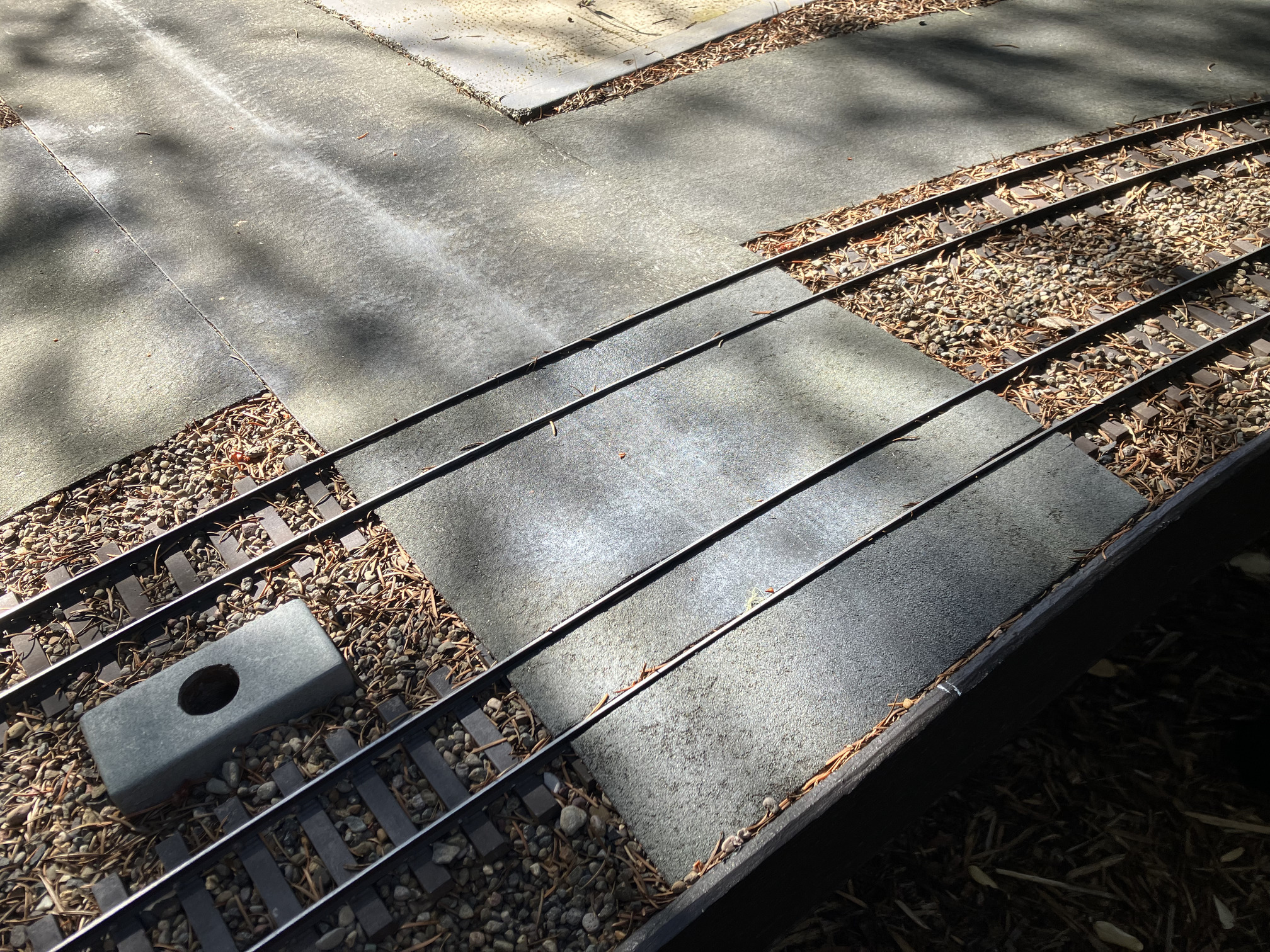

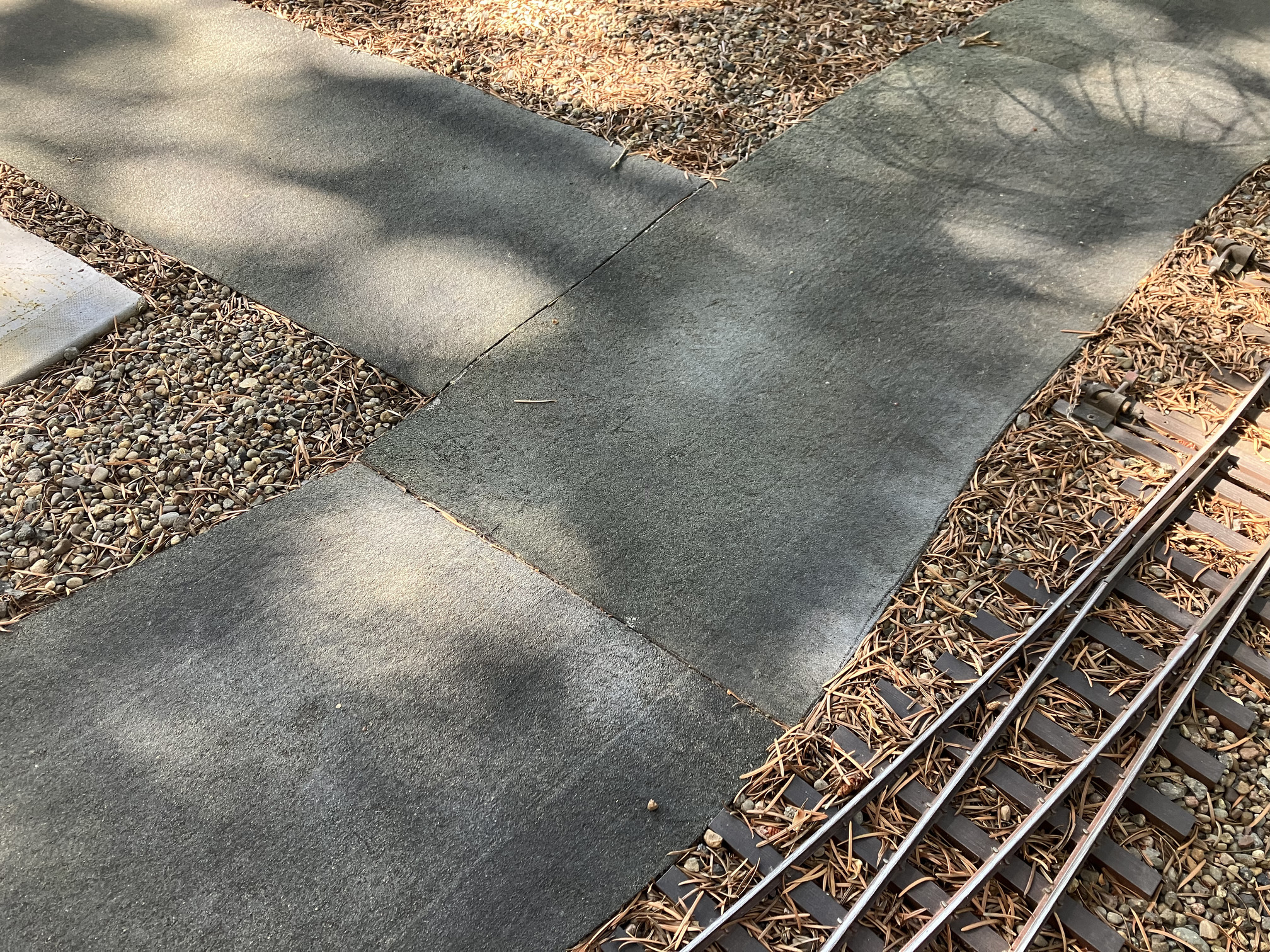

I have used patching cement, mortar mix, and combinations of each. They look pretty good if your after a Concrete roadway but over time they begin to fail. Usually cracks and separations at joints and stopping points. This seems to be exaggerated on raised wooden structure because of the expansion & contraction of the wood structure. It is also kind of expensive, lots of waste and time consuming to install.
I started using 90 Lb. mineral surface roofing felt several years ago. It is fairly inexpensive and easy to cut and place. Doesn’t matter what color because I place the back side up. Just a little dusting of gray, brown, black etc. spray paint and it is there for years with no problems.
A couple of pictures that sort of show the results.

I use 1/2 by 1 1/2 cleats glued to the roofing material about 12-16 inches on center. At joints I lap them 3/4 by 3/4 on each piece. Liquid nails works pretty well and the cleats are easy to snug down into my base gravel.
So far, almost 3 years, I have had zero problems with this system. Like I said quick, easy and looks acceptable.

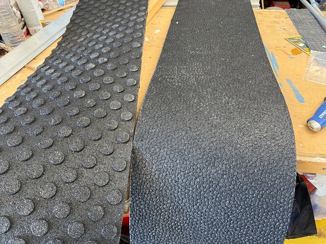

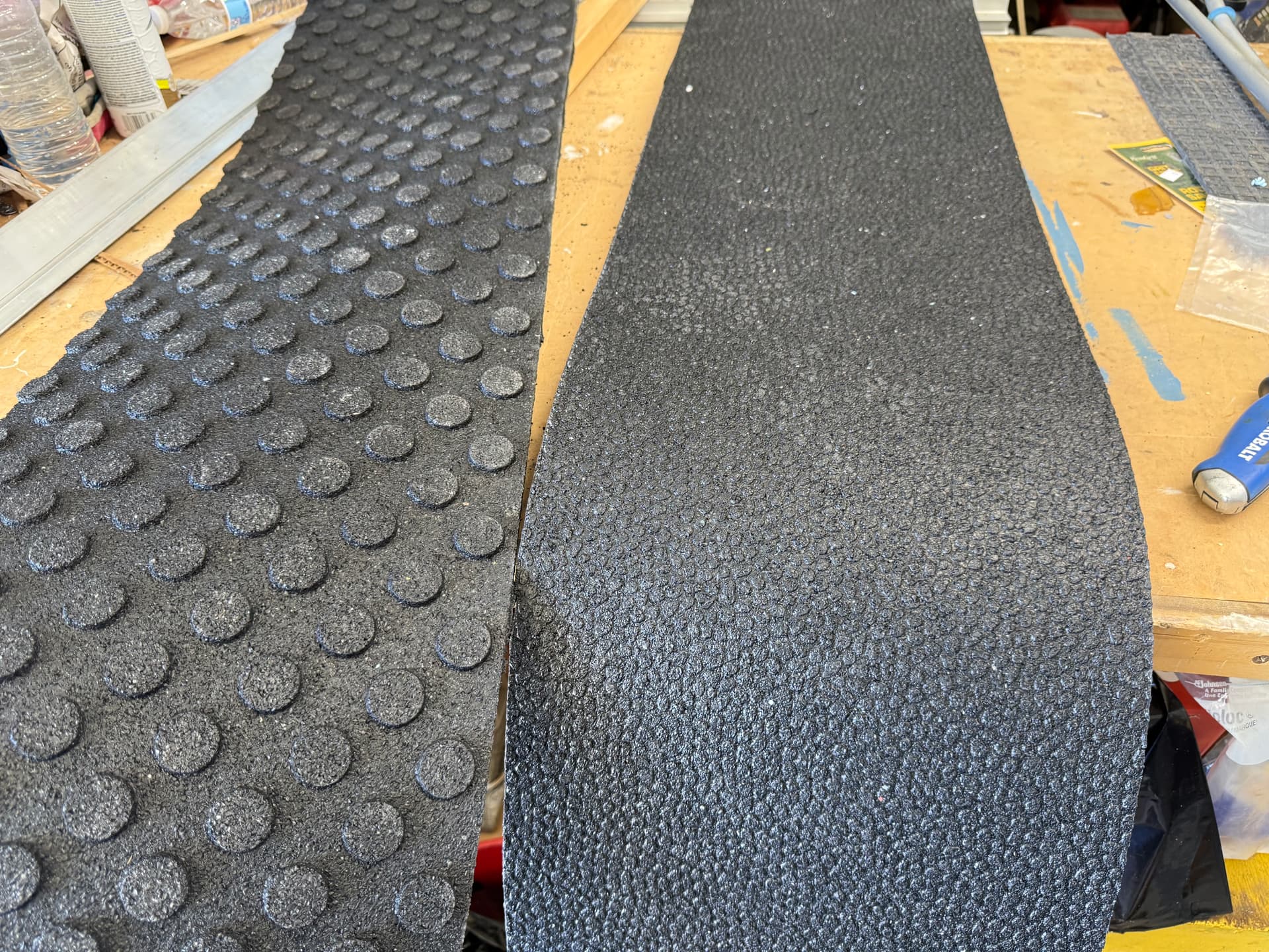

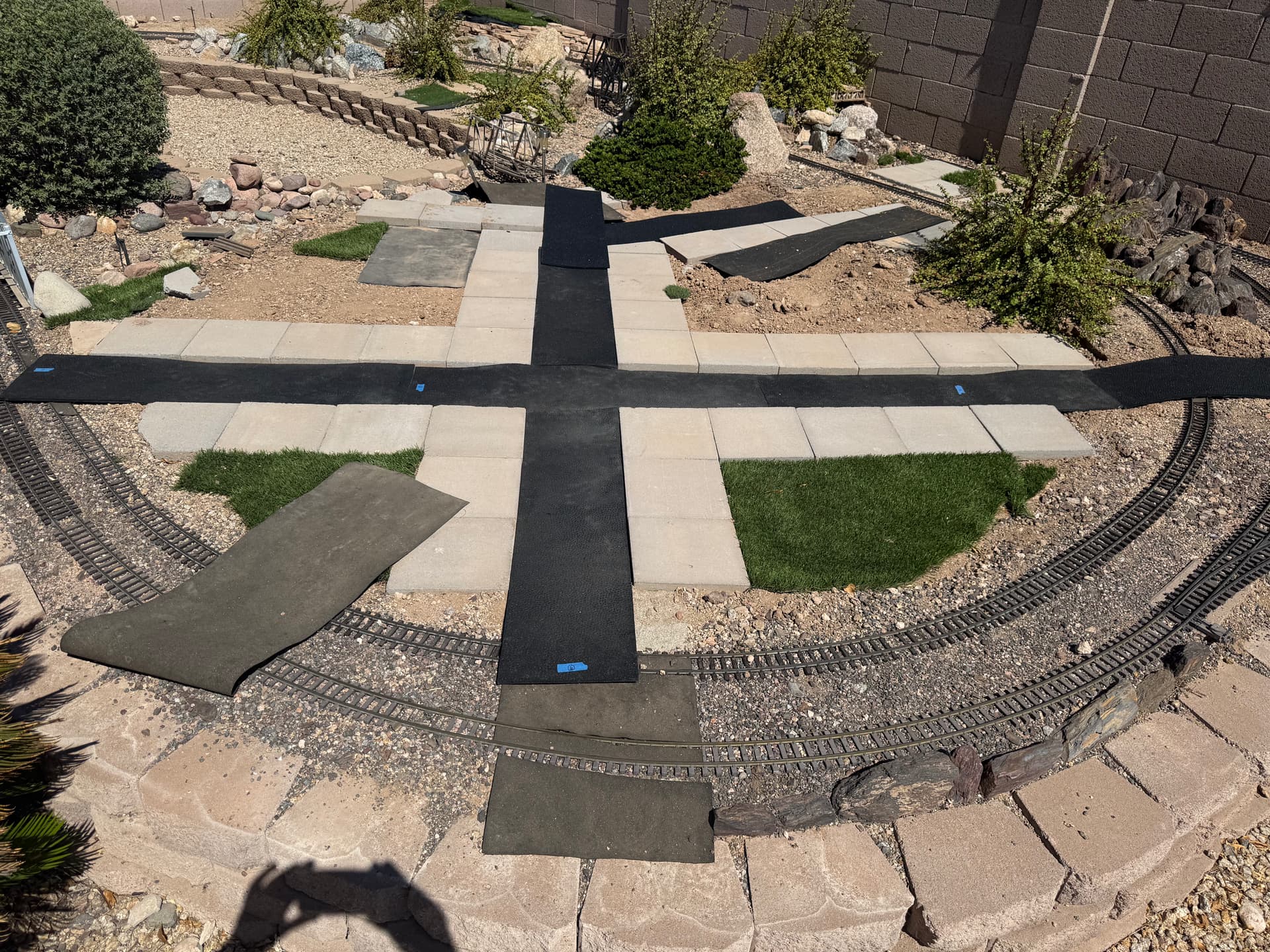

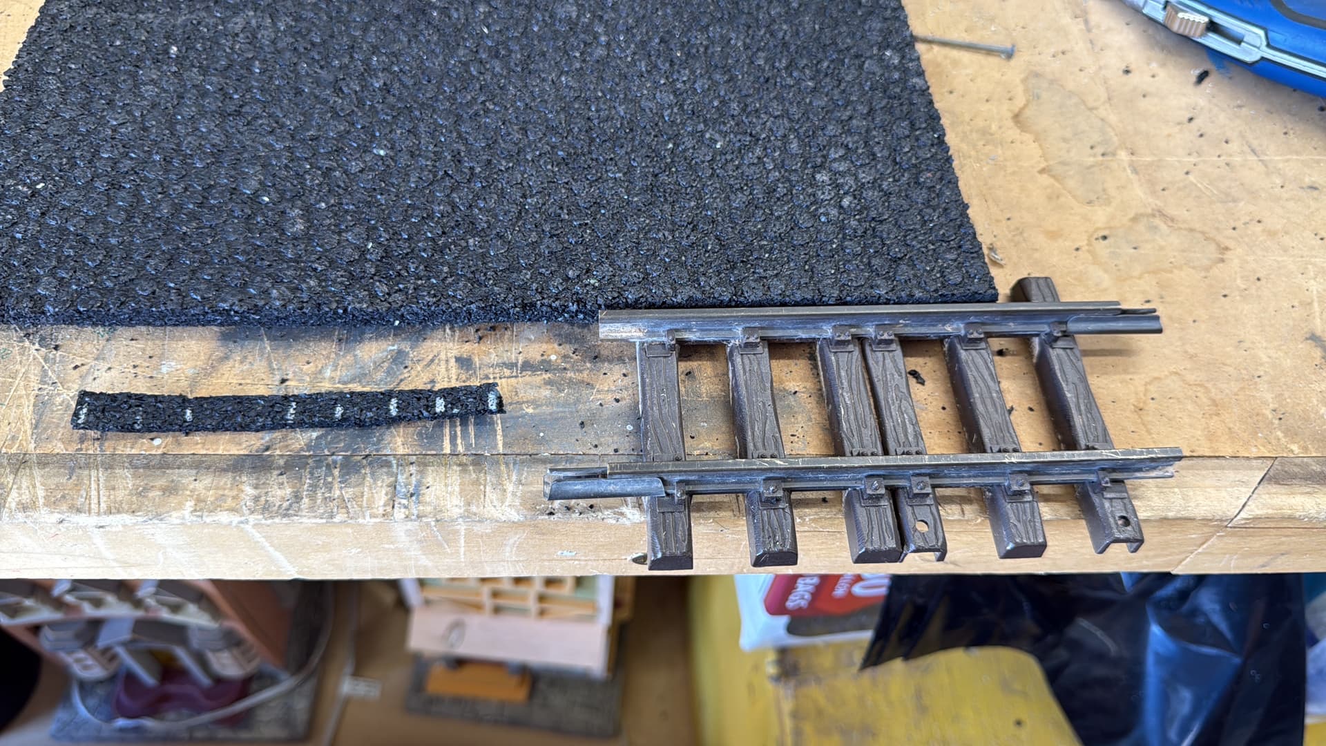

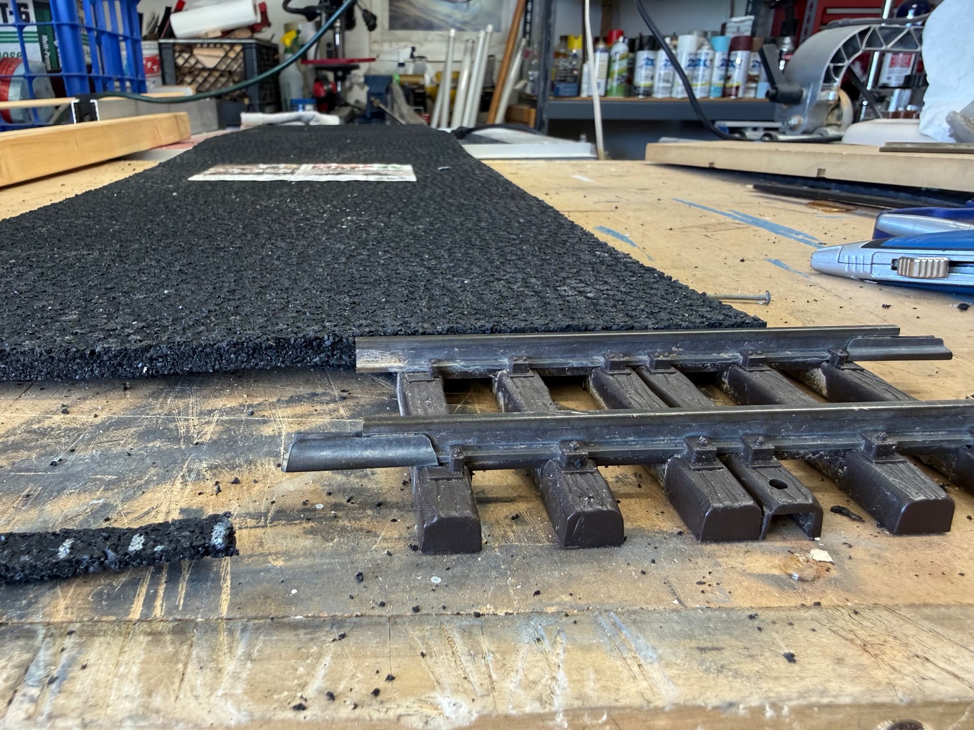

Costco is currently selling frozen $17.99 rubber matting 3’x4’ and pretty thick recycled rubber . I have acquired several and cut them into 1’ roads and as a test plopped them down to see how they look. Have not trimmed them or decided how to make them meet the tracks .
After cutting into 1’ strips
Temporarily laid out to get an idea on what they will look like

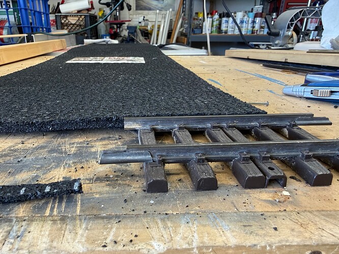

Used a razor knife to cut a lip to snug up to the tracks, but probably will not do this as it will probably cause loss of blood doing the horizontal cutting with razor/ utility knife. I have a product I have used elsewhere that may prove to be better for the actual crossings
Frozen? 20 characters
One hell of an idea Pete!
I think it will be a good substitute for an asphalt road can’t wait for temps to go down some to get them in and see how they last
