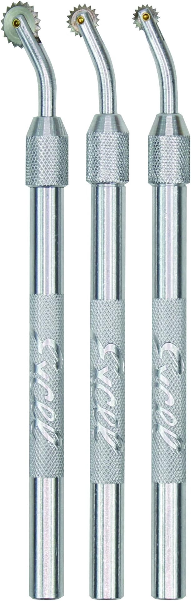

https://www.trainmastermodels.com/Aluminum-Handle-Pounce-Wheel-Carded-With-1-4-Tip-p/exl30606.htm
Pounce wheels come in different sizes. I use the middle one above and get an 1 1/2" spacing in 1/29
