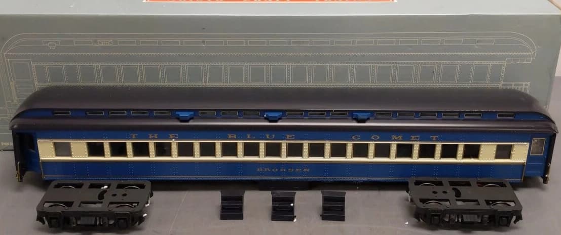

The prototype 900 series heavyweights had four wheel trucks, so I bought a pair of dirt cheap Aristo heavyweights on eBay to be truck donors. The USAT trucks were removed and the Aristo trucks added, along with prototypical safety chains:

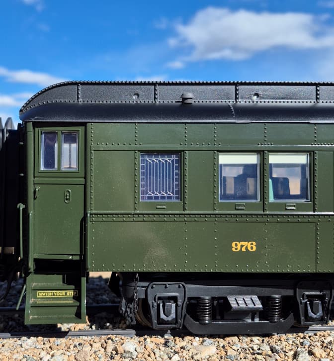

Last week I began lettering of the cars and painting of the RPO/baggage. The RPO/baggage also inherited a pair of the USAT six wheel trucks; it also got a USAT diaphragm on the baggage end. Grande trains during this era had a variety of colors:

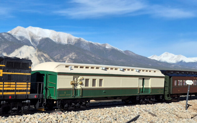

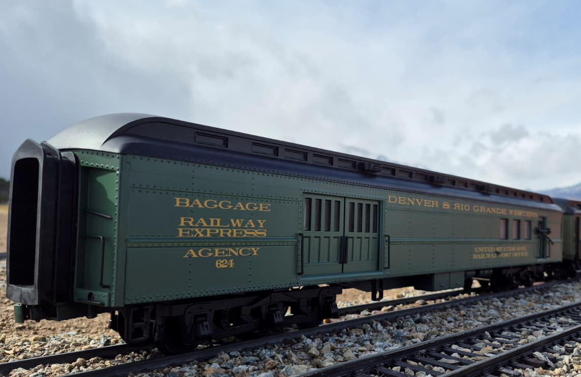

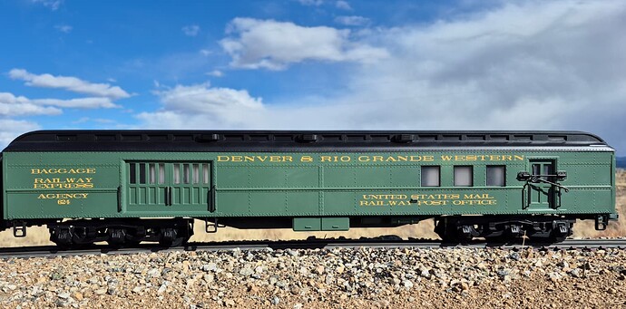

I used Krylon matte Spanish Moss for the baggage/RPO. I was able to remove the Santa Fe lettering from the USAT coaches using a q-tip and lacquer thinner. Each side of each car takes about an hour to letter, but by last weekend I was able to first operate my version of the San Luis:
Here’s that Aristo BN RPO/baggage car after alterations:

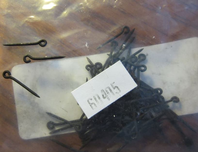

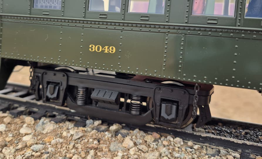

Somebody sent me a back channel email asking about the truck safety chains. The chain is from Micro-Mark. I have now cut up several feet of that chain, eleven links at a time. Yay. These are the brass hooks I used:
I thought I got them from Micro-Mark as well, but cannot find them on their website now. They were chemically blackened with Birchwood Brass Black.

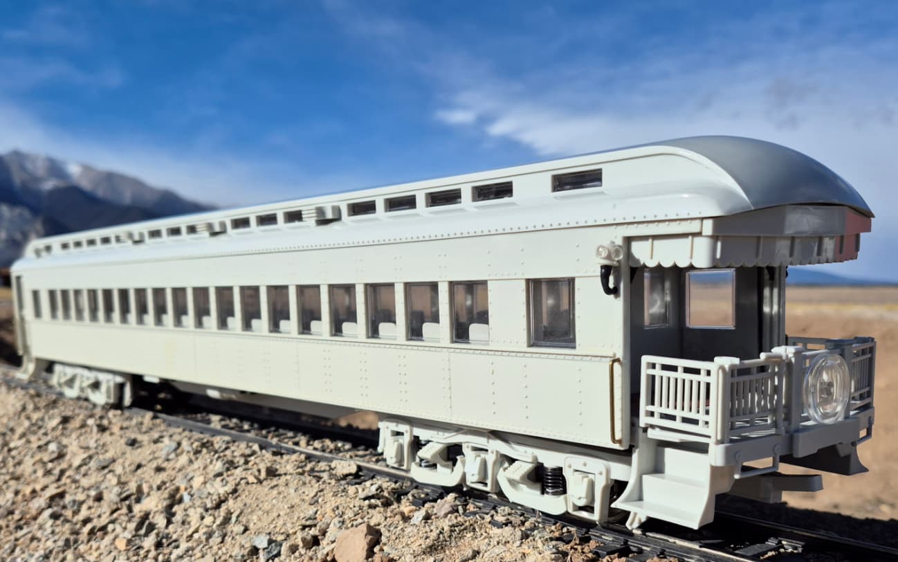

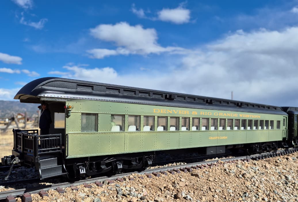

Okay, an update on the Aristo donor cars. First of all, one of them was not a donor. I found an undecorated Aristo observation car on eBay in January for a very good price and made it into a tattered and tired version of the Grande’s business car Granite Canon, appropriate as the real Granite Canon is only a few miles to the north of me. Here’s what I started with:

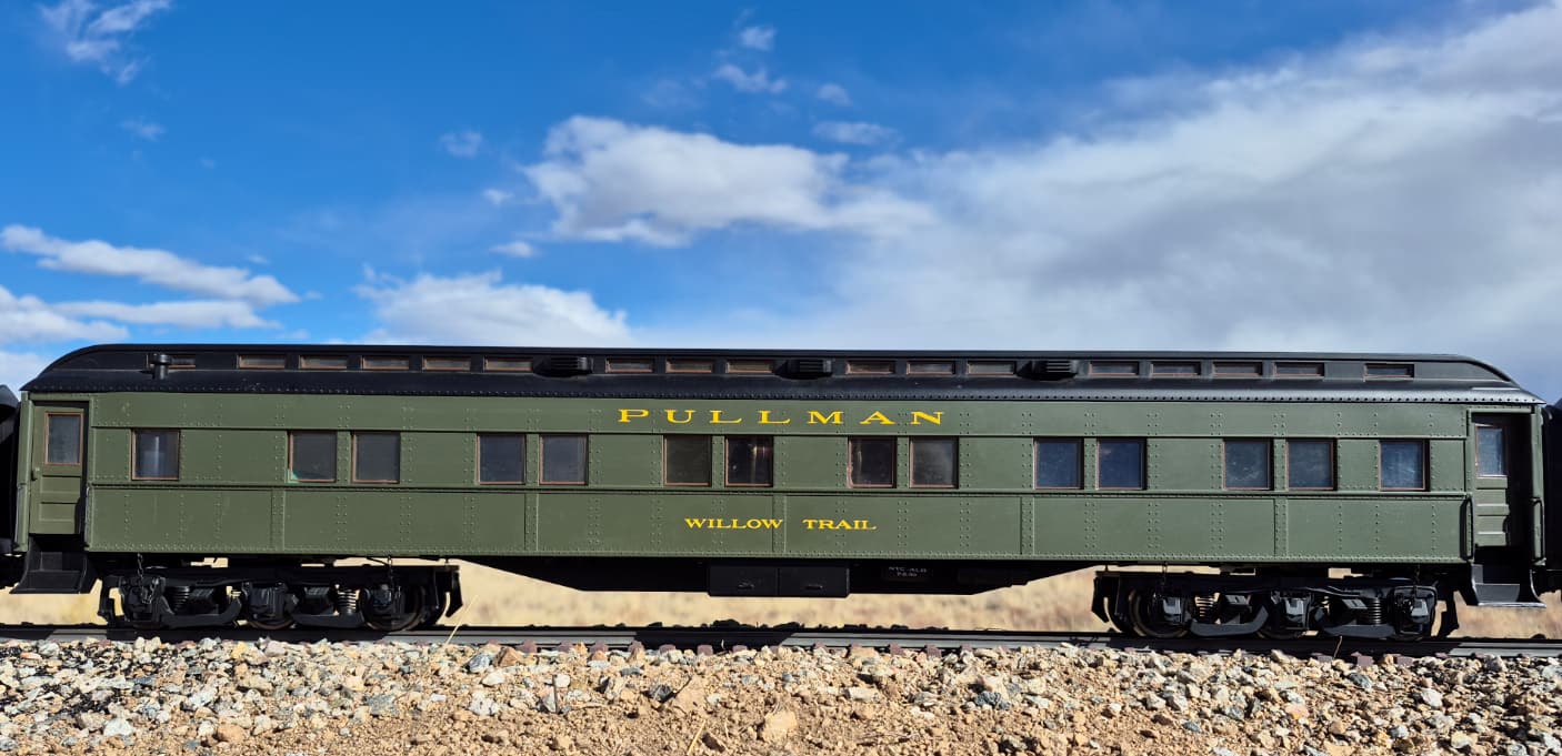

Its six wheel trucks were re-assigned to the Pullman sleeper - more on that later. This car got a set of the USAT trucks from one of the coaches. It was painted with a thin coat of Krylon Satin Italian Olive and lettered with dry transfers. It got new couplers and a USAT diaphragm. The Aristo marker lights are still on it, awaiting proper 3D class lights from my son. The marker light lenses got a coat of Gallery Glass stained glass paint for now. Today it looks like this:

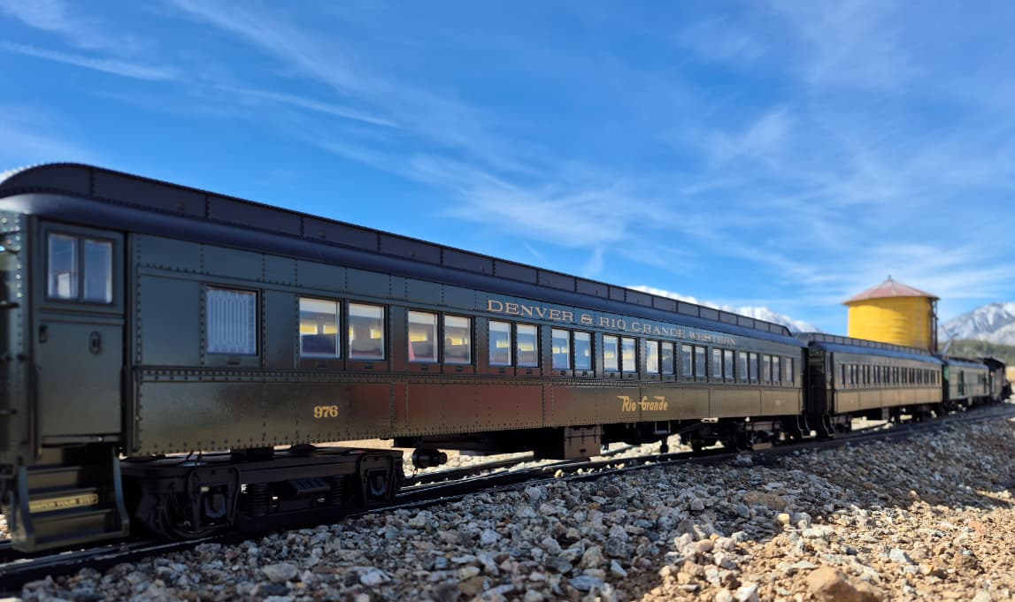

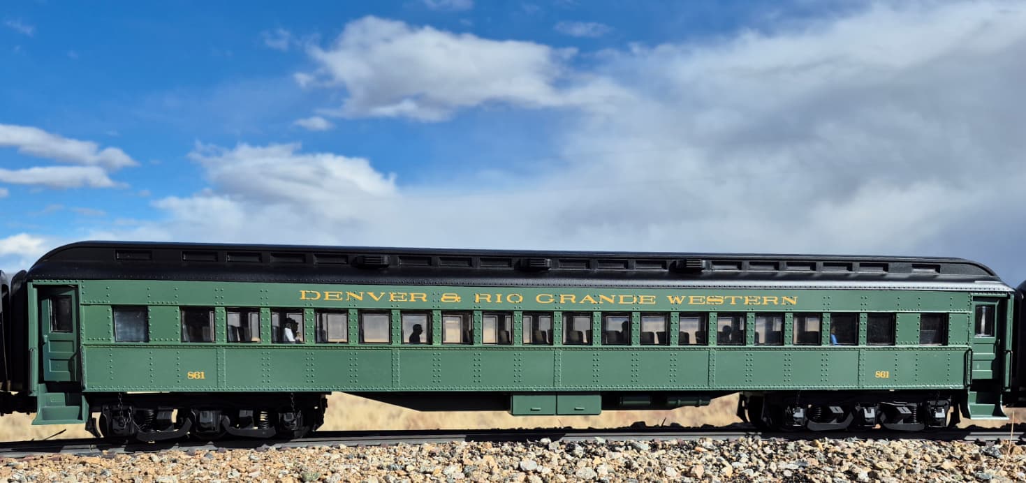

As you can see, it was a little beat up. I cleaned it up and fixed the broken stuff. It got the six wheel trucks from the observation car, a new coat of paint, new couplers and new lettering. It got some passengers from USAT, along with diaphragms. It now looks like this:
This donor car was also a little beat up. I cleaned it up and gave it a pair of the Aristo six wheel trucks and new couplers. There’s a lady in there, but you can’t see her in this pic:

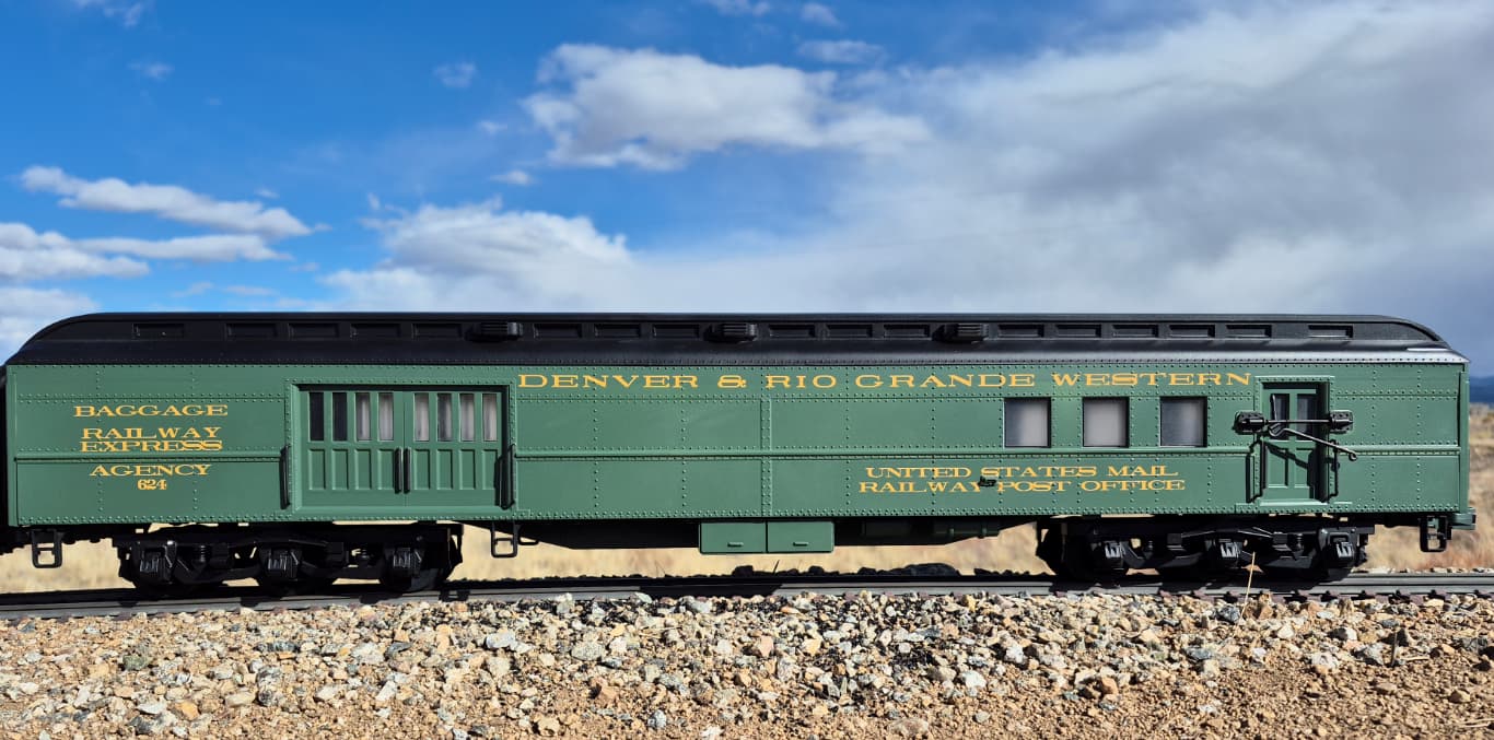

The RPO/baggage car is now mostly done. It got six wheel trucks and a diaphragm on the baggage end from USAT and a coat of Krylon Matte Spanish Moss. It also got new couplers. You can see I have drilled the trucks for the safety chains but they are not yet installed:
One more thing: the USAT coaches got toilet vents from Ozark Miniatures, blackened with Jax Pewter Black:

I understood that the problem with the unpainted heavyweights was that you couldn’t get the window ‘glass’ out in order to paint the body. How did you manage? Was the glue so tired after 30 years that they fell out?
Hi Peter,
I was unable to get the window glass out of the heavyweight observation car, so I masked the windows before painting.
On that Blue Comet car though, the windows all came out pretty easily, making it easy to bury the Aristo gold leaf window trim using a black paint pen from Hobby Lobby.

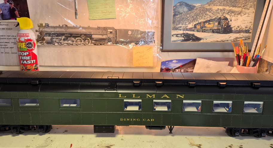

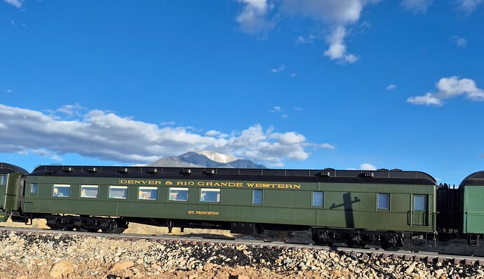

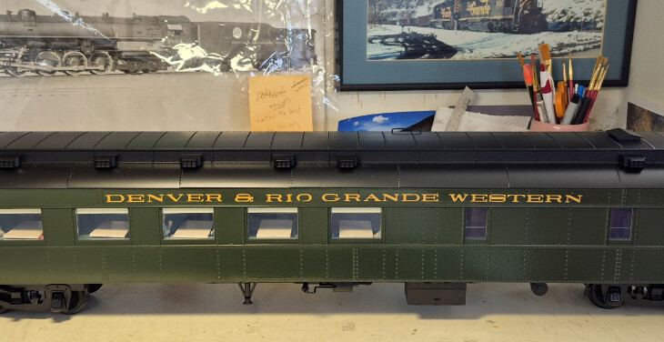

Not having tortured myself enough in March, I decided to add a heavyweight diner to my train. Here’s the USAT car losing its lettering:
The car got Kadee 906 couplers and then I applied the new lettering. I still had enough letterboard lettering for one more car leftover from my earlier custom dry transfer order from Avery at drytransfer.com:

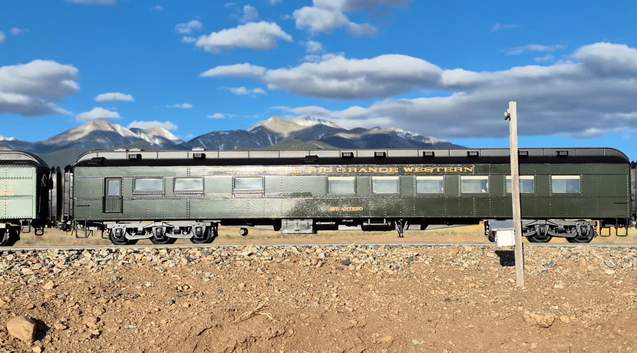

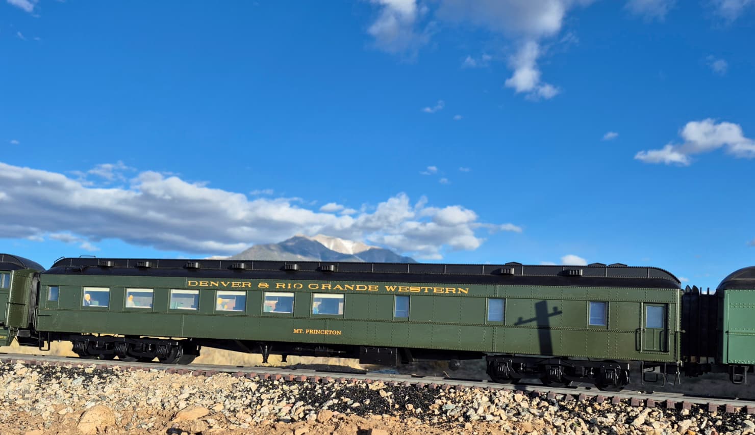

The Grande had four diners named for mountains in my area, two of which are right outside my window. I got lettering for those two mountains. Here is one side of the car posed with its namesake peak, 14,197’ Mount Princeton:
Here is the other side of the car posed with its namesake peak, 14,269’ Mount Antero:

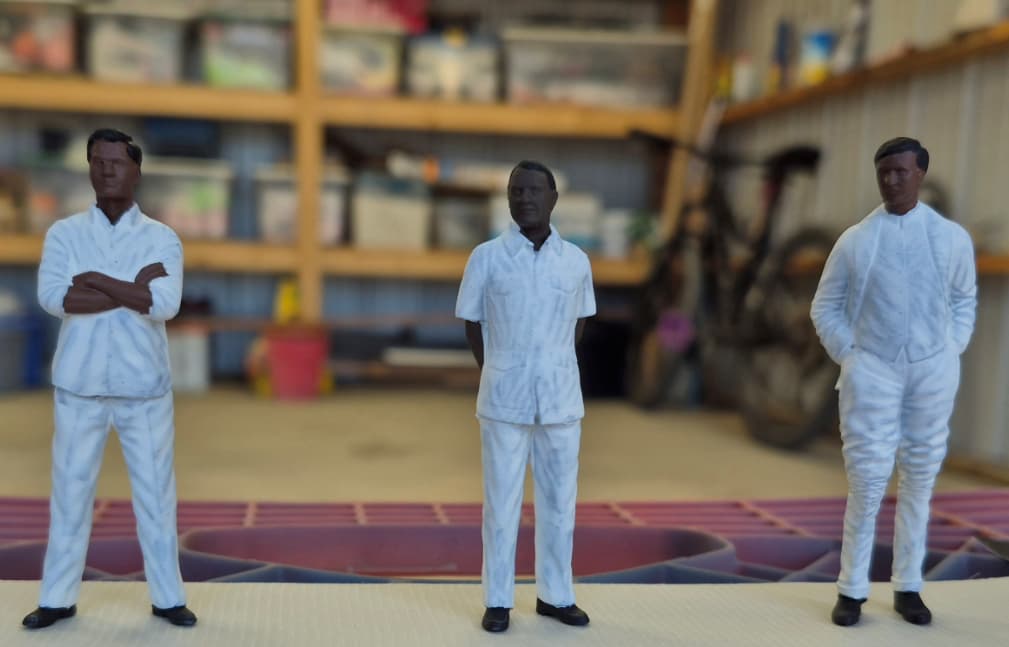

USA Trains included diners in the car and kitchen interiors, but no one to actually prepare and serve food. I got these 3D printed guys from eBay and they will be added later:
My original scheme for a three car train is now a seven car train. Sigh.

Matt,
You need to paint up the guy on the left as Gordon Ramsay. I think all of the features/look is there.
