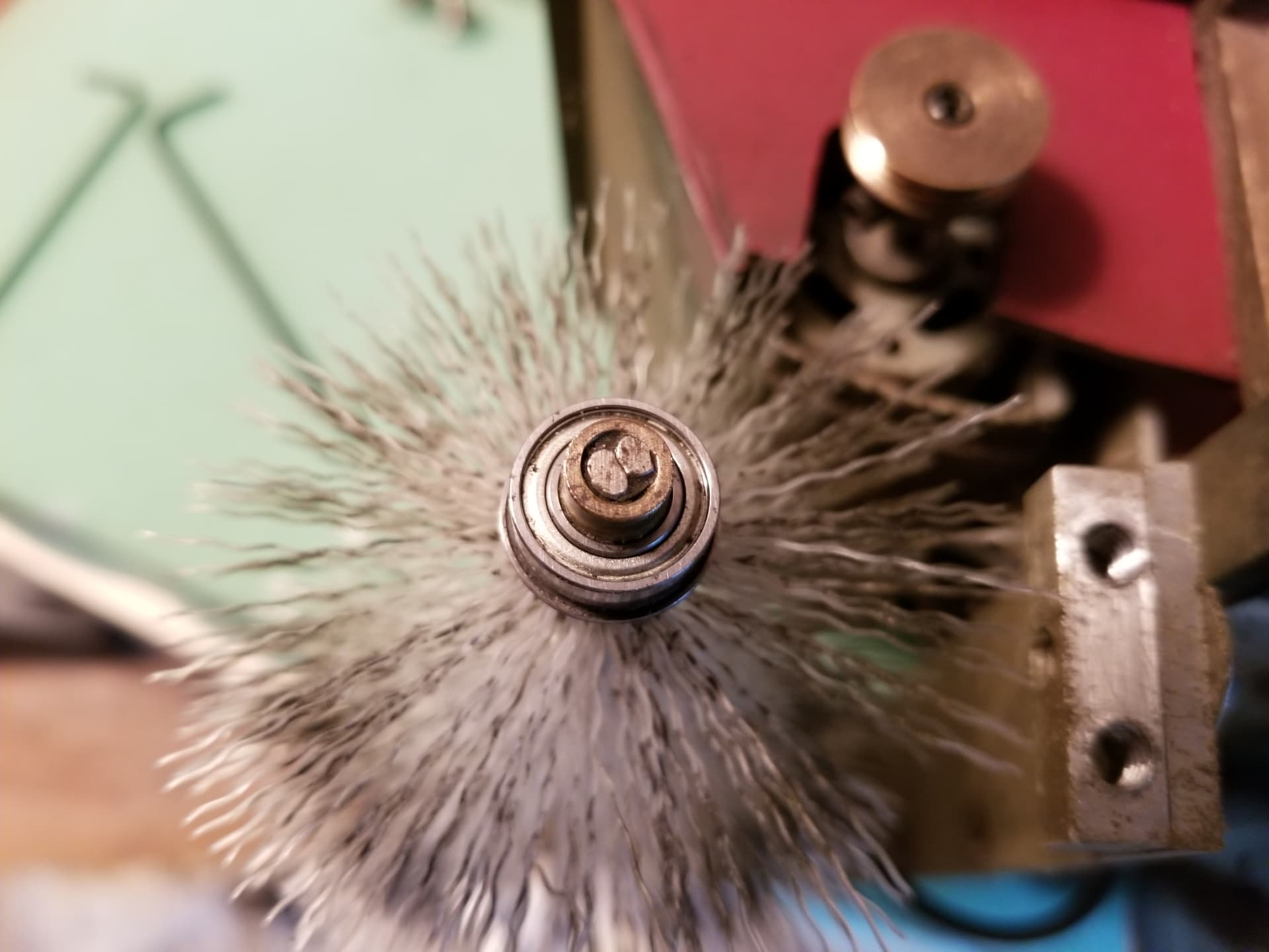

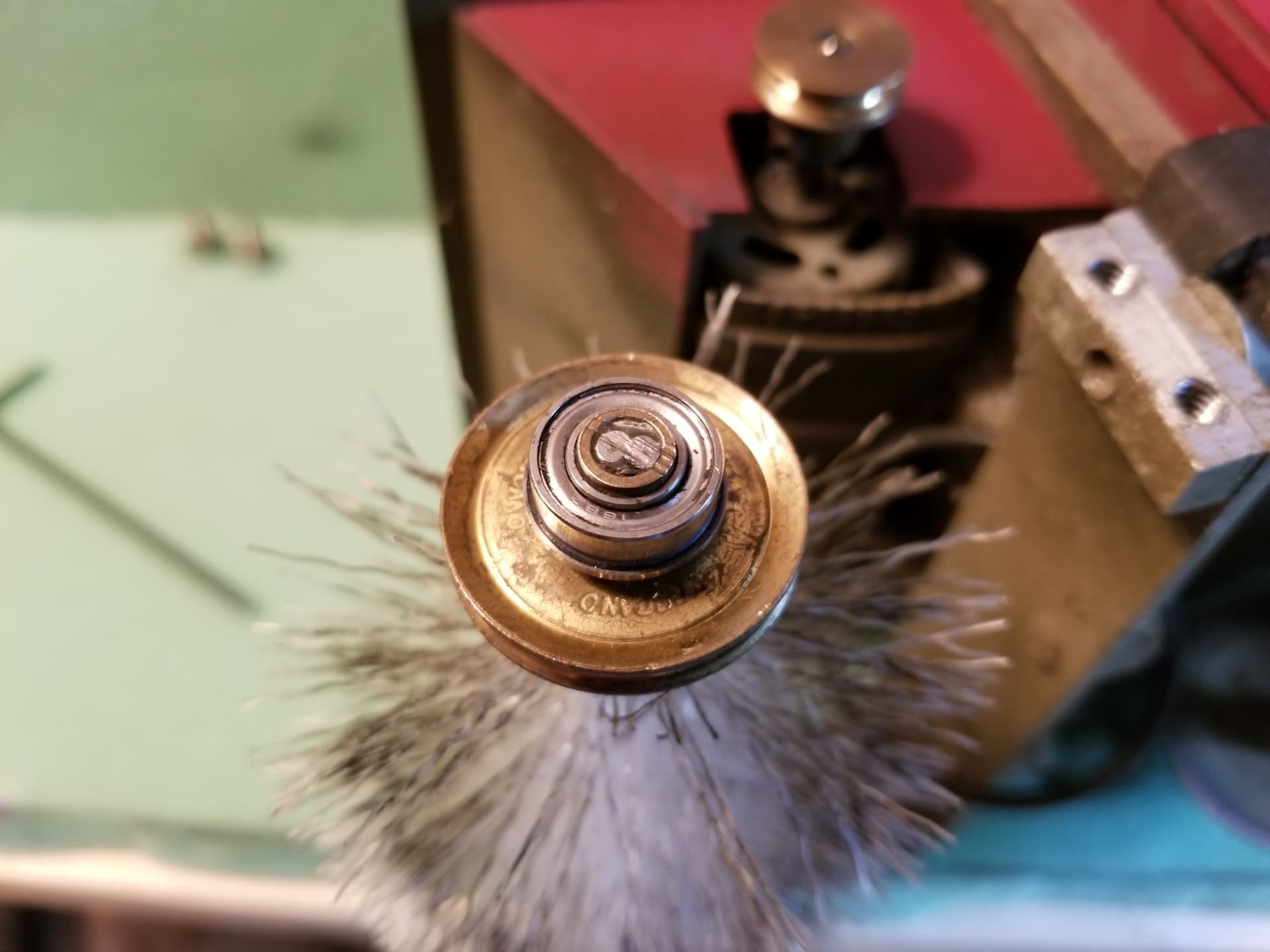

My most used piece of MOW equipment is my Railbroom. Over the years the brush part has become worn. I bought a bottle brush to replace it but I can’t figure out how to get the bearings and pulley off the old one. Has anyone done this before?
It looks like there is a brass ring that grips the twisted metal wire that holds the bristles. It is not crimped on. Could solder hold it on but let’s not damage the bearings with the heat? Maybe glue?
Any ideas on how to take this apart?
Maybe with some solder

The photo with the pulley shows the ends of the twisted wire that holds the bristles. It looks like the brass sleeve and bearing were put on possibly glued and then filed to remove a sharp bit. There is a bit of scoring on the brass sleeve.
I’m going to try as David suggested. Putting it in the vice and giving it some gentle encouragement with a hammer and punch. If that doesn’t budge it I will apply a bit of heat and a wiggle.
Good news. The punch worked a tap at a time. It looked like some type of glue was used to hold the brass sleeve onto the brush part.

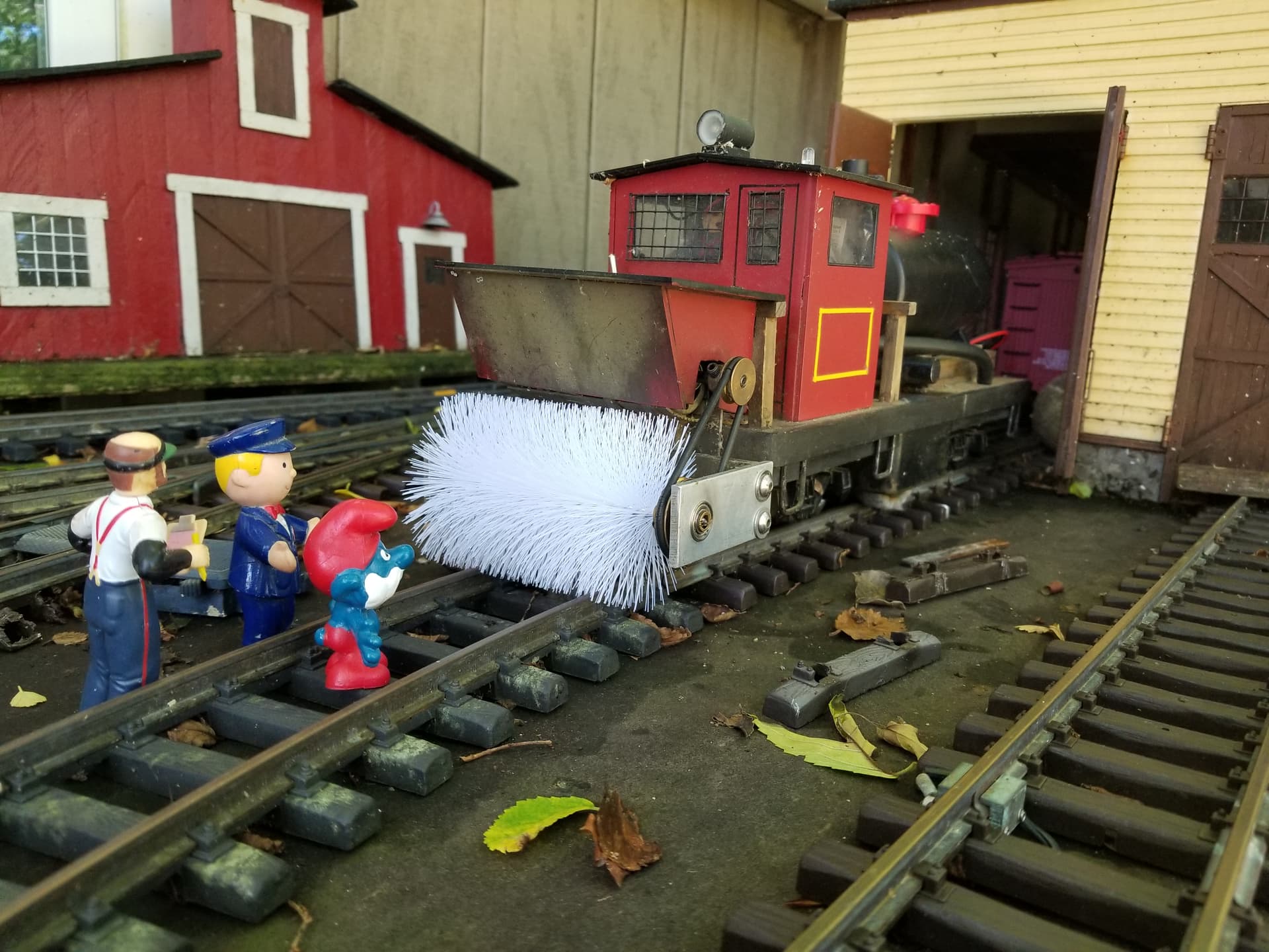

It is back together now and I will give it a track test soon.

The 2.5" width was a trick to find but I found it on Amazon. It came in a 3 pack so I guess I have spares.
It did have to be cut down and some bristles were lost in the process.
The bristles are not as stiff as the original so maybe they will not last as long but that is okay.
