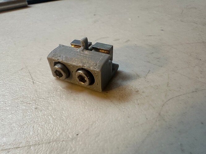

Over the years I have had problems with my split jaw insulated rail joiners.
The problem is that because of the design the plastic piece tends to break.
Because of this I had my son and Al redesign the insulated part
Several improvements were made
  1. The profile of the rail was used for the insertation rather then an angled cut so that it fits better.
  2. the insulated part now goes under the rail to help prevent the stress caused by the insulated part tilting down.
  3. the insulated part was strengthened
  4. there is now an insulated part between the rails that prevents the two rails from touching each other.
Still needs some minor adjustments but if anyone is interested we can share the 3d design.
Stan

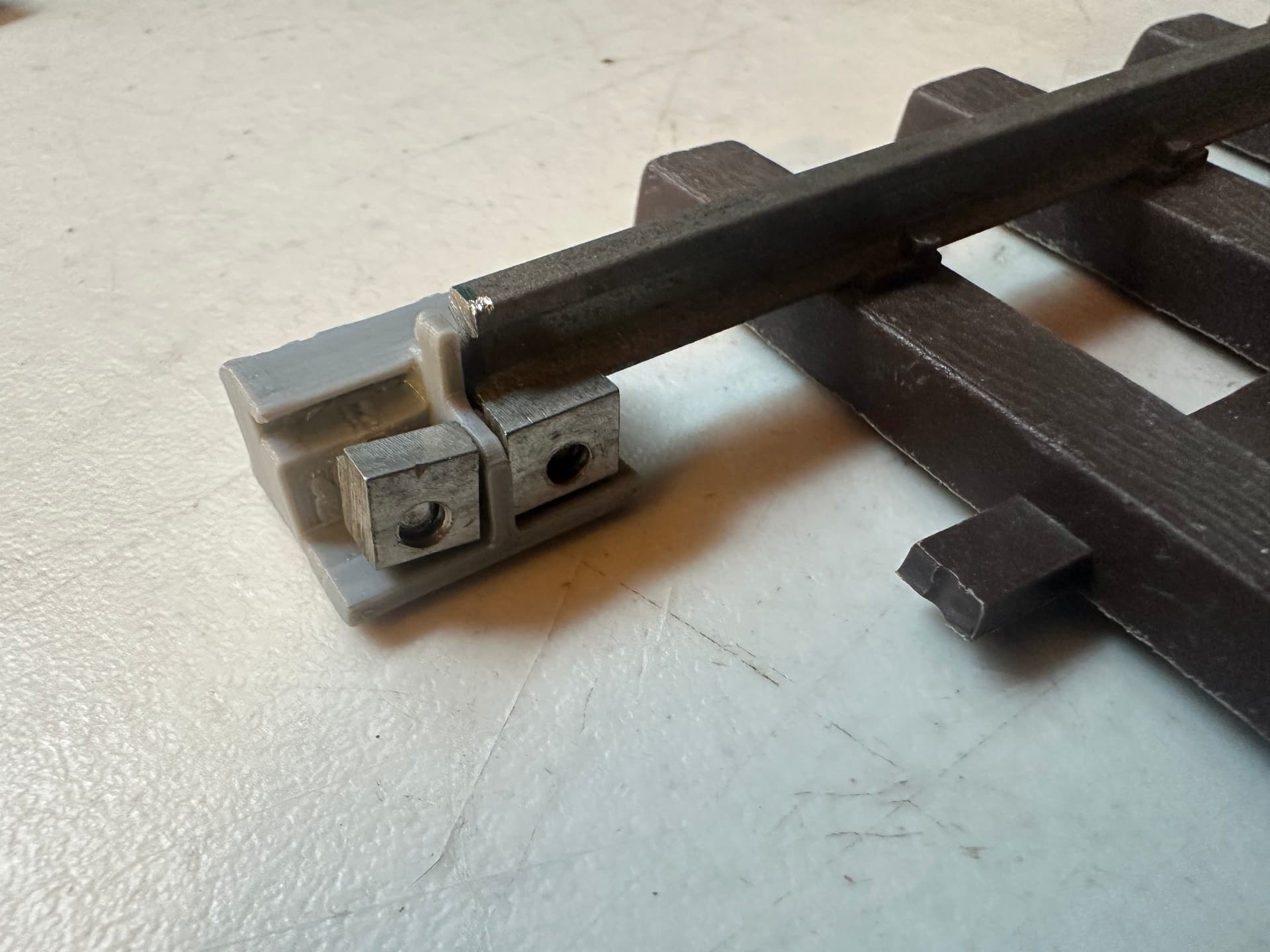

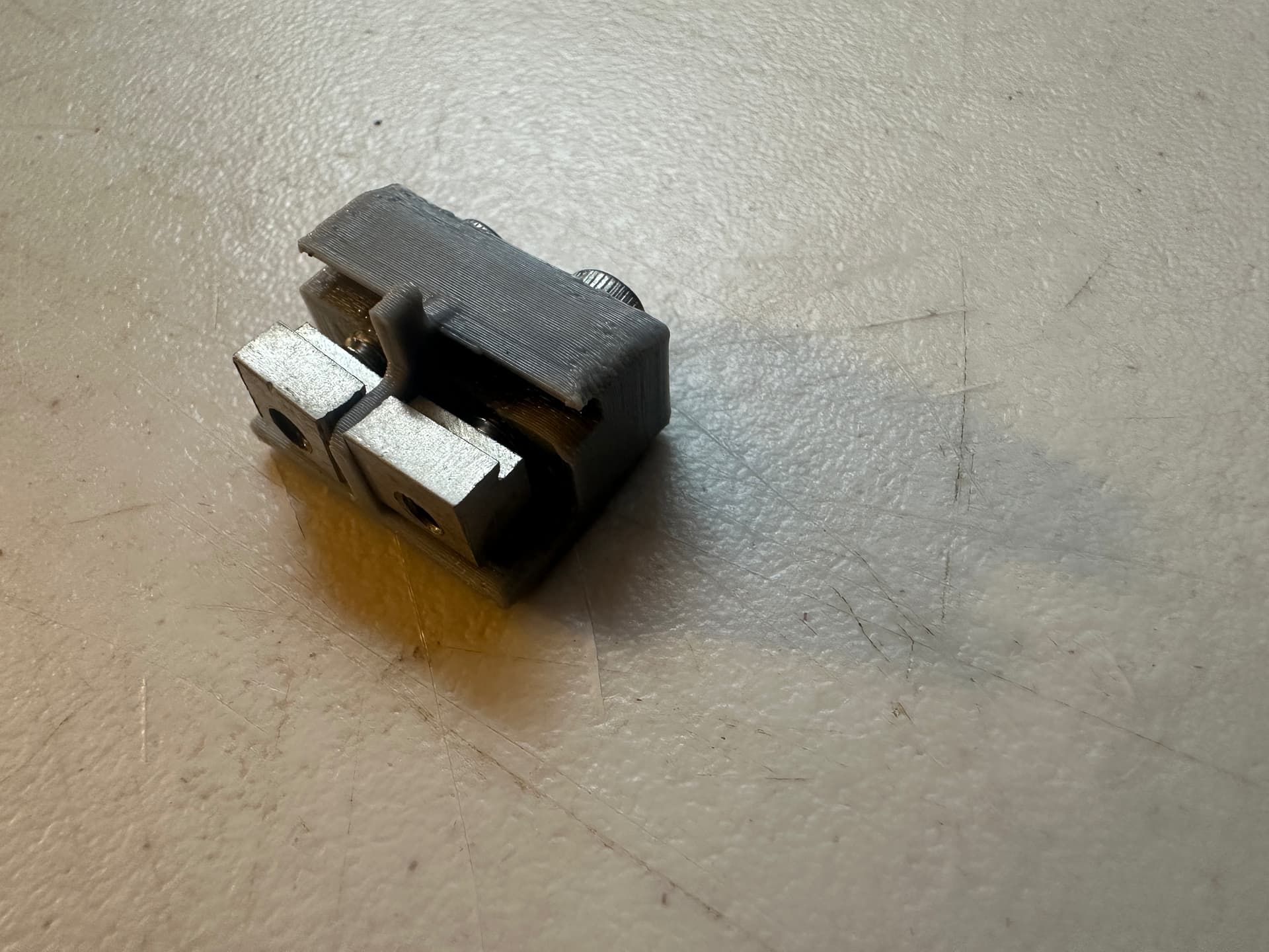

Last summer, Al was kind enough to share his CAD files for this joiner. I did a bit of fiddling to size it to code 250. A few test prints in PETG for adjustment and I think I have a winner.
Didja break the plastic part on the original? I like the addition of the sepetrator between rails, I don’t recall the original having that. Don’t over tighten!
EDIT to add that I didn’t realize this was an old thread or my comment would have been a bit different. Carry on!
Hah, nope. I have some insulated joiners but I like this design with the whatzit between the rails. This prevents expansion/contraction/movement of the rails from creating an issue.

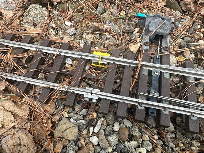

Nice! We’ve gone back to LGB rail joiners, as the SPLIT JAW ones got brittle and, over time, wiggled until they contacted across the break! As an extra bonus, bright yellow joiners let us know where to (or where not to!) stop trains.
Getting the insulated joiners in place on the first few blocks.
