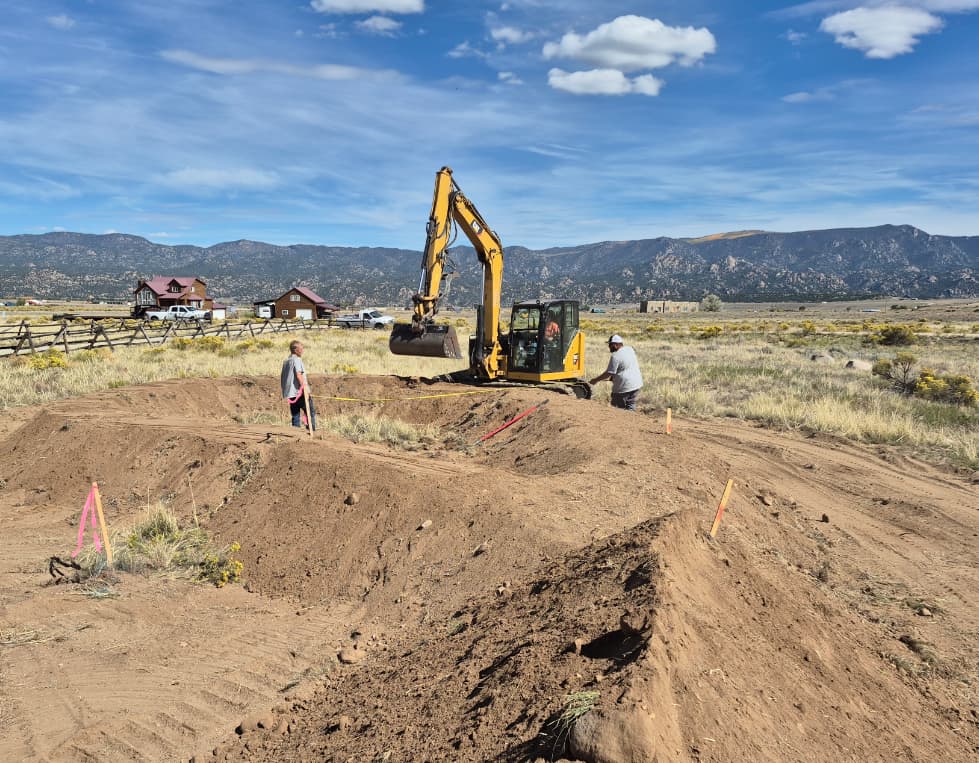

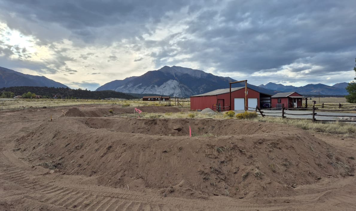

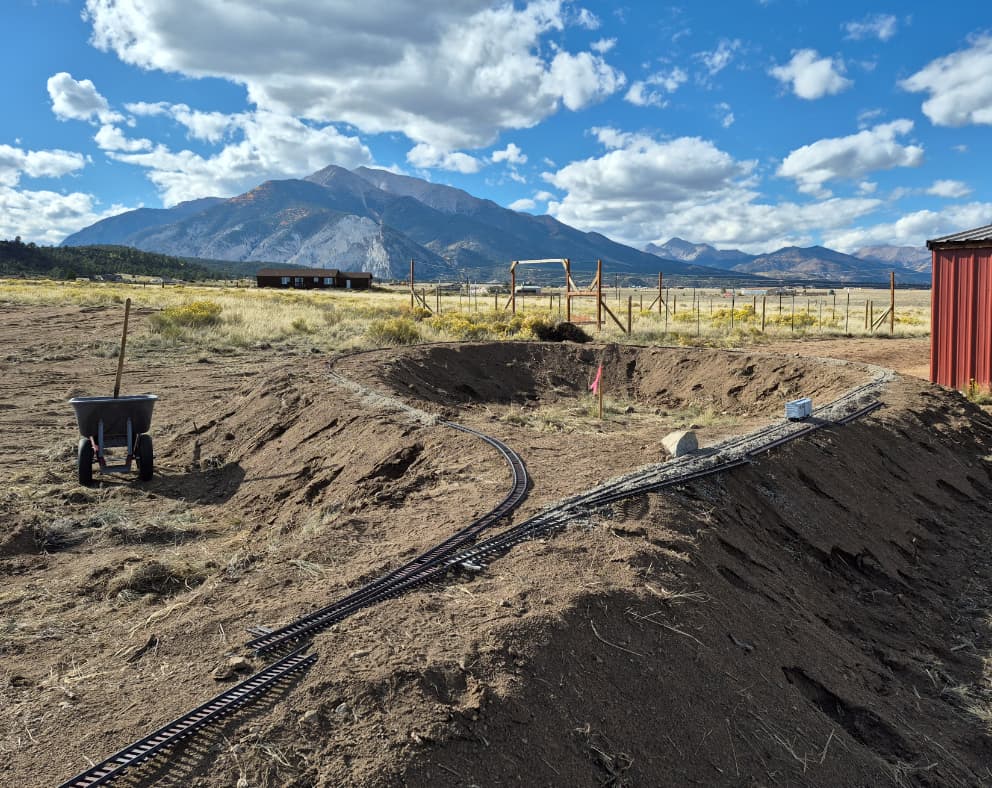

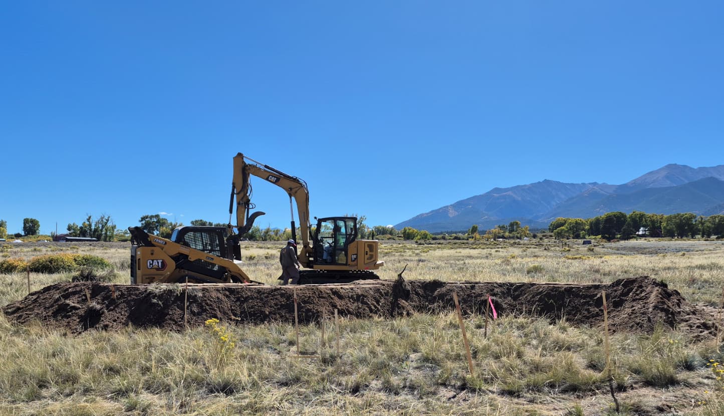

The new layout is roughly 3’ above existing grade. Here’s a shot of the grading underway for the west loop:

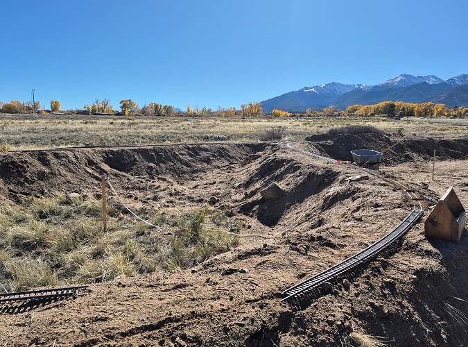

Here’s some grading for the east loop:
After two days of earthwork and grading, a view from the east loop looking toward Mount Princeton last Friday night:

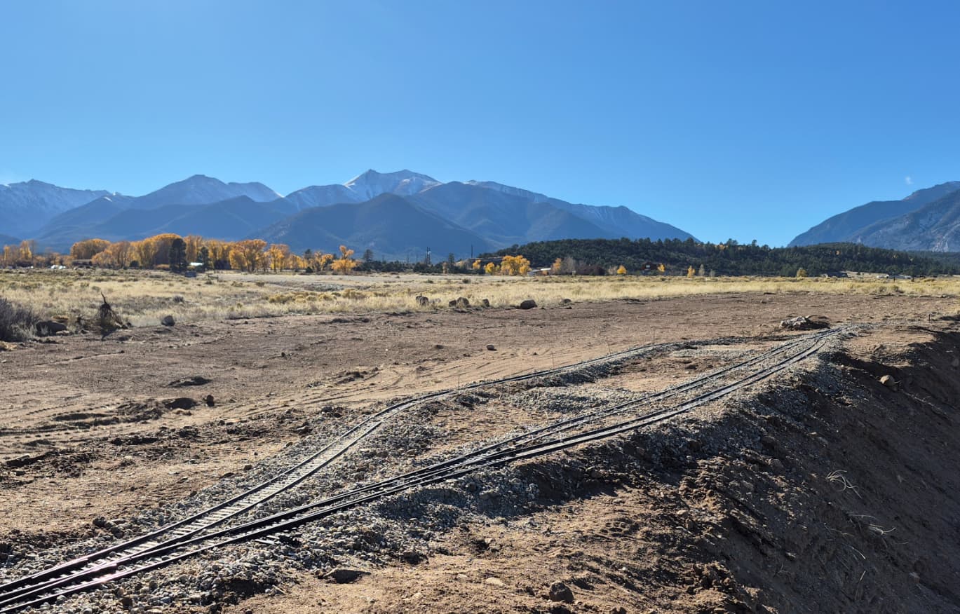

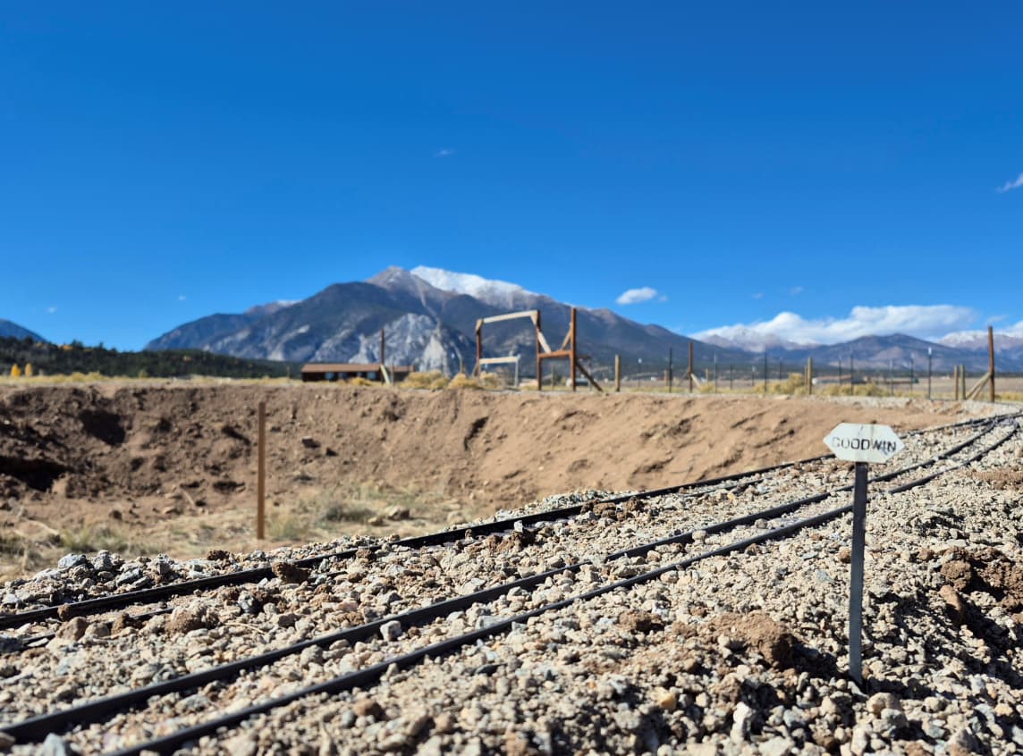

On Sunday I began grading and trackwork on the new mainline at Goodwin:
My goal is to have the layout completed before winter gets serious. Hope to have the mainline completed over the next couple of weeks, then go back and install the sidings.

How much is that getting compacted as it’s built up? I’d imagine it will start to settle over the next year or two and be about half that height long term.
that shouldn’t be a problem.

Thanks for the comments! I have spent my adult life in the engineering and construction fields. Drainage will not be a problem as we live in a pretty dry climate; also the ground around here “percs” very well, meaning water dissipates into the ground rapidly.
As to compaction, fill was placed in 12" lifts and compacted with the excavator bucket. I do not expect to see much settlement. if there is, well that’s what the section crew is for. :wink:
Got track built on the west loop a couple of days ago:
The fenced garden area in the background is going away someday - can’t have that in my pics!

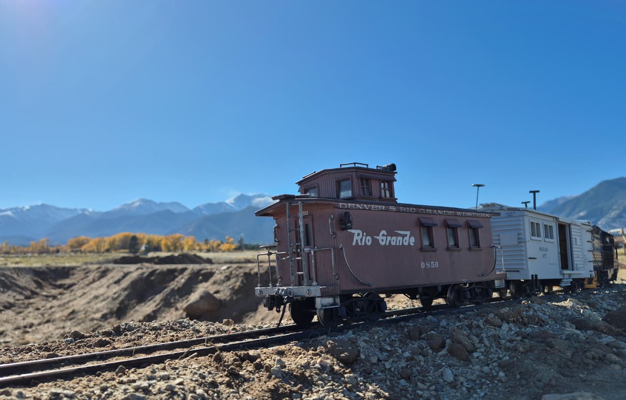

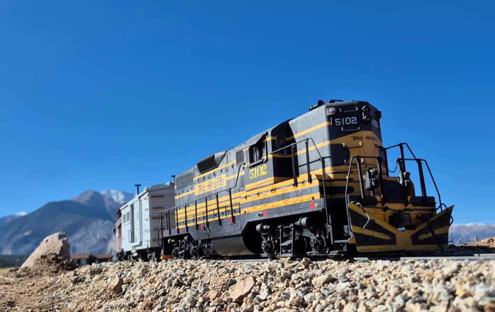

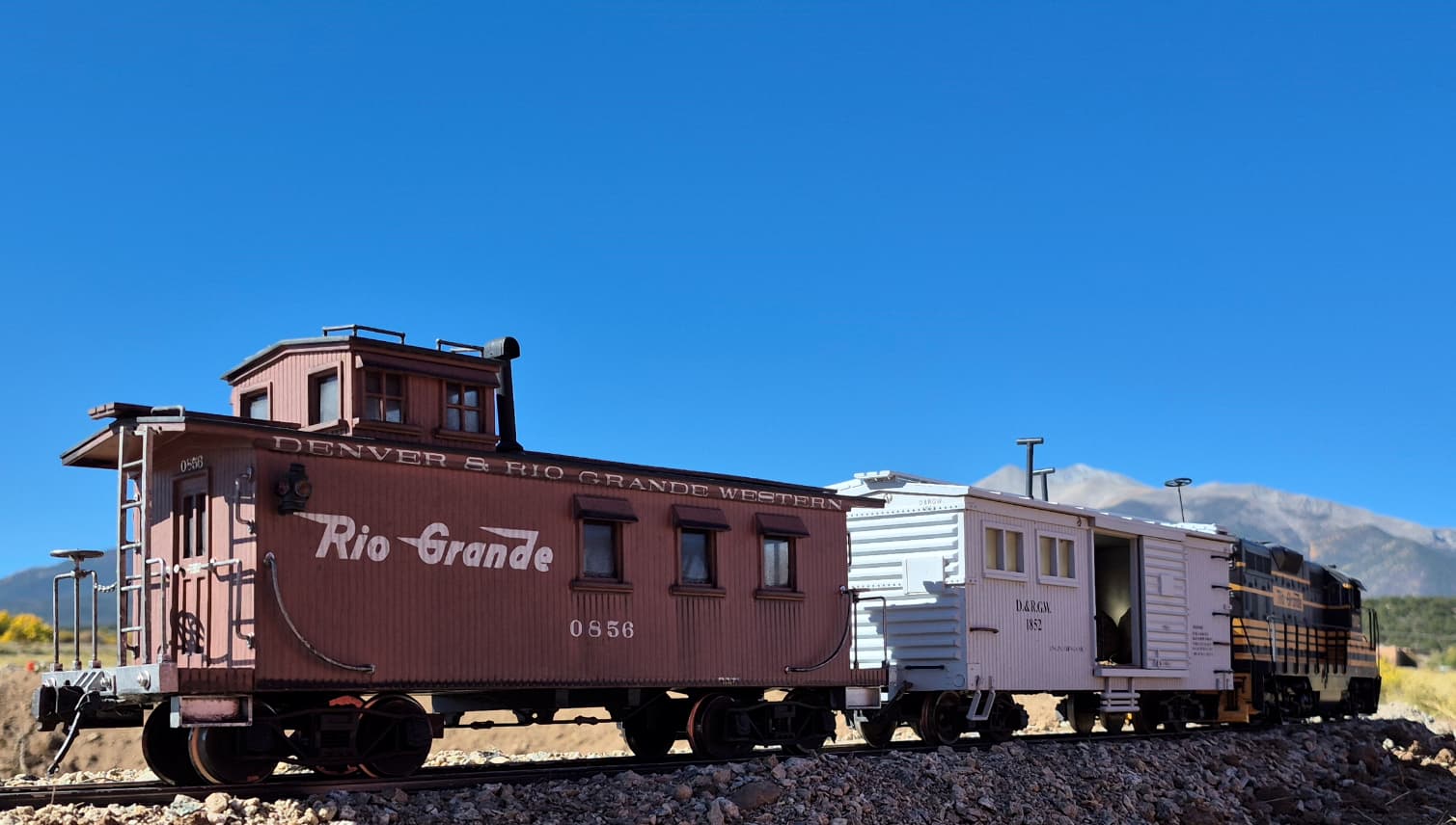

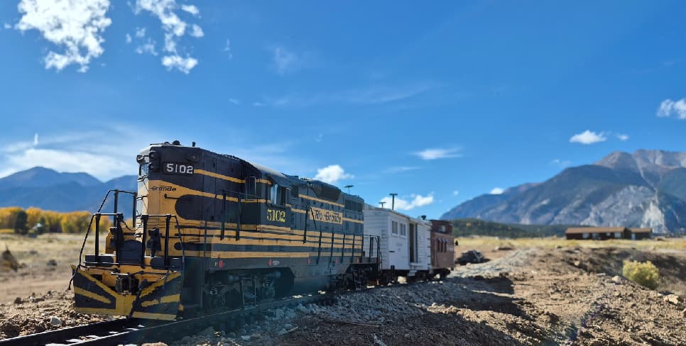

Got about a third of my track in service this afternoon. Here’s the first train going up the west loop. That’s 14,269’ Mount Antero in the distance:
The work train made it all the way to the west end of the Mosca yard:

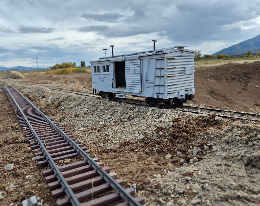

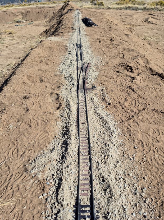

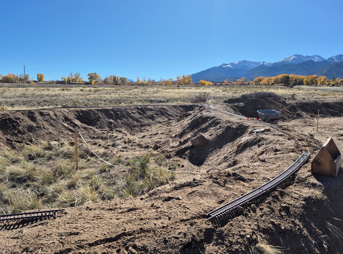

Made some more progress today. Yesterday construction was rained out. Today’s goal was to get through the Mosca yard. The stringline shows proposed construction:

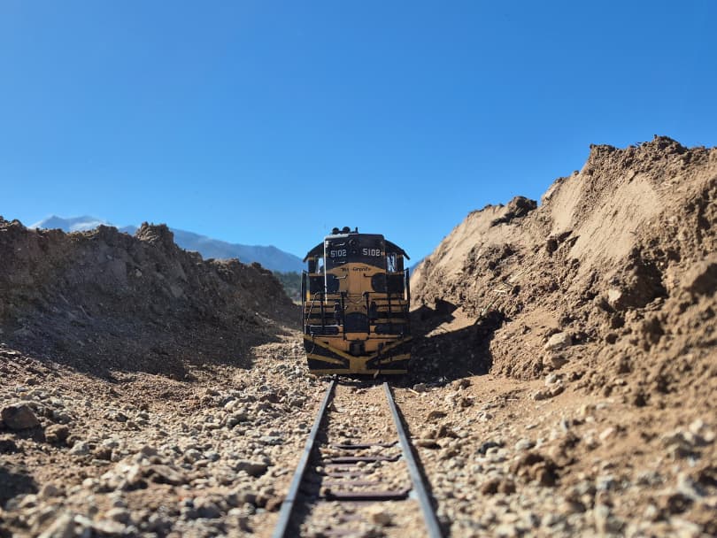

Track and ballast in place. I asked the contractor to put a few extra buckets of dirt on the alignment ahead so I could build a cut. For variety’s sake, don’tcha know:
First train to the east end of the Mosca yard:

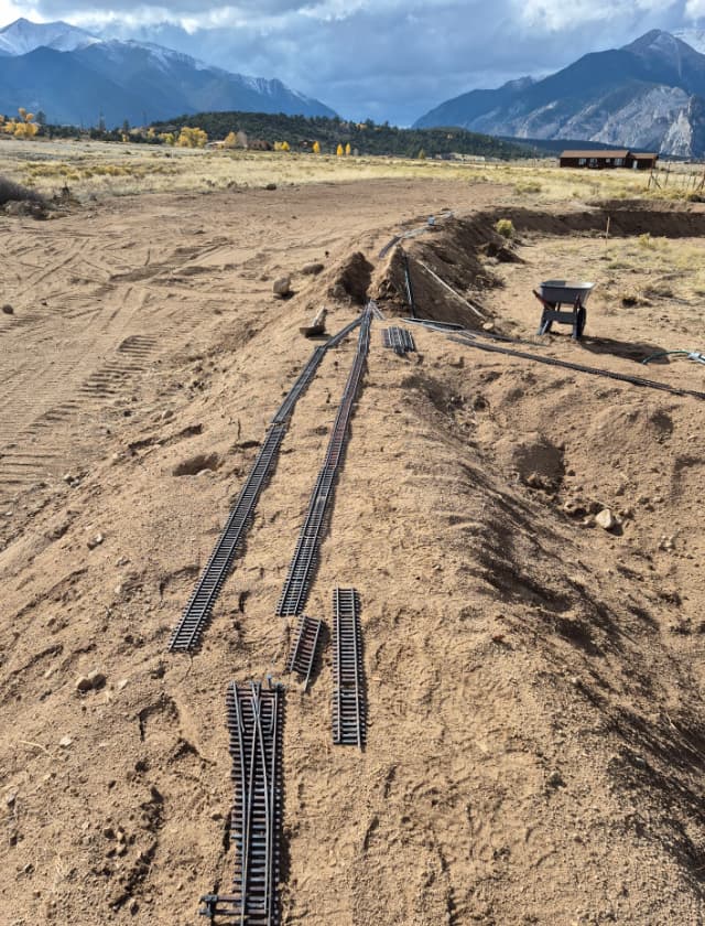

Okay, made a lot of progress since Sunday. On Tuesday evening I began to lay out the yard at Mirage:

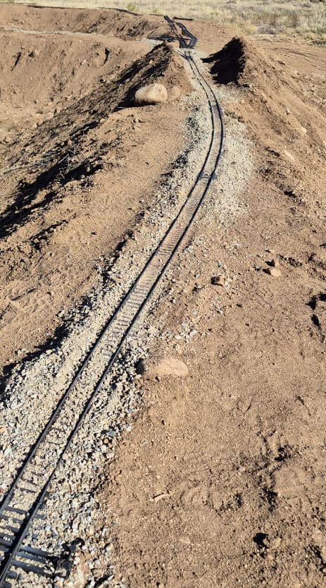

And built a little track east from Mosca through the cut:

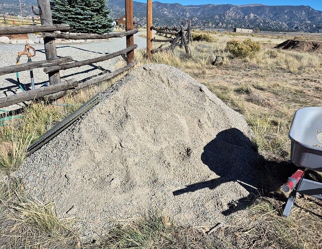

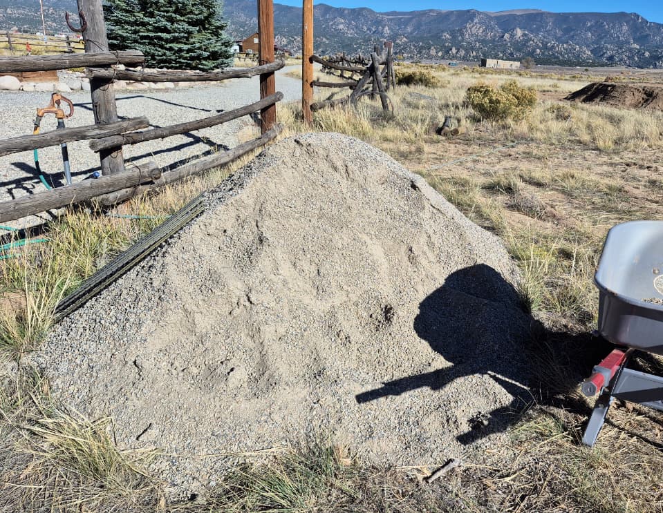

For this project, I bought five tons of screenings from a local gravel pit. This is what I am using for ballast, and this much should last me the rest of my days. Historically I have brought this stuff home in 5 gallon buckets from various construction sites - this is much less labor intensive:

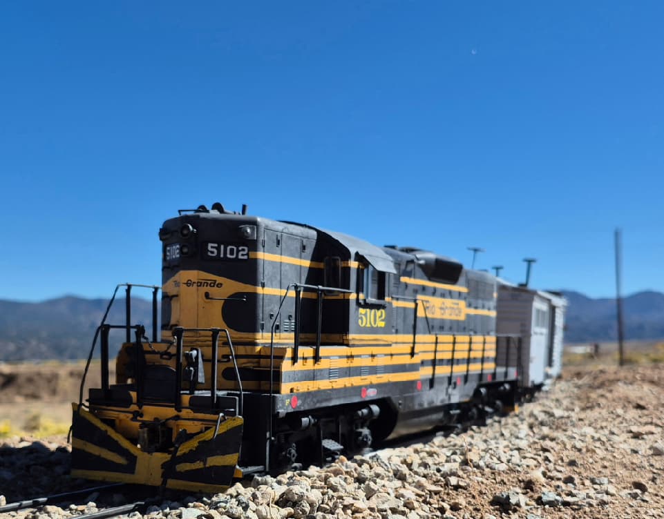

Once Mirage was finished, the mainline was complete. here’s the first train through the cut:
First train around the east loop:
First train to do a complete lap of the mainline:

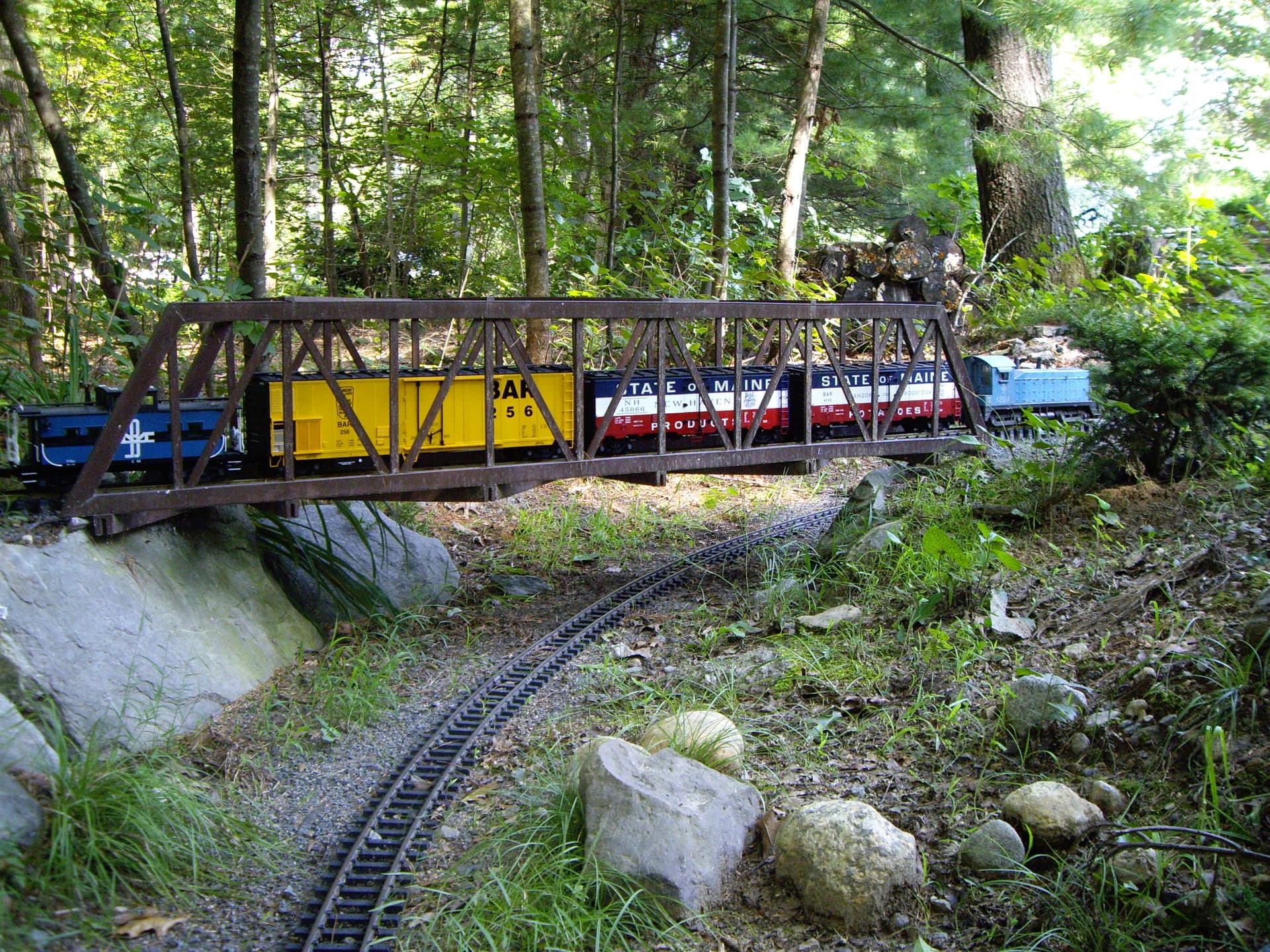

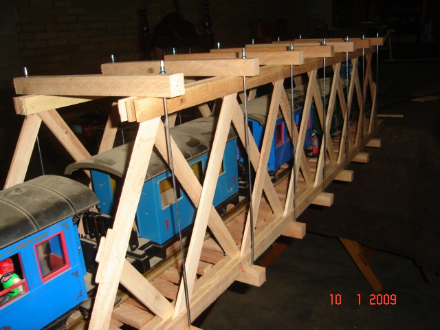

i made a crude Howe Truss bridge once.
just cedar, nails, screws and bicycle spokes.
bruecke1-11
https://kormsen.info/bridges/trussbridge/
I made mine out of trim pieces of PVC lattes found at the big box stores
