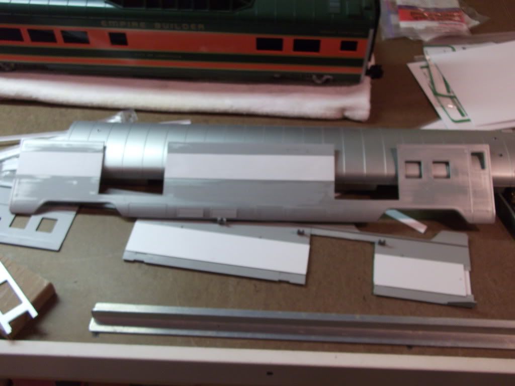

I love my LGB streamliners but sadly they never made them in Great Northern livery…So I got out a spray can. I made coaches, dome cars, and even an observation…But wanted an RPO. LGB never made an RPO. WARNING…If your a rivet counter or serious LGB collector you may want to avert your eyes!
Finished…

The break down…
1 LGB streamlined coach on ebay…$50.00 (bought coach and obs for $100.00)
2 cans of Rustoleum…$7.98
1 roll gold automotive pinstripe…$6.99
Left-over dry transfers from years ago and scrap styrene…$0.00
I’m happy with the results but it ain’t no museum piece!!!

Great work. What’s the thickness of the styrene you used to cover the windows?

Bruce…I “cut out” the window sections and replaced them with .080" styrene, I backed this up with a larger piece of .060". This allowed me to keep the top and bottom of the original car sides so I could use the LGB roof and floor units to screw right back on as normal. The styrene was a near perfect match in thickness! I re-used four of the now removed windows for the doors.

You did a great job on that seam. What did you cut it with? You might think about submitting an article to Garden Railways.

Bruce…I scored a line with a t-bar straight edge and a standard utility knife (the big Stanley ones). After 5 or 6 passes I “snapped” the car body. It made for a very clean cut, no sanding required. I also got sneaky and hid the seam under the gold pinstripe, though honestly you couldn’t see it anyway.
The cargo door grab rails are from LGB 2-bay coal hoppers. Every car I ever bought had a couple extra, guess there was a reason to hang on to 'em.
