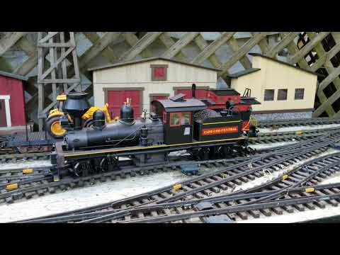

Here is my Shay in all her glory running the yard.

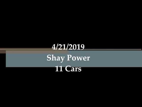

I have RailPro in 2 Shays and really like the system for being so user friendly. The Shay sounds are very basic and as Jon pointed out don’t sinc well between stop and low speed. The range of sound effects is less than a Phoenix but I believe more than the Revo provides.
Here is one of mine running at semi low speed.

Nice Shay Joe.
